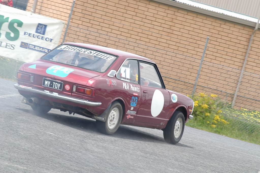

This is roughly how much roll I get from my 20 on basically standard suspension, and I am going pretty hard at this point.
how fast are you going on this pic? mine will do it on high speed corners. eg: coming off the highway on to a slip road or fast wide taffic lights.

Tic pic before was taken at about 60km/h maybe. It is about to break into oversteer.

Q3 see picture as rough guide, "as i put the boot in"
Q4 ummm the wheel will pull against me (you know if you let the wheel go it want to straghten, it wants to go the other way)
Q5 see picture also
