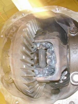

August 10, 200719 yr comment_191015 hi guys, don't mean to bring the thread back to life yet again, but I'm trying to research info on mounting a CA18 into a KE70 corolla, just to keep my options open. so far all i've got is: use RB20 engine mounts on the existing KE70 crossmember mock-fit the engine and gearbox to see how much needs to be cut out for the selector to move back, and cut it out accordingly have the tailshaft shortened and balanced use an AE71/AE86 diff, or a stock welded diff questions for you: does the T50 gearbox mate to a CA18DE, be it directly or using an adapter plate and some other sort of bell housing? how does it go for clearance in relation to both the bonnet and firewall? what costs would you roughly estimate for a conversion such as this? Report

August 12, 200719 yr comment_191233 they same to be the same box from whatr i saw when i just pulled a CA18DET box apart. Nissan pintara even looks the same (ca20). A proper det box has more ribbing on the outer case for some reason unsure as too way? All i did when putting a ca in a mates ke70 and in my 35 coupe, Was 1.cut the standard enigine mount brackets off the cross memeber.,Used range rover v8 mounts to bolt them to the motor 2. LOweerd motor and box (as one unit) into the car and scribed (marked) where brackets needed to be cut to ensure motor sat in the correct location. Both height, Sided to sside and fron t to back. 3. cut brackets as required and tack welded on. 4. Mark shifter location and cut out 5. messure and make up gearbox cross memeber 30x30 (25x25 maybe?? can't remember) box and some flat bar. Plenty of room for motor just remove standard fan and use a thermo. Radiator wither get a bigger corona one standard ca one or have a three row core put in the ke70 one and get a switch for the thermo put in the bottom tank. Use standard ca box and install a good clutch Report
