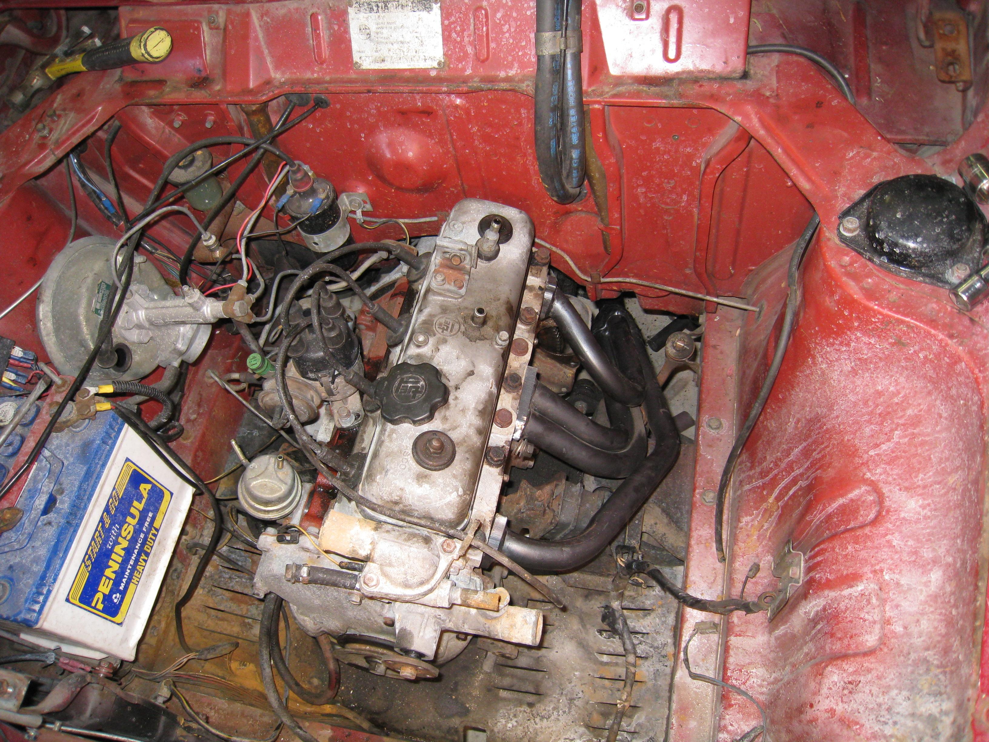

Before I ripped the 3k out, I checked the Extractor fitment, given that they are notorious for hitting things in KE10's.....
Perfect fit! It's touching the side of the Toyoglide, but the K50 is about 70mm narrower, so it'll have plenty of space in there once I swap the box.
There looks like ample space for the starter (shouldn't even need a KE70 one), and the Idler is also clear on full stroke, plus they fit up nicely with the Dellortos. I'm fairly sure they're HM's for those who want to know.
*EDIT* I just checked my correspondence with the guy I bought them off, he said they were HM Headers (Perry might be owned by HM now)> I'd assume they are the HM38's off their website. I'm blown away at the fit!
Edited by philbey
For those looking at my engine bay wondering what the white crap is, thats the Chem E Weld that got all over the engine bay from my fix-it attempt......
Contemplating spraying the engine bay....

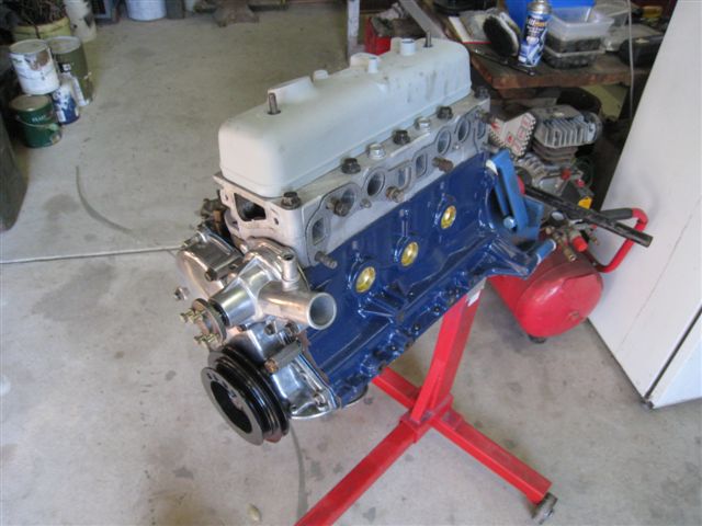

Slow progress.... I got my sump sorted out, with a bit of Mad Fabrication, my attempt at a sump baffle should avoid any starvation issues.
I had to run about getting some new bolts - Clutch Bolts, Flywheel bolts and also a set of Engine Mount - Block bolts because I had to slice the old ones off. Read my post on bolts stretching as well... CLICK HERE.
I also had a stupid moment - couldn't work out why my flywheel spigot hole was bigger than the bearing I bought... Went to the wreckers to check what their other flywheel sizes were, only to discover the Spigot bearing on K engines mounts in the back of the crank. :jamie: Last clutch I replaced, it was in the flywheel....
Funny as.
Next week I'll get the box and motor bolted together and it's bolt up and crank over time. Gold.
