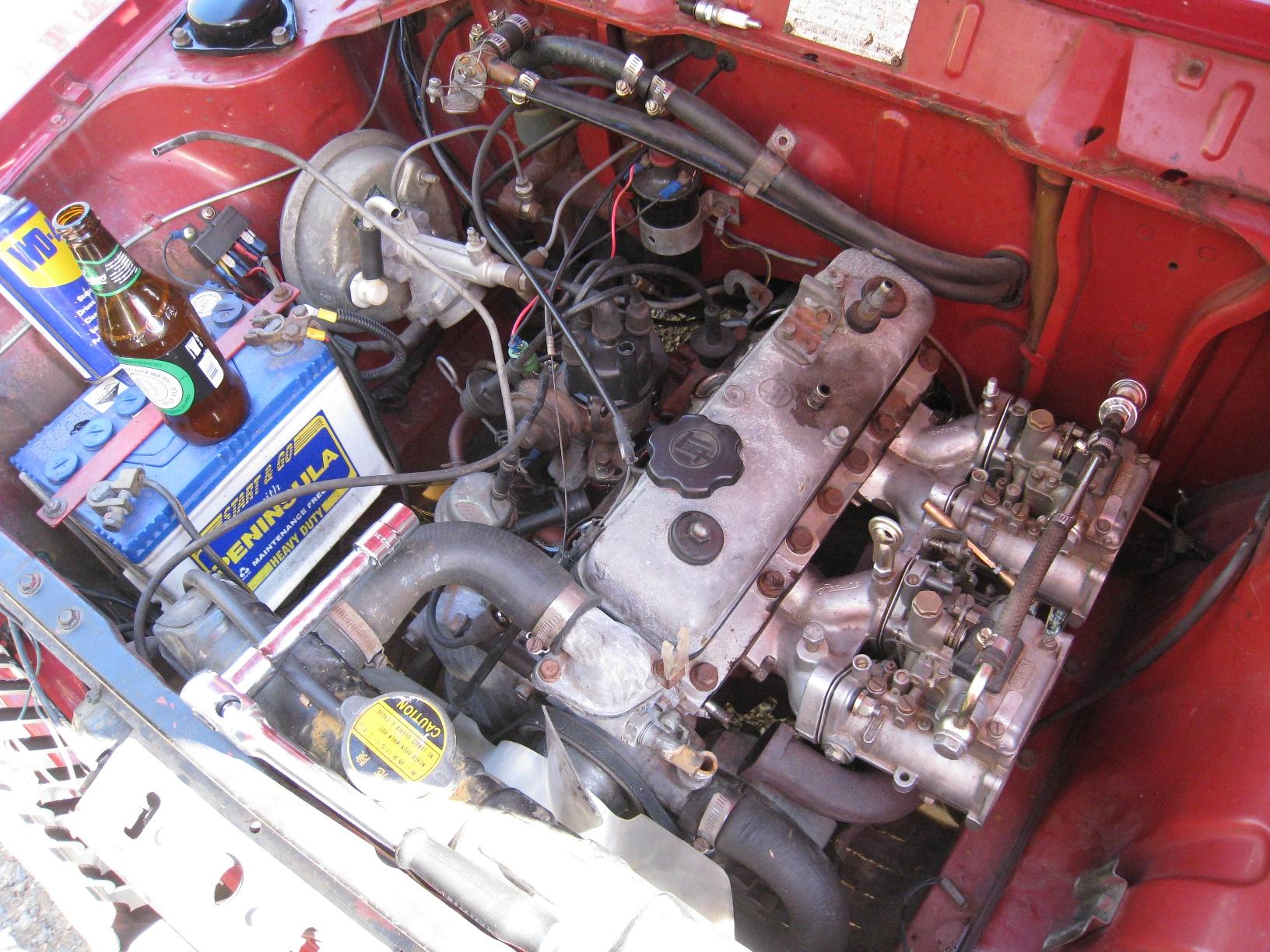

Mount up pic of the DHLA's from a couple of months back. Need to sort out ignition curve and filters for the DHLAs too.

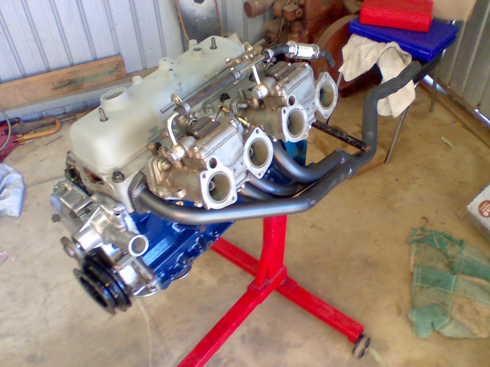

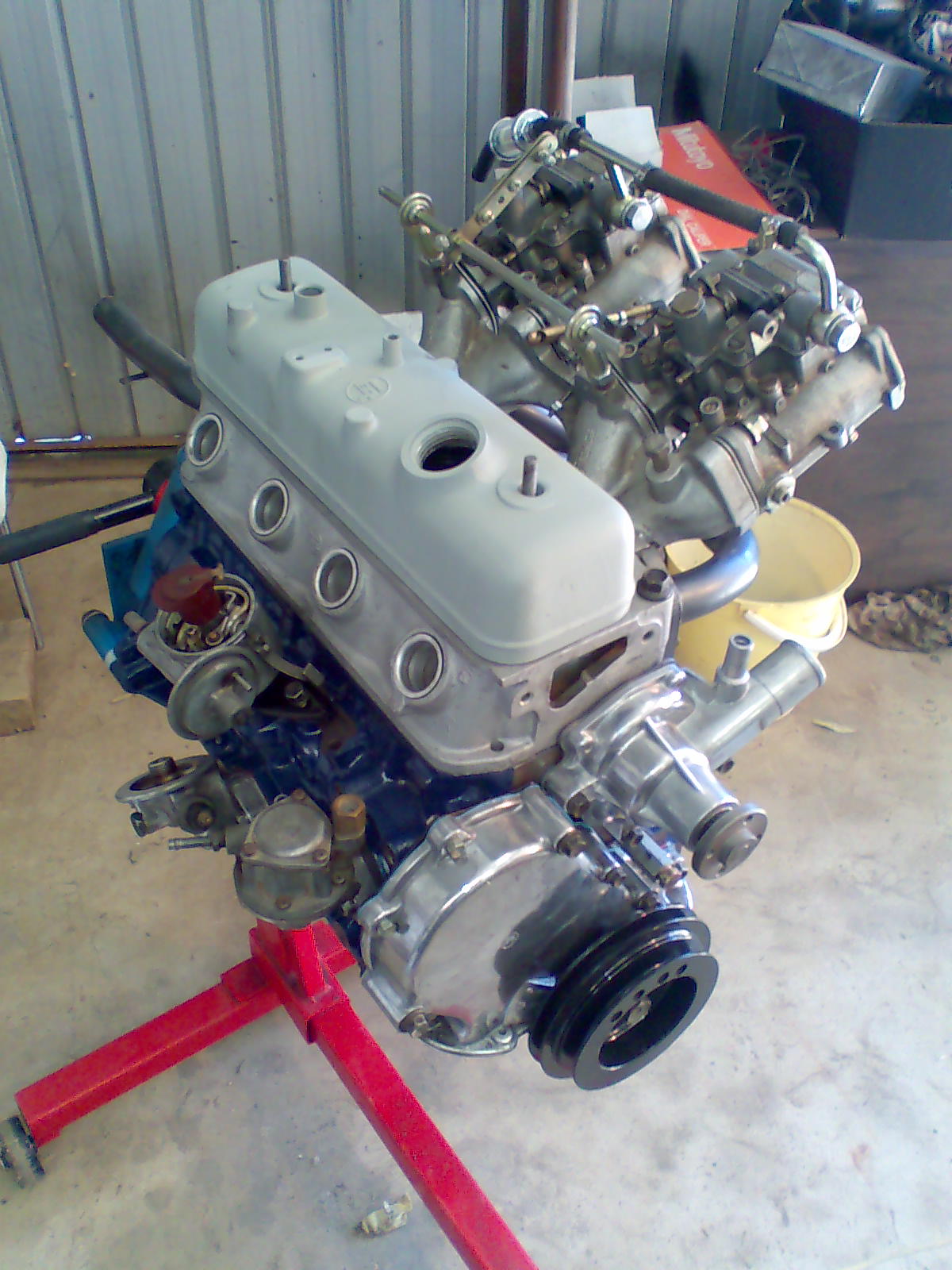

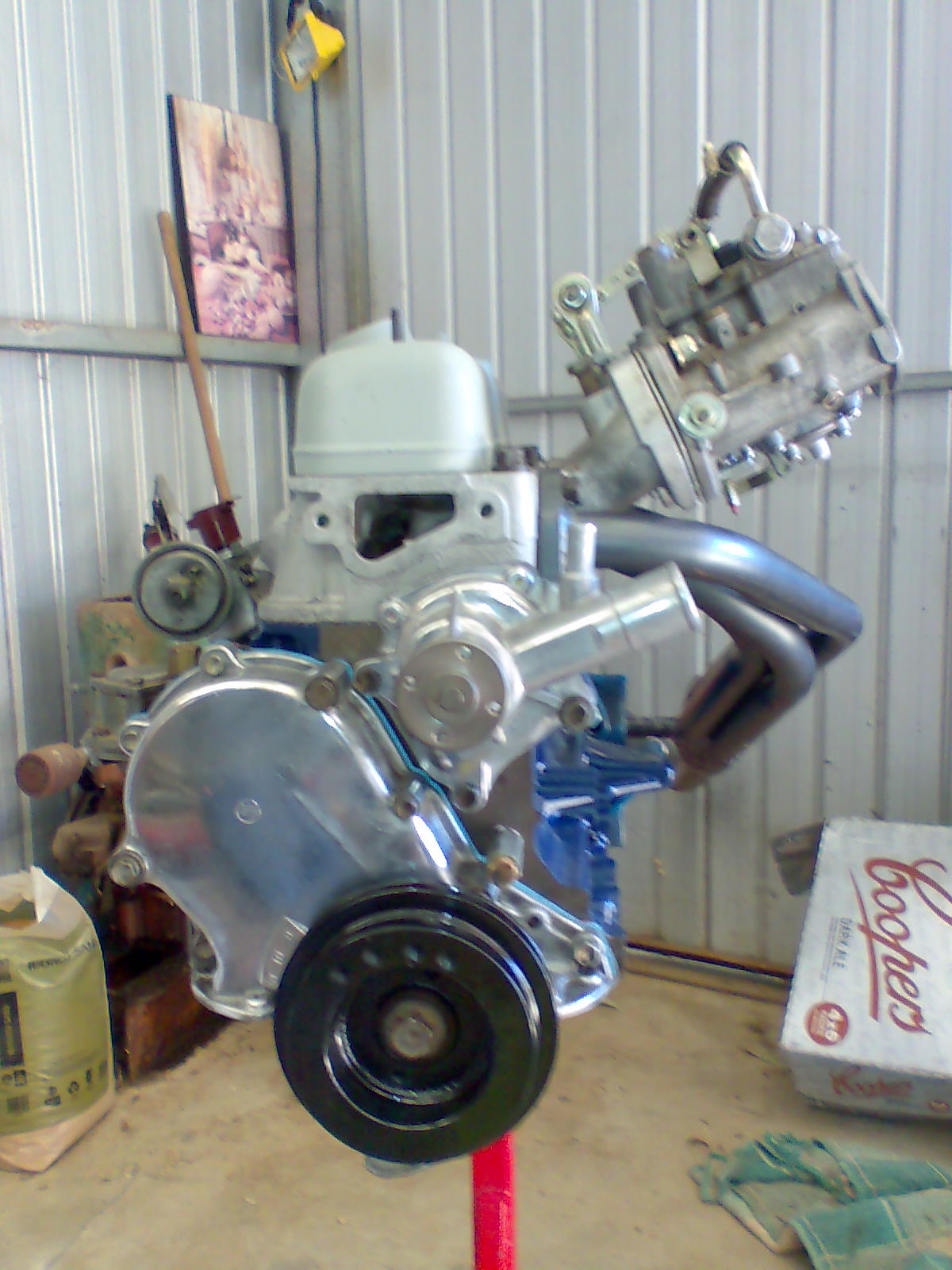

Pics:
Good work Philbey, thats a very nicely built 5K. Any estimates on power?
