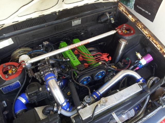

some speedflow, filter, extra fuel pump.
hooked up innovate wideband to haltech.
eflex hooked to return line, just brass fittings to step the return down to the smaller size.
It now starts and runs good on the new haltech ecu, its now booked in for dyno tune on the 25th june, i leave for japan in 2 days, so this goes in 2 days after our return.
I now have 2 bosch pumps under the car, with a speedflow mesh 10 micron filter after the pressure pumps to look after the id2000's. I also have a 40 micron mesh aeromotive filter before the lift pump/ surge tank. Fuel rail now returns to the surge tank.
under the car beside the tank.
in the boot surge tank
I had to put in a different fuse holder for the fuel pumps, the previous one got hot and melted, connections must have been crap.
Fuel pressure gauge finally arrived so fuel rail pressure is set spot on.
This arrived today, radiator overflow, its about an inch too tall so will have to cut the bottom off and shorten it a tad.
I have been working on this thing a fair bit, sorting out a heap of little things, getting all the gauges working, getting it running good, and going over any issues. I changed to rear wheels today to 17s hopefully they suit the dyno better.

    New engine mounts made.                     removed ready to finish weld
got a new battery cos the other one was dead, intended for a harley its pretty small, 400cca deep cycle non-spill.
Used the opportunity to add the main battery fuse inside the box, should have done it long ago.
I read on the haltech forum that air intake sensor should not be mounted into any sort of heatsink, so i moved it to the intercooler pipe just before the plenum. I cut a bit of round bar and welded it to the pipe underneath, then drill + taped the thread. Worked out overrated.
I started on the radiator overflow setup, I decided to thread the radiator overflow and taped a thread into a 6an fitting to screw onto it, I just didnt want to pull the radiator out to weld it on. I need to put the fitting on the lathe still to remove the outer thread.
I have made the stainless overflow tank i bought fit the car too, i cut it down an inch or so, and shaped the bottom to suit the car, just waiting on a 6an weld fitting to finish, and i still need to make some mounts for it, i don't have much stainless laying around.
This is how it will sit now, pretty out of view.

Dyno last friday, unfinished due to a fuel supply issue. Didnt get to e85 tune, 98 only so far so we didnt get to put some real boost into it. 310hp@20psi and [email protected], happy with that, shows plenty of promise through the 4500 stally. Would have liked to get it finished but its run in now and going strong.
