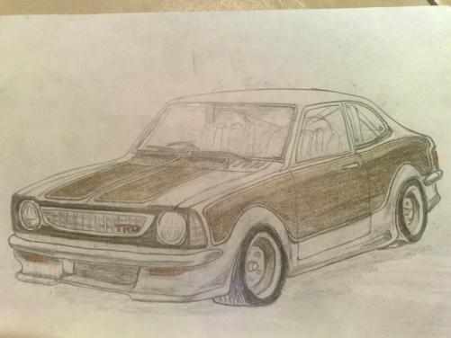

toy74 Posted February 2, 2008 Author Report Posted February 2, 2008 I drew this pic of what it is going to look like. I think its a sweetass look, unique. :jamie: What do you all think? Quote

machg Posted February 2, 2008 Report Posted February 2, 2008 I drew this pic of what it is going to look like. I think its a sweetass look, unique. :jamie: What do you all think? I don't know what its going to look like in the flesh, but that's a pretty old school (1970's) looking paint job, which I think will look great, but not with the modern looking skirts, front splitter. IMHO that kit will go better with a more modern style paint scheme or loose the skirts, go bolt on flares and a more old school looking splitter design with that paint, maybe look at race cars from that era for inspiration on splitter design? Having said all that, the dissonance (?) between the old and new will certainly make the car stand out from the crowd, if you go ahead with it. Quote
