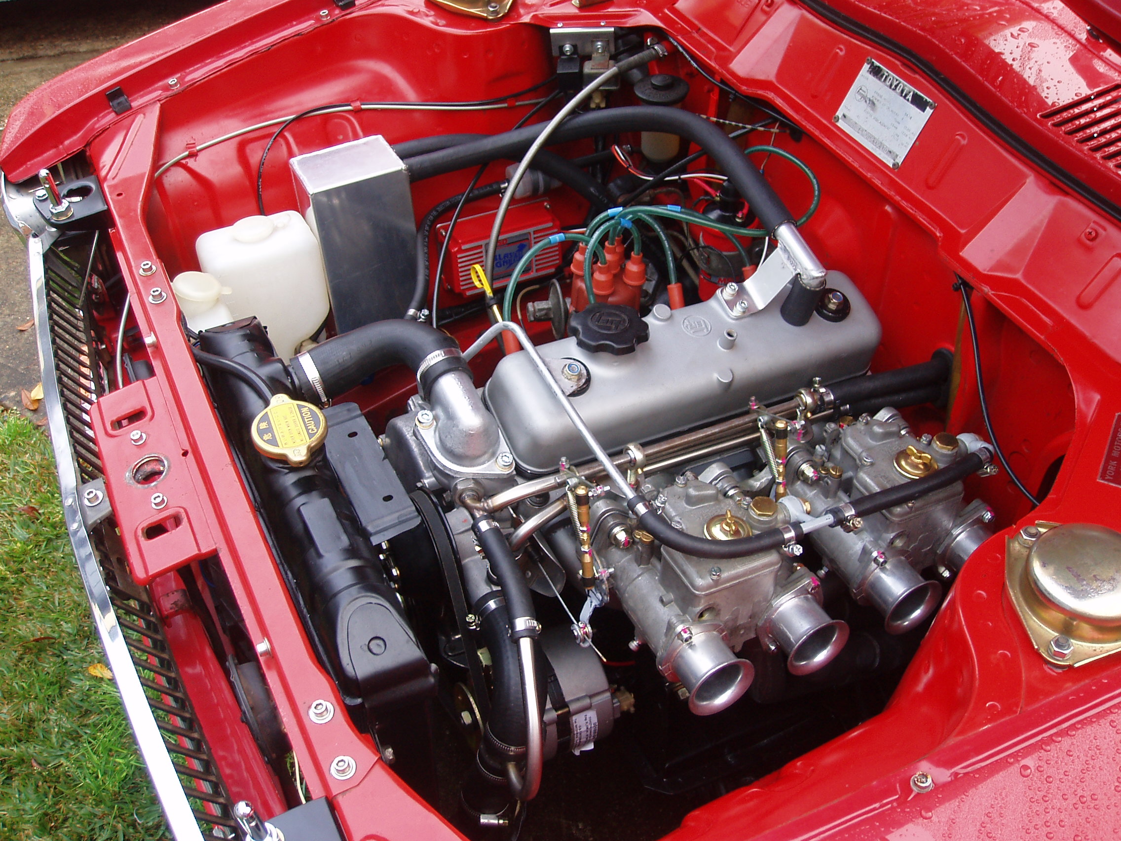

You have finished it so nicely A+ my friend. Oh, and please put up a vid of how it sounds!

Well done Gavclassic, that is finished very nicely, its a class act

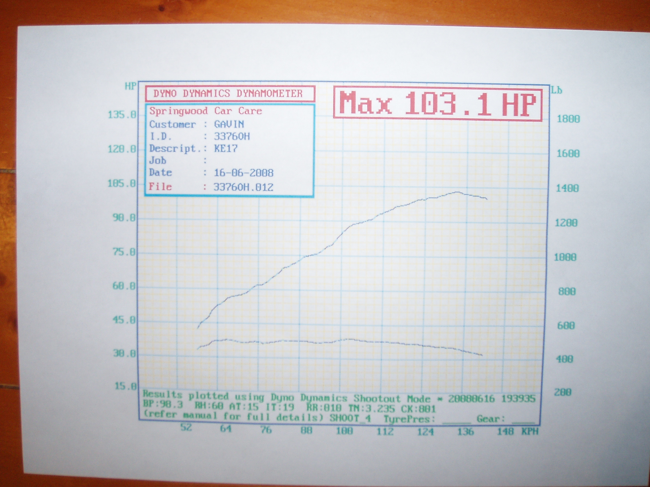

Just got of the dyno and after an hour of playing around we were able to get a little over 103hp at the wheels. Motor went fine, made good torque all the way through the rev range and made good HP from about 2500 up.
103HP in that little car must MOTOR :)
Not bad for a van motor with webbers and MSD on it. Any other motor mods planned? eg cam, lifters, valves etc?

Motor was built by Jeff Taylor, big valves, big port job, cam, lightened flywheel etc. He also buit the 4K in my Kahanacross car which made 75hp at the wheels. The 4k need about 8000rpm to get that power compare to about 6200rpm that the 7k needed.

Nice figure, and from a n/a k motor as well :)

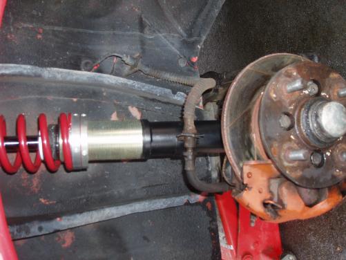

Also can we get some pictures of the front struts at all? Sounds like a mean setup. What coil overs arae used custom jobs?
I just put heavier oil in my stock KE15 struts to give it a stiffer ride..LOL

Only got one pic, car was corner weighted, Koni adjustables were matched to som Ebach coils on threded tubes grafted onto the original struts. Also an of set top bearing plate was made to give more castor and a little more neg camber.
Next will be a brake upgrade with disc/lsd rear.
