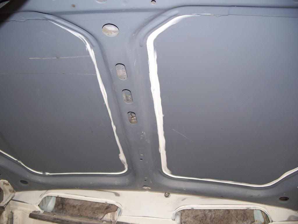

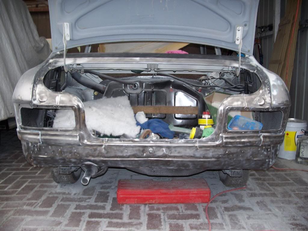

Doogs Posted July 18, 2010 Author Report Posted July 18, 2010 (edited) G'day guys, So the rear end has now been stripped and deoxadene'd and we have seam sealed the gutters and front of the bonnet. We also re-attached the bonnet to the skin with sikaflex and this has reduced it oilcaning. About half a day was spent with a slide hammer and hand tools pullng the rear end back out, to improve the gaps around the bootlid. The rear valence panel is still quite bent up and so I'm looking for a new one we can stitch in. I don't like my chances finding one all that much, so we might be stuck repairing the one on the car. Yesterday we gave all the baremetal a coat of etch primer, this should help seal things up and reduce future rust. We will now go around all the areas we have stripped and etched, and repair things bit by bit before stripping the rest. We plan to work around the whole car this way and get it all straight again. Stripping; Seal sealer; Bonnet re-attached; Gapping bootlid with new rubber and pulling the end out; Edited July 18, 2010 by Doogs Quote

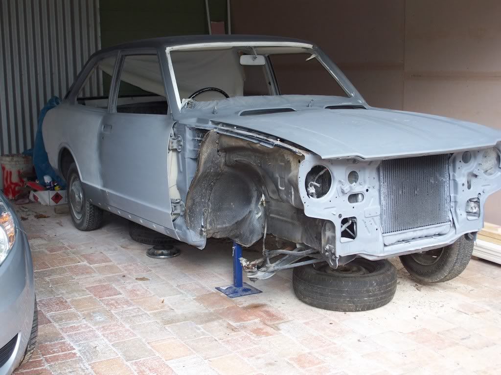

Doogs Posted September 18, 2010 Author Report Posted September 18, 2010 Here are a few recent pics; Repair almost done; Strut out and 1/4 getting closer; Out carport at home is now almost fully enclosed, man it's nice to have a good sheltered environment for the car to live and to work in! Quote

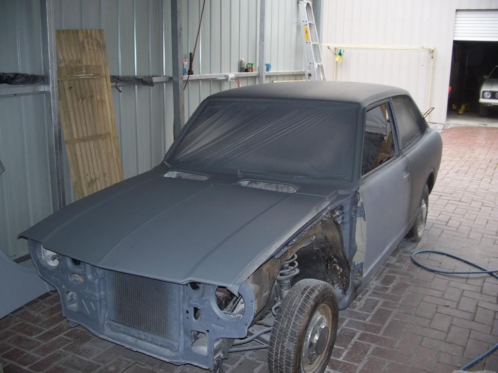

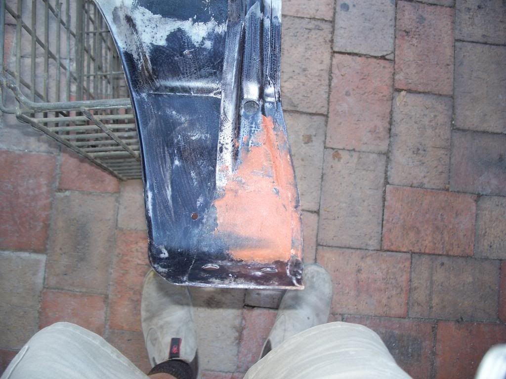

Doogs Posted April 1, 2011 Author Report Posted April 1, 2011 (edited) Hey guys, Not all that much happening at the moment. Time is scarce with Uni, Work and SAE. I have tyres on my rims and I'm gonna sort some coilover sleeves on the front. Not looking forward to seeing the fitment :S 205/60/13s on 6s! Just have to buy some more period 7s or 8 S with stretch! :P I have my first free day for a long time next Sunday so I will make some more progress of my own. Having a mates "help" has just slowing me up because he has way to many projects. No point rushing things though so I'll keep working my way through in my own time. Also I bought a 5k, 5 speed and custom plennum made from XF falcon runners from Loupee. Keen to get an engine build going soon (time premitting) and I'm leaning towards a dedicated gas setup on an Impco or GRA. Cheers, Edited April 17, 2011 by Doogs Quote

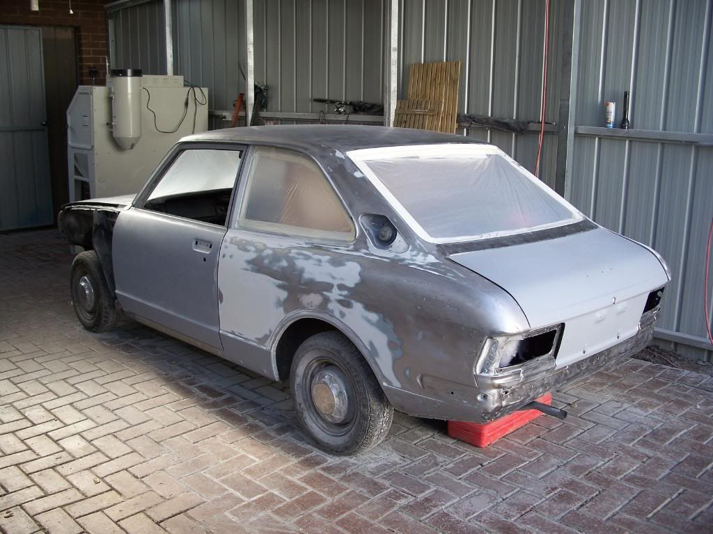

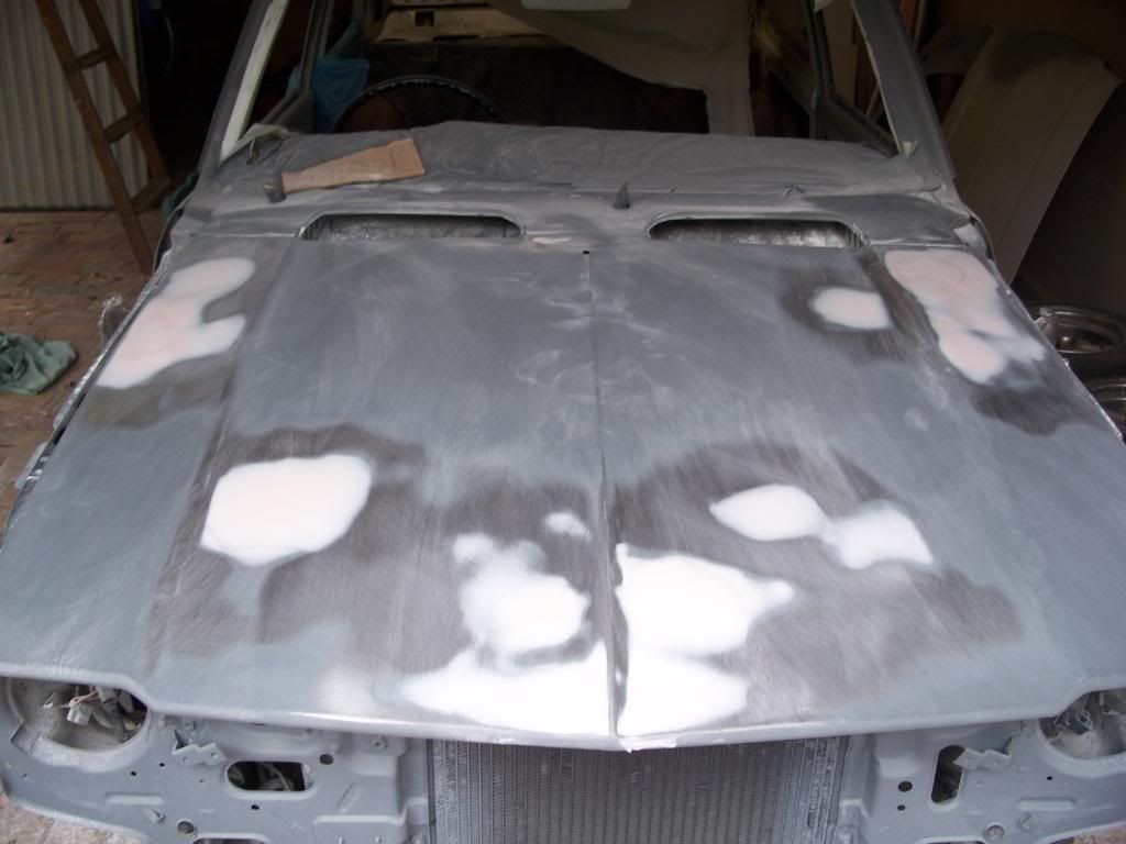

Doogs Posted April 17, 2011 Author Report Posted April 17, 2011 Recent work; Light coat of etch (still some more sanding to do); Back to original paint/steel; Reofill for pinholes; Etch; I need some longer bolts so I can put the engine on the stand, and then I can pull it down and determine what needs doing. Hopefully more time for progress soon, still need to strip the other door and front gaurds. Quote
