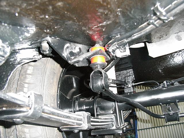

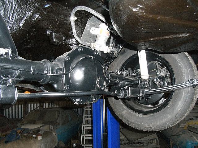

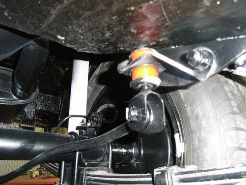

Hi there everyone i hope you all survived the heat wave (45degrees+ bloody hot)up our way (Swan Hill)any way i spent the day working on Thomas little beast. I finally found something good about the TE18 i was able to take the rear sway bar of and fit up to rear end of the ke11, came up a real treat(i'll get Thomas to put photos up)refitted the original front end back on of our donor car just need to turn the camber tops around and wheel alignment.Still waiting for our colapsable steering coloum from Peter Robisons(3 bloody weeks now)then of to the engineers.Tomorow i will try and find some clips so i can fit all the stainless side body trims and then i think ive just about got the little beast done other than i still have to trim out the boot for him but the little rolla is looking real sweet and looking forward to getting it back on the road. Anay way as i said when Thomas gets home i will get him to post some photos for you all to enjoy as i know you all like pics.

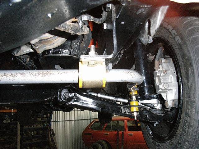

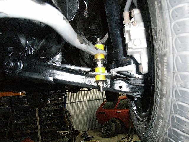

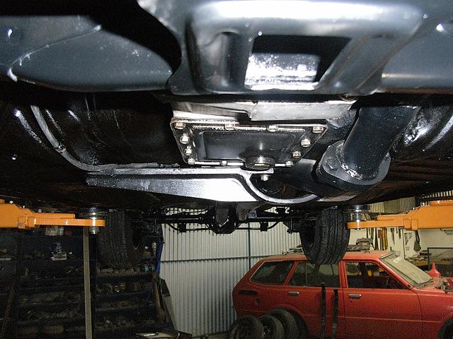

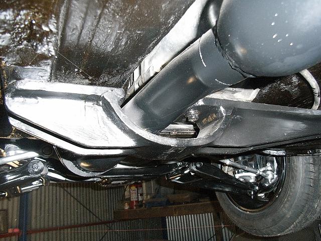

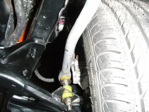

Hi there all just a few random shots for you all to enjoy of the rear sway bar and the under side all cleaned up and repainted.I have removed the front sway bar and are doing some mods to it tomorow to see if i can get it to work without fouling the brakes(i'll keep you updated)and allso fitting up the side moulds.Anayway here are the photos i hope you enjoy.
Cheers:-Stuart.

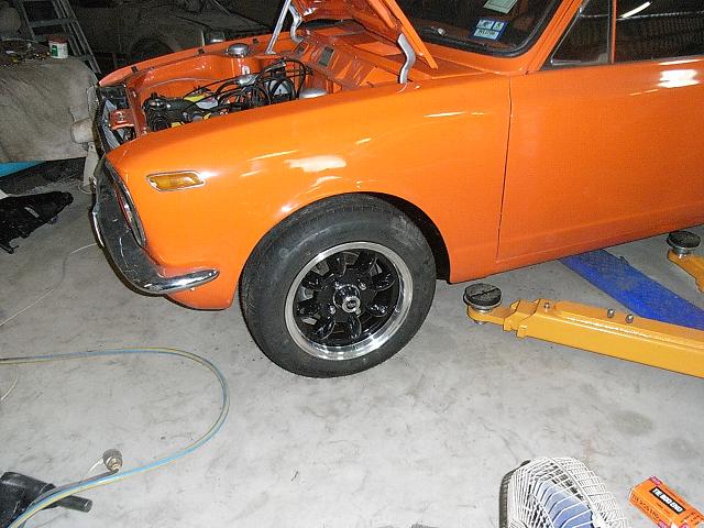

Looking great guys!! New wheels look awesome!!
It's workmanship like this that made me nominate it for RCOTY!!

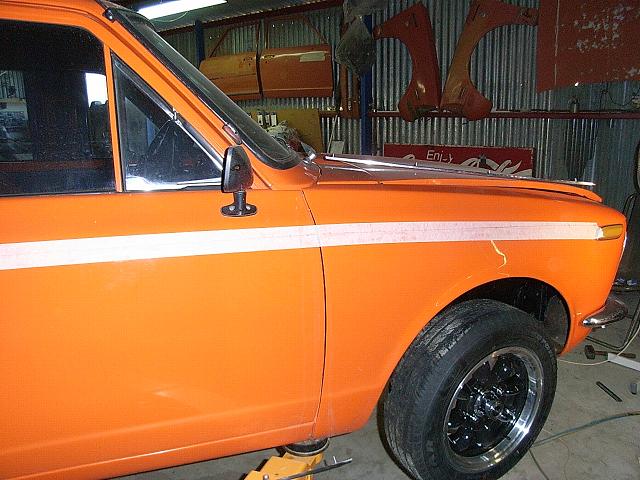

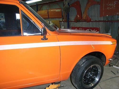

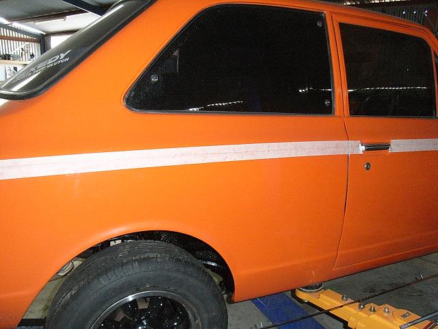

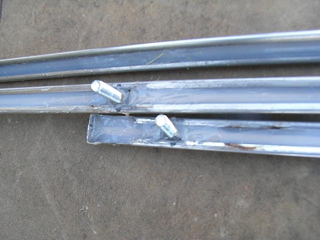

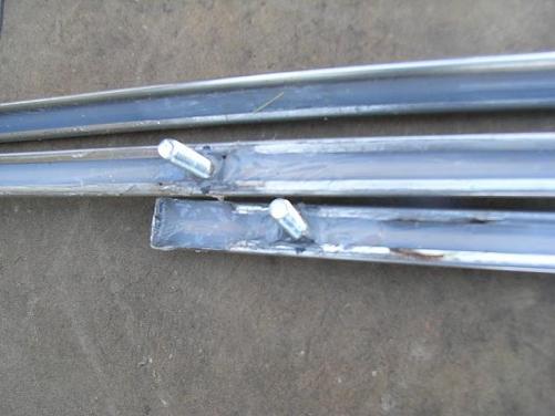

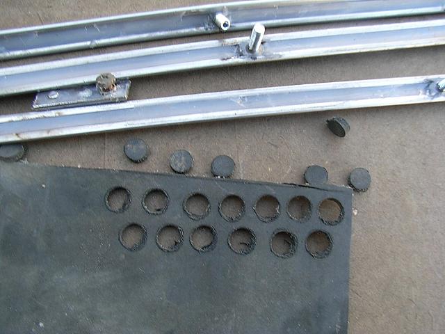

Thanks Stu i hope you like how it is coming along i just finished prepping the stainless trims to put on,RareSpares wanted $10 for 4 clips total $70 so i got some 3sixteen gutter bolts slid them into place held them there with a bit of bluetac then mixed up some PermaWeld,filled around each bolt let it dry then filled the whole back of the trim with silicone so hopfully this should stop any crap building up behind the trim and rusting; anyway all going well tomorow they will be fitted so we will get some more pics up for you all to enjoy(project cars are they ever finished) :yes:

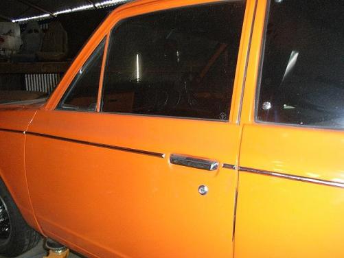

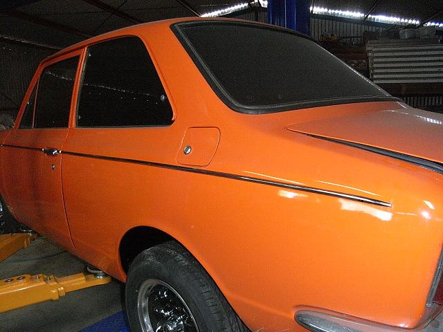

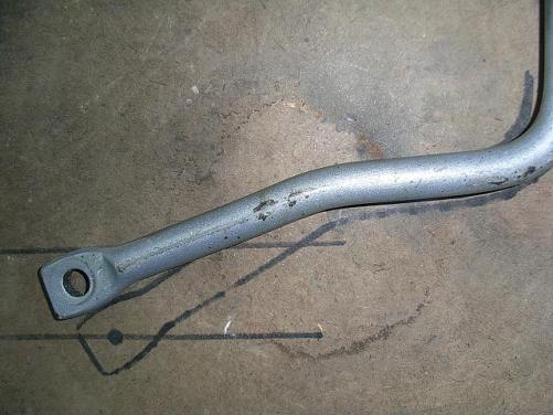

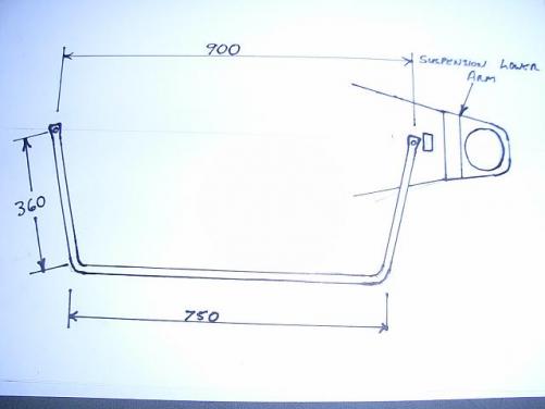

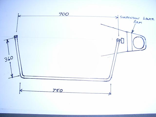

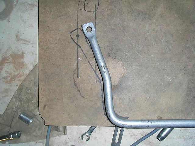

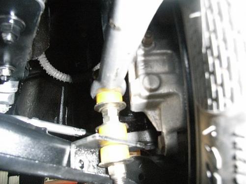

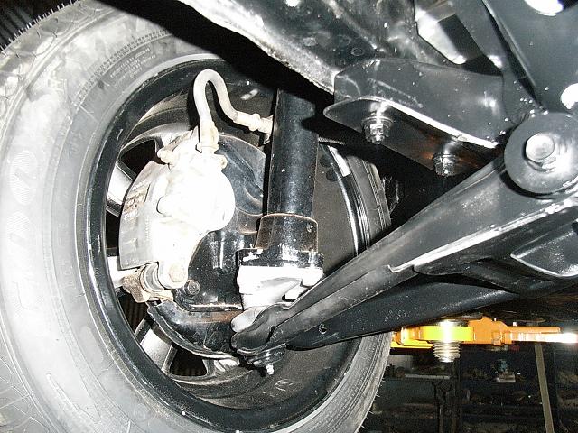

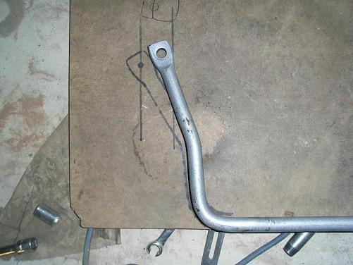

Hi there all had a bit a play with Thomas sway bar today and managed to modify it to fit without fouling on the disc brakes by putting it in the press and changing the angle(photos show how much)i also have drawn a picture of what i reacon would be a better design so if any one knows the people from Whiteline it may worth someone having a look(tell me what you think)i have also pre drilled all the side trims just need to pull the inside door & side trims of so i can to all the bolts any way i have put some more photos up for you all to enjoy.
Cheers:-Stuart.
Pictures 5&6 are on full lock.

So glad you have put the trims back on. Looking awesome.
Sway bar looks to goods, let us know how it goes after some spirited driving :)

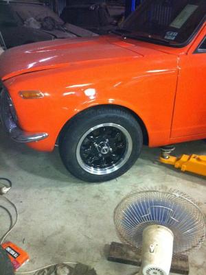

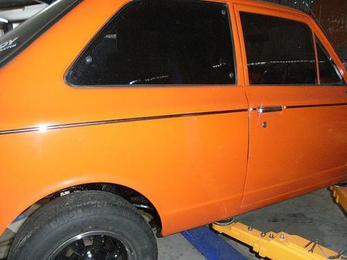

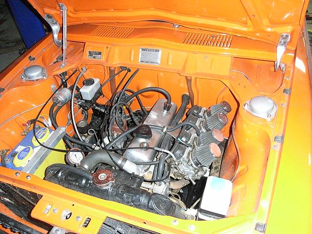

Hi there everyone havent posted for a while so i thought i would bring you all up to date. We finally got the little rolla engineered on Wensday :yes: (4k to5k motor/coil over front end/gear box cross member/disc brake rear end/widend wheel track/collapsible steering column/retractable front seat belts/14x6" superlite rims/front tyres 175-65-14 rear tyres 185-65-14) i had removed my modified front cross member but i took it down for him to have alook and tell me what he thought he said go home and put it back on as he could not see a problem with it :hail: (bloody great)but won't be back on for Hanging Rock Car Show.Got the road worthy done and yellow sticker of the windscreen and now finally back on the road ;).Decked all the boot out and carpeted looks great i will get Thomas to put some photos up for you all to enjoy of what i hope is the end of it for a while now :no2: .
Cheers:-Stuart.
