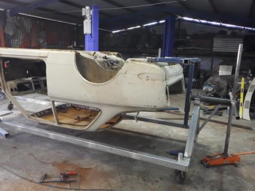

Hi there everyone ! Just a little update ; should have the new body shell going round on the rotisserie tomorrow :2thumbs: and then the fun begins :hmm: as in the above post we are chasing a good KE11 bonnet - boot lid and front stone guard if anyone can help out it would be much appreciated :) . :offtopic: I managed to pick up another project on the weekend something a little different :elvis: a 1974 TA 4 door Holden Torana :huh: it was a gap fill model between the LJ & LH Torana's it was only in production for 11 months with only 11306 sold all up in both 2 & 4 door models , The 2 door came out in both 4 & 6 cylinder models were the four door only came out in what they called there Deluxe model with a 4 cylinder motor :down: but as they have a massive engine bay :yes: and I just happen to have a fresh 308 bolted to a Celica 5 speed box just laying around looking for a new home ;) it may have just found one :P . They are the same body shell as the LJ Torana with a different grille and tail lights so all replacement panels are the same as the LJ :thumbsup: . I'm not sure how long it had been sitting in the paddock for as its last registration was way back in 1989 , all 4 tyres were flat with cracks in the tyres but to our surprize they all pumped up except one which was tubeless but the spare was laying in the paddock half buried and flat but it to pumped up as well :rocknroll: and 3 days latter are all still up :wtf: LOL lucky HAHA . Any way enough about that as it is not a Corolla and we will keep you all updated with the progress of Thomas new little beast ( version 3-4-5 lost count 8/ ) but let me ensure you it is defiantly going to be something a little bit different :2thumbs: . Cheers :- Stuart :wave:

Hi Darren ! yea we are really stoked with the power out put for a NA K motor :rocknroll: . Mid 13 sec car with traction :hmm: we might wait till the new body is done with all the mods and then give it a run down the track as we are currently getting a new STATE OF THE ART 1/4 mile drag strip being built here in Swan Hill :2thumbs: we will keep you all posted . The new shell is now going round on the rotisserie so work can begin ( AGAIN ) I will get Thomas to put some pics up as we know you all like pics , and we are still chasing the above mentioned panels if any one can help out :hail: . Cheers :- Stuart :wave:
Here are a couple of pics of the new project on the rotisserie!!! and the Torana
