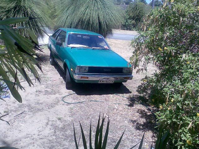

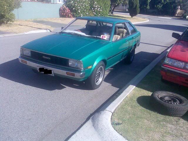

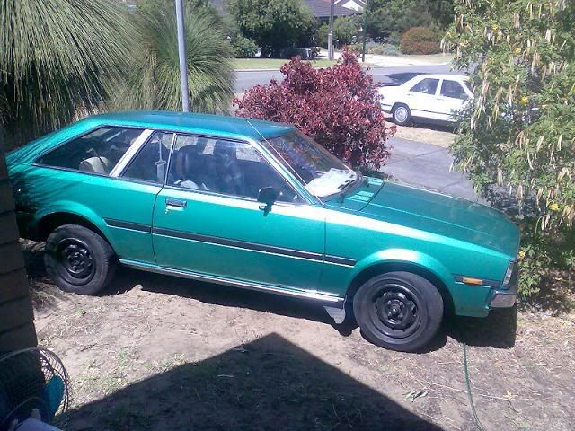

Thought I might as well introduce myself on here with a members ride thread,
have owned the car Since, December 07, and bought it like this, minus the sprayed black rims
few pictures of the interior,exterior and engine

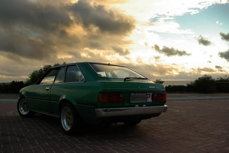

and my favourite picture of the car:
