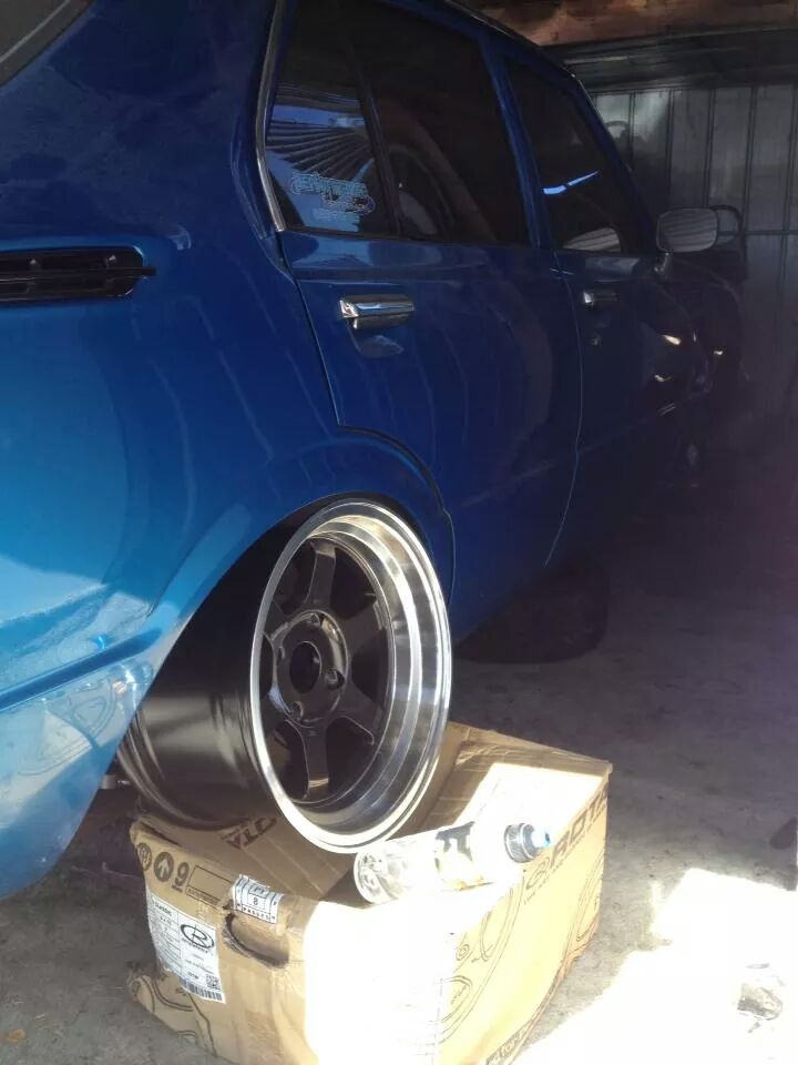

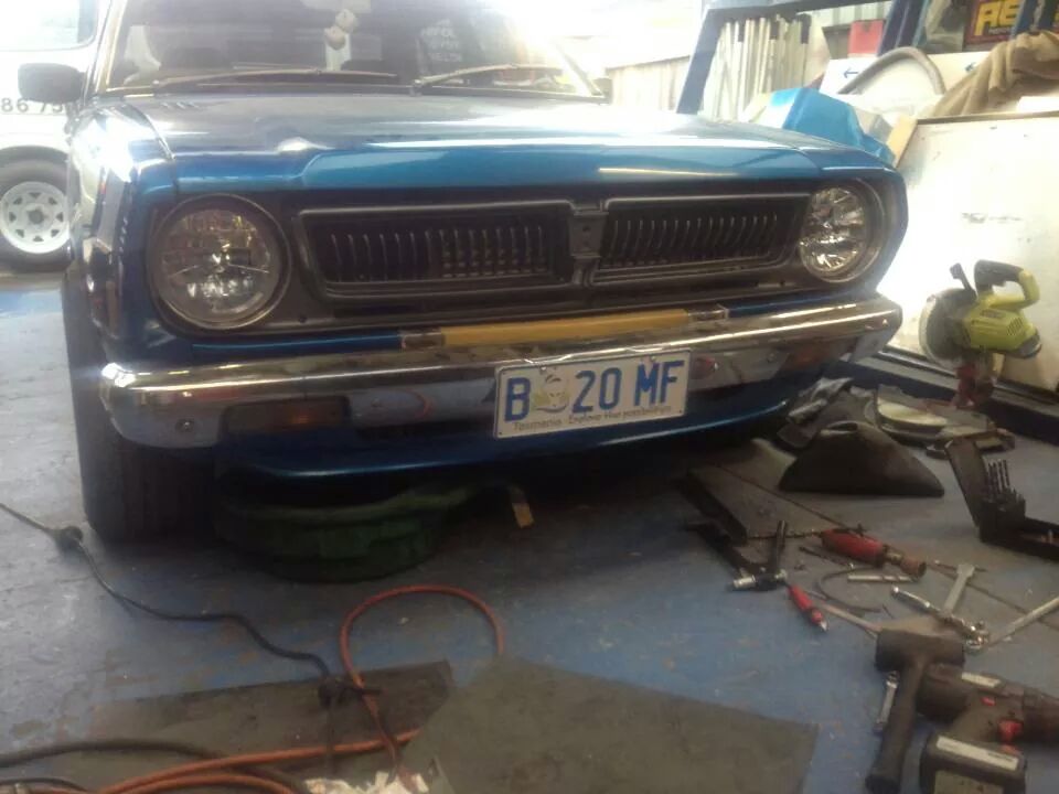

hey guys along time between drinks again but I'm finally making progress with my corolla again consisting of intercooler re fitment new new grille, new pipe work new ecu hopefully coilovers in the front (pending on $$$) more body work and the engine coming out to shave n tidy up the engine bay also new wheels and rear calipers some progress has been made but will put up sneak peek photos soon as more starts happening! watch this space 😃

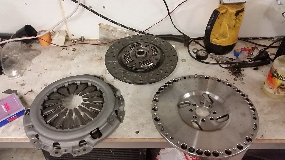

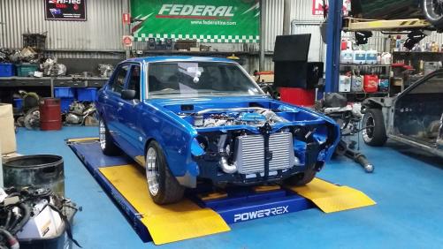

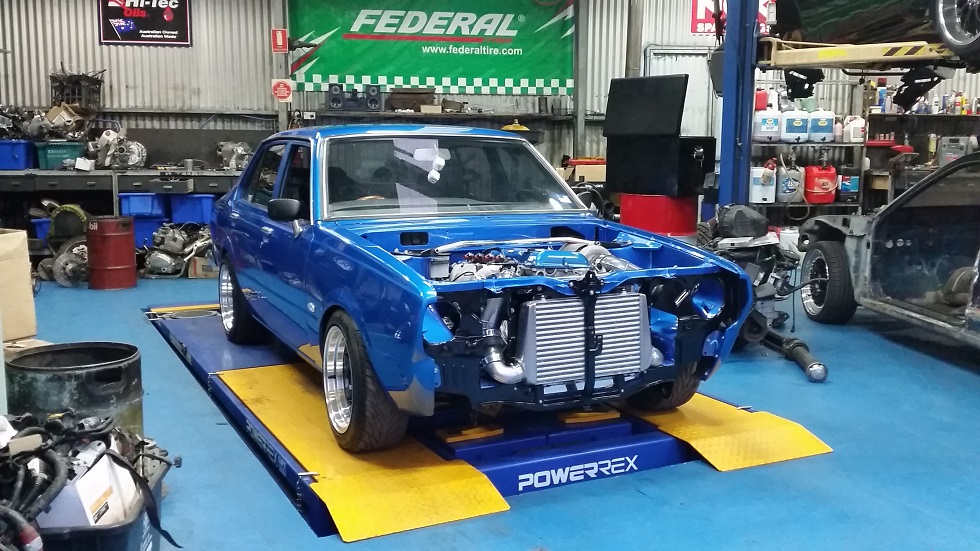

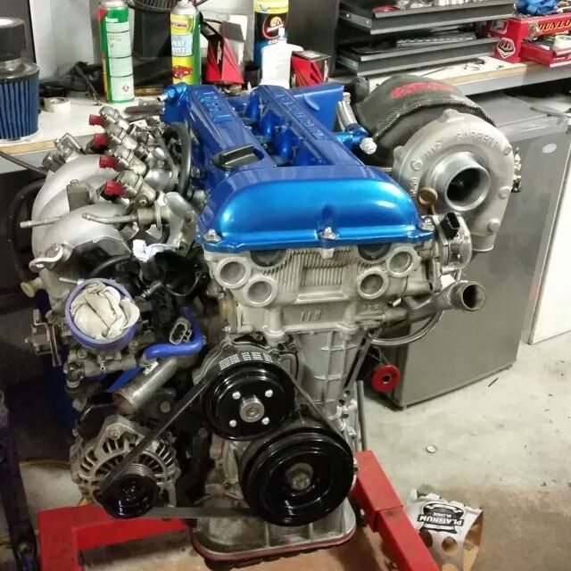

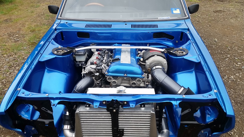

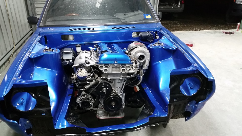

Sorry for the delay but ginally have a few photos of the new engine bay,new forged engine,gt3071r,10 inch clutch, intercooler relocation and new grill and lights, some new wheels and coilovers in the front. More progress in months to come!!Let me know your thoughts cheers

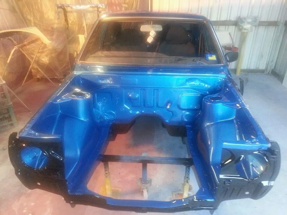

Thanks matt there was sooo many hours in that bay! Could of been more but how far do you go. Love the wheel tubs and towers so smoooth 😊 Full credit to my man brad clark with his small buisness static customs panel and paint down here in tassie. Such a perfectionist
Oh bugger i thought I put one up was in a rush will attatch one now.. yeah so much happier with intercooler hidden 😁

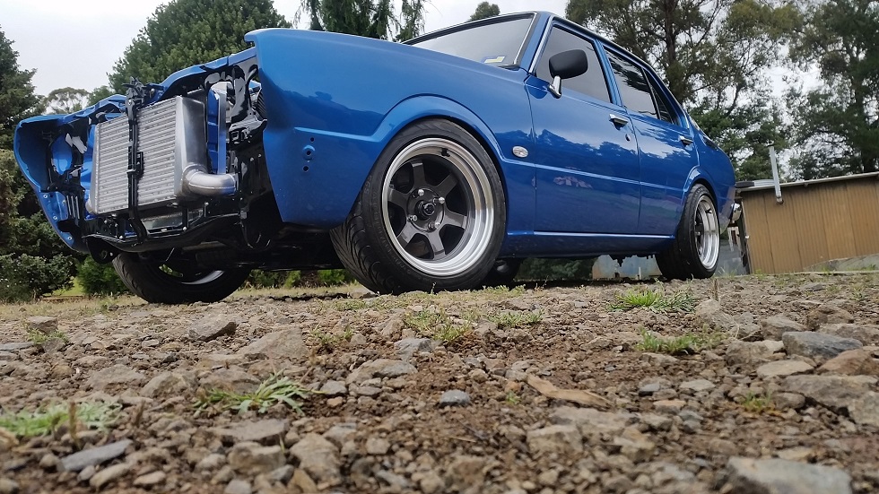

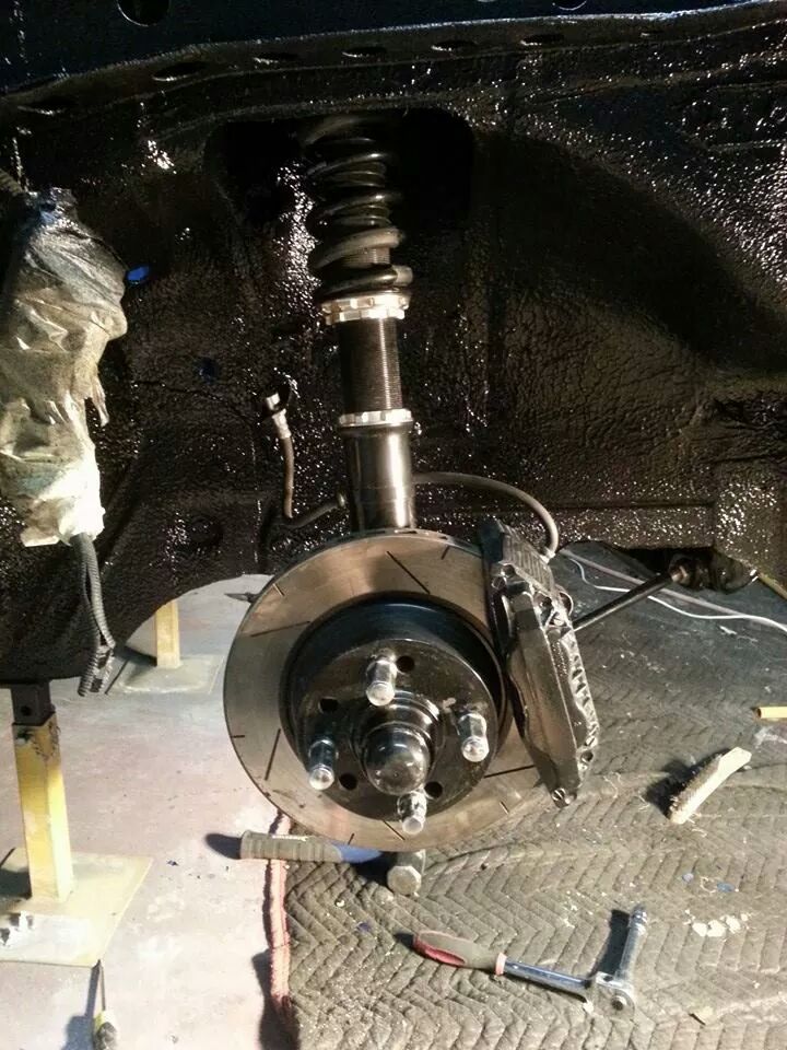

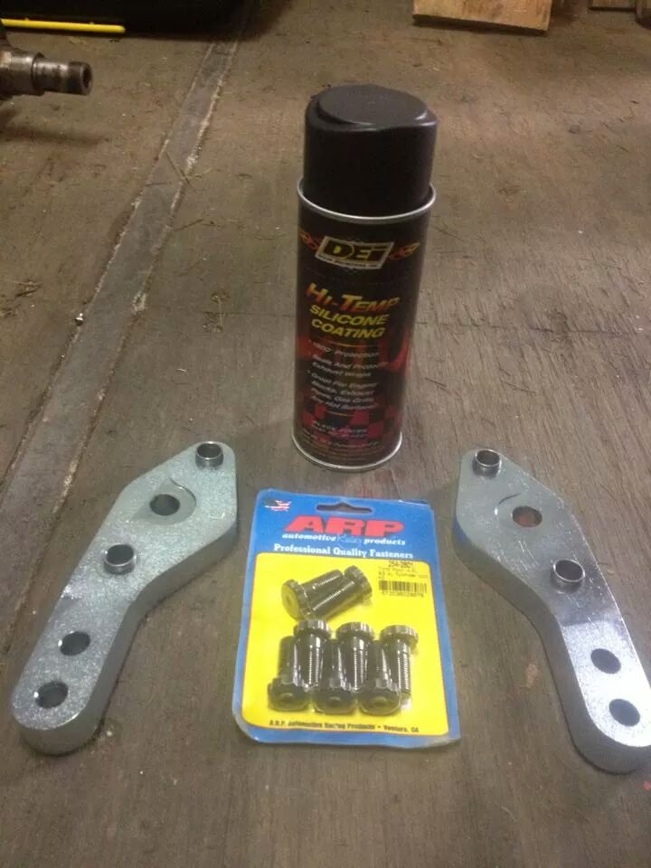

So the brakes are from my old set up which was ra40 struts with a ford 285mm disc with r32 4 pot caliper and all I done was put a weld in bc br gold coilover jn it with 8kg springs I also got a new knuckle ao I can get more lock 😉 ideally id like a different set up as the stub axel is really long and sticks outside the wheel and the cap can't cover it. But I spent to much to change.

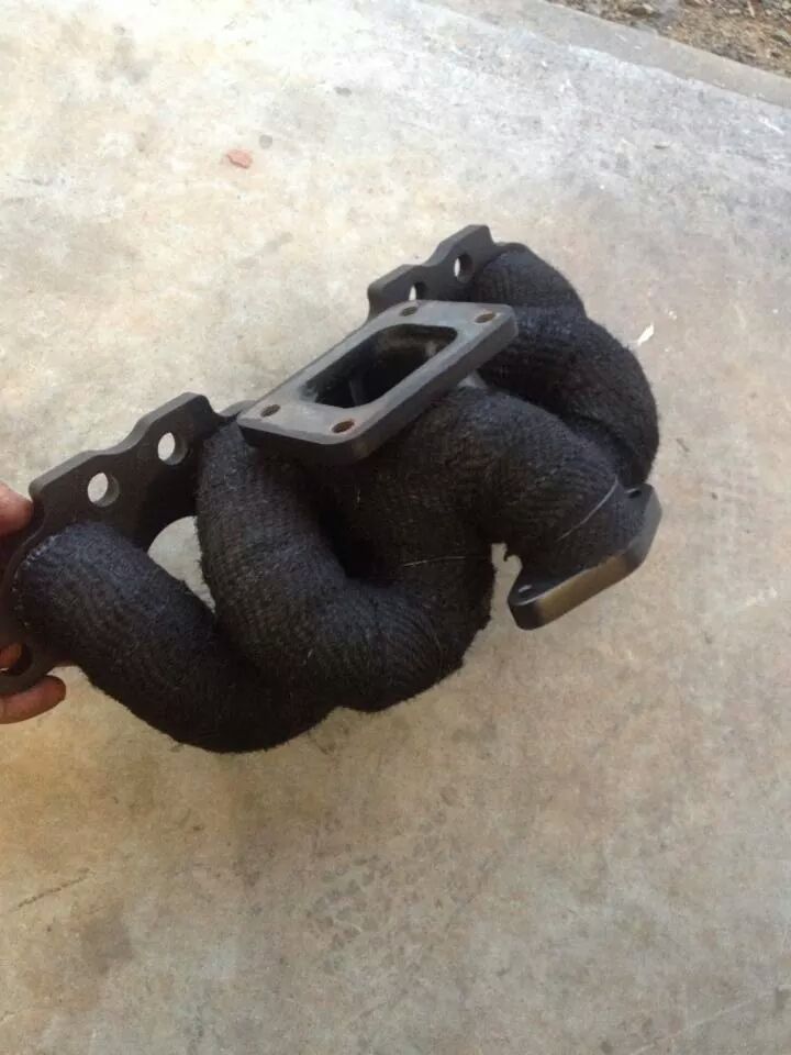

So have my wheels and steam pipe manifold wrapped and sprayed in hi temp silicone spray to resist against oil dirt ect sticking to the heat wrapping and my new knuckles ☺

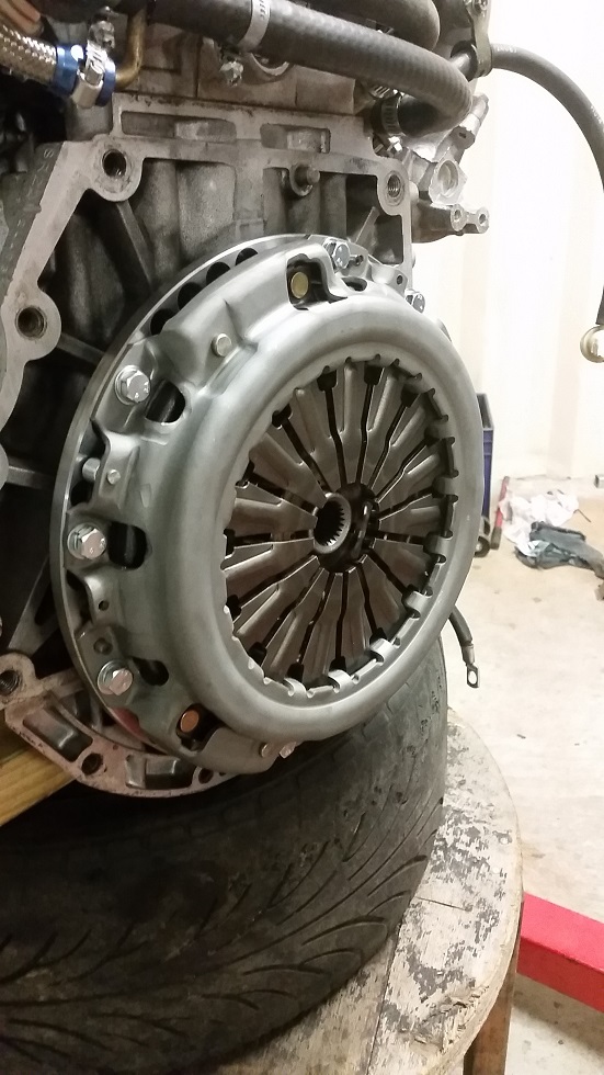

ok so so much progress last 4 weeks! ill let the photos do the talking! from new forged engine, clutch, front coilovers, shaved engine bay ect so exited for the next few weeks with the new ecu getting wired in and alot of other finishing off things its that one step closer :D
