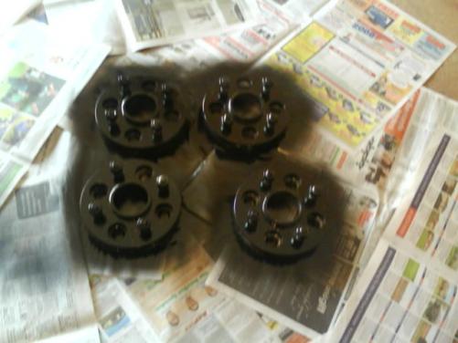

ke30Rolla myles Posted October 10, 2008 Report Posted October 10, 2008 this is what mine look like i painted them black do the old bill don't see them Quote
KE ping it real Posted October 10, 2008 Author Report Posted October 10, 2008 Same as the ones i'm looking at Quote
