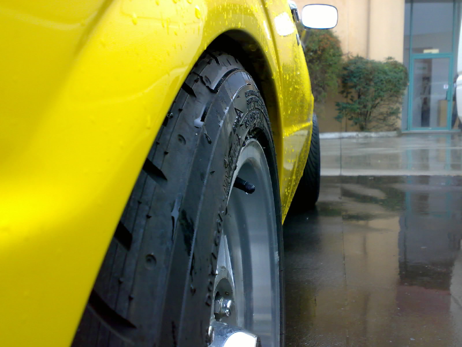

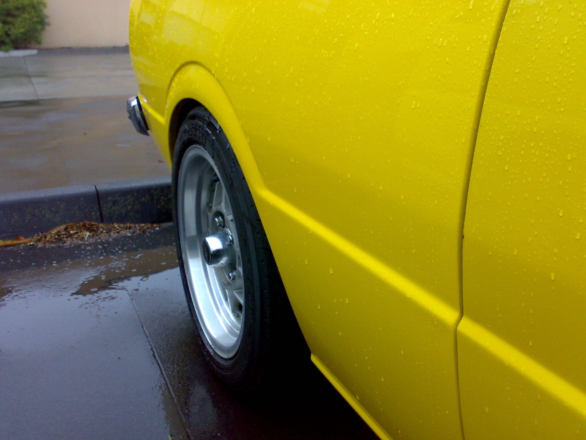

kangaroosa Posted October 24, 2008 Report Posted October 24, 2008 I have a shortened R31 LSD in my KE30 2 door. If you want to do it properly, you have to get it cut and the flange re-welded on. Weld on the new leaf spring mounts. Then get it straightened and heat treated. Can be a costly experience, but thats what you pay for a proper job. I run 15"x7" Globes with +20 or +3 offset (can't remember which is on the front and rear). Anyway, they just sneak inside the gaurds. I also purchased a brand new 4.11:1 ratio and had the lsd rebuilt, so its tight as a drum. On a side note, I found that Commodore pads don't fit in these callipers whereas the brake place told me they would and actually sold me a set of EBC Green Stuff pads..... Maybe other brands vary in thickness and thus will sneak in, but the ebc ones are too thick. Quote
