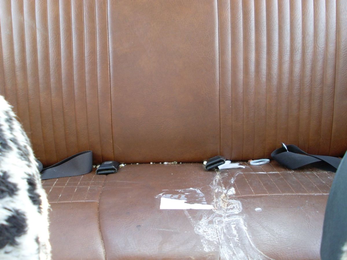

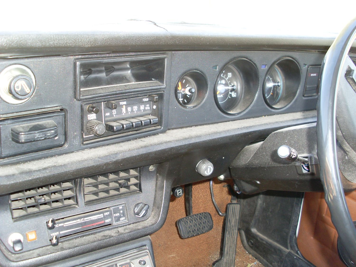

here are some pics of the "new" car and its interior

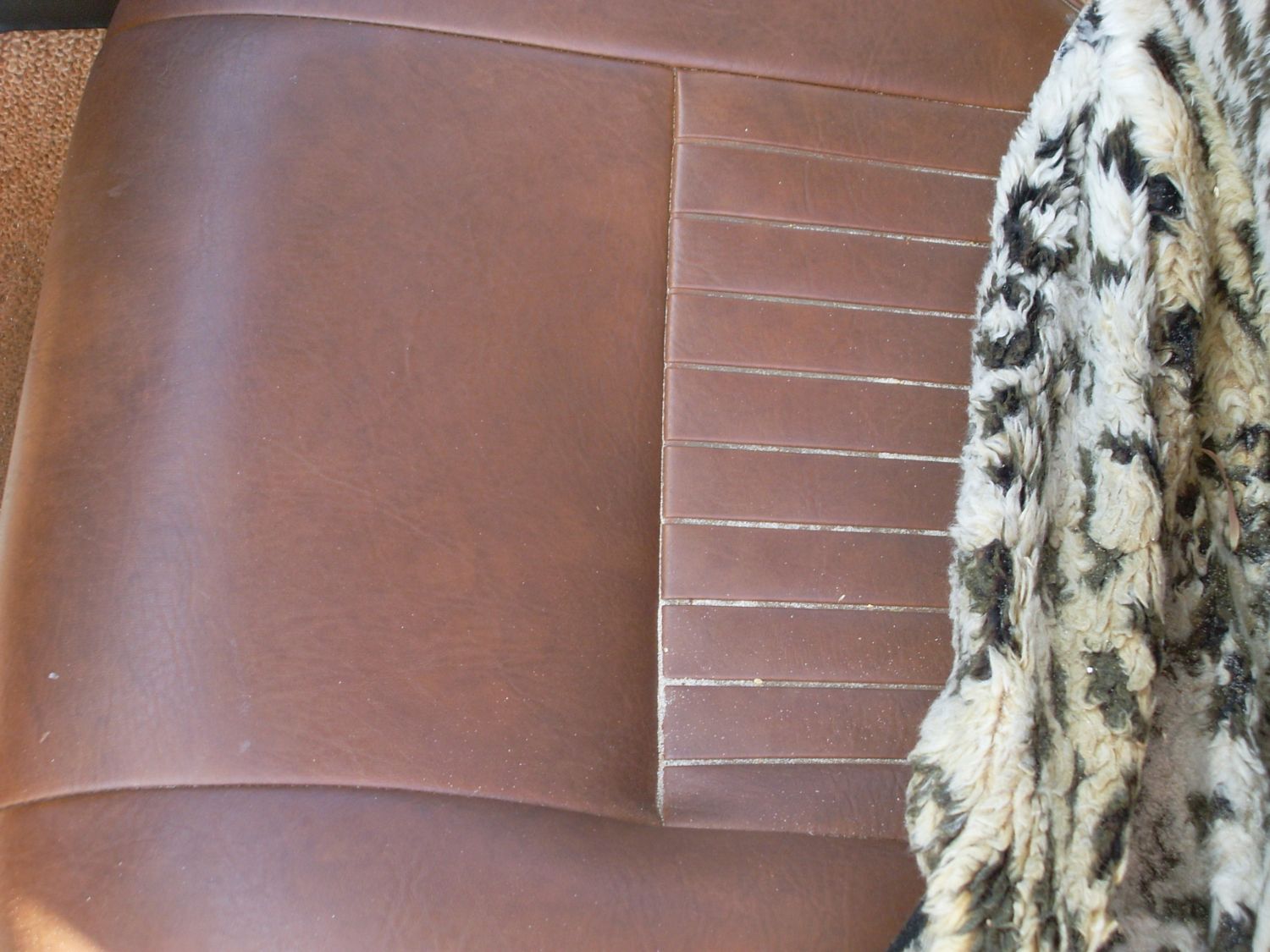

the back seat is just had something spilled on it, should come off

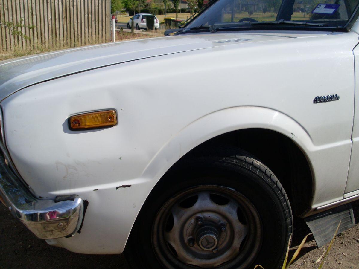

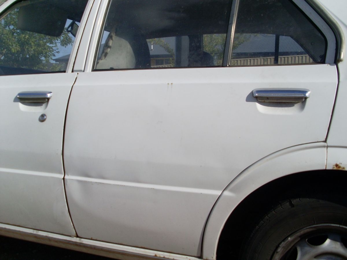

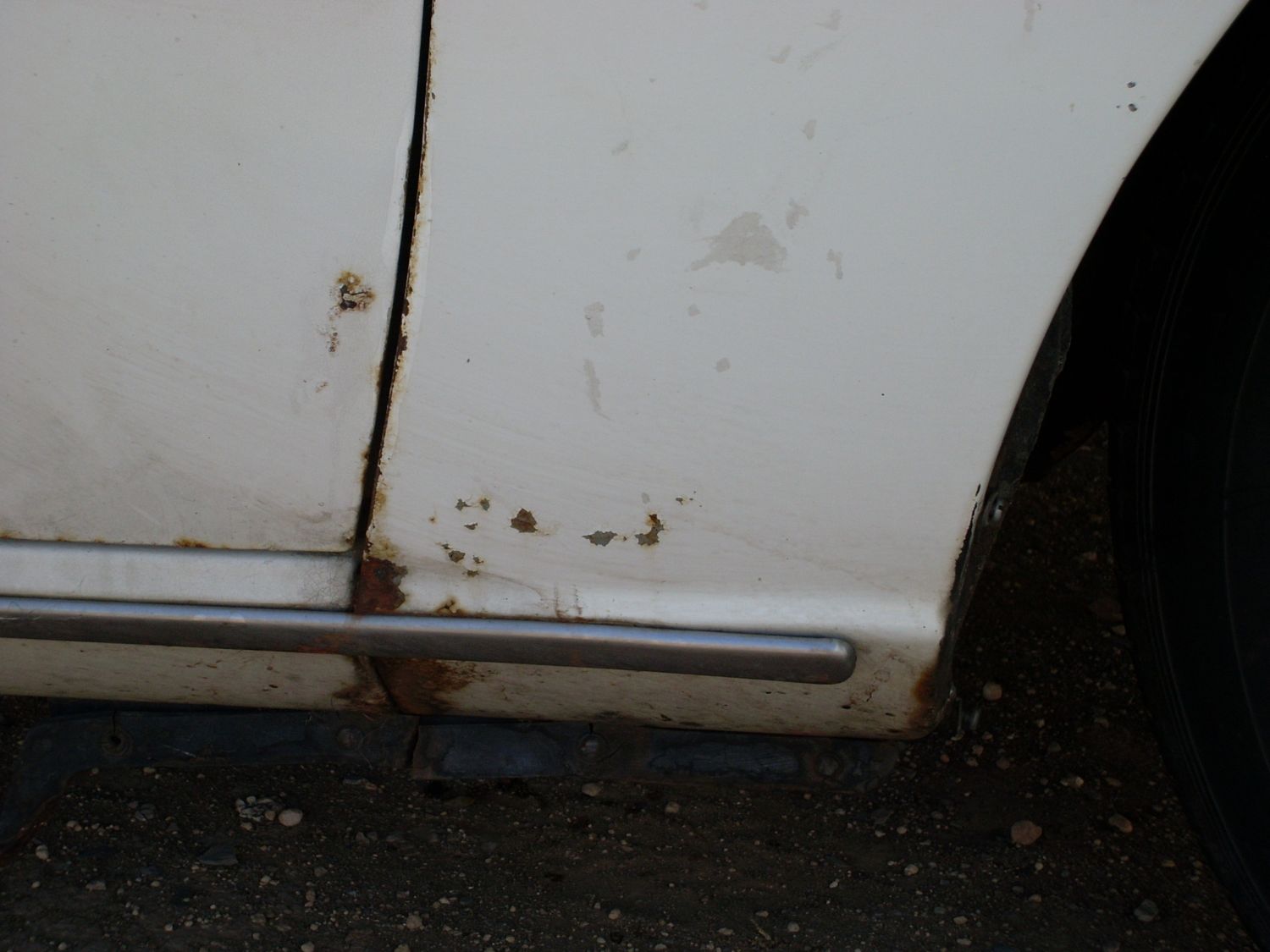

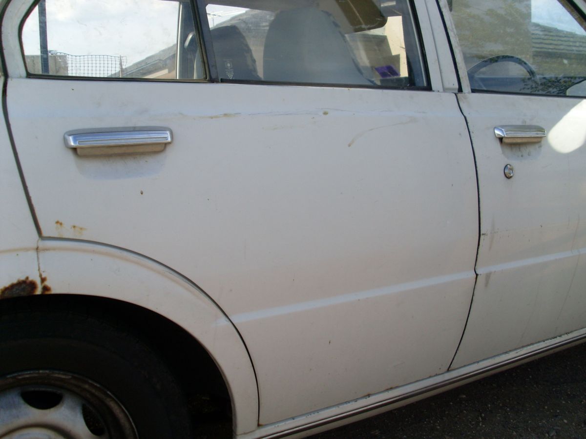

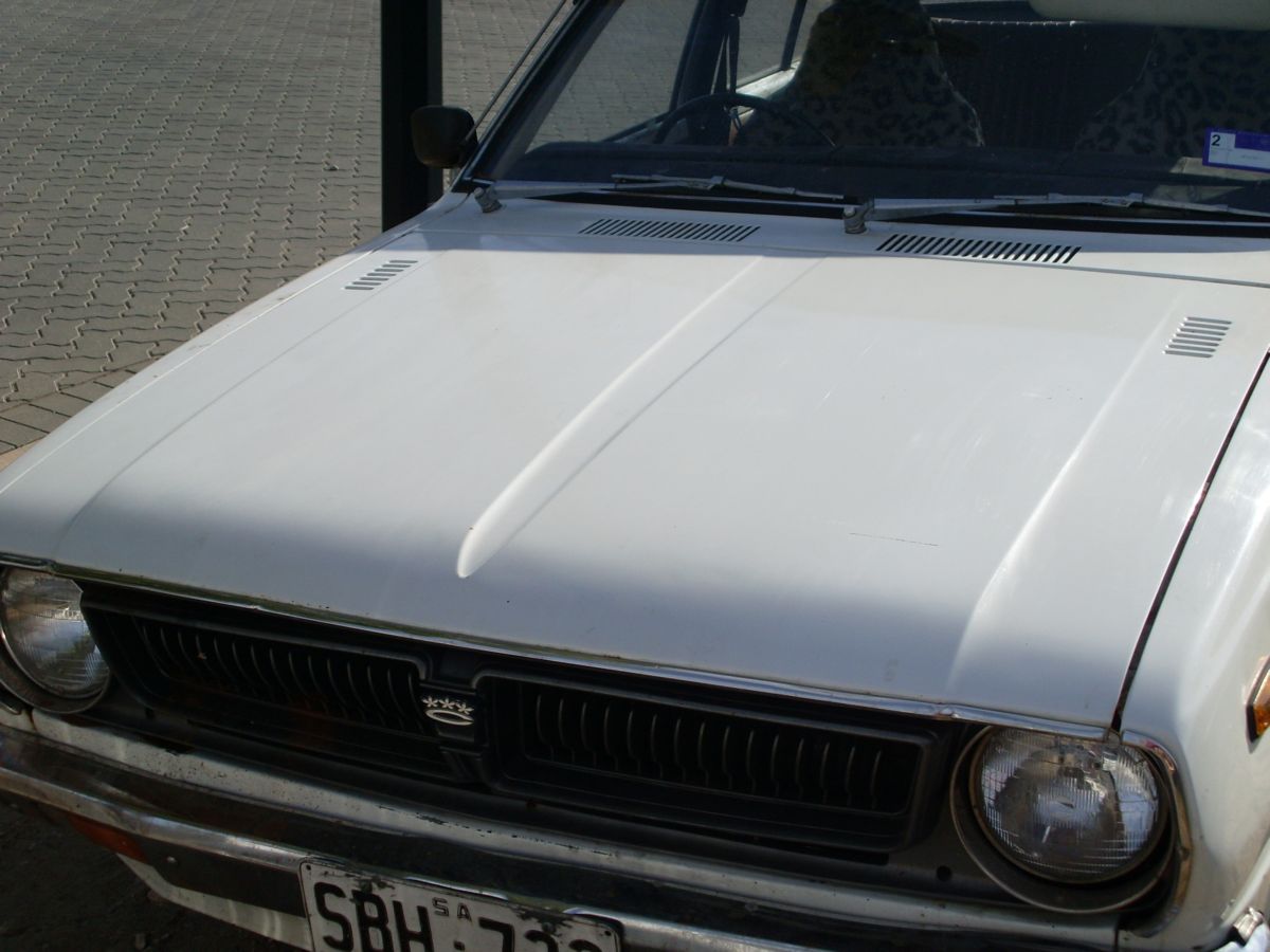

pics of the exterior (it does need a clean, shes a lil dirty)
full resprays aren't as expensive as you might think
just do most of the work yourself and get pro's to paint it!
some fella tookk his kesev into midcoast body works morphettvale and they did all the work apart from rust for $1200
and rust removal is fun :y: and pretty straight foward.
if you don't wanna do it get some chum to!!

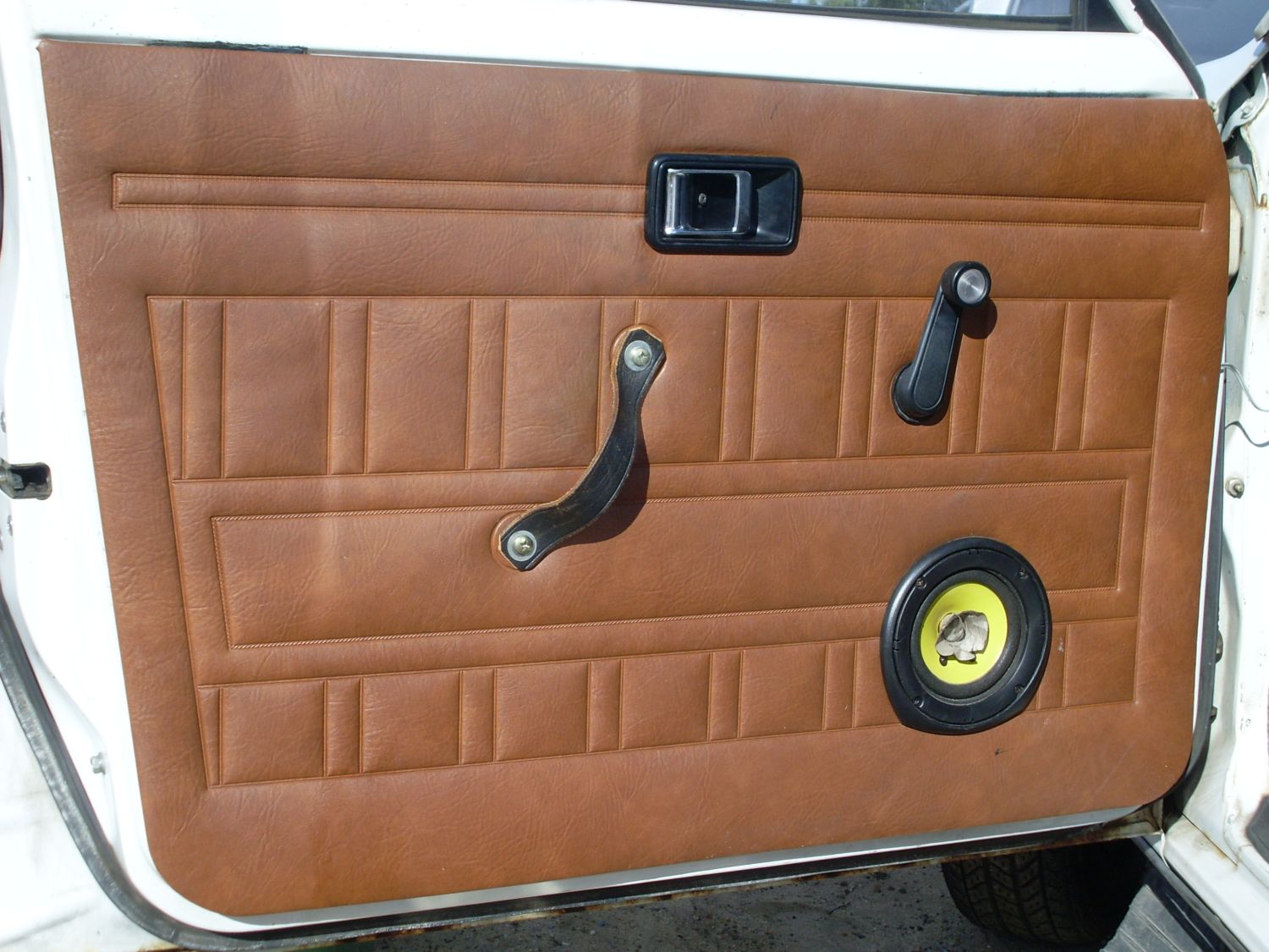

alrighty, picked up some vinyl spray. i decided on black, cconsidering when i get new carpet it will be black so it will all blend nicely.
tried to get the panel of the door but cannot for the life of me pull of the window winder. most cars have a split pin behind the winder (i have done it on some of my other cars) but the winder is flush up against the trim and can't the bugger of. i can hear the backing starting to split so not keen to keep trying, until i know exactly how to get it off.
does anyone know the trick?
There is a tool you can buy to help remove it. Personally I just use a small Allen key, hook it in and wind the winder. It ends up popping off.
As for painting the trims make sure you prep them up correctly otherwise the paint will slowly just chip and flake off.
i used to struggle with screw drivers and stuff to get winders off until i realised you can just get a piece of cloth, slide it behind the winder and wrap it all the way around the back, hold the cloth in place and turn the winder, the cloth snags the clip and it pulls out, and tada winder is off
