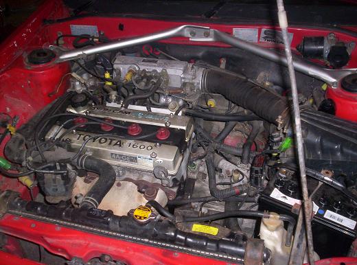

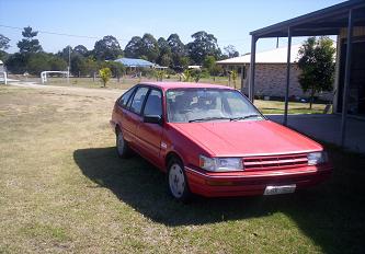

I picked up this baby for $1200. its got great torque @4000rpm - 7500rpm but it needs something done to it so I can take off with the power it has at the higher revs. I just replaced the lhf hud and it handles like a dream now, its also just had a clutch in the last year, the gearbox doesnt go into 2nd if I'm doing over 50kph for some reason and its annoying because it does over 90kph in 2nd before its redlines
anyone have a suggestion? I'm just a newb when it comes to talking about cars but I'm trying to learn.

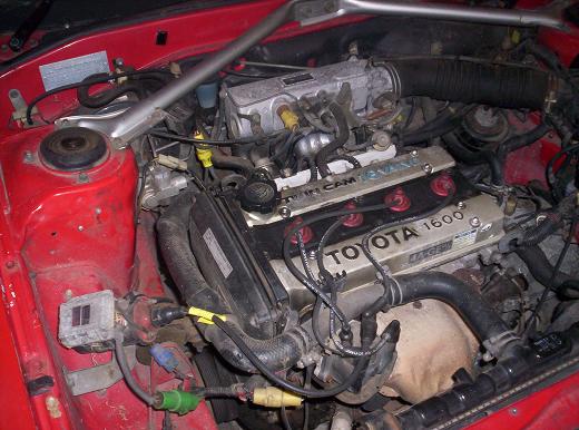

I pulled the motor apart and cleaned it since I took these, I also got pulled over by the department of transport and they gave it a green ticket, which is good apparantly because they let me go

The engine really is much cleaner than that now, I didnt realise how much better it is now until I saw those pics lol
the 4age's have never had great torquue down low, and for the matter not a great deal up top either, hence the torqueless wonder monika they have, but still a great motor and they sound porn when on song above 5000rpm :cool: even more so with ITB's
but anyways nice score for the price, I'm not so keen on the ae82's but everyone has their preference.

Most corollas with c52 gearboxes have dramas in second after a few years of (ab)use . Yours sounds pretty bad. If can obtain one from the wreckers or ebay, thats come out of an ae101 generation with a 7afe, it would probably be cheaper then getting yours rebuilt. Most ones bolted to 4ages would have copped a flogging.
