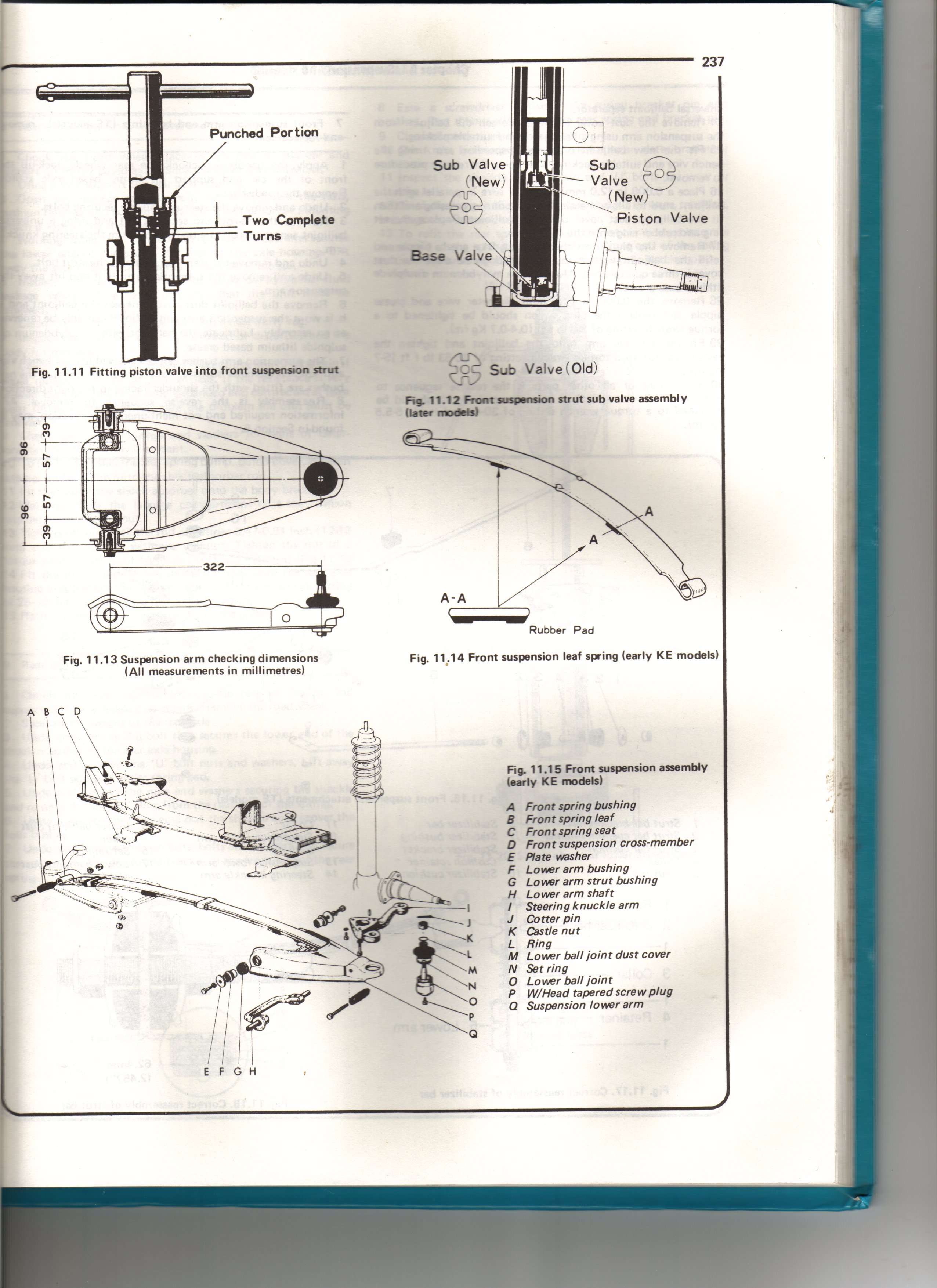

It is a cheaper design as less other suspension/handling components are needed, but it does affect performance handling.
Basically when one side moves (bumps), the other is affected in someway. The thin coil springs hold no weight at all so they wont help.
Corvette have used this setup for years but have refined it very well.
Although alot of circuit racing vettes end up going with coilovers.
http://www.supersport.org.mk/Statii/Front%20Suspension.htm
http://www.carbibles.com/suspension_bible.html
http://www.carbibles.com/images/fibreglass_spring.gif

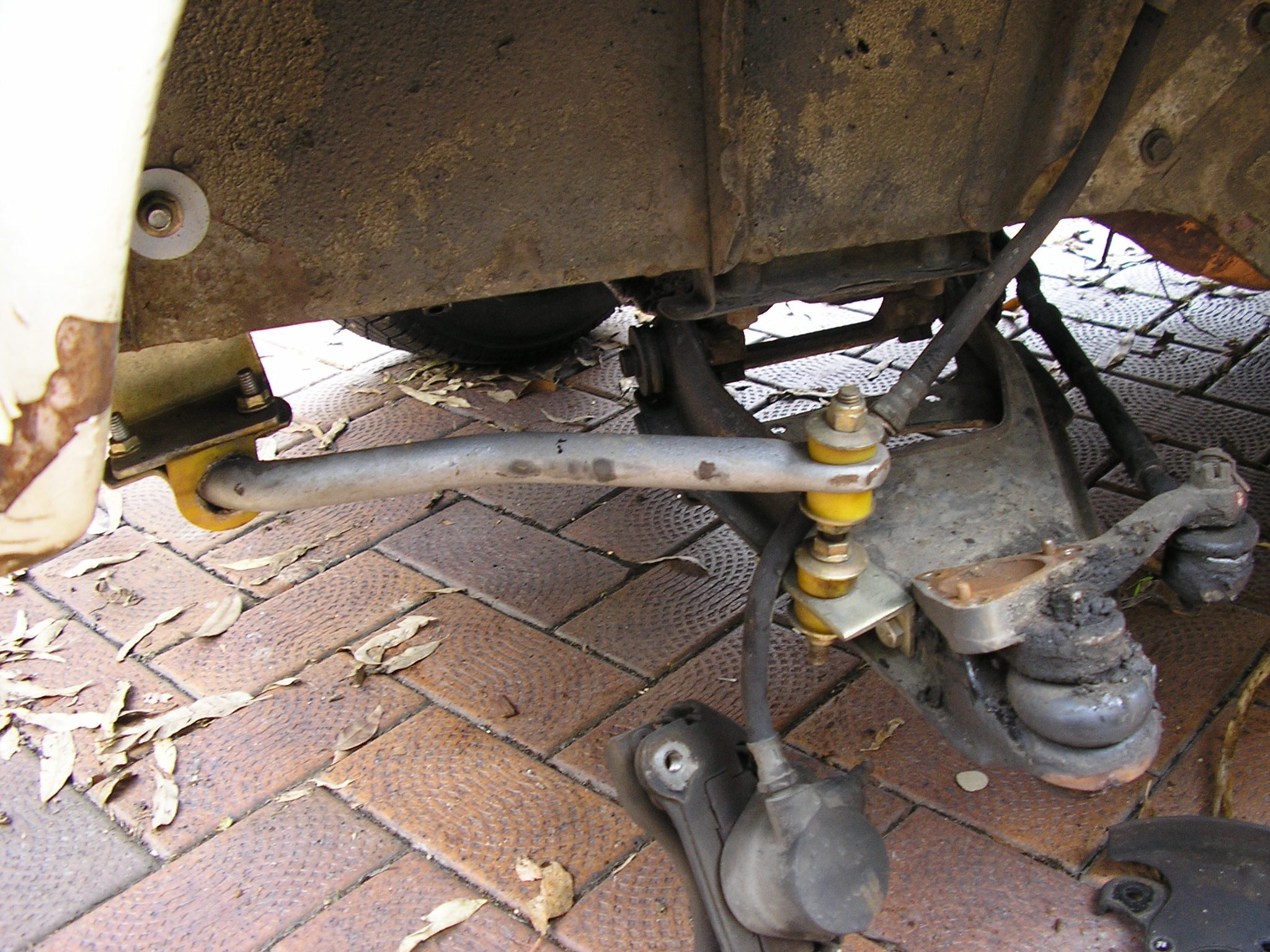

Yes with the whiteline bars there is the issue with the swaybar hitting the calipers, and forcing fluid back to the mastercylinder, requiring you to pump the pedal a few times to regain brakes. I've found replacing pads more often reduces it happening. Also the ke1/2x calipers with the long thin pads are more affected. The jap ke3x calipers with the square pads are least affected. Winding the steering lock bolts out a bit helps.

Having not seen leaf springs since my 1949 Armstrong Siddeley its a bit hard to visualise...

so where does the whiteline swaybar hit the caliper? any photos? and does it only do this on full lock?

I'm still a little bit confuzzled about the whiteline swaybar hitting the brake calipers, surely they couldn't release a suspension item that had a safety issue like that? Anybody have pics?

As for the swaybars hitting the calipers, I found an old pic from my ke16 where you should be able to get the idea. You can see the lighter brown rub marks on the lower side of back the caliper.
