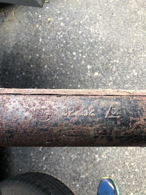

That is a very strangene exhaust doovey. It it bolts on after the muffler wouldn't it stick out the back of the car heaps?
