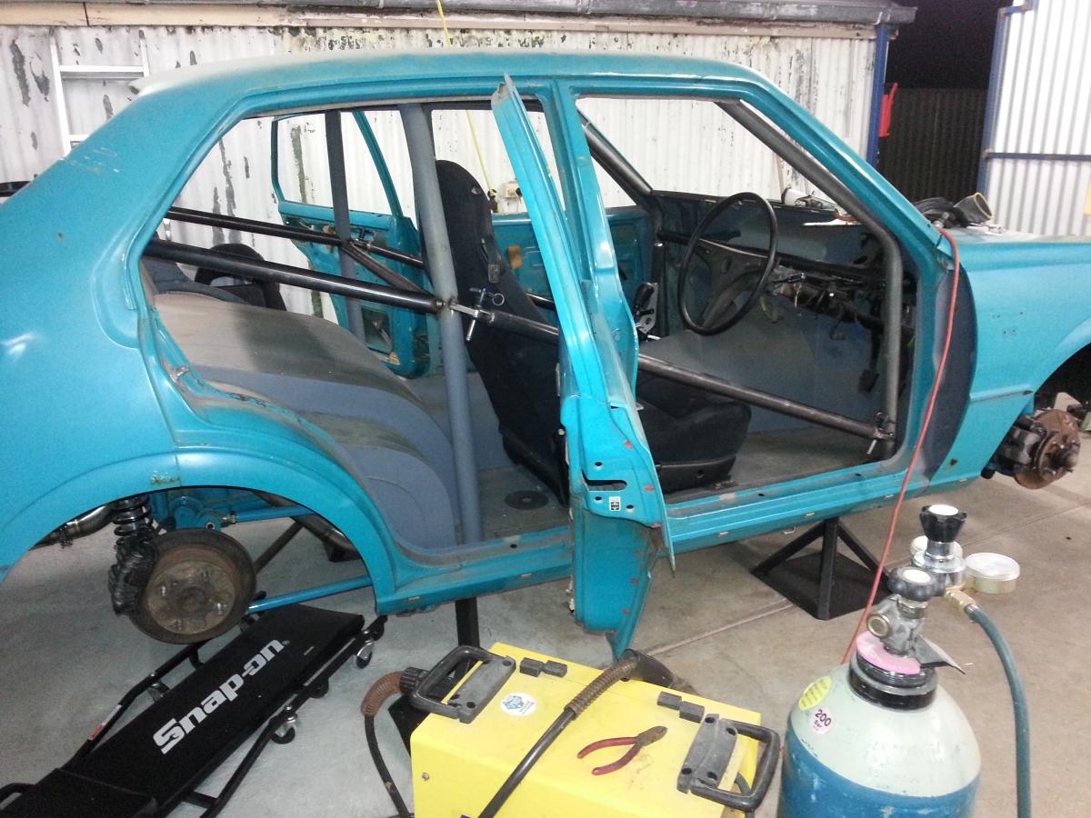

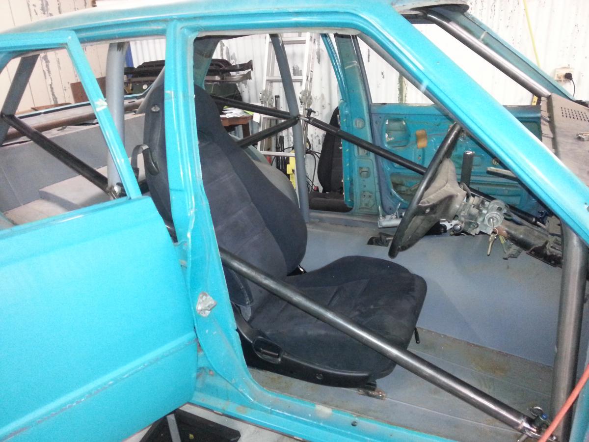

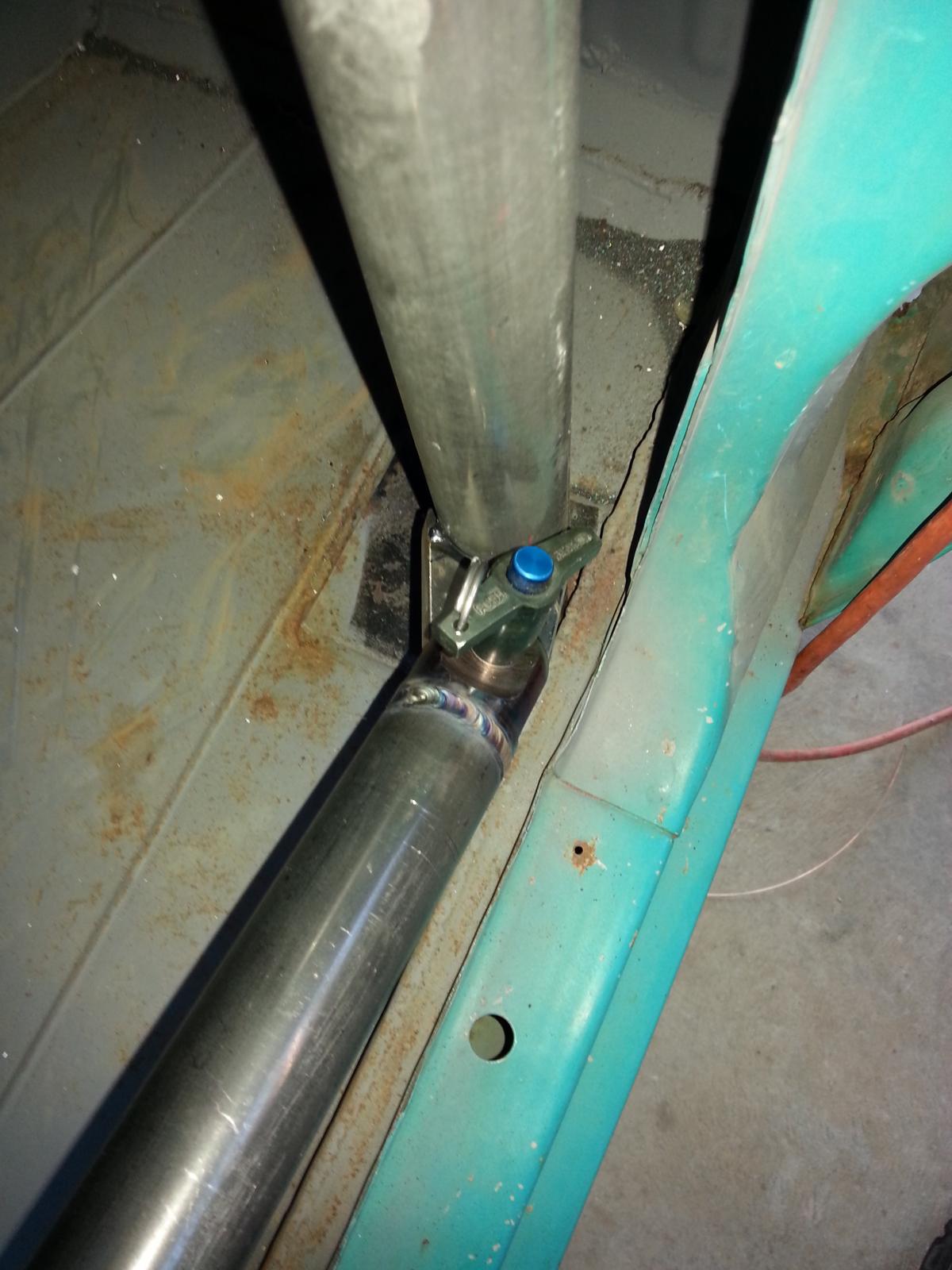

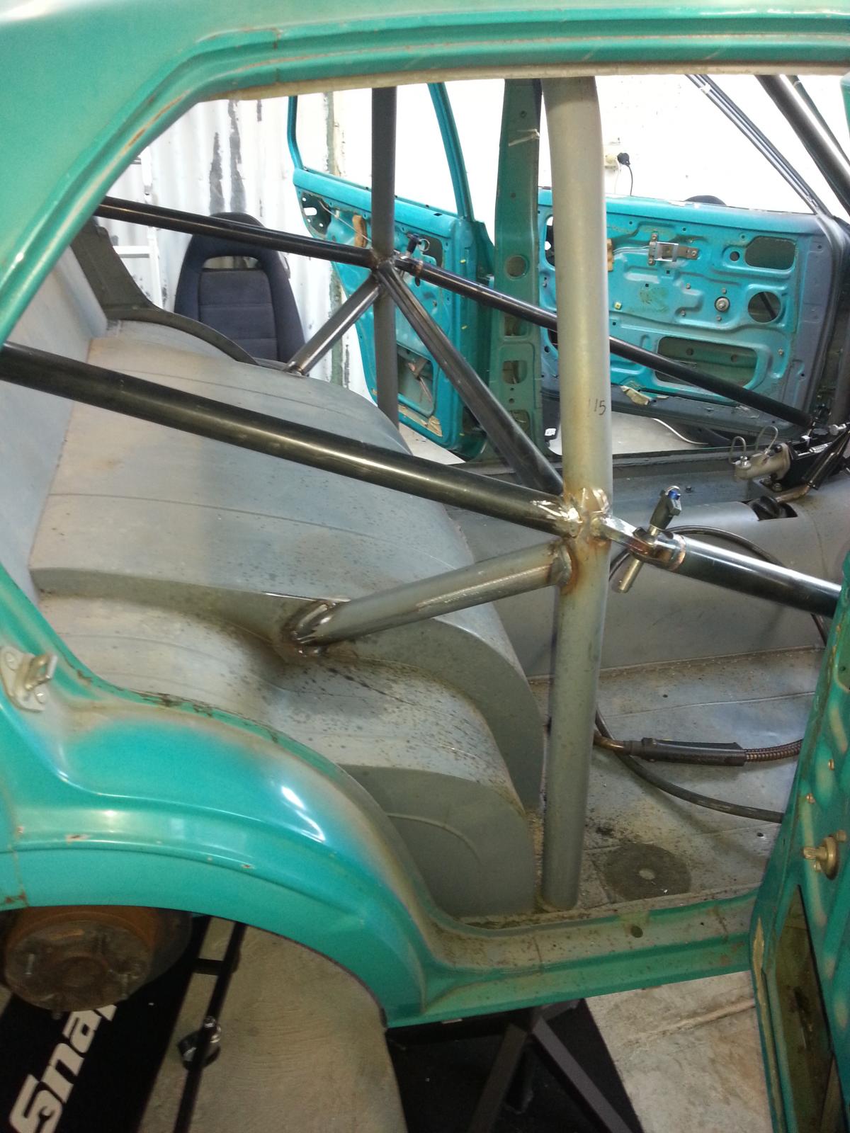

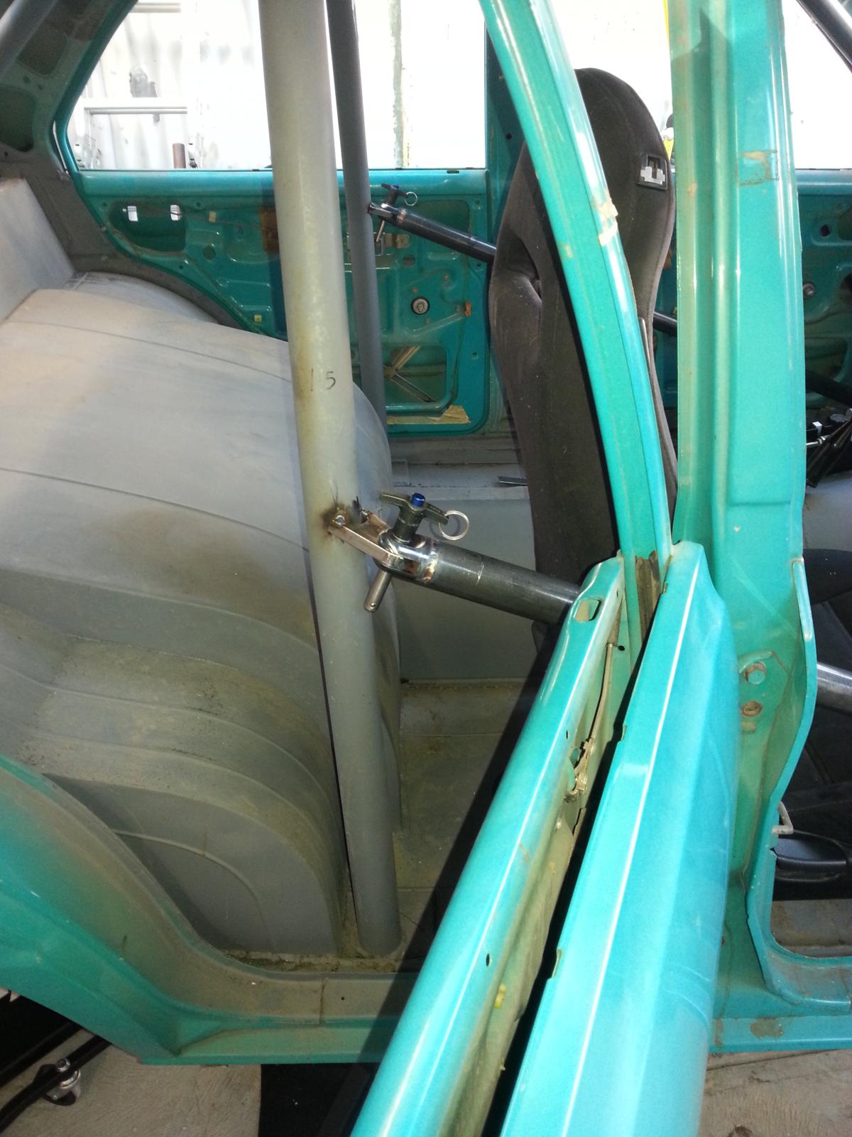

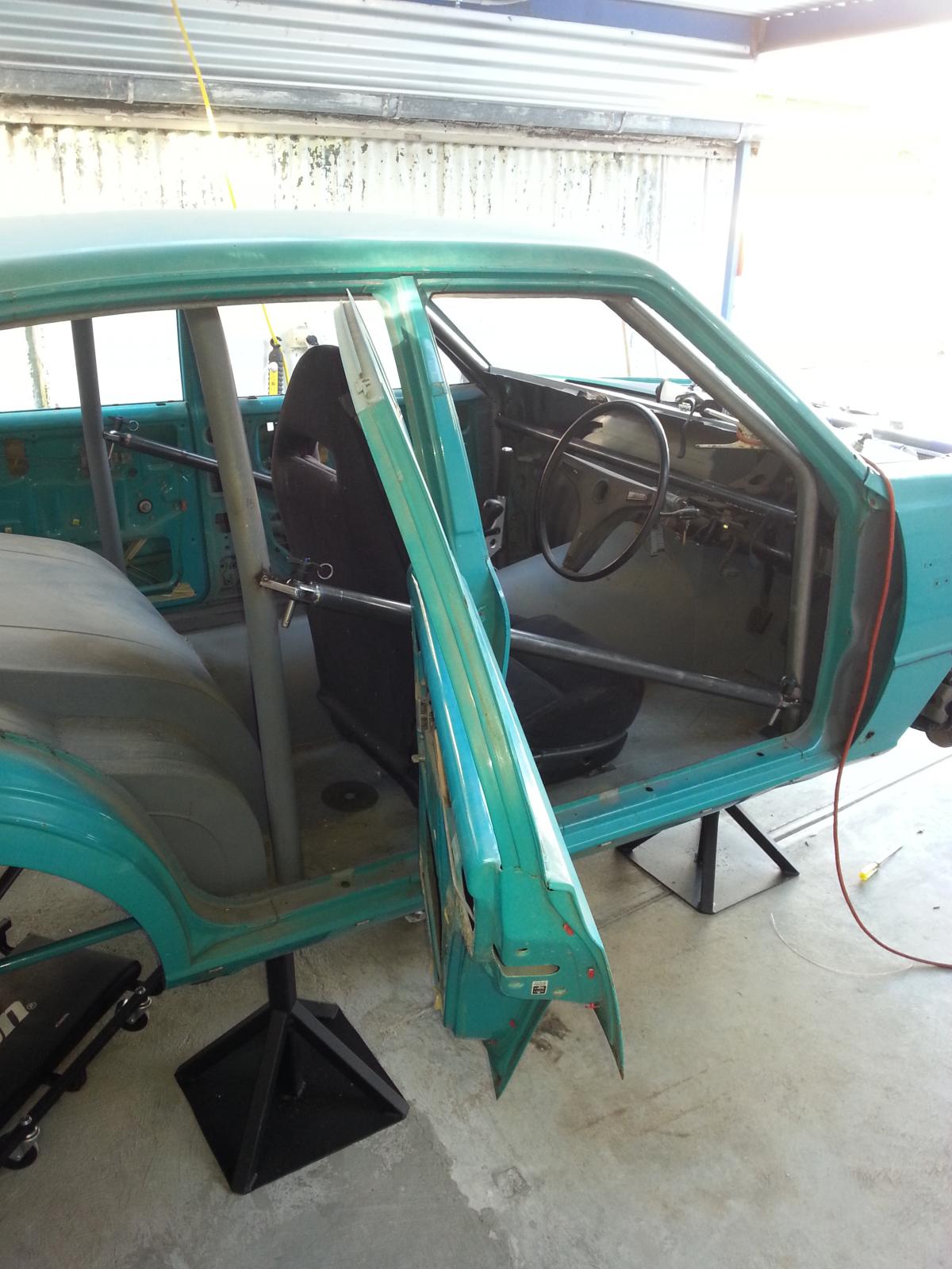

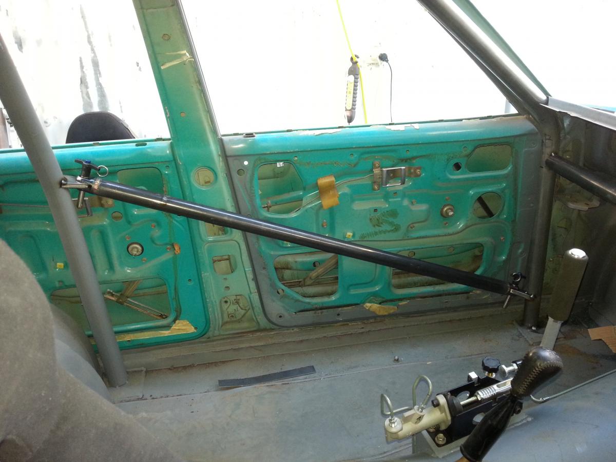

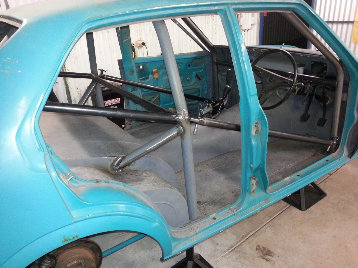

The roll cage is starting to come together just a couple more bits to go :hmm:

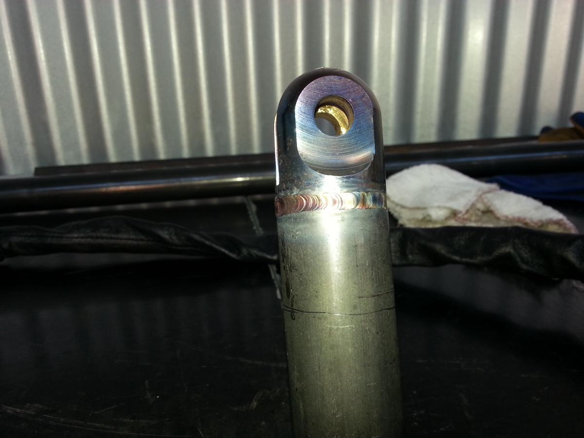

  • well after a few hours of welding the turbo manifold is finished just need to pickle it to clean it up and its ready to go :P:
looking great! bet your can't wait to drive it? love the sheet metal work done!

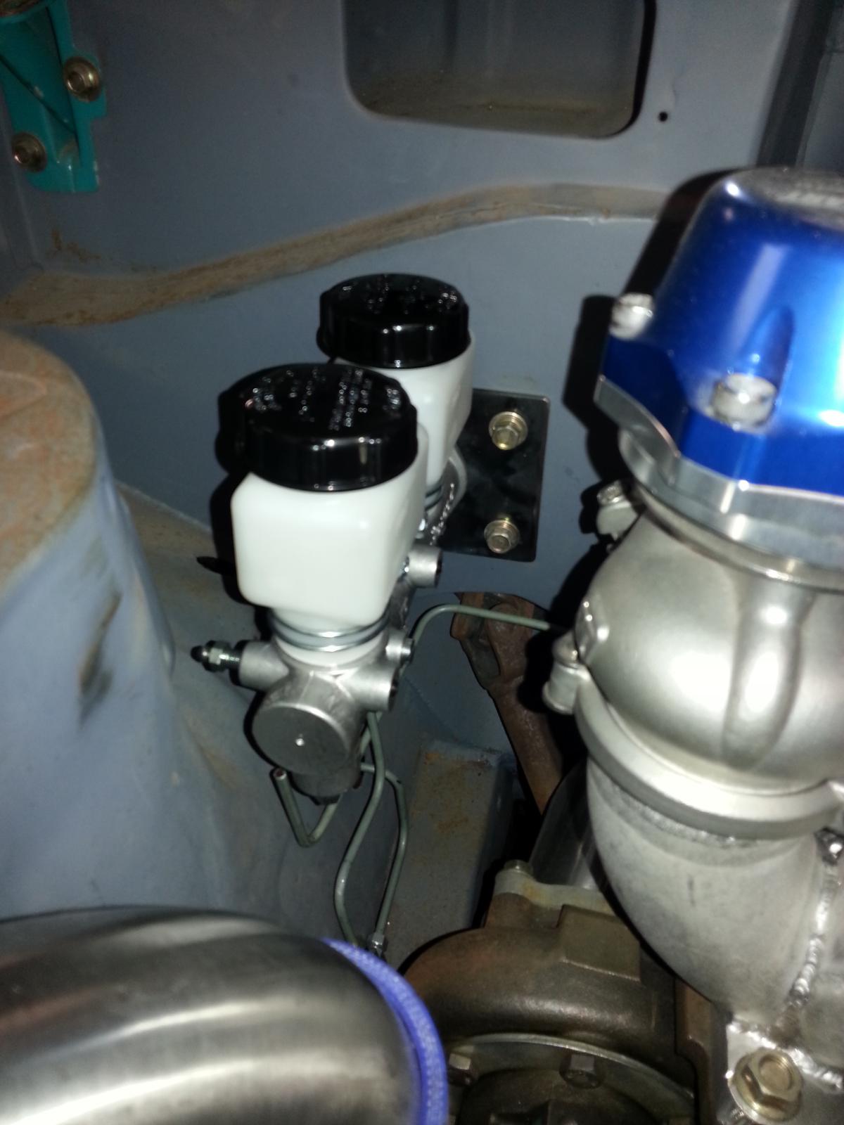

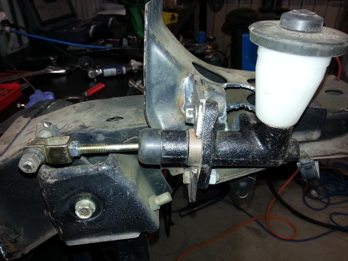

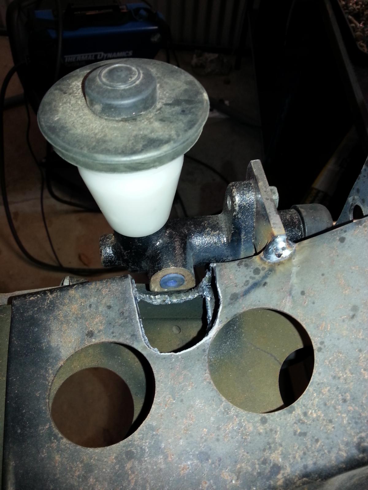

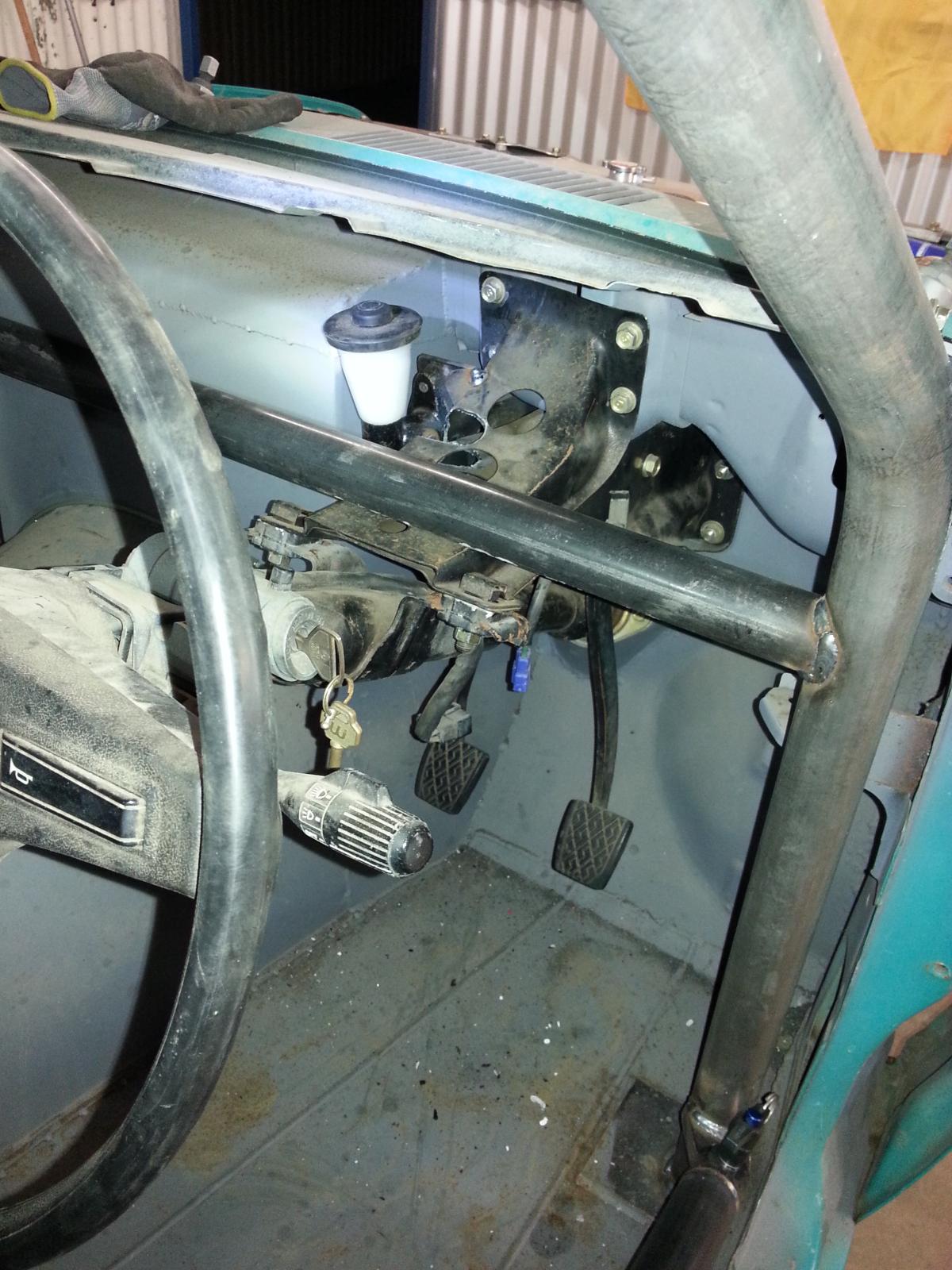

I've put a couple extra bits into the cage clutch and brake master cylinder are both mounted after some stuffing around had to put the clutch master under the dash which caused issues in its self with the lack of room to run the line thank god for my new plasma cutter :lol:

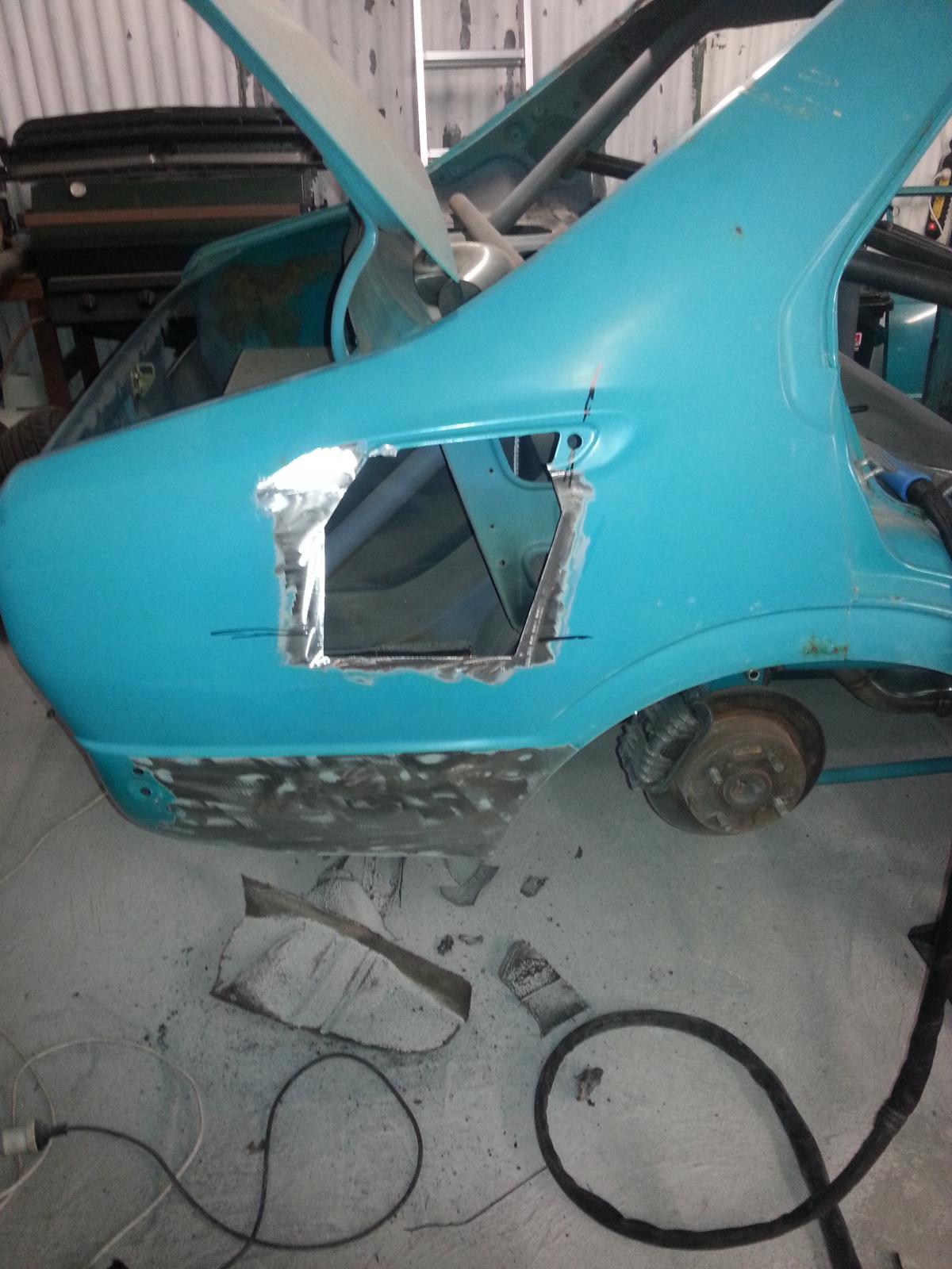

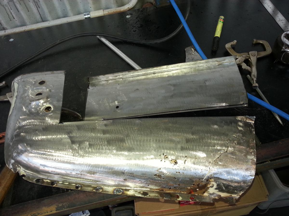

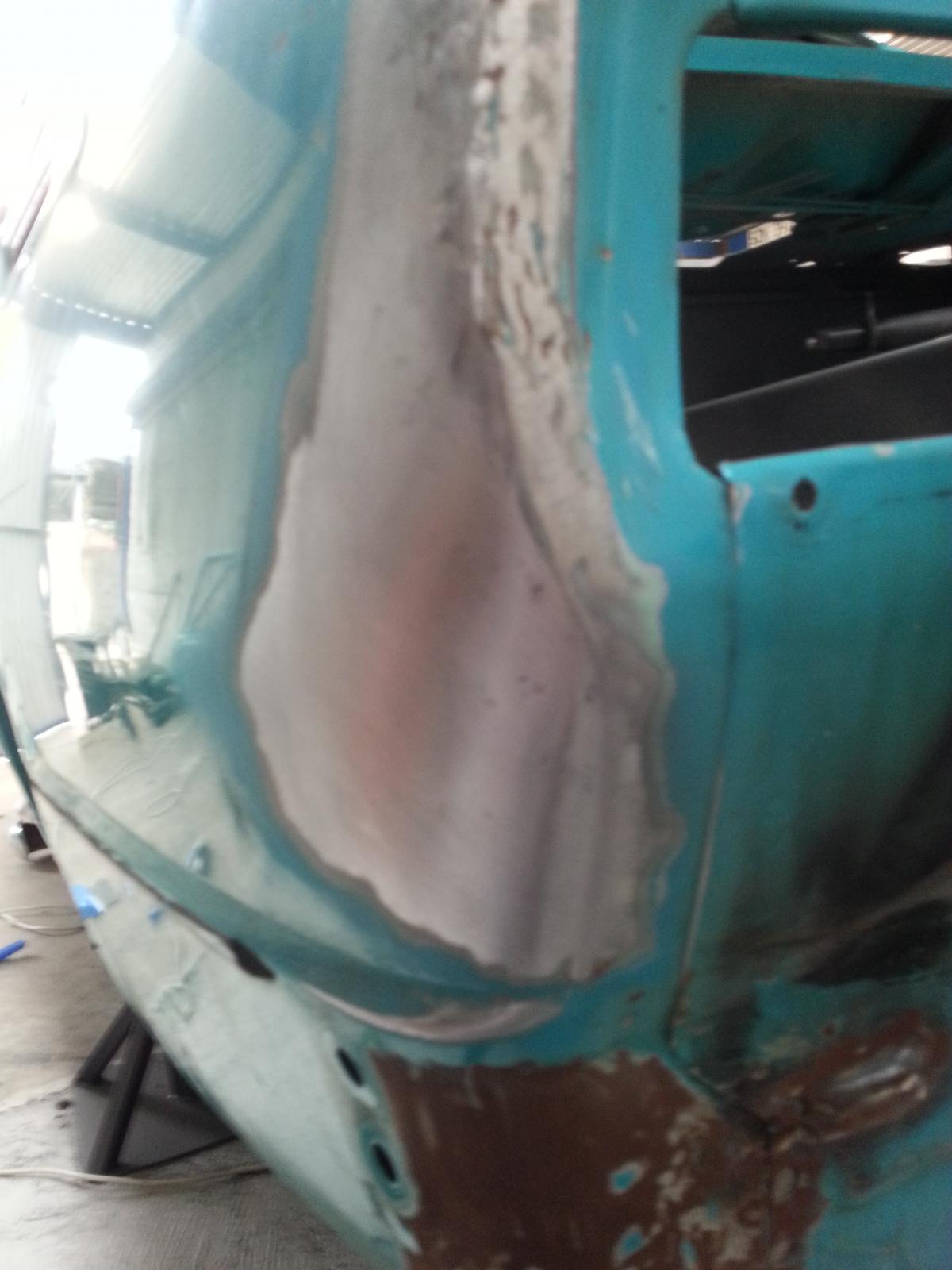

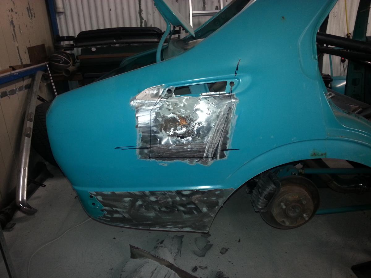

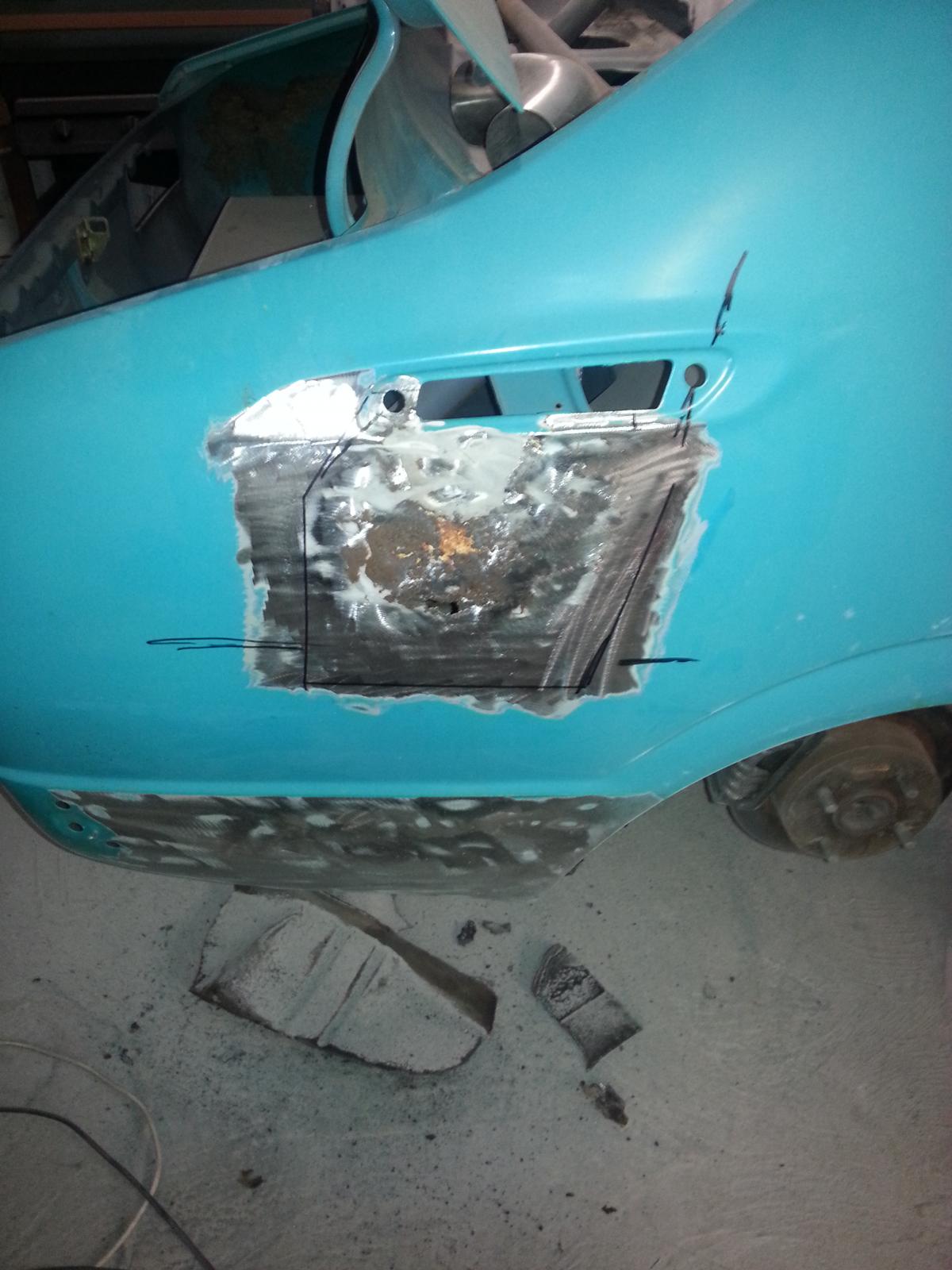

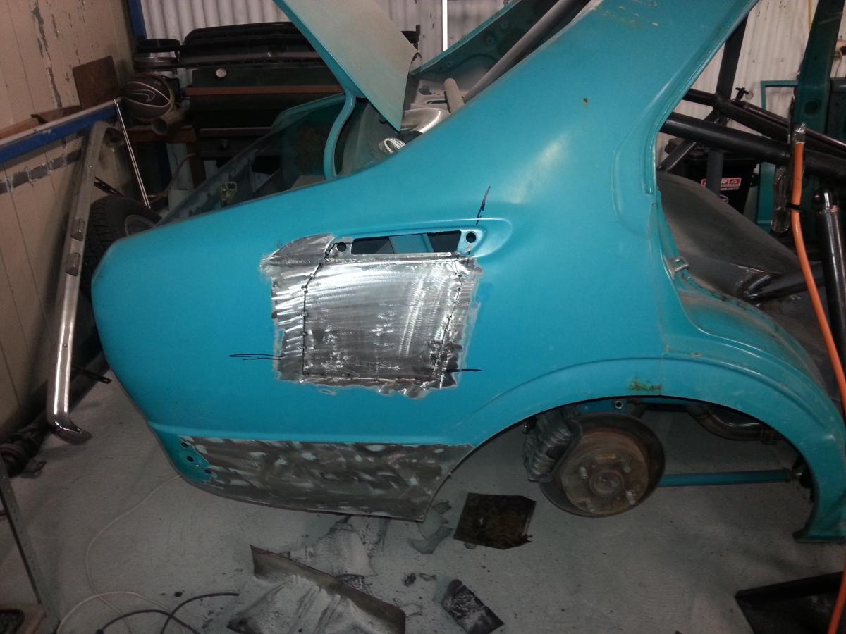

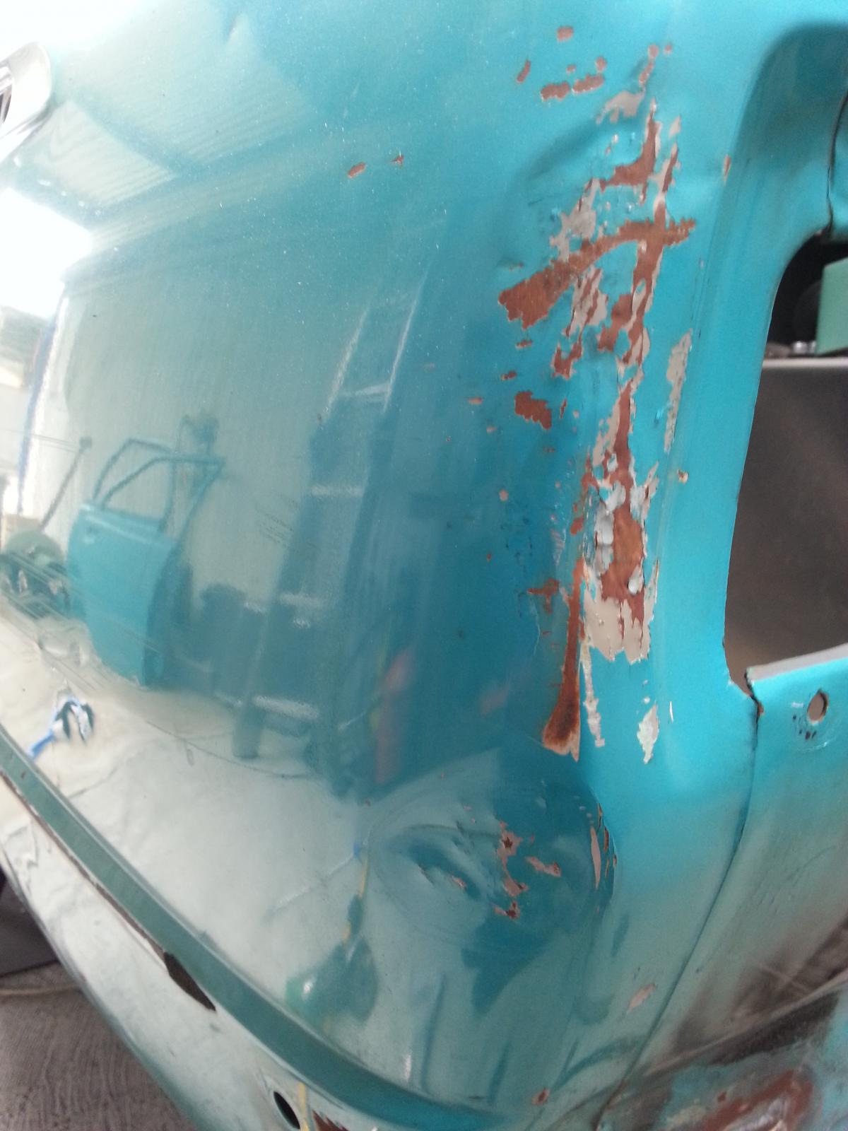

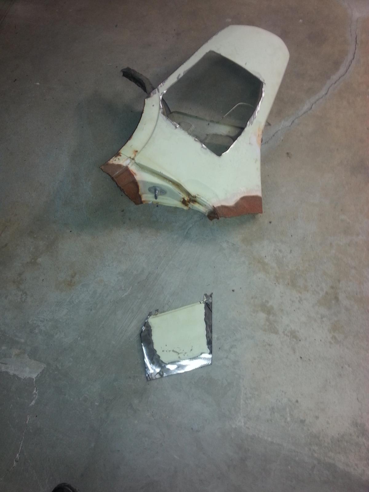

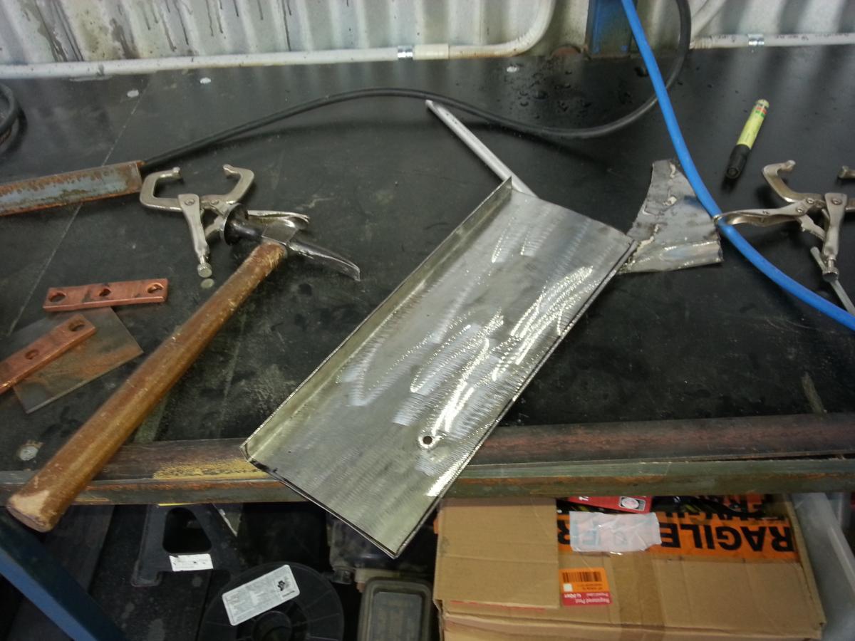

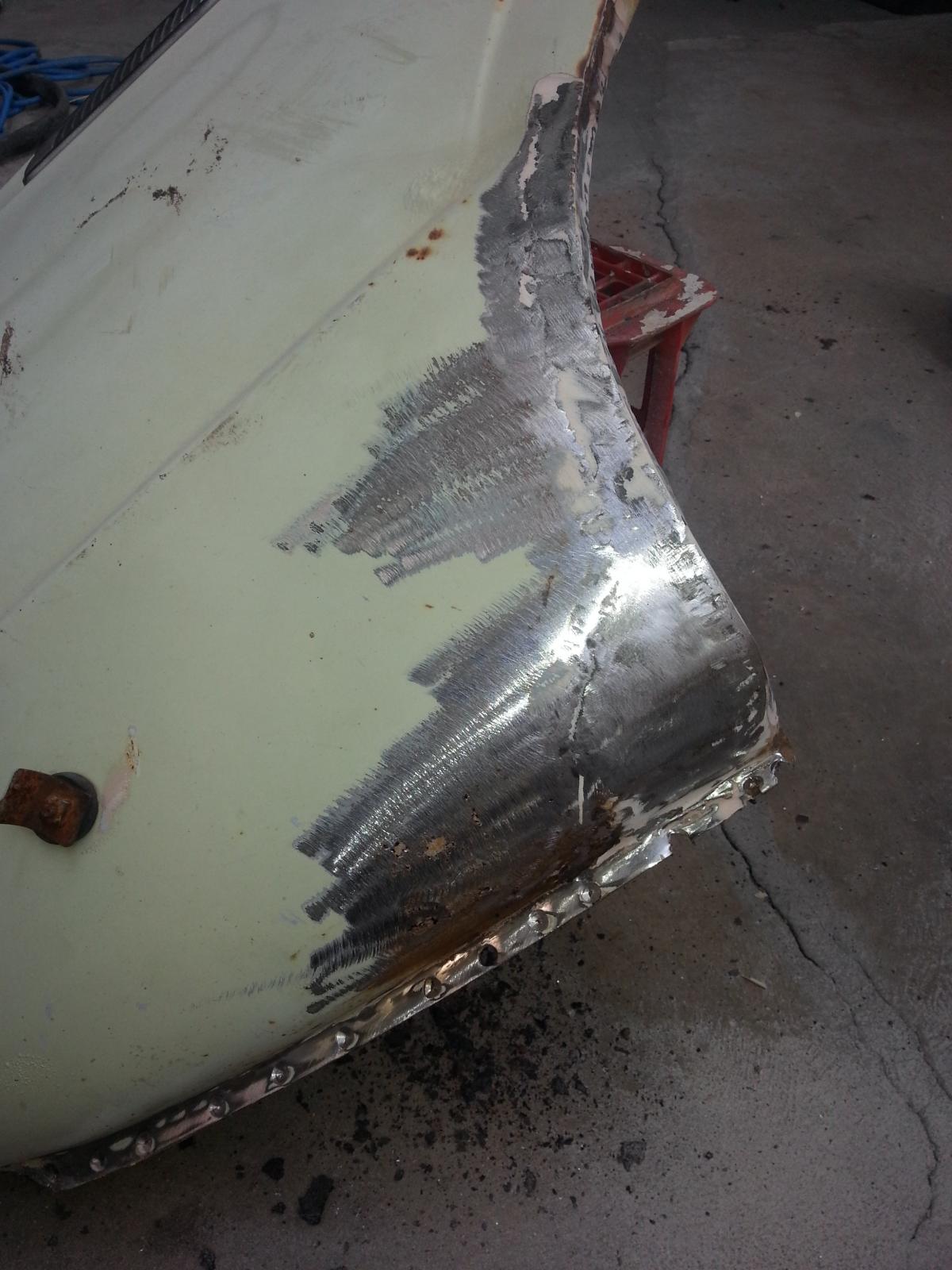

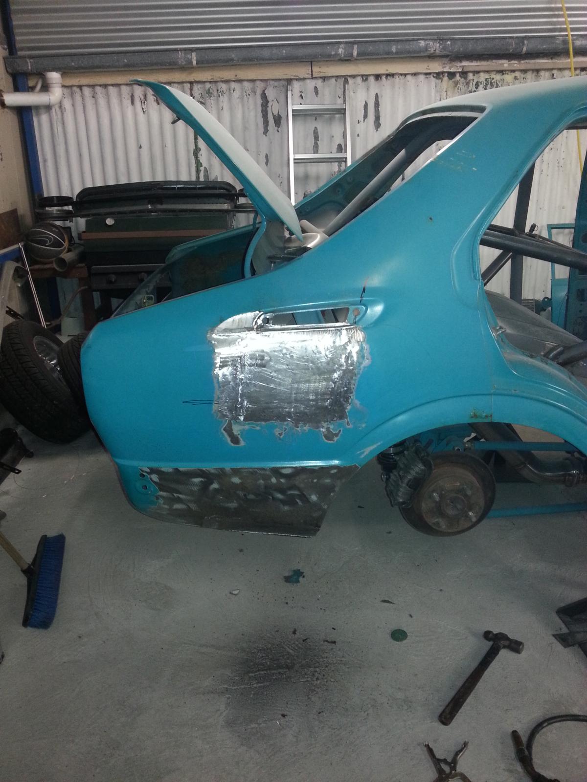

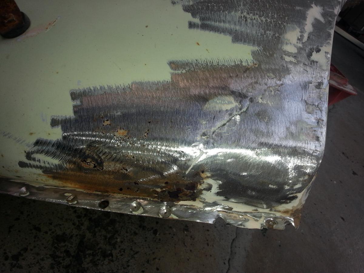

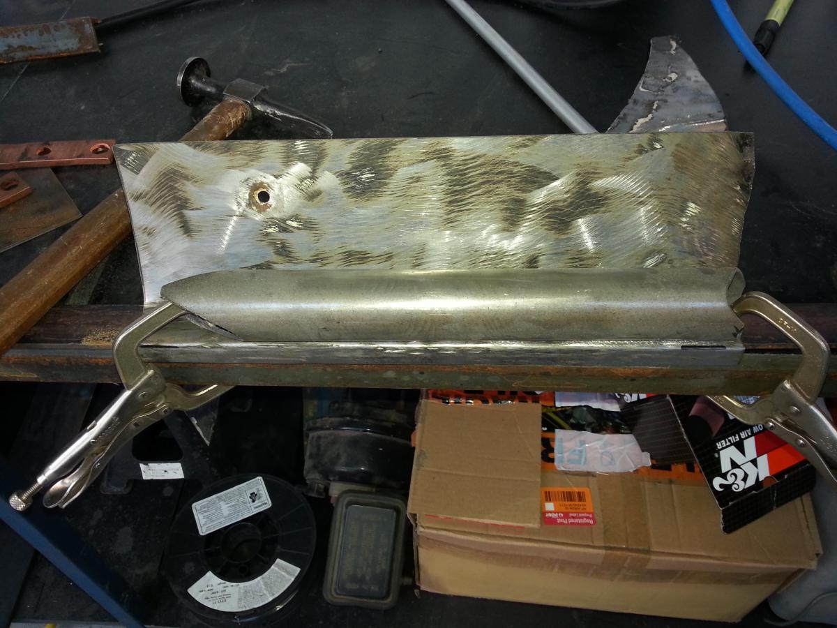

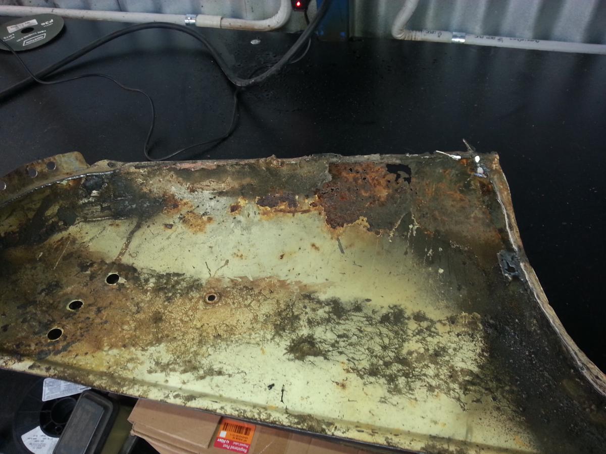

After the last couple of weeks working on the rolla the list of things to do is finally getting smaller I can see the light at the end of the tunnel :greenbounce: so today I thought I'd tackle the worst of the rust the in right rear quarter we had another quarter panel that we thought was good but someone had done a really shit rust repair on it and filled it with bog so ill be making a replacement peace for the bottom of the quarter
Edited by 1JZKe55

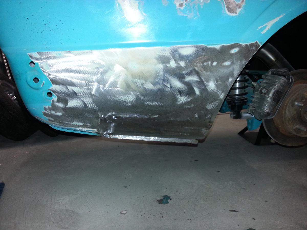

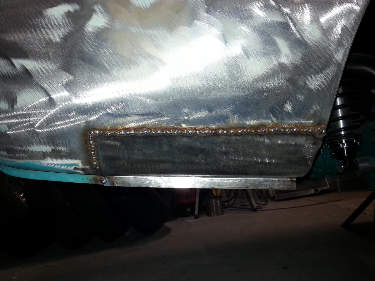

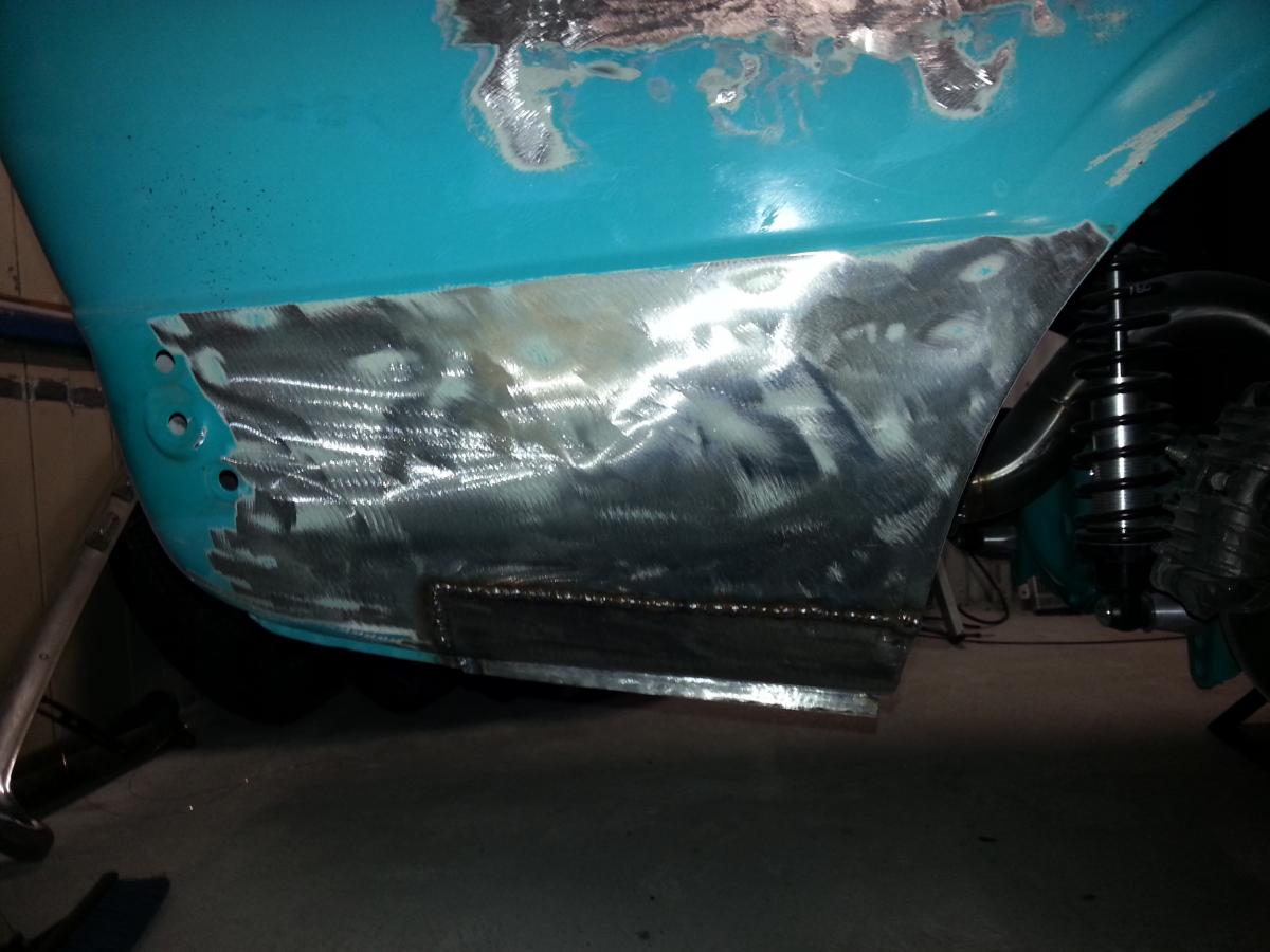

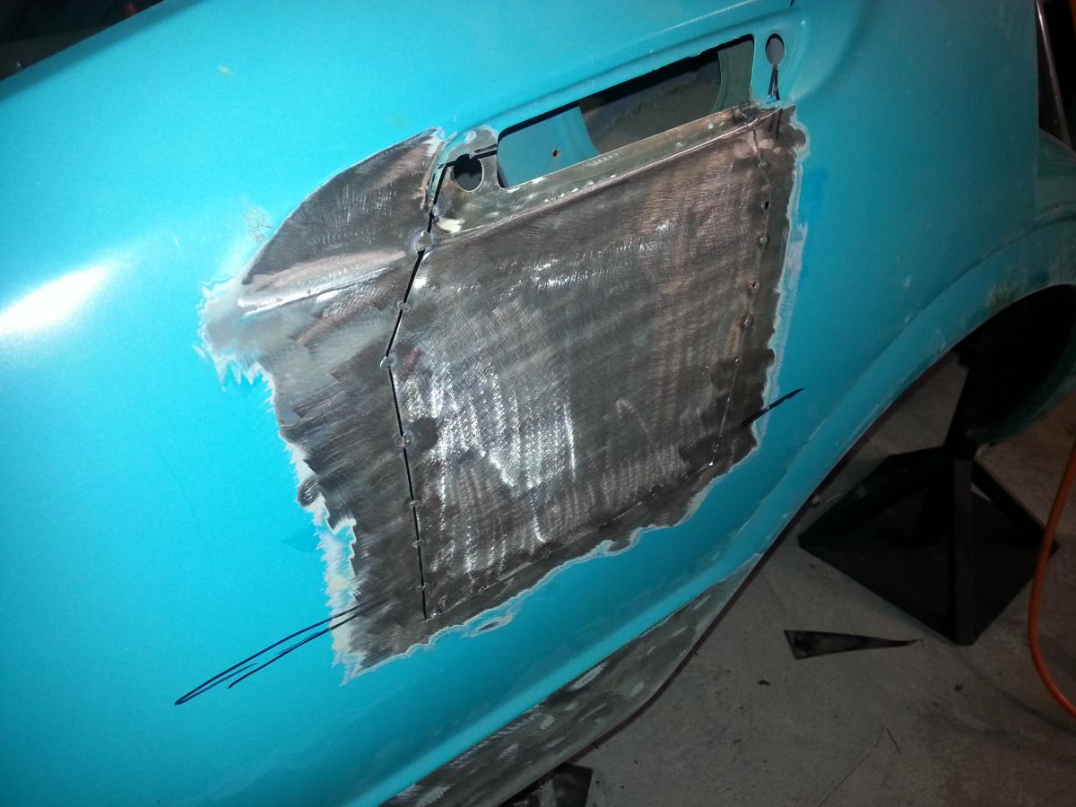

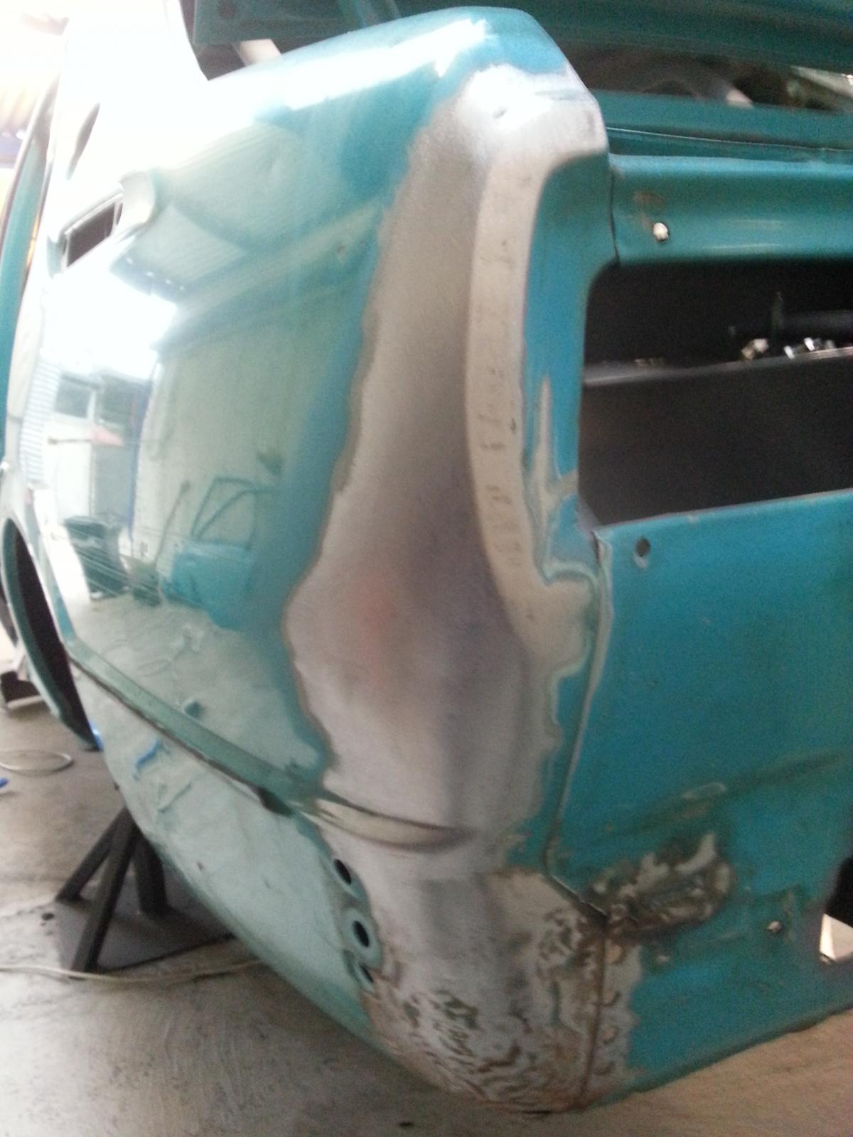

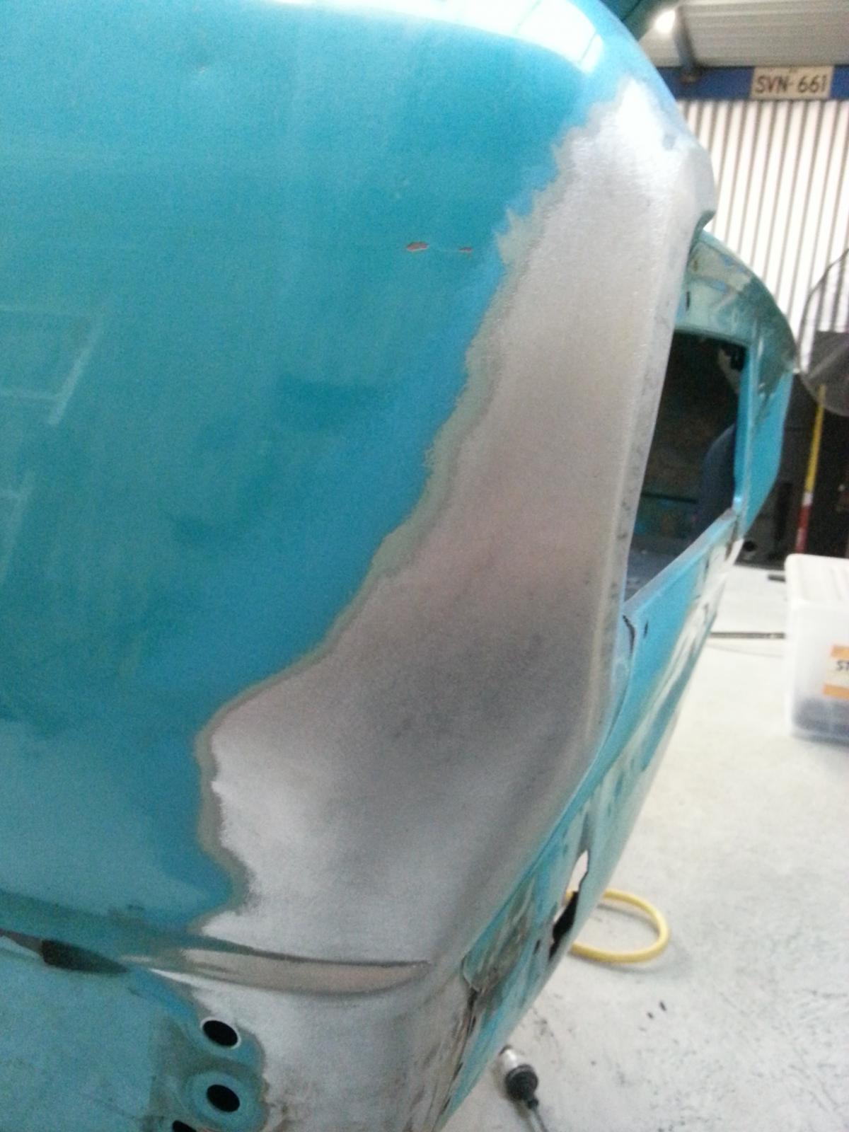

Thanks mate I spent a few more hours welding up the quarter panel and fixed the last spot of rust in bottom of the panel now just a little bit of shrinking to go then it will be ready for some primer :yes:

Now I just have to organise the ANDRA tech inspector to sign off an the cage and chassis work before I paint the inside and boot

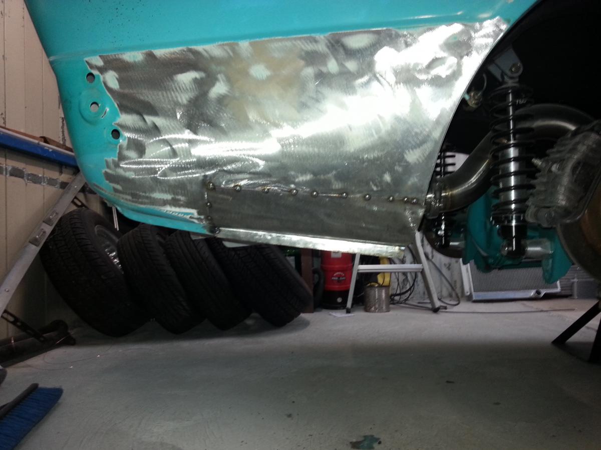

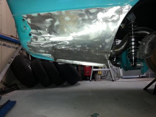

The rear quarter are just about done
