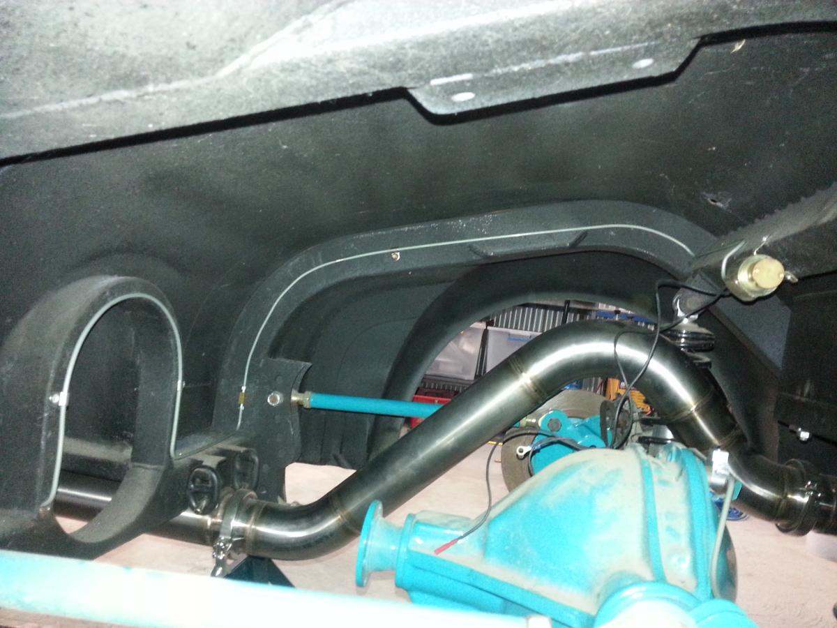

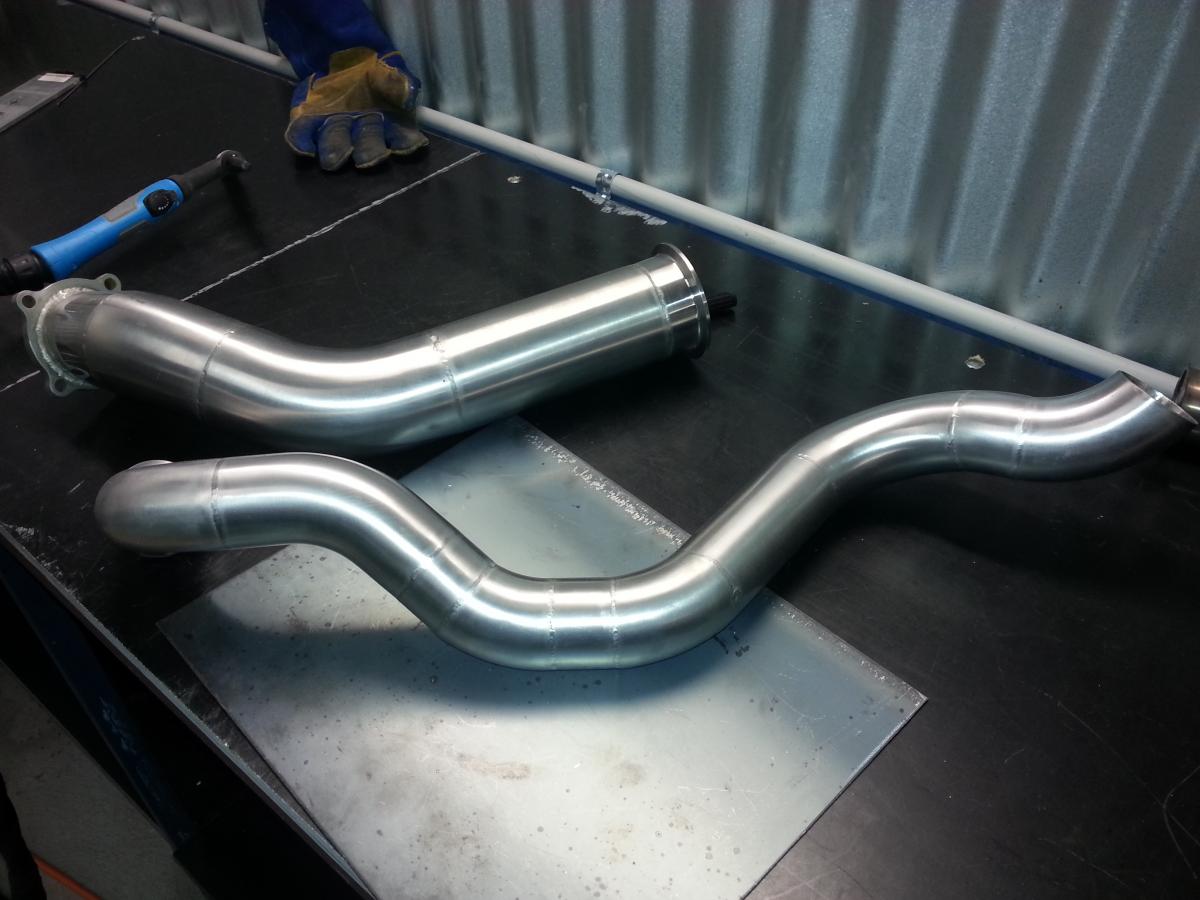

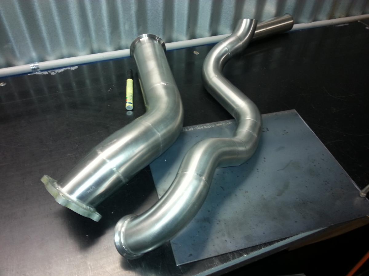

drift freak Posted June 12, 2013 Report Posted June 12, 2013 Yeah answers the question perfectly. Awesome work :) interesting your using v-bands on the exhaust, looks sweet as!!! Quote

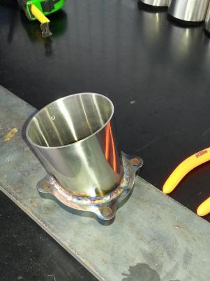

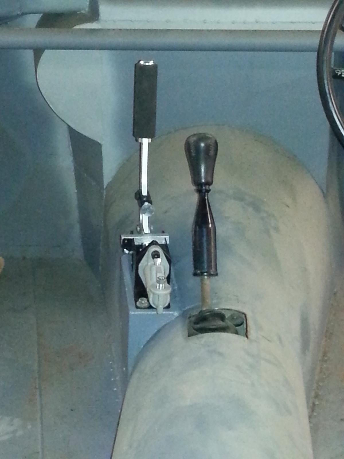

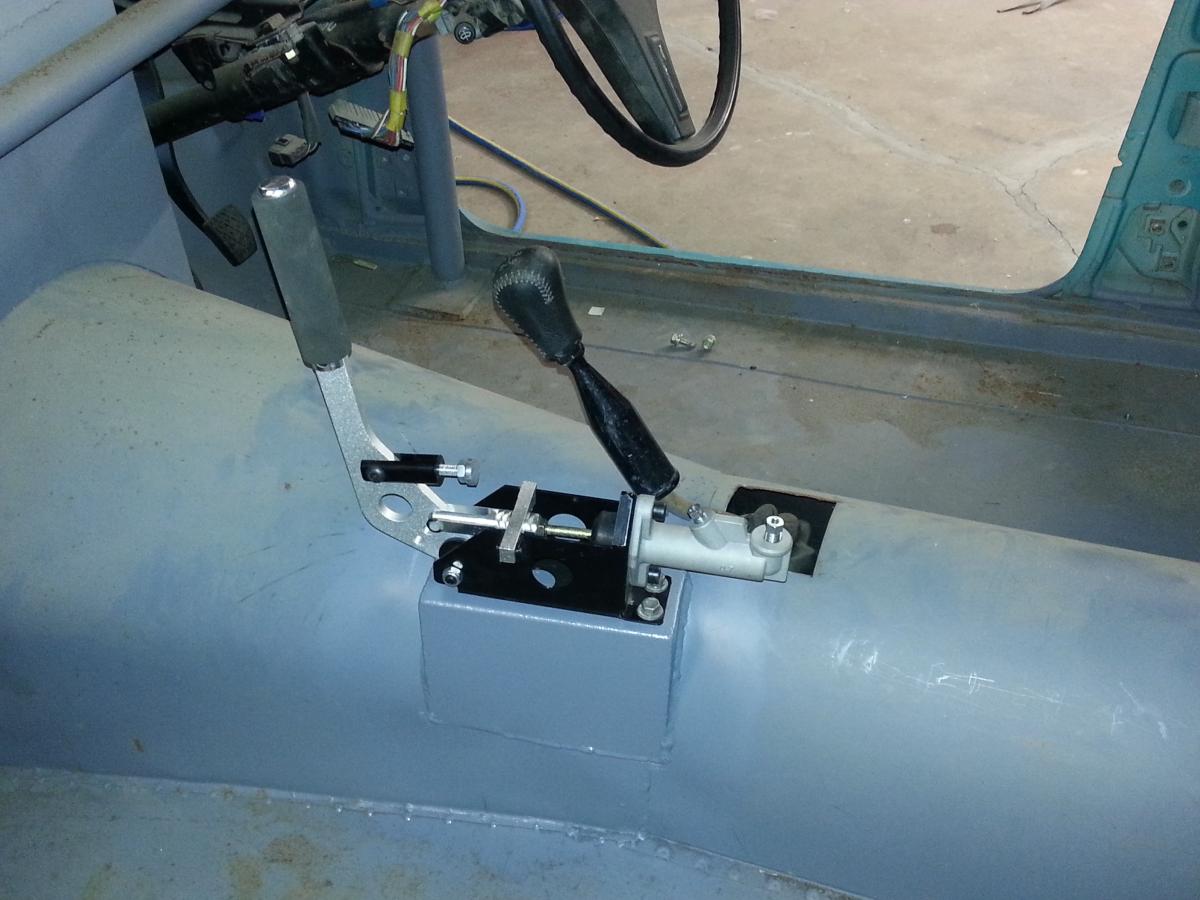

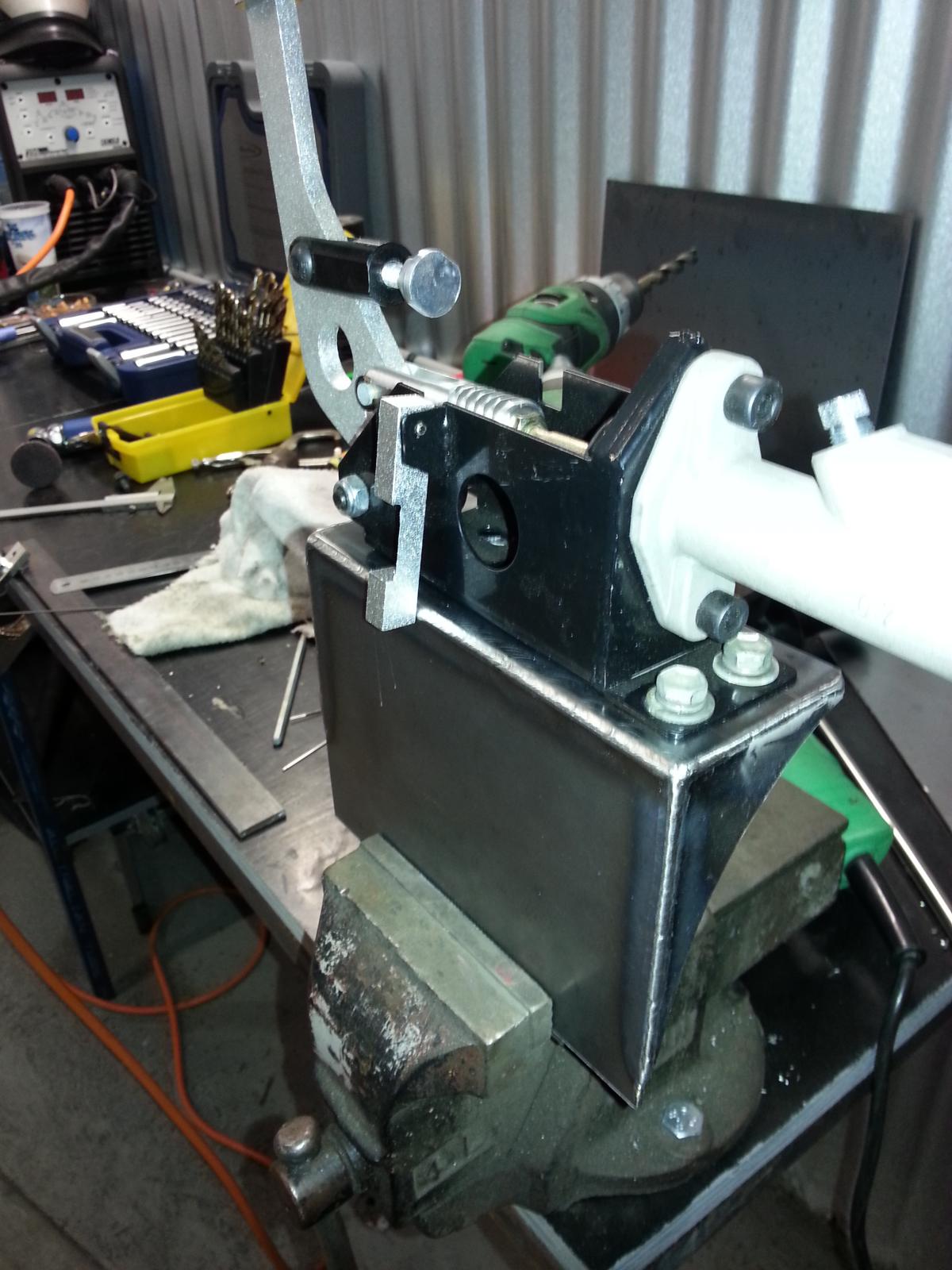

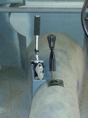

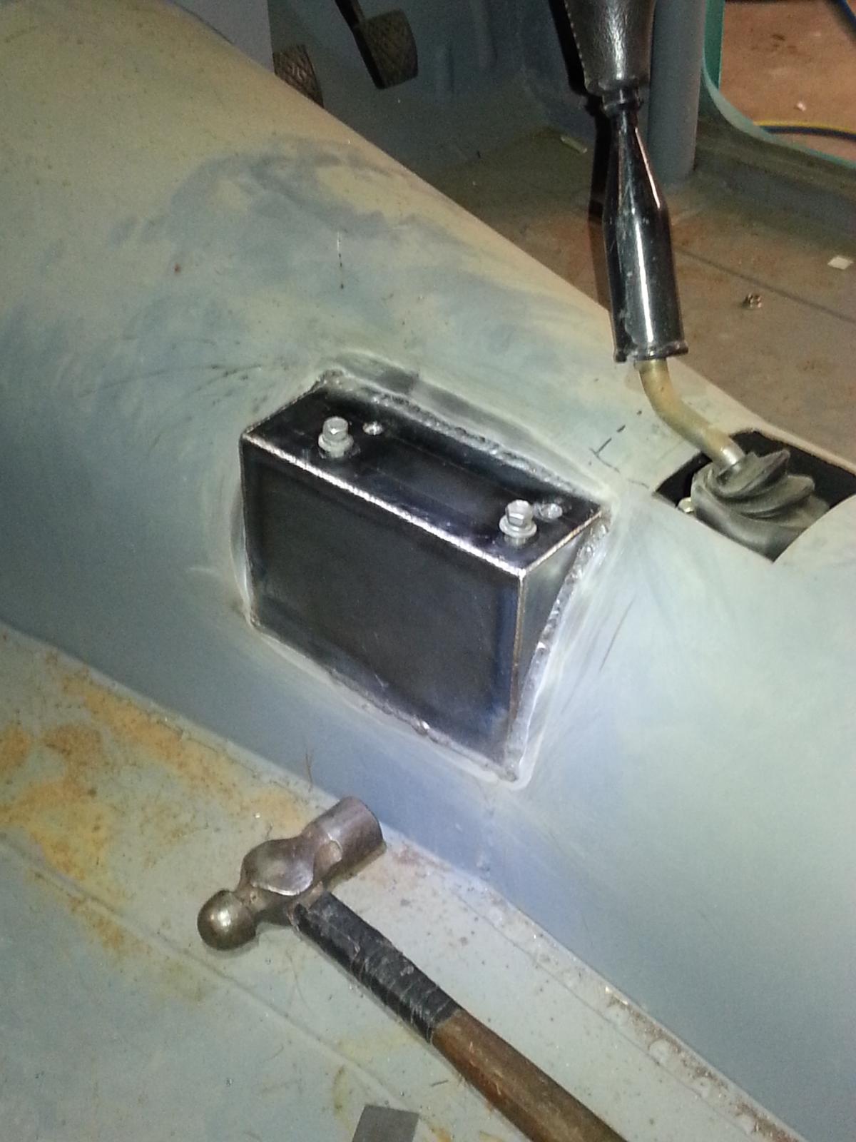

1JZKe55 Posted June 12, 2013 Author Report Posted June 12, 2013 Cheers guys yeah Vbands so much better than a normal exhaust flange no leaking no gaskets no bolts to worry about and its nice and easy to drop the exhaust out at the track. I spent some time today making the mount for the handbrake Quote
drift freak Posted June 12, 2013 Report Posted June 12, 2013 Hydro handbrake??? I thought this was a drag car??? Please explain?? Quote
1JZKe55 Posted June 12, 2013 Author Report Posted June 12, 2013 Ha yeah it was easier than trying to set up a cable setup and it will help hold the car while its staged instead of having your foot on the clutch brake and accelerator all at the same time you can just put it in first gear foot on the clutch hold the handbrake on and bring the rev's up let go of the handbrake and drop the clutch and away you go Quote
Doogs Posted June 12, 2013 Report Posted June 12, 2013 Ha yeah it was easier than trying to set up a cable setup and it will help hold the car while its staged instead of having your foot on the clutch brake and accelerator all at the same time you can just put it in first gear foot on the clutch hold the handbrake on and bring the rev's up let go of the handbrake and drop the clutch and away you go Cool idea, love that this will be manual drag car too! I had just assumed it would be a built auto like so many others, this car is certainly gonna cause a stir. :y: Quote

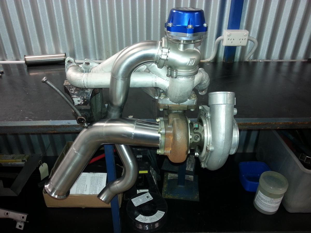

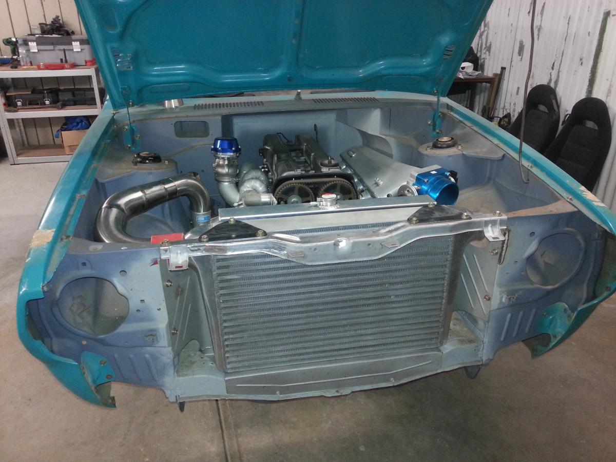

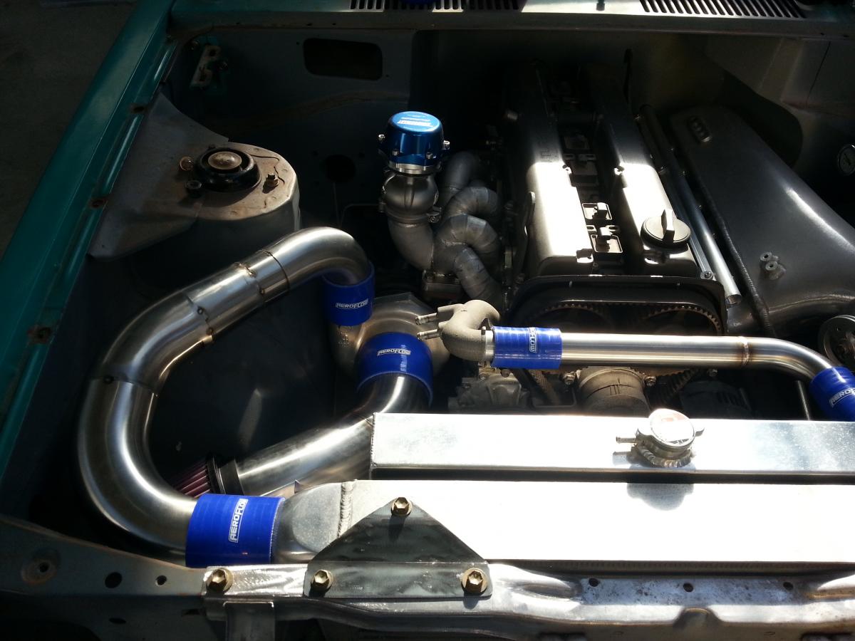

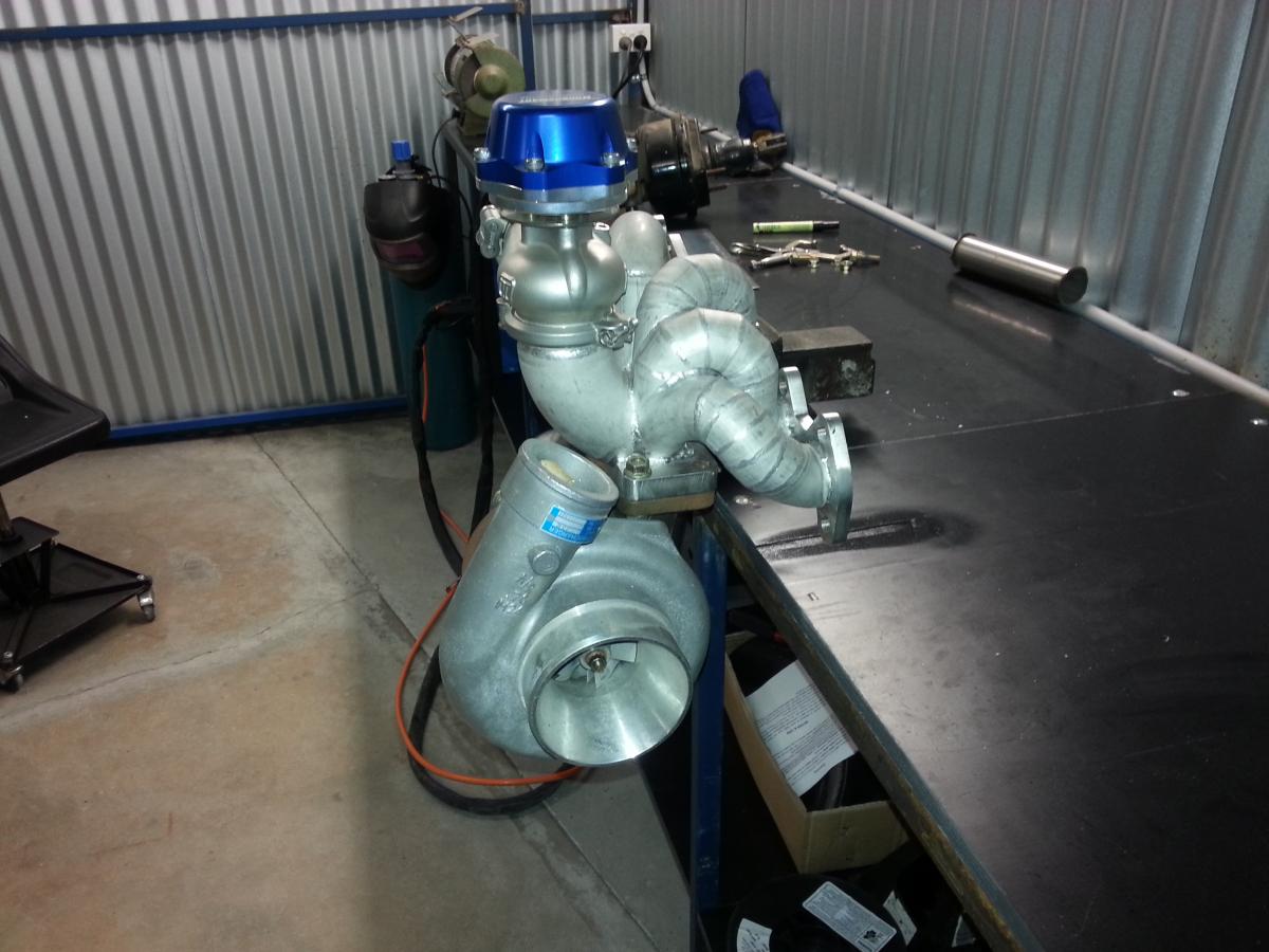

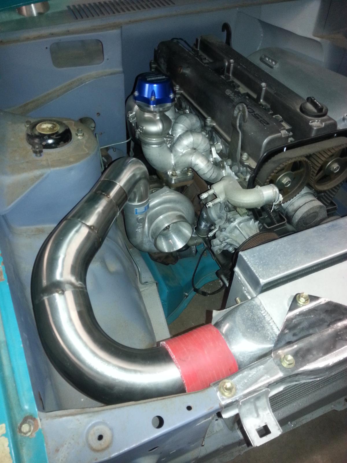

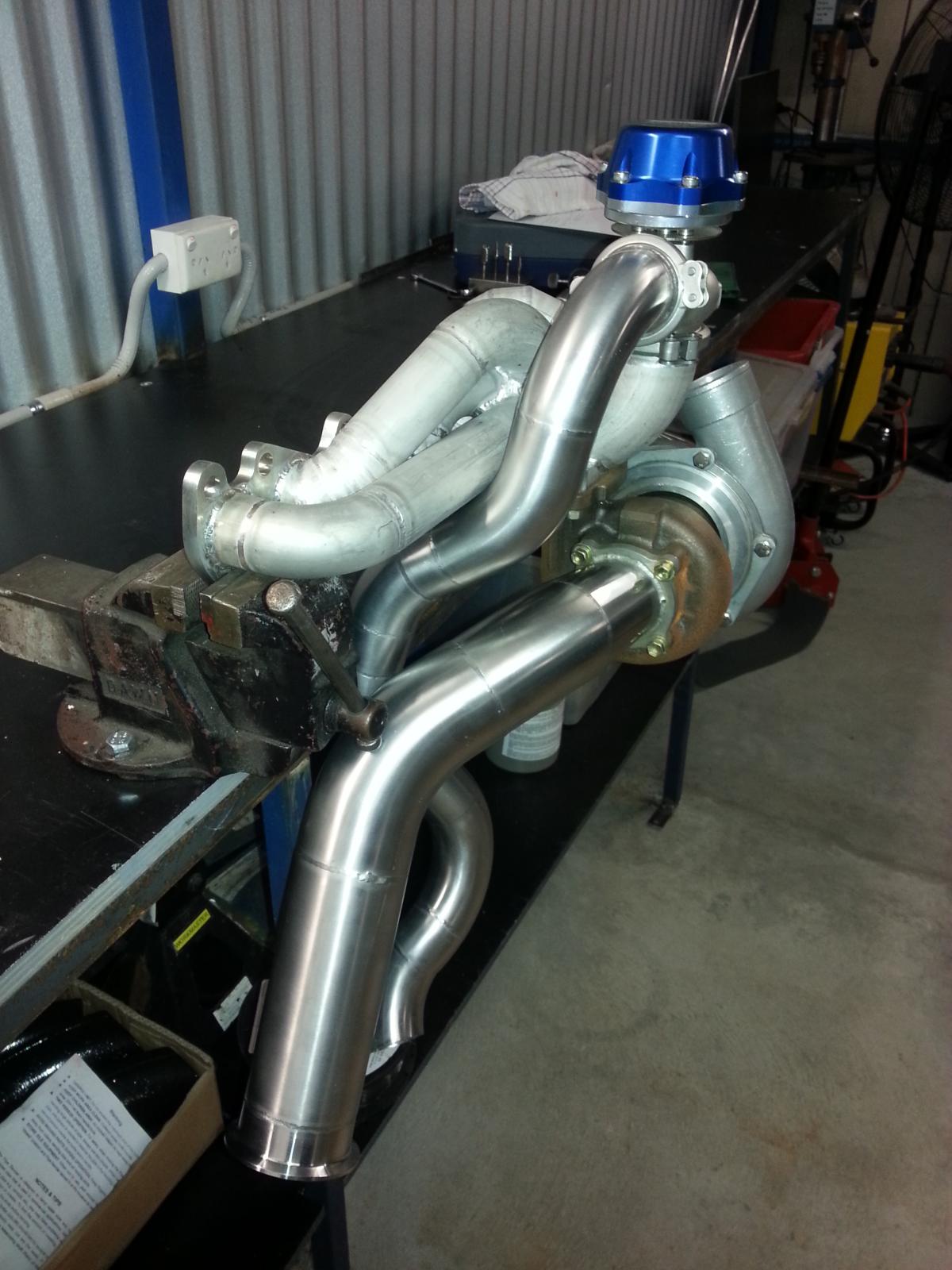

1JZKe55 Posted June 17, 2013 Author Report Posted June 17, 2013 yeah I'm not sure if it will be done in time there's still heaps of work to do. I spent a little more time on the rolla today cleaning up all the manifold and dump pipes Quote

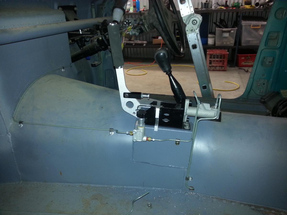

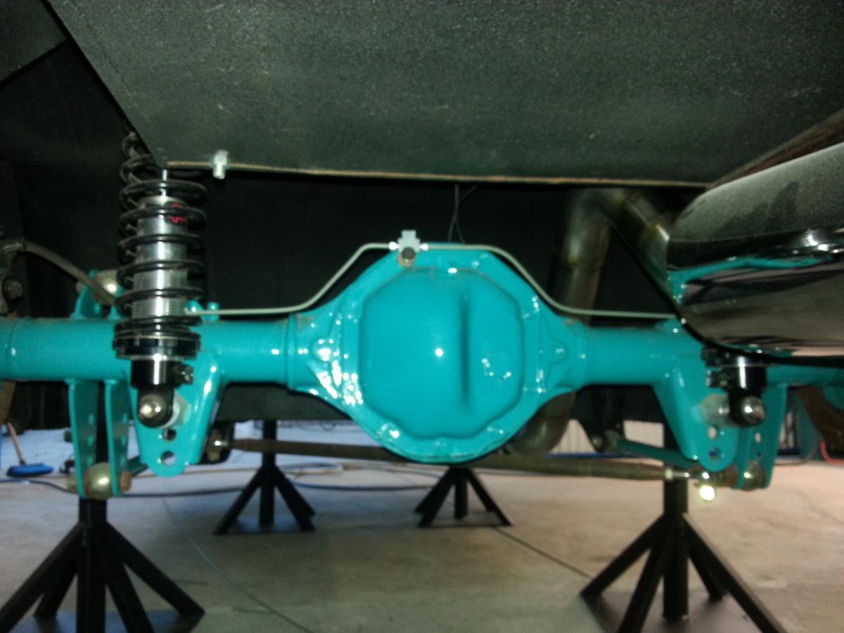

1JZKe55 Posted June 19, 2013 Author Report Posted June 19, 2013 After a few more hours of work on the rolla today I have finally got all the rear brake lines made and fitted and plumbed up the wildwood brake proportioning valve as well as the handbrake now i'm just waiting on the new master cylinder to turn up then it should have some brakes :yes: 1 Quote

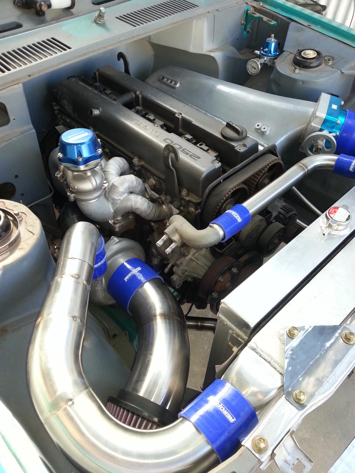

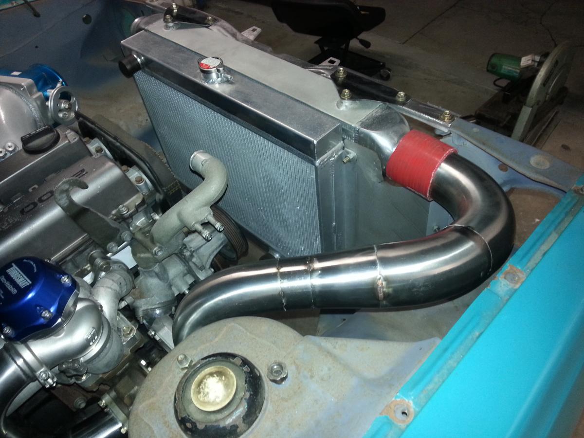

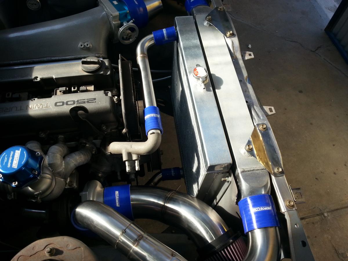

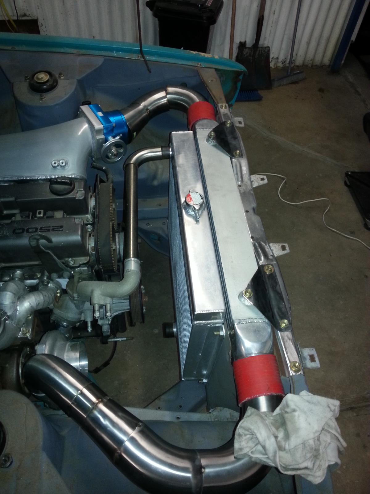

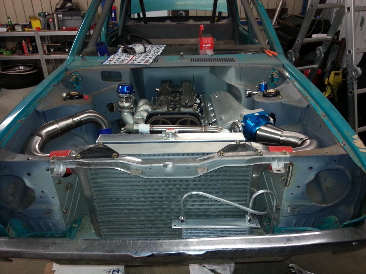

1JZKe55 Posted June 20, 2013 Author Report Posted June 20, 2013 its getting there :D intercooler and radiator mounted now its time for all the pipe work 1 Quote

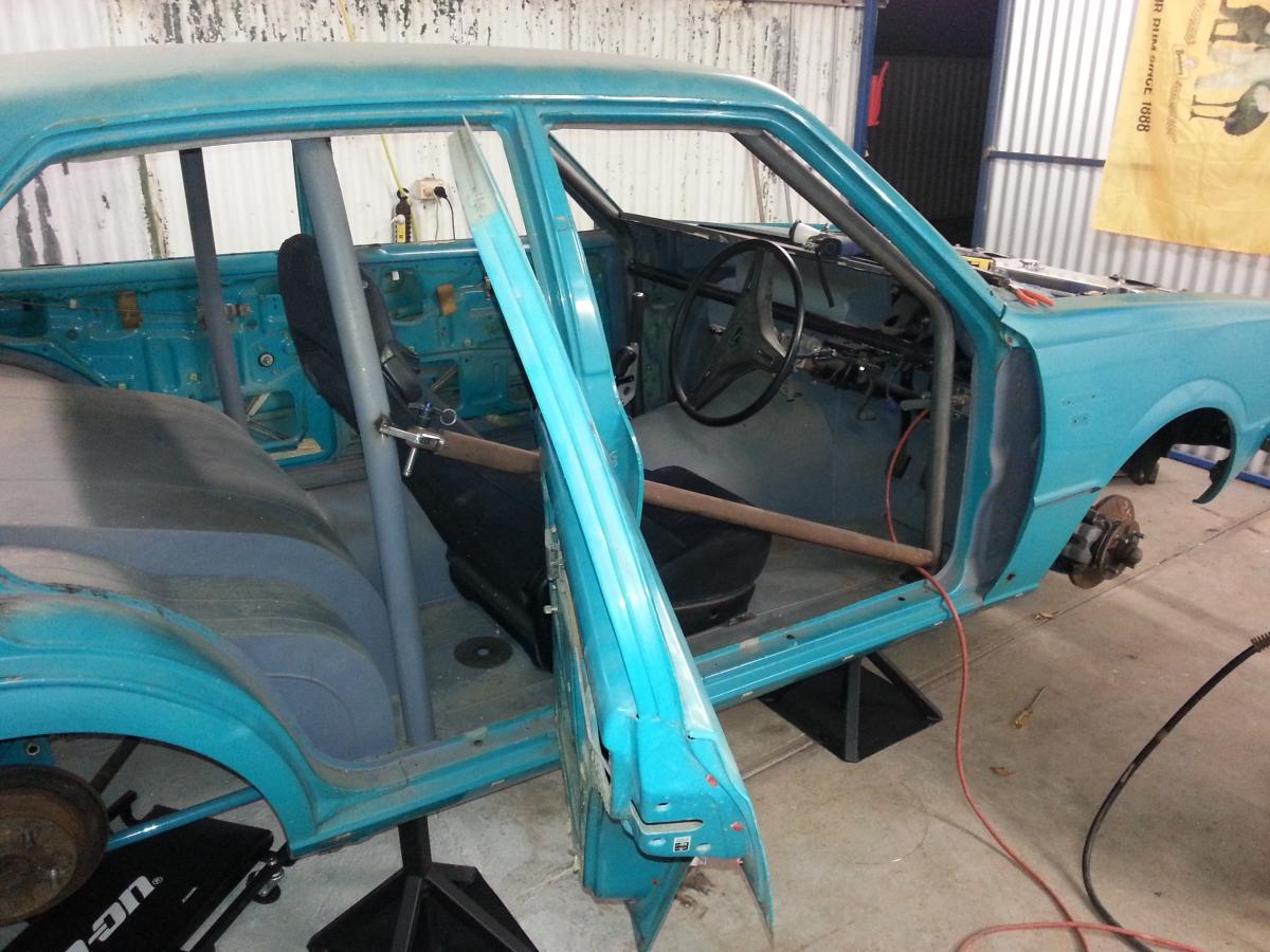

1JZKe55 Posted June 28, 2013 Author Report Posted June 28, 2013 started to finish off the roll cage today putting in the removable side intrusion bars and finished off a few welds on the pipe work and mounted the oil cooler slowly making some progress :) Quote

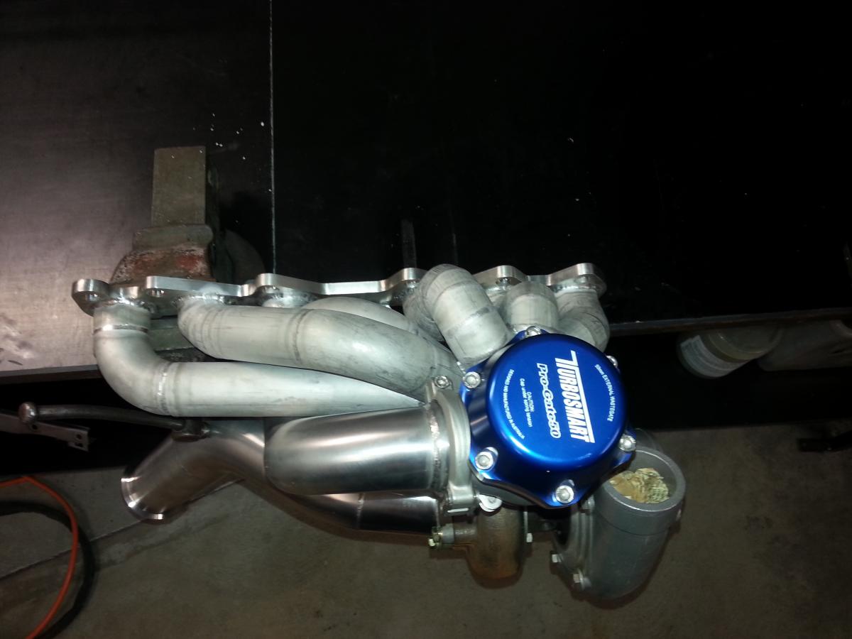

BUZ440 Posted June 28, 2013 Report Posted June 28, 2013 lookin pretty trick there mate, is that titanium? or water over the sun haha keep up the good work Quote
indelible Posted June 29, 2013 Report Posted June 29, 2013 sweet project there, will definitely go crazy when running any reason you went with a low mount manifold? seems there is alot more room there for highmount , just curious Quote
1JZKe55 Posted June 29, 2013 Author Report Posted June 29, 2013 cheers Carlos its stainless steel Quote
1JZKe55 Posted June 29, 2013 Author Report Posted June 29, 2013 Hey thanks Matt :thumbsup: Neil (the owner of the car) wanted the turbo mounted down low and it made it easier to make the turbo dump pipe Quote
