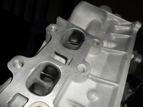

It's been a while so here's a few pic's... things have been coming along nicely the bottom end is built ready to for the head which is in its final stages of porting its gonna be the best 1j head out there

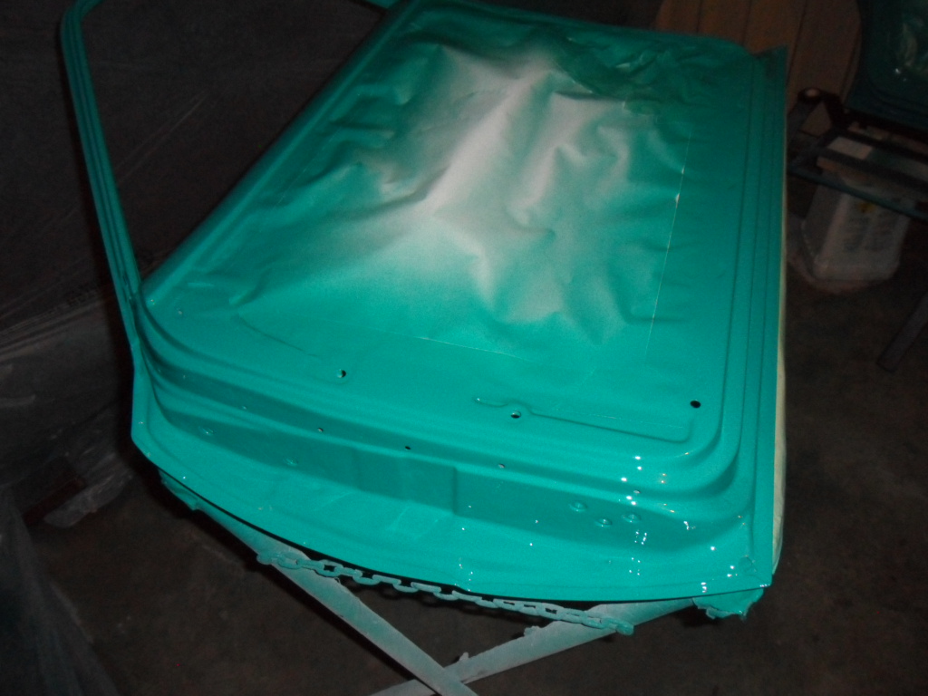

Hey guys after all these years its finally getting some colour. :blinks:
All the inside of the doors are painted engine bay and the rest of the inside of the car is next.
The motor is ready for the cylinder head which is heavily ported with some amazing flow figures for a 1jz head it's all coming together

who did the porting and whats the flow specs?
https://www.facebook...139128586195488
Frank Intini Race Engineering did the head work one very smart guy when it comes to head work
Inlet flowed 255.4cfm at 0.400tho lift
Exhaust flowed 171.7cfm at 0.400tho lift
A stock 1JZ head flows 215in and 133ex at .400 lift.
