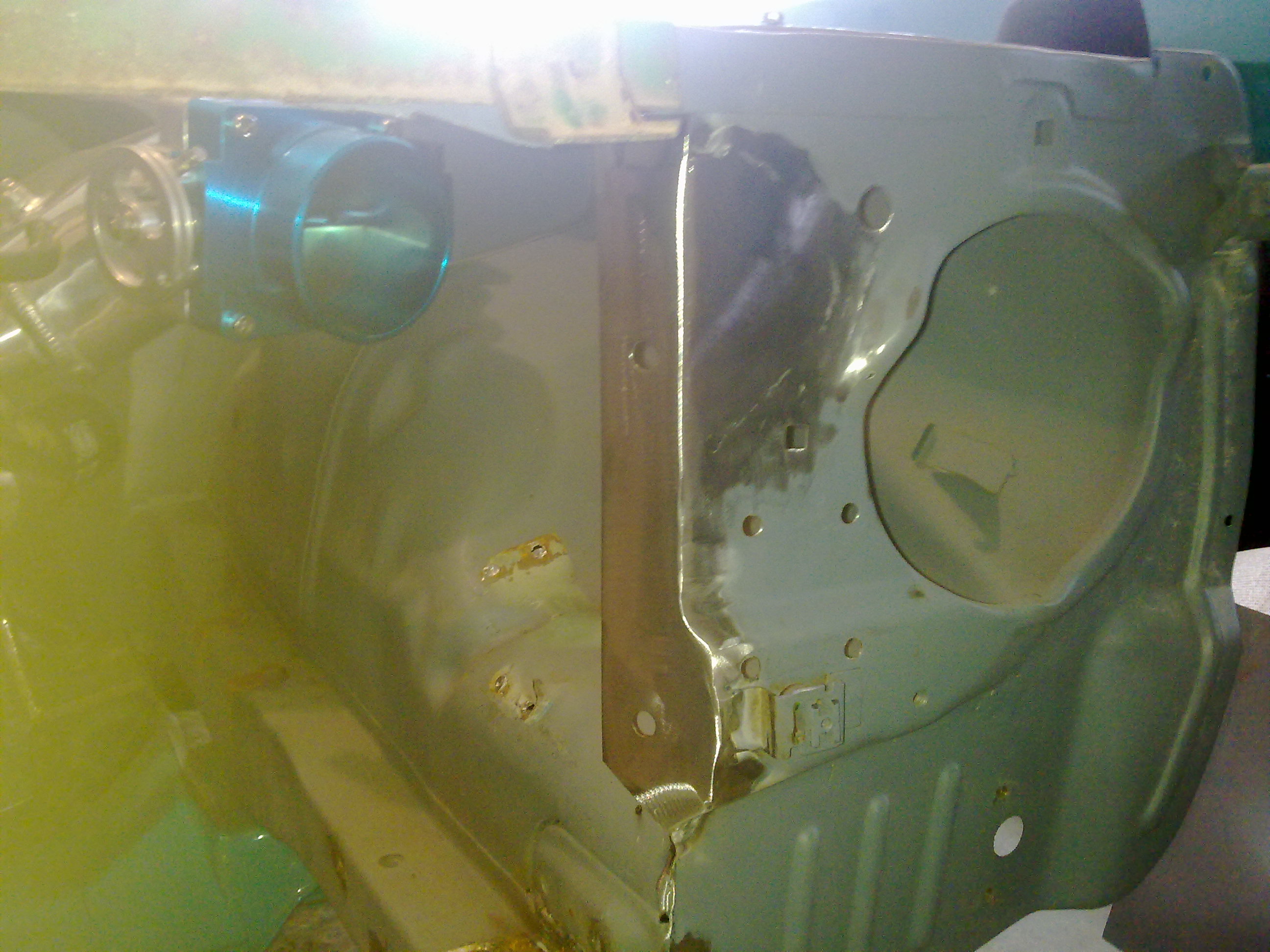

1JZKe55 Posted December 21, 2010 Author Report Posted December 21, 2010 spent a little bit more time on it today Quote

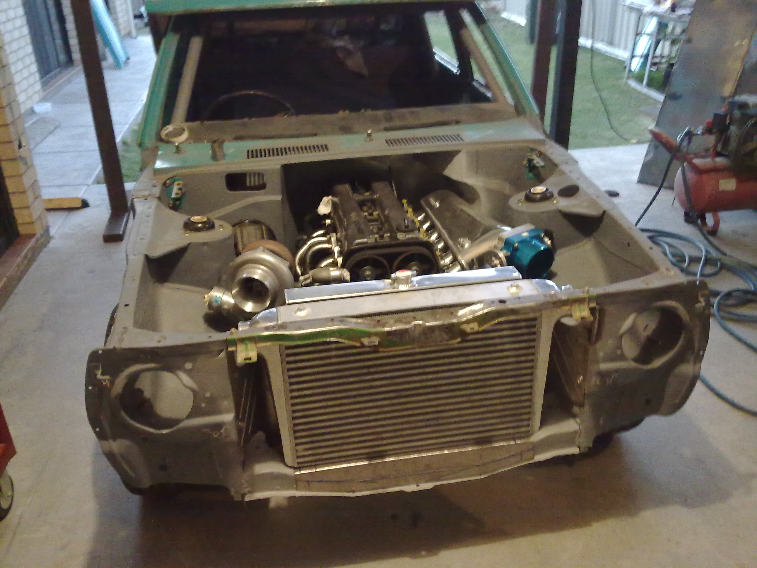

1JZKe55 Posted December 24, 2010 Author Report Posted December 24, 2010 (edited) got the intercooler mounted now just gotta weld the top mounts in and started remaking the turbo manifold wasn't happy with the 6-1 just too tight for room so i changed it to 6-2-1 to give me some more clearance Edited June 7, 2011 by 1JZKe55 Quote

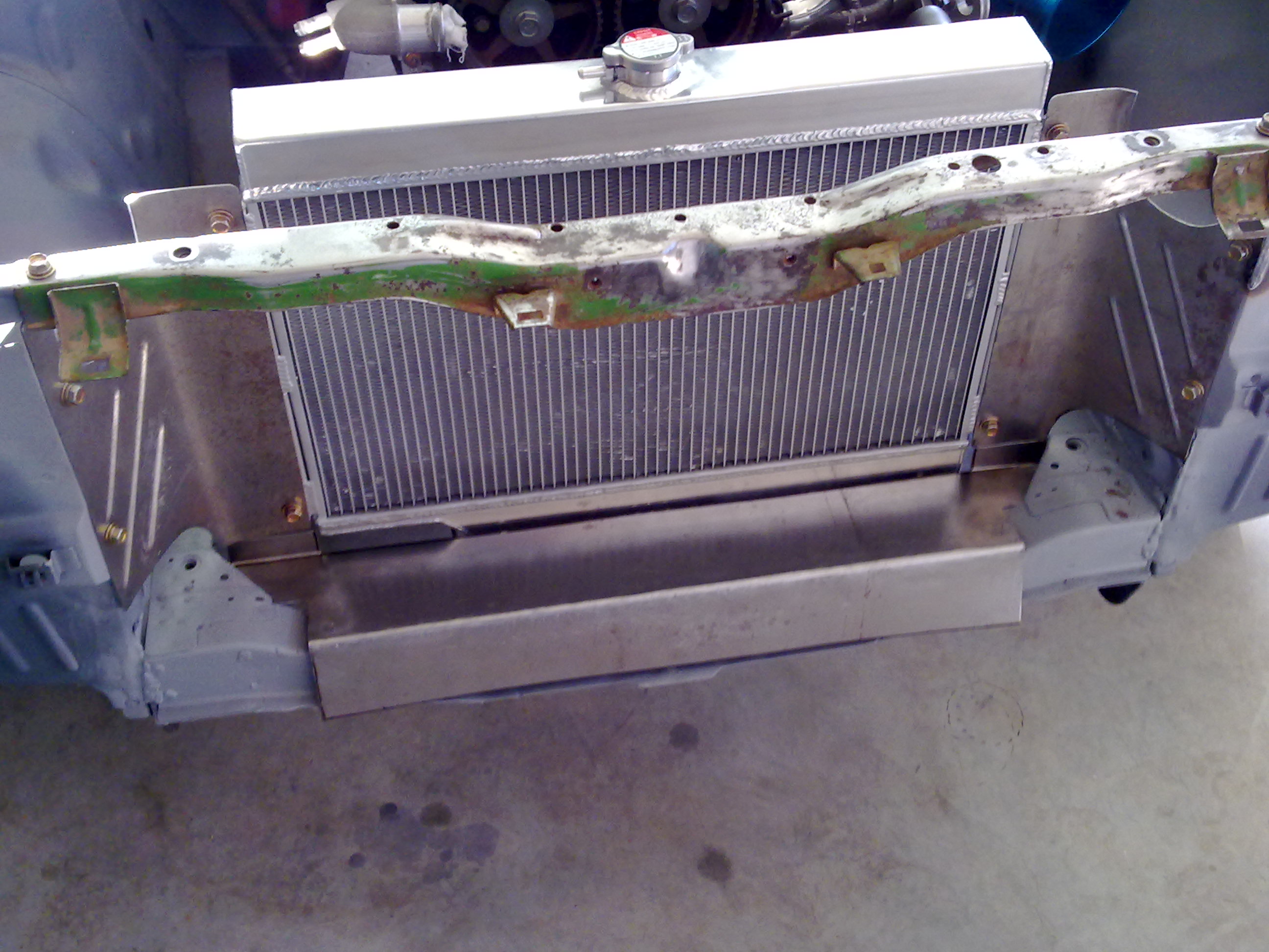

oh what a nissan feeling! Posted December 25, 2010 Report Posted December 25, 2010 man that radiator support is a work of art, shows some real thought, and metal work skills. top quality car, keep the pics coming. :y: Quote
ae824ate Posted December 25, 2010 Report Posted December 25, 2010 Absolutely love it mate, very nice work. PM me, i get lonely :( . can't wait to see a vid of her running. Quote
comtoy Posted December 26, 2010 Report Posted December 26, 2010 damn this thing makes me want to drop the turbo rb30 that i have in the shed into my hardtop rolla f'n awesome work mate Quote
