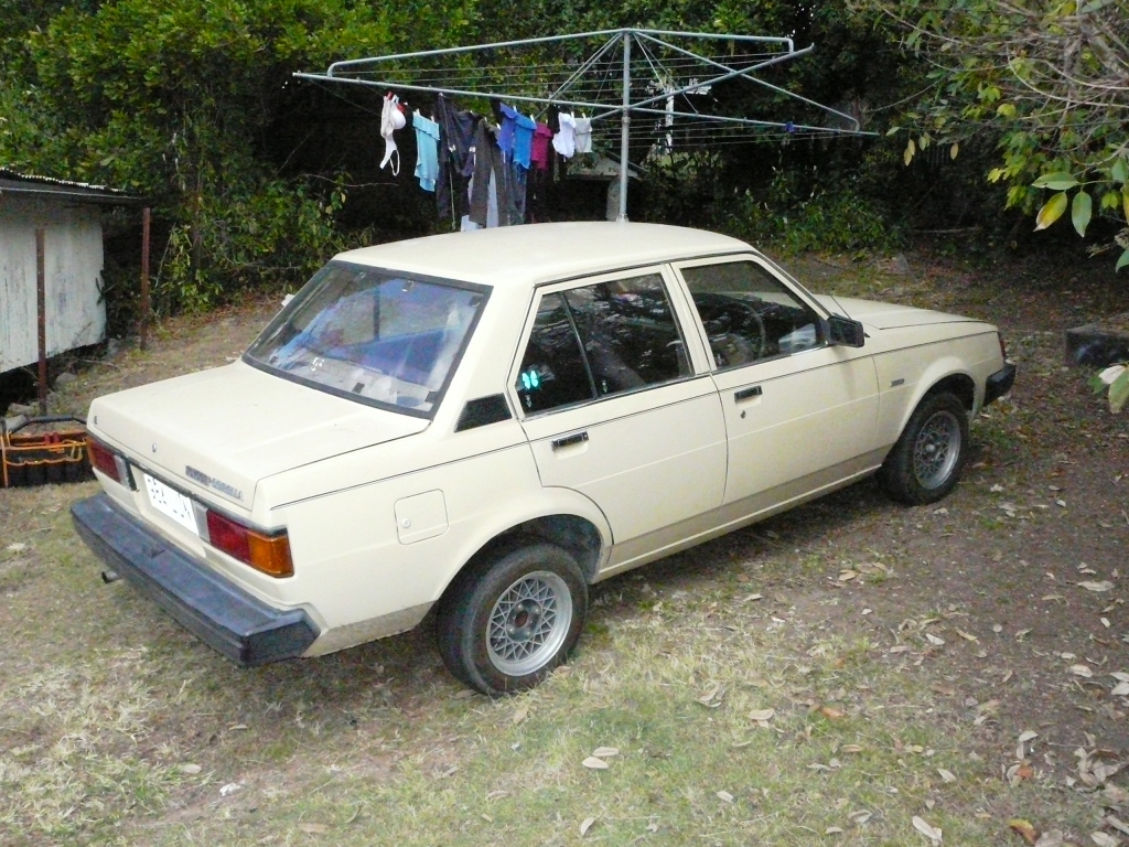

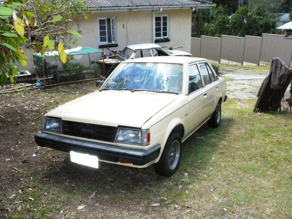

Hi guys.
Let me intorduce the new vehicle.
Vital Statisitcs:
Colour: beige
Rust: standard here and there
Wheels: 13x5.5 hotwires
Motor: 4kizzle my nizzle
Gearbox: Umm, havent even checked
Diff: Yes there is a diff.

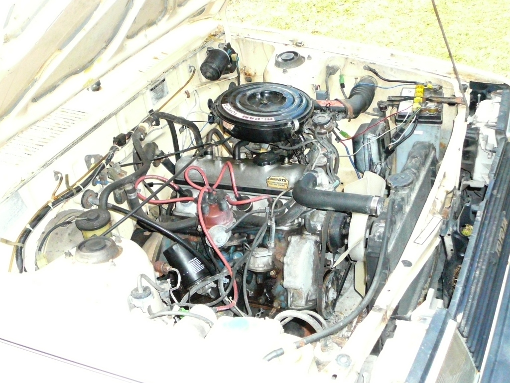

Beerhead popped over today for a look and ended up fixing the starter issues. It had 2 relays wired in series and one of them was broken and it was just unneeded and shit.
We put the wire brush into the drill and cleaned all the grounds, replaced the cables that were shoddy, and it started off the key like a dream.
So thats when we actually heard how rattly this 4k is.
Its only gotta last a week to get me around to the rwc place and to qld transport. Its the original motor going by the documents with the car, and its got 291,000klms. The 4 speed is a conversion. She started life as auto.

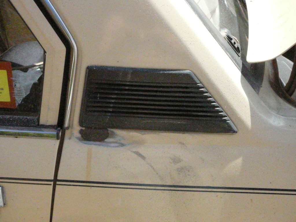

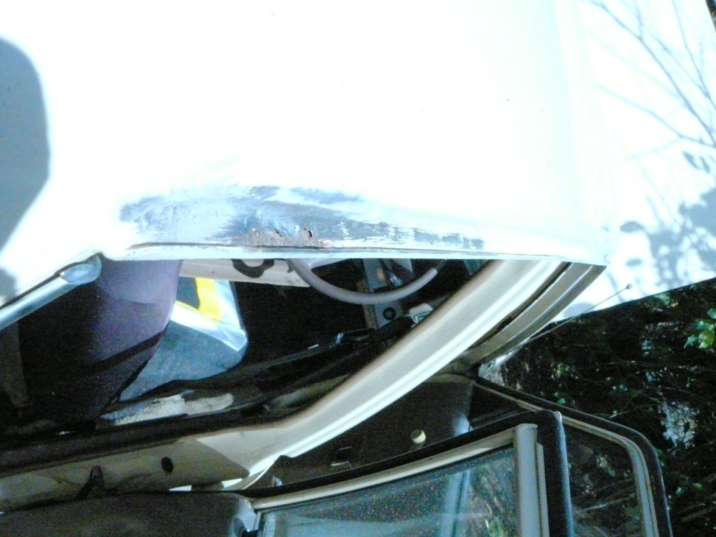

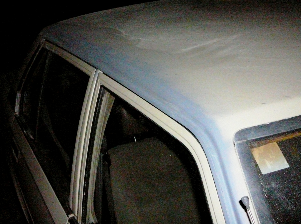

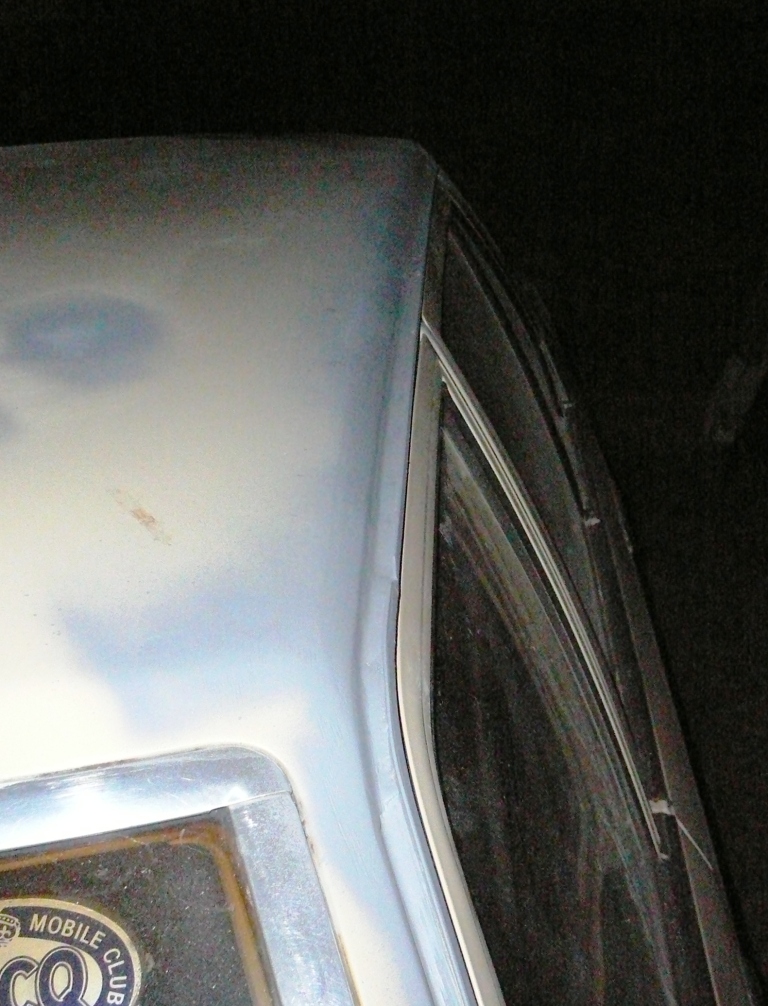

The rust has been brushed back, and bogged over. Its not a spectacular job but its gonna be water tight. I need a can of beige touch up.
Ha, Stay away from the grinder man.
