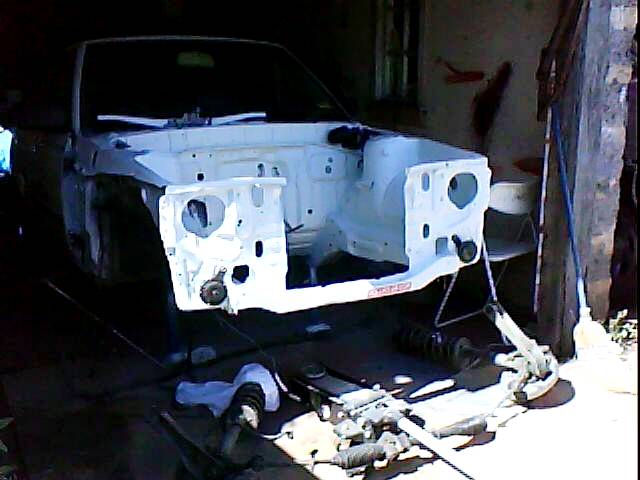

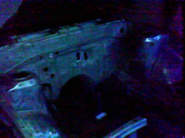

PROGRESS!!!

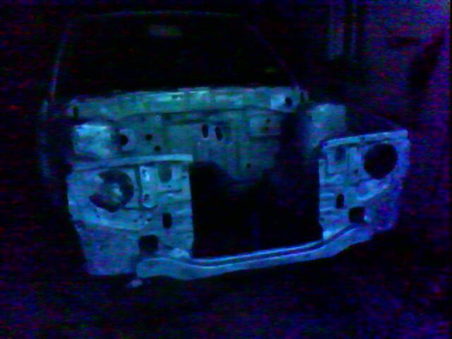

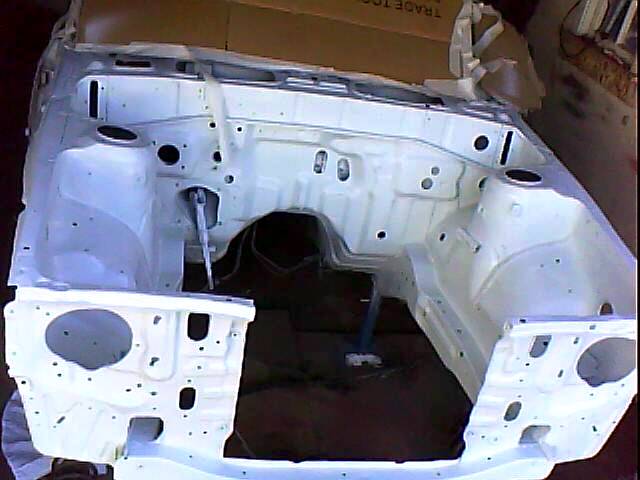

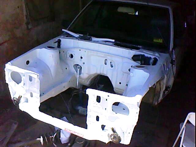

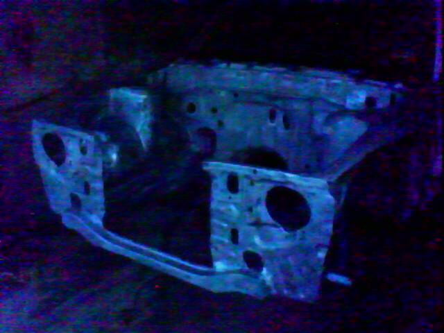

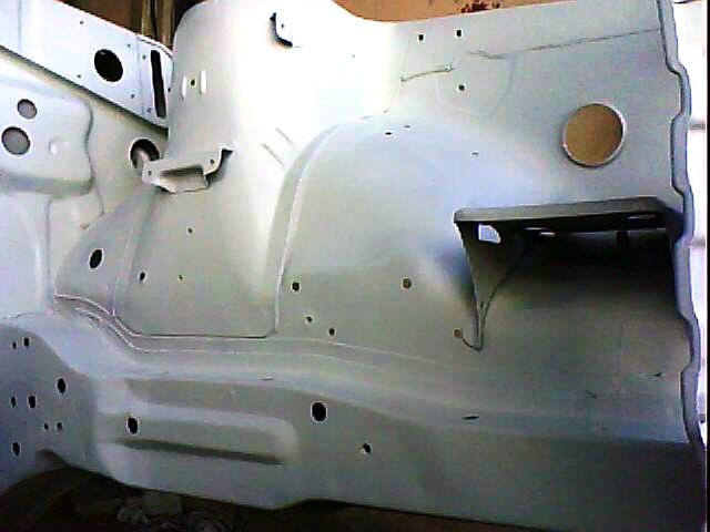

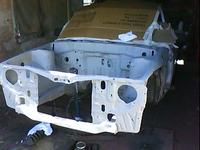

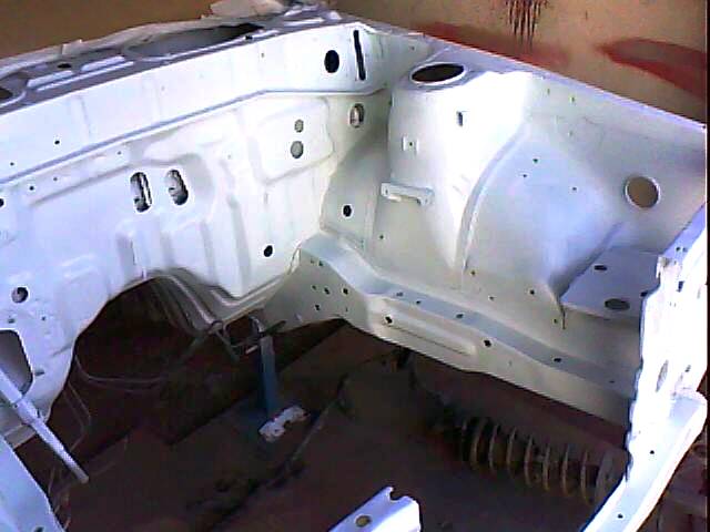

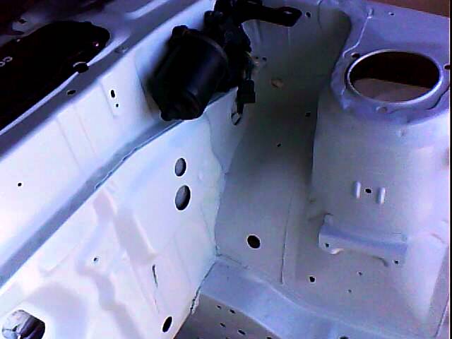

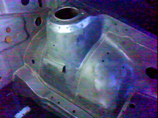

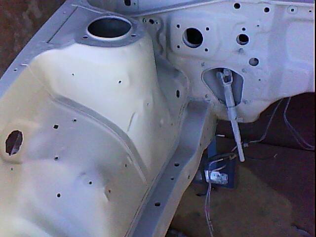

I sandblasted the entire engine bay and radiator support panel back to bare metal.
Now its sitting there all sprayed with 2 coats of acrylic primer/filler. I didnt use etch primer since I'm not too worried what it looks like in 10 years time.
Ill give it a couple of days to dry fully then Ill do 2 or three coats of white over the top and I can finally do the engine conversion and fit all the suspension.
I need to find a good heater core, and also swap the front of body looms over for some better ones that I have.
Just a few weeks to go now and Ill be done.
