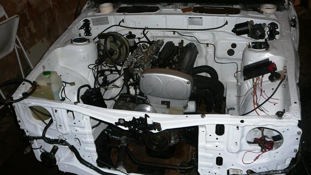

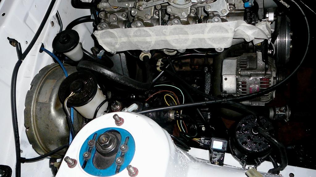

Fitted the quads, complete with injectors, just need to fit the other shit now. :hmm:
Tank and diff are in, fuel filler still needs minor work but all the hoses are done up. Got a new fuel filter installed aswell. Still waiting for my radiator mods to be done, Ive got the radiator shop making me a nice cowl for my sv21 thermofan, and braising on some captive nuts so it just bolts straight on.
Just need to bleed brakes, put in some gearbox oil and get it wired. Beerhead will come and do that when hes ready.
Then zorst and tune.

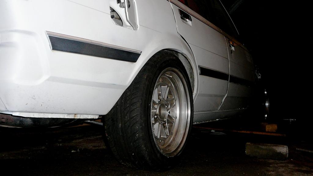

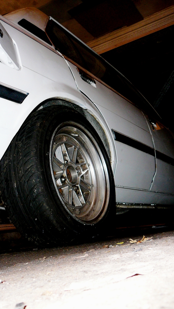

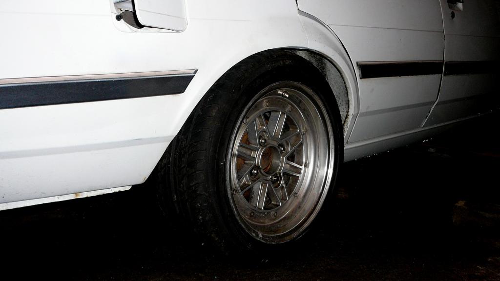

Mungi mods popped over and we test fitted some southernways mesh wheels he has which clear my 4 pot brakes. They are due to be widened so ill have a full matching set of 7.5s and :y: to fit soon, reco and polish with powdercoat centres and new bolts.
Still wondering what colour to paint them. thinking either white or silver but mungi mods likes gunmetal. I kinda want to be different but still keep it classy.

I've bled the brakes, and they feel great. Thats 2 pedals now. Just need the motor to run. Ive Just got to further mod the fuel filler an then it will just slip in the spot no problems. I also need to put in some gearbox oil. I chucked all the rims on it so i could drop it down and see the ride height, and its just as I had hoped with the new rear springs. It should drive perfect, and thats goodbye cut springs for good.
Its getting so close to driveable now, I can taste it. I also need some velocity stacks for the silver throttles. don't know what I'm going to do there. Anyone have something I can buy or borrow?
I also need new front rear bumper as mine's not real straight.
Hope fully when Brad comes over to wire it I can be painting the panels.

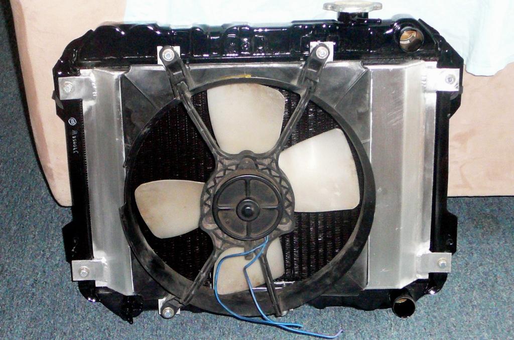

I just collected my new thermofan shroud/radiator combo from Western Suburbs Radiator Service at Sumner Park.
I spoke to Dennis and he did me a great thermofan shroud in Alloy for 100 bucks. Here it is.
It uses a Toyota OEM thermofan from an sv21 camry. It seals the whole core so the fan will be as efficient as possible.
