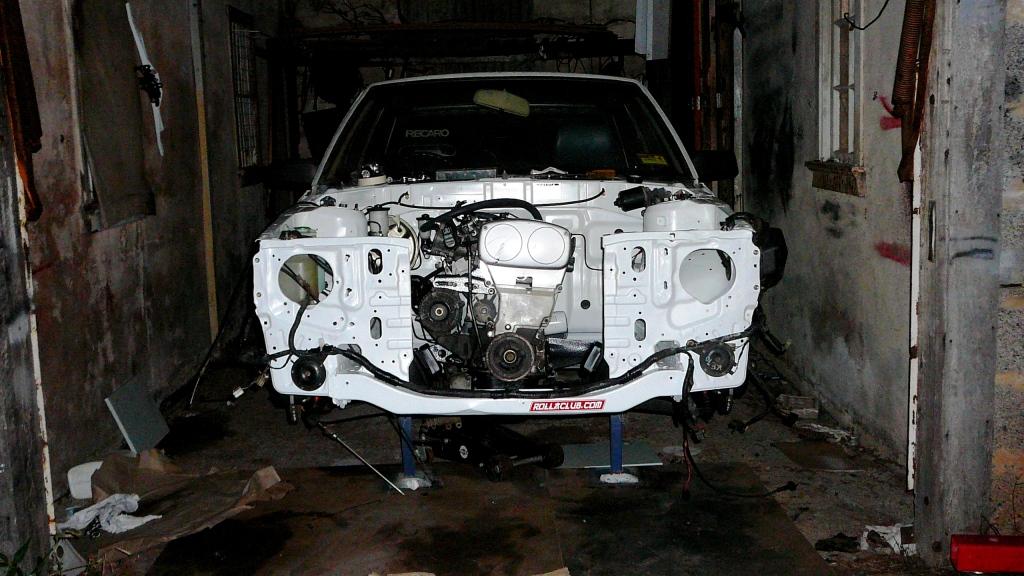

Instead I put in a steering rack, connected some hoses to the heater core, found and fitted a better steering uni joint, and combination switch. I just have to slip (bash probably) the steering column into place and plug it all in, and Ill be dropping in the motor after that I guess. I wasnt going to put the steering in yet, but the rain meant that I couldn't do much with the crane and motor out front of the garage. If it stops for a few hours later on I might give it another go. Bit over it and frustrated right now. Just want some sunshine and another day to work on it, all of which I don't have.

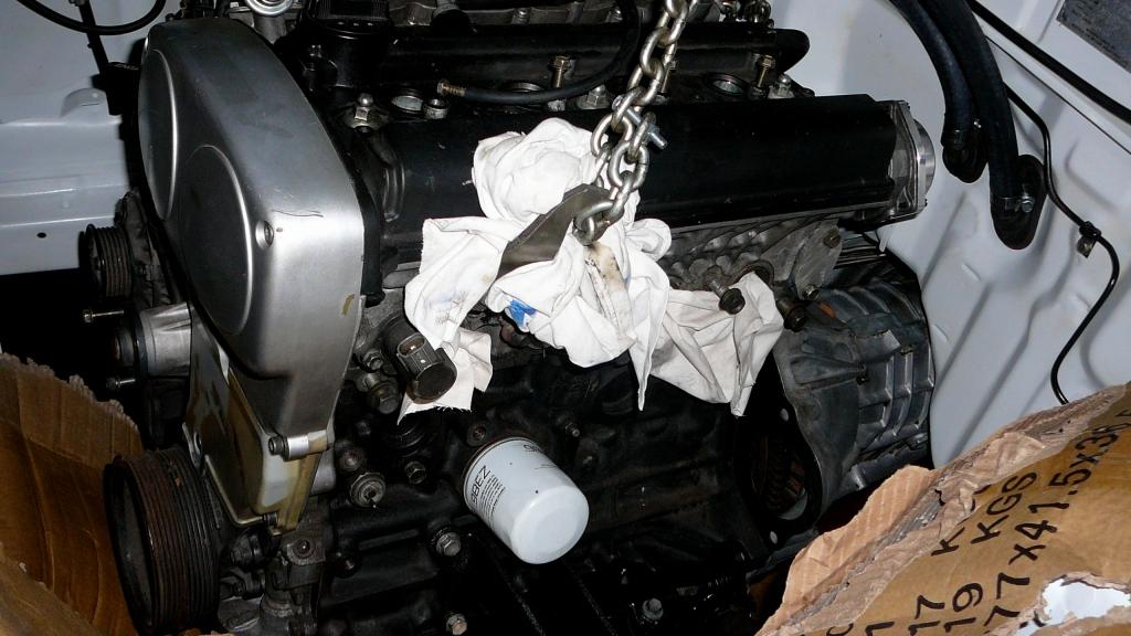

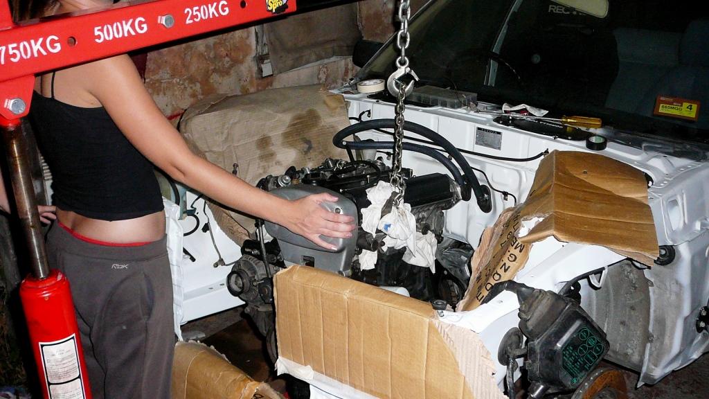

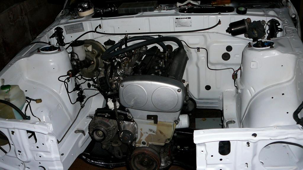

Anyhow, I dropped the motor in as soon as it dried up enough outside. I spent so long getting ready to do it that it was a breeze. 25 minutes and a little help from My girl and it was too easy. I don't think I even dented much or scraped anything thats visible. Hopefully the heater core is ok. I did give it a bit of a rub, you might say, next time I may leave it out while fitting the motor.

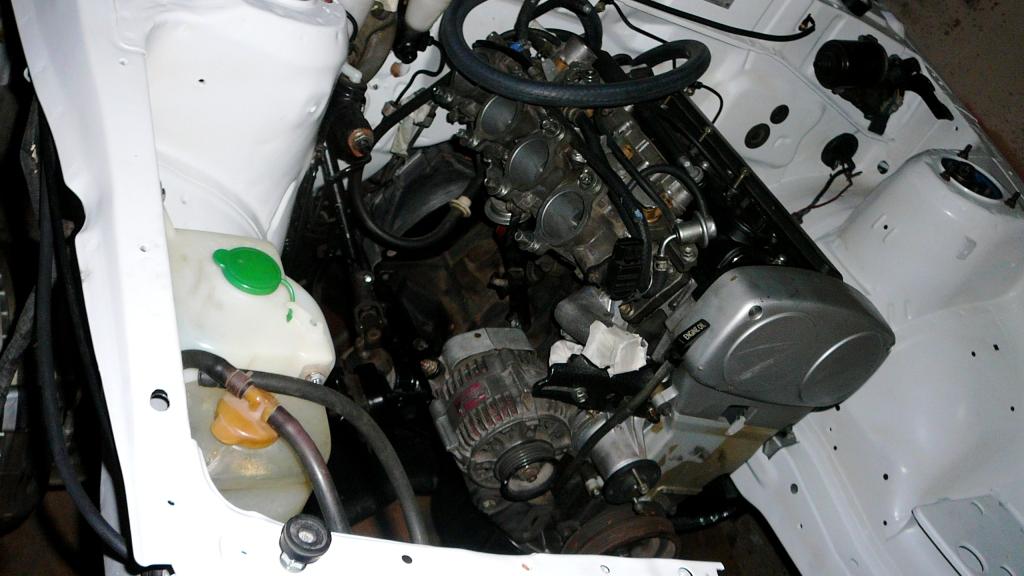

I also went and met rolliac tonight and purchased his spare set of silvertop ITBs. They will work better on this silvertop than the ae111 throttles. Rolliac is the fellow who bought Trevs car, and hes working hard on getting it running.
The ae111 throttles will go on the 2azfe build. Need the extra flow they provide in that application.

Did up some bolts to hold the motor in, had a look to see if the stock heater tap can be used, and it cannot.
Made a ground cable from motor to body. I used 140 amp cable for those playing at home.

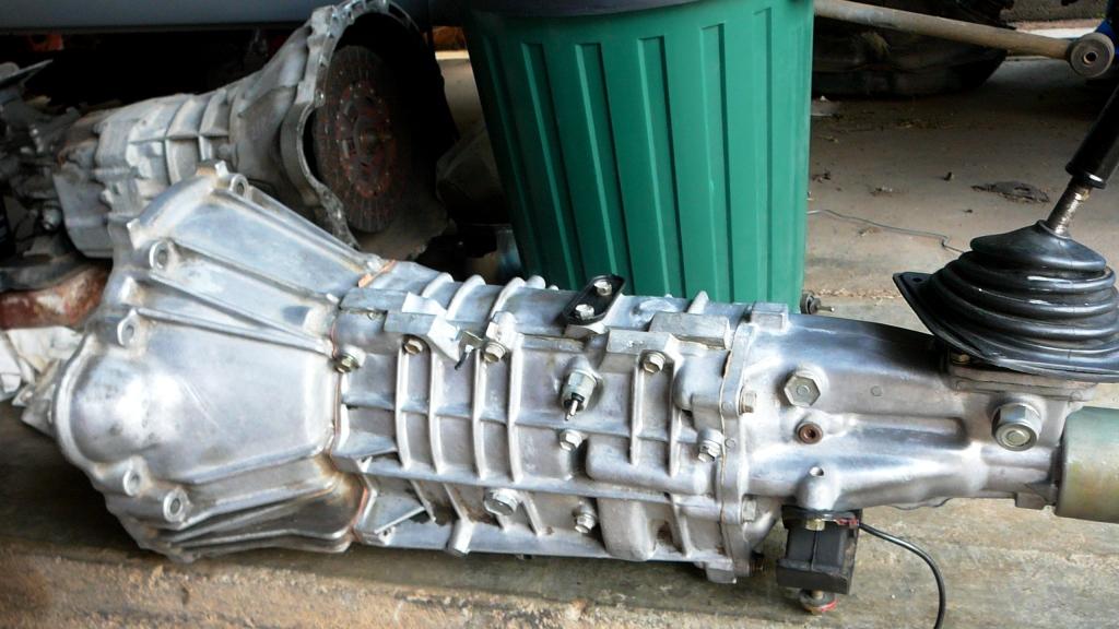

I might slip the shifter into the car, and put the jdm tailshaft in.
