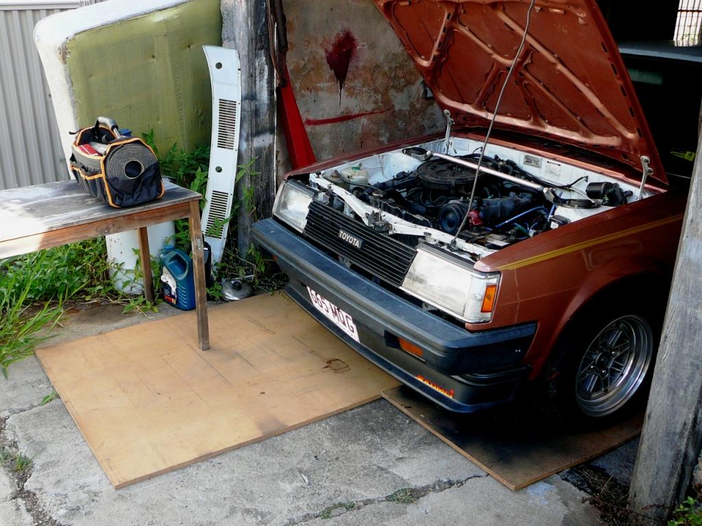

You can see the lip doesnt meet the wheel arches, but once Ive got some serious wheels under it and the rona arms Ill need to fold the flare out further, most likely from right where the lip begins. Should look a bit neater then.

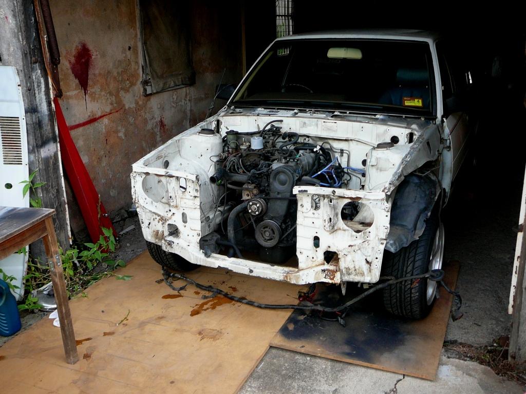

Ive done a bit on it today.

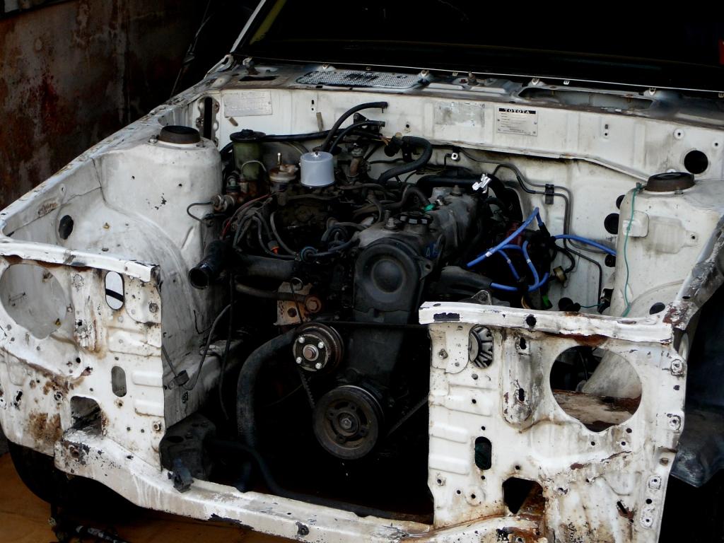

I cut the crossbrace out of the spare shell since the one in the car is bent down and makes the bonnet sit a bit low.
I cut the bent bit out of the car ready to be replaced. I'm going to make the bit that joins the 2 radiator supports removable.
Ive also stripped it back to just a motor sitting loose in the bay.
All I need to do is undo the gearbox mounts, pop out the tailshaft and undo the clutch line, then the motor and box will be lifted out together. I also washed some of the parts for it and cleaned up the starter which I had disassembled a while back. I scrubbed all the grease and grit off it, and wet and dried the corrosion off the alloy casting. Ill lube it where needed and put it back together tomorrow.
I'm gathering a few more bits to go to the powdercoaters, such as the heat shield from the starter, the stone tray, another set of bonnert hinges, 2 bonnet support posts, and Ill probably do the other mounts and the crossmember I have here once it all comes out.

The motor is out and split from the box. Got another fair heap of bits for the powdercoaters.
