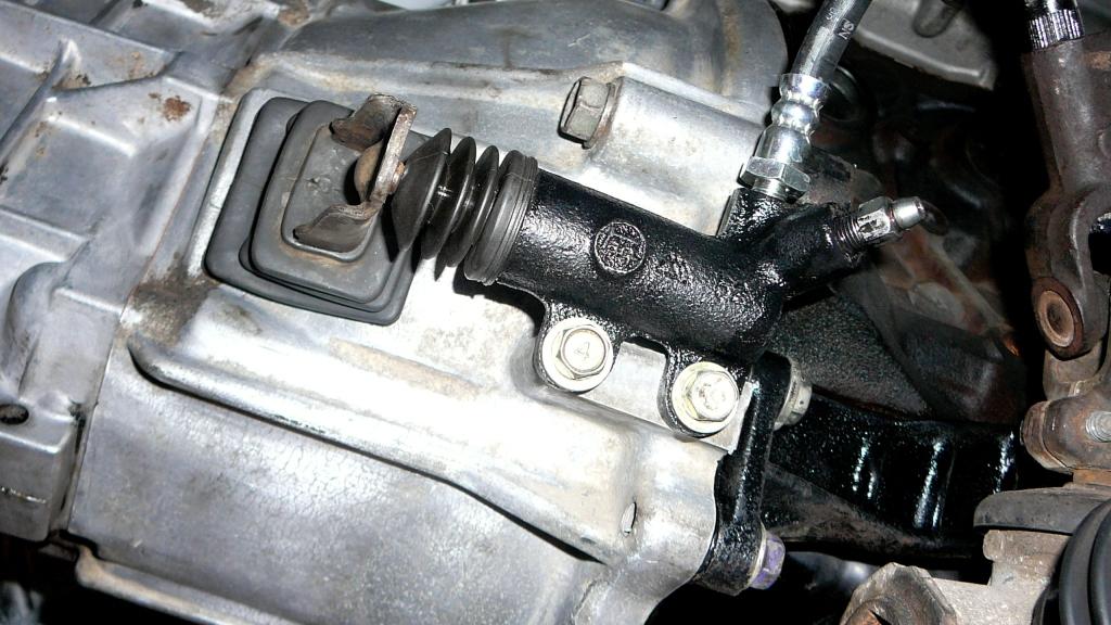

My slave cylinder has been recoed and I got a new rubber hose manufactured to suit it. Exact same as the jdm line.

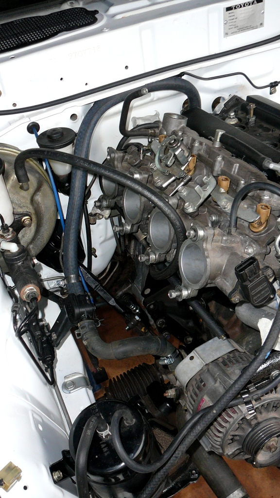

Well i got the heater tap in an awesome spot, down next to the brake bias valves, kinda under the throttles. The hoses are actually quite neat if you ask me the way they flow. I just need an inline adapter to connect the water back in from the heater. Its a widebody Camry tap and a cable from an ae82 4ac.

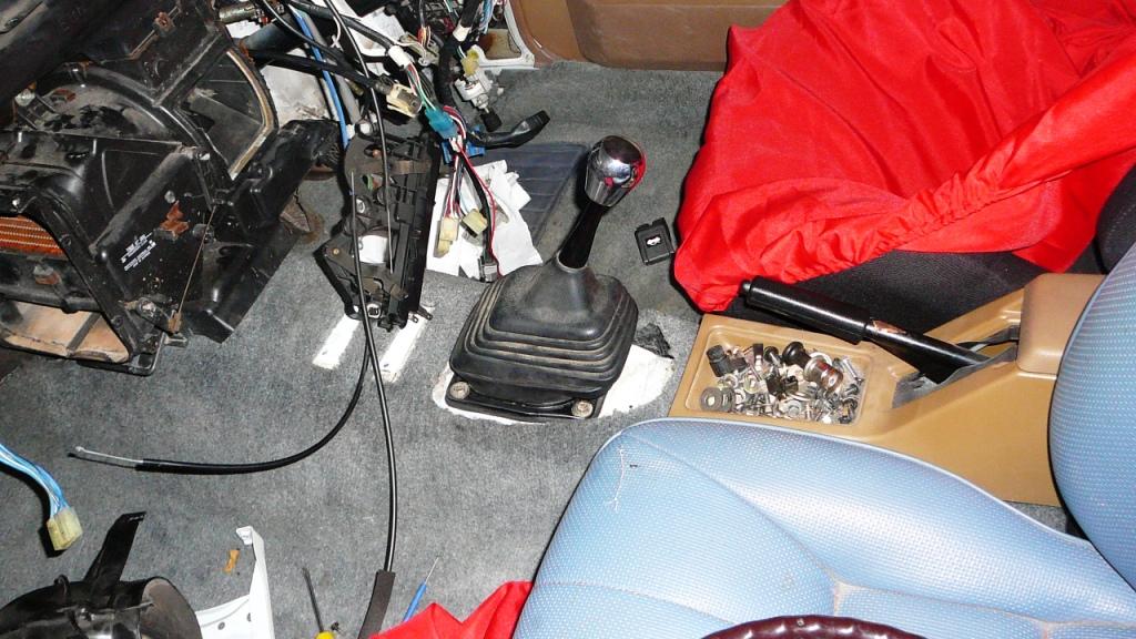

The shifter is in, and the JDM style clutch is set up with a reco slave and new rubber line. My clutch master cylinder was new not long ago. Its basically a new system. I just need to bleed it to get a pedal and thats it for the clutch system.

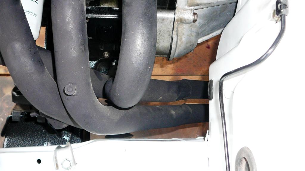

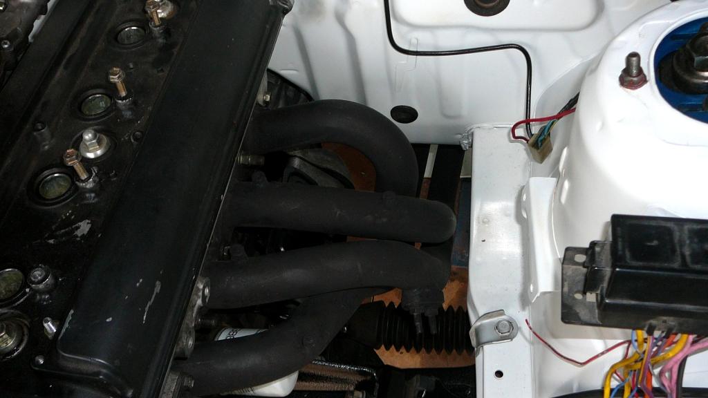

I tossed in the 4-2-1s and they fit great, exactly as I had hoped for, Ive heard some headers for ae86 can foul on the firewall but these are absolutely perfect, they miss everything and don't stick down very far under the car at all.
Ive connected up the brake booster vaccuum hose, and thats about it for today.

just a quick Q: what you mean by "jdm style clutch"??

By jdm stlye clutch I mean i used a jap t50 bellhousing on an aussie t50. i say this just to indicate which side the slave is on.
Its bled and I must say, its light as a feather. So thats one pedal down, 2 to go, haha. Need swap a diff asap.

Oh and for all the people who said it wasnt possible, I fitted a rubber gearshift boot from an ae86 to my ae71. All it takes is a slight stretch to the rubber. Ive doubled up the ae71 boot and the ae86 boot to try and keep noise down.

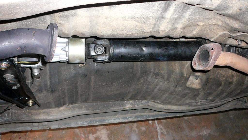

I put the speedo cable in aswell as the jap tailshaft. Ready and waiting for the diff, and I will fill the gearbox with oil soon so I need the spline up its bum so it doesnt run out.
