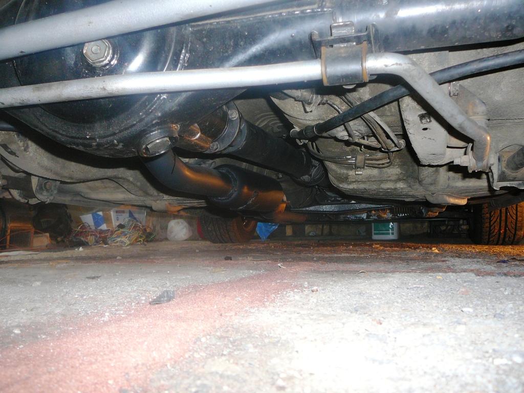

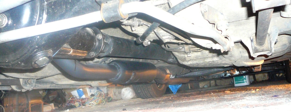

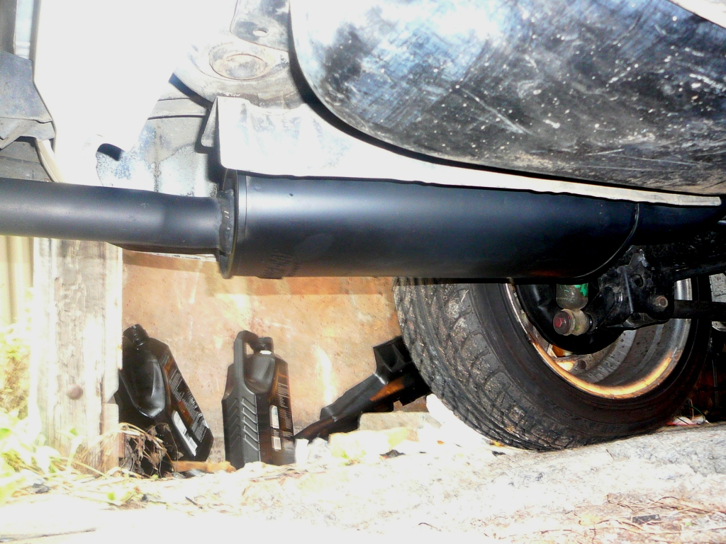

Booked in at 8am, Moss St Slacks Creek. Right Price Exhausts.
Going for a metal cat, 2 inch pipe over diff, single resonator, and just a regular muffler. Should sound a touch quieter than before. Its super stealthy now. A bit too quiet with a stock ae71 rear section.
I go past there like ten times a day for work, they are always very busy and see some quality cars in there too, I'm sure the job will be top notch!
The thing goes great with the new exhaust. Its running a tune that had a different sized exhaust, different headers, different size throttles and different trumpets but f@$k it goes good. I can highly recommend going to 2 inch pipe even on a press bent exhaust. It so grunty now. Exactly what I had hoped, and with a tune it can only get better! There was a dyno day on next to the exhaust shop, I was tempted to drop in and see how many kw it made.

That's awesome dude. It's funny how some people get carried away with peak power figures, rather than how well a motor lays down what it has
Its more responsive from low revs and it still pulls hard at top. Feels much solider than before. Much nicer to drive.
Its not like its got 312s and massive lift to flow for, its a stock head with 256? duration cams. No need to get too carried away with peak figures on this type of setup. They had 4-2-1s from the factory...

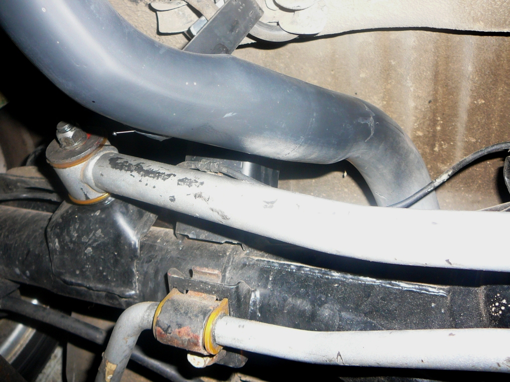

Thank you gents, thats the goal, tidy and stock at first glance. He went and painted it flat black i don't know why but I don't really care, its less noticeable and I'm happy how smooth the diff bend is this time, however its a tiny bit too smooth, its just able to clip the panhard rod at the top of the rear left suspension travel. ive been meaning to dial in more compression damping, so I will try that. See if it slows its up travel. I will have to lower the front 5mm too.
You've outdone yourself once again Matt. Can't wait to be cruising with you. I would be happy if my car was 3/4 of this :laff: Haha.
resonator looks to be a long way back on the pipe?
might help with back pressure?

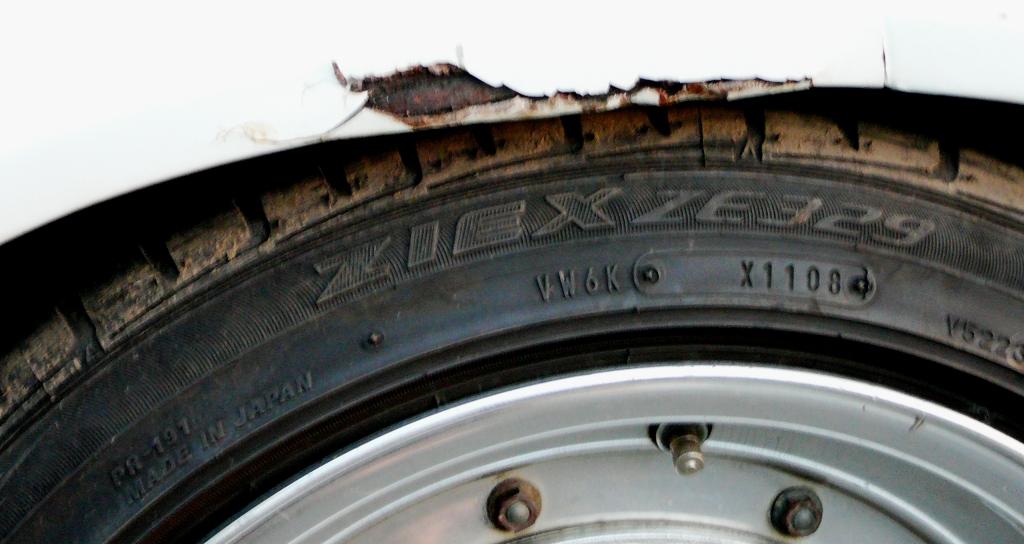

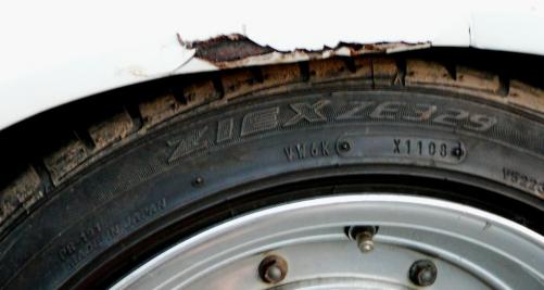

i will fix that rear arch as soon as we have some 8 inch rims to fill those guards..
