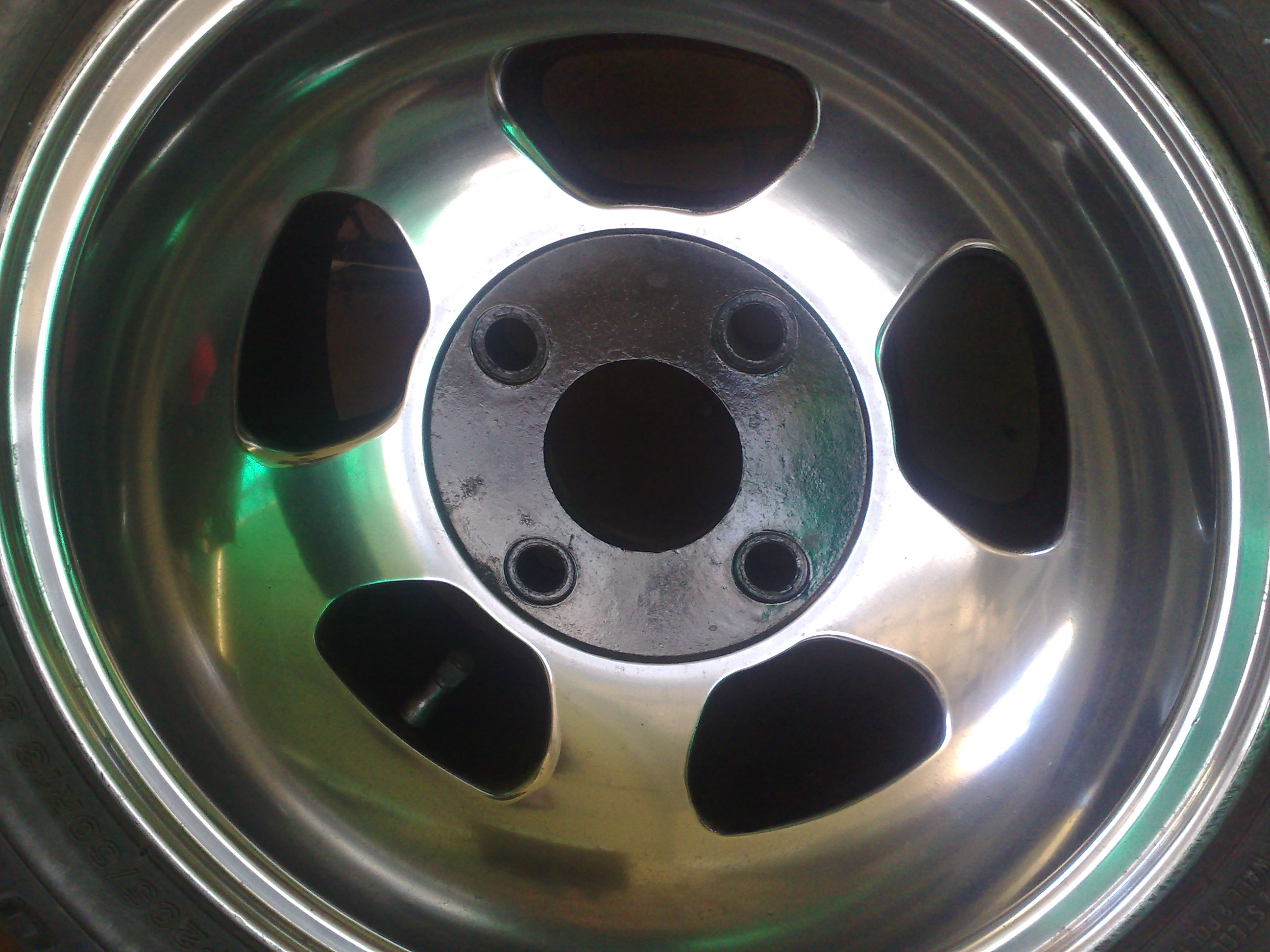

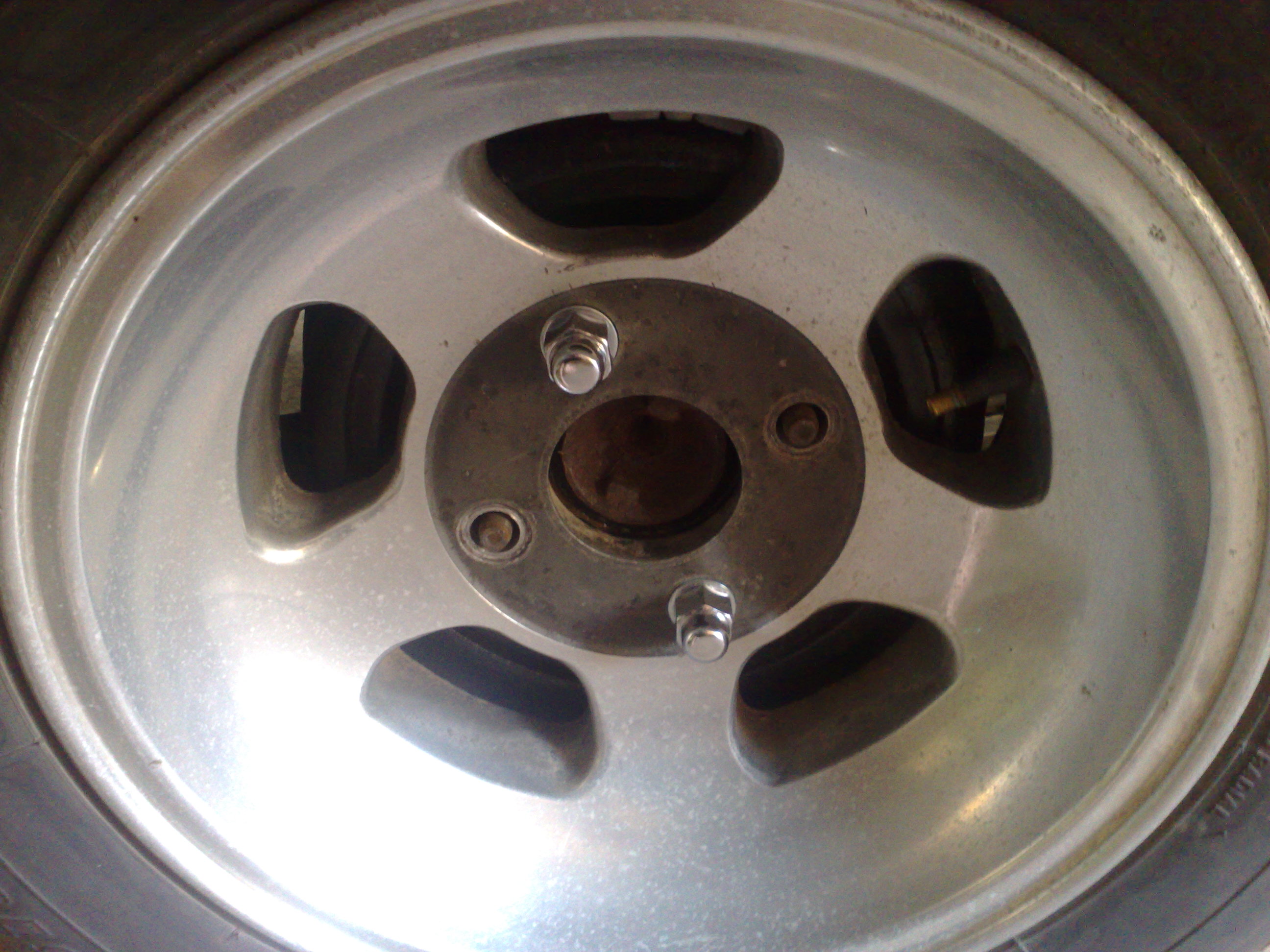

November 25, 200917 yr Author comment_393438 Okay, so inspired by Mungi Mods, i finally got around to buying some sand paper and some Autosol so i could begin polishing my wheels. I went 600, 1200 and then 2000 grit sandpaper and then hand polished it with Autosol and it came up like brand new... After that, i taped the wheel up and sprayed the centre of the kidney bean holes and the centre of the wheel in black. Its my first time doing anything this extensive to a wheel and it wont be the last cause it came up looking much better then i thought they would. Ive put up before and after shots of the wheel i polished, and when ive rolled the guards and the car wants to move again, ill put some more pics up of them on the car. :wink: It took 2 hours to do this one so theres definatlly some elbow grease required. :wink: Heres the pics. Before After Edited November 25, 200917 yr by KETURBO25 Report
November 25, 200917 yr comment_393457 so shiny! hey man, you can buy a cloth buffing wheel for drills, about 100mm round for about $10-15. use autosol with that and your arm will hurt a bit less! Report
November 25, 200917 yr Author comment_393462 Now theres an idea! Ive still got three to go dude so some futuristic contraption like that could be the answer my poor shoulder needs at the moment! :wink: Its just another one of those times where i find my self saying Why didnt i think of that? lol :wink: Cheers m8. :hmm: Report
November 25, 200917 yr comment_393543 39.95 at bunning .. comes with a stitched one used with grey compound and a cloth used with white goes in your drill but no substitute for sanding by hand unfortunately.. once theyre buffed give em a hit with autosol and bling bling..................... Report
November 26, 200917 yr comment_393619 Should be alright to give them a hit with the drill then hand polish for a final finish though wouldn't it? Report
November 26, 200917 yr comment_393668 depends on condition.. i sand every wheel i do simply to remove any scratches and marks and to be sure i have a perfect surface to buff most old rims have some form of oxidization which the buff will remove but it takes a long time to get the same results Report
November 28, 200917 yr comment_394130 depends on condition..i sand every wheel i do simply to remove any scratches and marks and to be sure i have a perfect surface to buff most old rims have some form of oxidization which the buff will remove but it takes a long time to get the same results what grade sandpaper do you use to sand them back ? Report
November 28, 200917 yr Author comment_394135 what grade sandpaper do you use to sand them back ? Not sure what you meen by grade, but i went 600 1200 2000 all wet rub. I just got the sand paper from a auto shop, did the trick! :jamie: Report

December 10, 200916 yr comment_397026 what grade sandpaper do you use to sand them back ? here... :hmm: http://www.rollaclub.com/board/index.php?showtopic=28552 all wet rub is the go... not so good for fingers but nice finish :( Report
