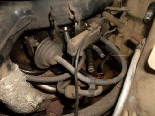

There are NO diagrams so i have no idea what to rectify renew. Read the whole carby bit of the manual and still can't find a diagram showing this part. If you could point me towards what it is or a photo i would appreciate it.
should be on top of your carby mate.
take the whole airfilter assembly off and have a look at the links. one should go up to top of carby and it pushs a plunger down. thats your accelerator pump, i drops a blob of fuel in to compensate for the sudden change in air been sucked in by pressing the throttle. If its sticky, or the bit the fuel comes out is clogged, it wont function properly and youll get the problems your having now.
i replaced mine and set it according to the Toyota K motor Yellow manual and bam, havnt had a problem since.
Good luck, will snap some pic tomorrow if i remember :lolcry:
