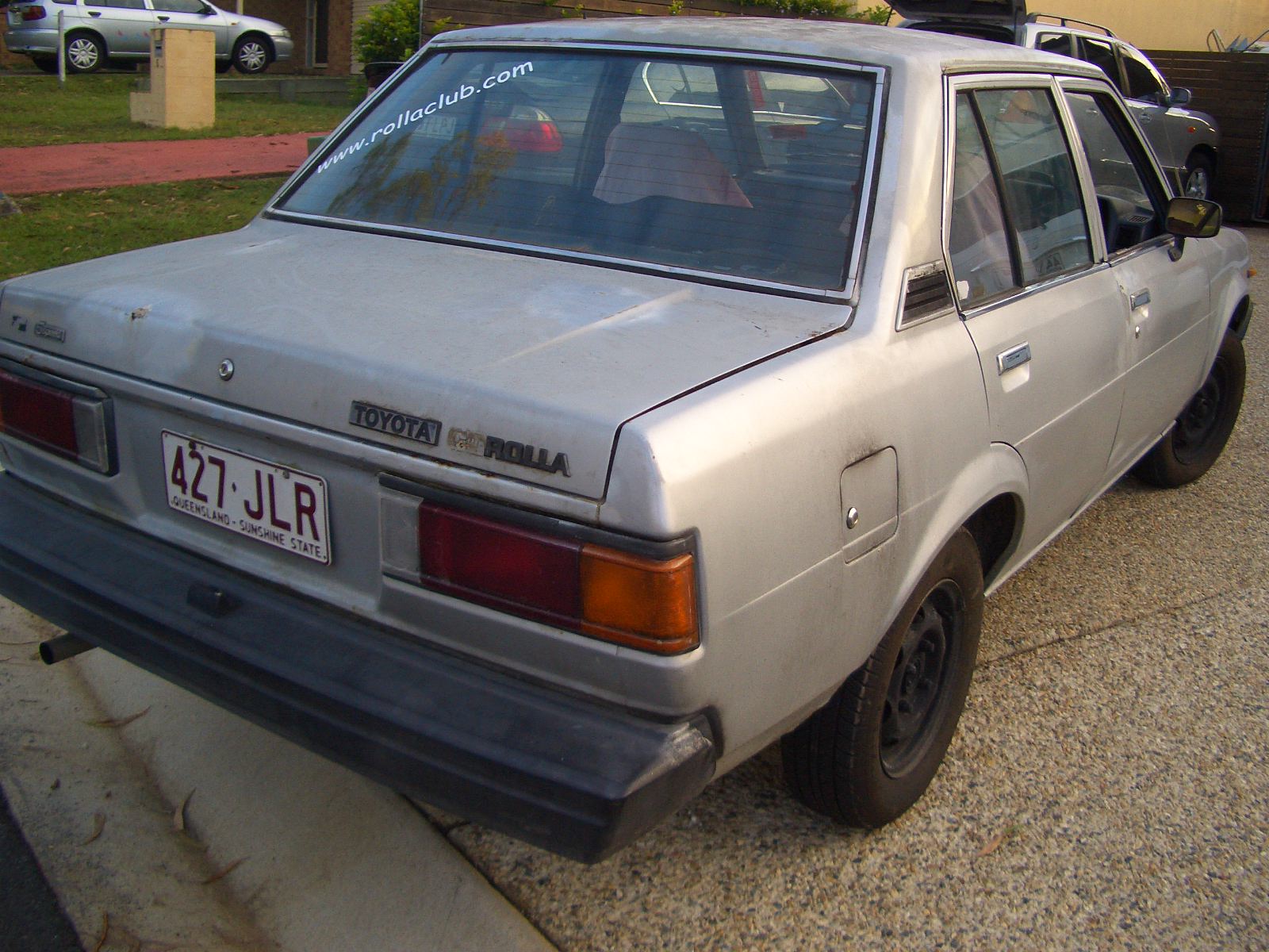

Hey fellas, i just got this ke70 of my uncle it was his daily. but sat at his place for about 9months. i asked him if u could buy it and he gave it to me for free. went to pick it up poured some new fuel and kicked over straight away and it runs overrated no engine problems or gearbox :P
i know it's not the best rolla out there but i got it for free with 6 months rego. and shes full of potential. :yes:
it's a standard 4k 5speed series 82 model ke70, mods so far;
interior, new seat covers, new geer stick knob GReedy, currently installing a cd player and 3 tacos. oil pressure, water temp, and volts meter. water temp is the most important atm cuz my temprature gauge isnt working on the new dash.
it has had a taco dash installed on it, also has new brake booster and master cylinder. just picked up some sick RollaClub stickers today added an extra 40hp id like to think :)
it still needs a fair bit of work, but plans for the future so far are,
extractors & exhaust, sit on lower springs, sway bars, a set of wantabies I'm picking up next week, new steering wheel, webber carby with better air intake, unsure what diff to put in it atm, going to sand it back remove most of the bad rust, primer then Paint with Satin Black. should look pretty overrated. there most of the main upgrades i'll be doing. alot of small things aswell.
Let me know what you guys think, i know it's a bit of a heap atm but its got potential.

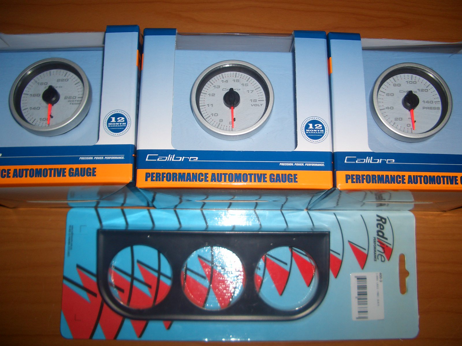

New gauges i bought :)

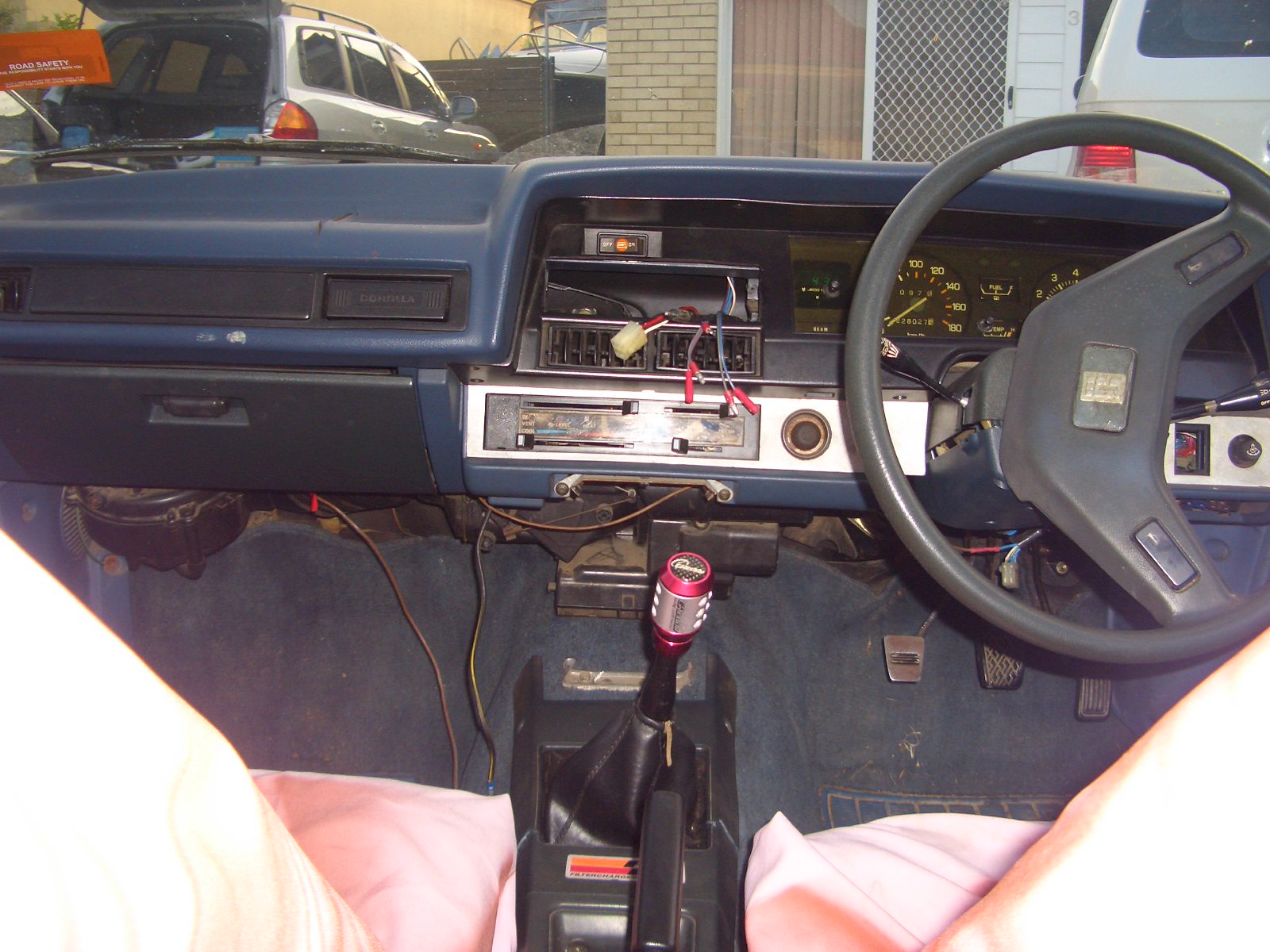

The interior as i pull the old stezza out, and starting to wire up the new one.
Let me know what use think :lol:
