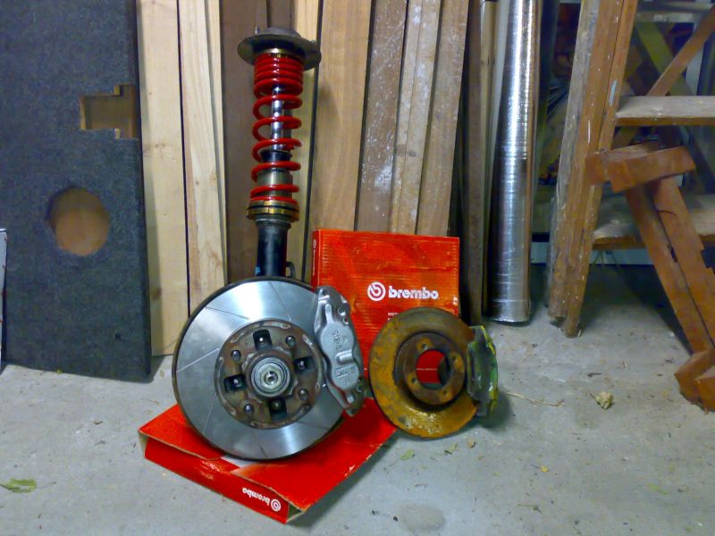

I have the usual Corona Strut, Peugeot Rotors and Landcruiser Calipers on mine. I had the Strut cut down to suit SV21 KYB shocks and had a Pedders coilover kit fitted.
I've also upgraded to a VN V8 1" Master Cylinder which bolts straight up to a KE55 or 30 Booster (you'll have to check which bolt pattern is right).
The stock RX7 brakes from a S1,2,3 are not worth rooting around with. The later model calipers are popular, but thats about all.
If your after simplicity, this is one of the easier proven conversions. Chuck some good pads in there and they pull up like nothing you've owned before.
Mine V's Stock - You do the Maths

Yes the PCD is the same. You use the Corona hubs which are 4x114.3 as well.
15"s fit fine. I had trouble trying to find 14"s that would fit, when i was troubleshooting my excessive front track.
The only machining will be to the rotor. They just foul on the caliper, so they have to be machined down 2-3mm in diameter which your brake shop can do.
The pads don't contact the entire face of the rotor (they stop a few mm from the outter edge) so there is no problem with them over hanging the outter edge of the rotor.
The holes in the rotors have to be drilled 1mm bigger in diameter so it bolts up to the hub.
You can actually use (S5 RX7 ?) pads in the landcruiser calipers. So that opens a whole world of selection when it comes to pad choice.
