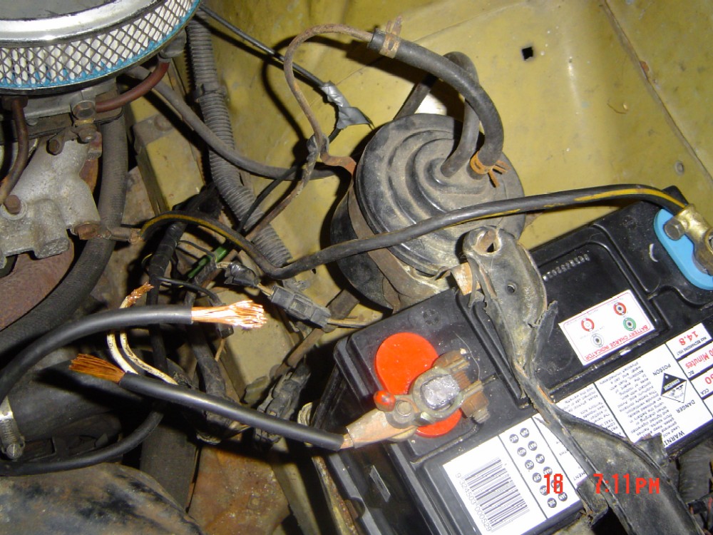

KE30Coupe Posted July 17, 2005 Author Report Share Posted July 17, 2005 Update...........I decided to play around with a few wires over the weekend before undertaking the task of a rewire, I really need to hear the rolla start. 3 recharged batteries later I finally got a spark at the plugs just as the battery went flat for the 4th time. I'll get some pics up tonight of the incredibly professional job the previous owner did with the wiring when he relocated the battery to the boot. Quote Link to comment Share on other sites More sharing options...

KE30Coupe Posted July 18, 2005 Author Report Share Posted July 18, 2005 (edited) OK some pics as promised Unwrapped a heap of black electrical tape and found this. Note the exposed wires, especially the thick red one which you can see connected to nothing down near the altinator heres some more wires that don't connect to anything the positive battery terminal in the boot this is the bolt that holds on the bumper which also served as the eath point for the battery in the boot don't even look under the dash away from the wiring heres a tip for those with a choke cable that doesnt work........2hb pencil and finally my patented racing seats with specially designed speed tears :( Edited July 18, 2005 by KE30Coupe Quote Link to comment Share on other sites More sharing options...

Ratty Posted July 18, 2005 Report Share Posted July 18, 2005 I had a simmilar problem in my ke35, i had power untill i turned the key to crank over the engine then nothing i replaced the main wire from the starter motor which is a pain to get too :( then i checked the negitive wires on the starter and replaced them and it works now i also replaced the main earth from battery to manifold all connections are tight and clean and i have a new battery too which helps Quote Link to comment Share on other sites More sharing options...
Ratty Posted July 18, 2005 Report Share Posted July 18, 2005 the cut black wire is the main power to the starter the cut two little white wires are from ignition i just need to join them together don't know if it helps much but if you can sort your starter motor wires out u might have some luck :( Quote Link to comment Share on other sites More sharing options...

KE30Coupe Posted July 23, 2005 Author Report Share Posted July 23, 2005 Update Found a spare hour in my busy Saturday and decided to play my favorite game, "Whats under the electical tape" =) Boot at the start Time for "Whats under the electrical tape" this is the positive lead from the battery. Removing the tape revealed this A bit of cutting, drilling and we now have a battery firmly in place with nice looking cable running to & from the battery, earthed to the chassis and no exposed cable showing anywhere And finally the finished boot :D Tommorrow we tackle the engine bay Quote Link to comment Share on other sites More sharing options...
