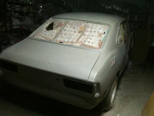

Pictures of me guards & bonnet in primer:
now just got doors left to do. will get right one done but waiting on a rust-free passenger side one as mine has rust all underneath it :no2:
