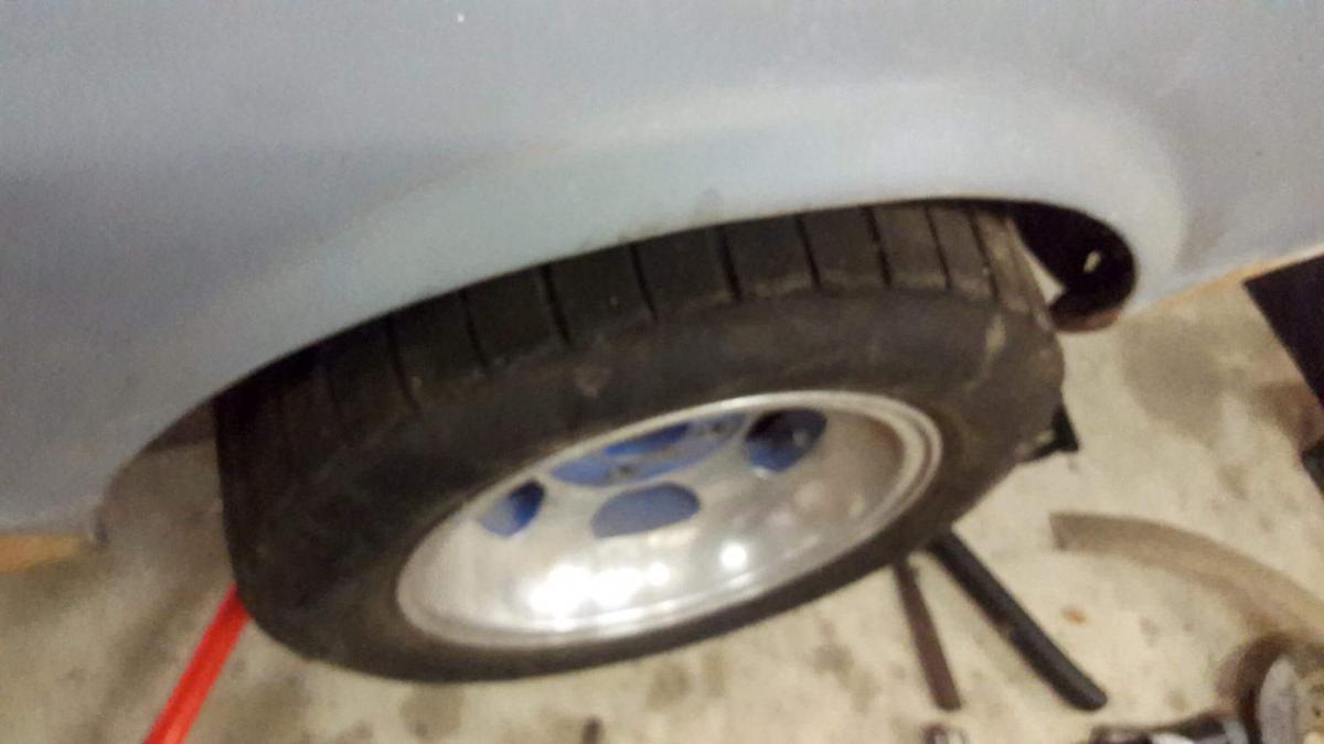

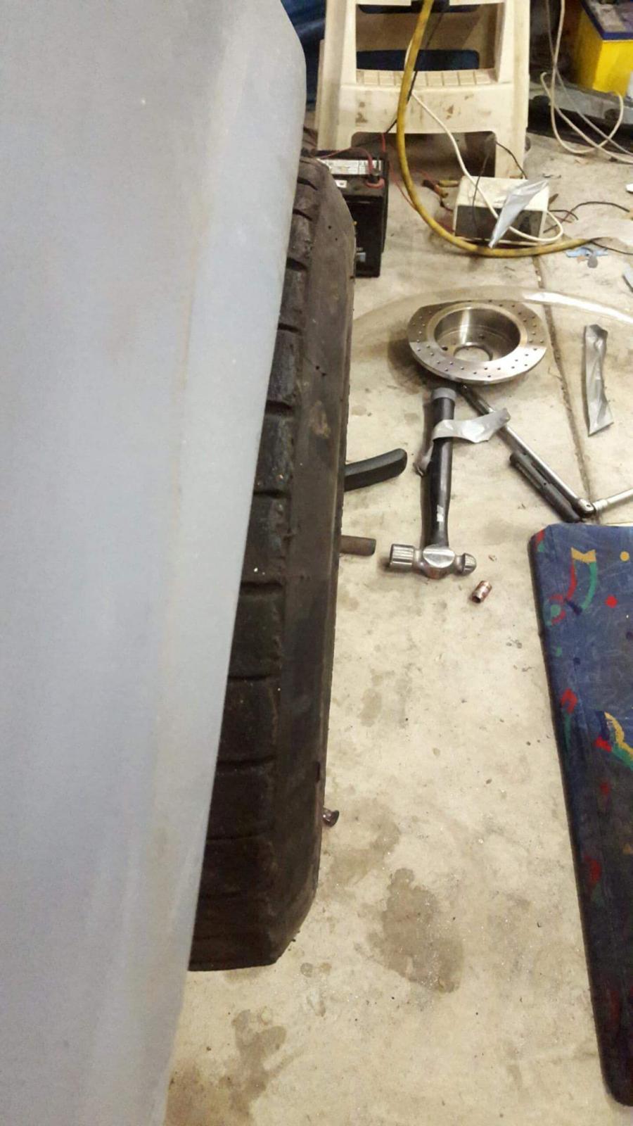

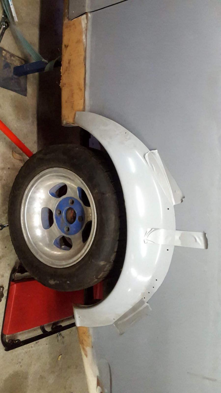

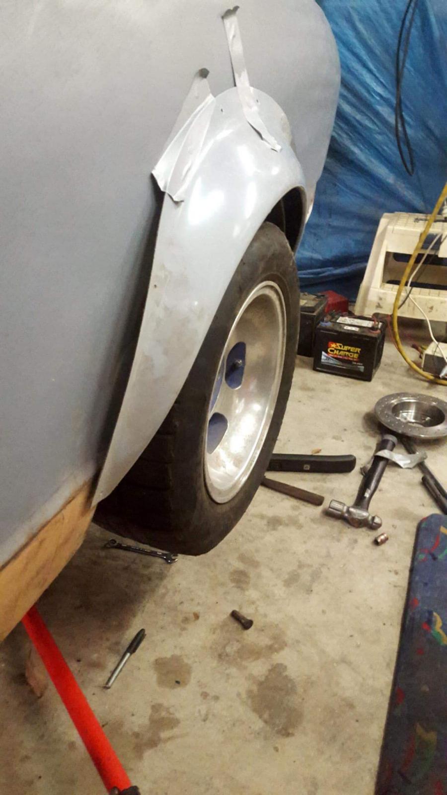

Need bigger flare's.
Not happy with these so will keep looking.
