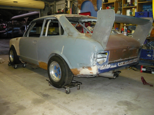

  • She is back on all four wheels. Next we will be looking at flares to cover those wheels and a front splitter.
  • A bit more progress today. Slowly coming together.

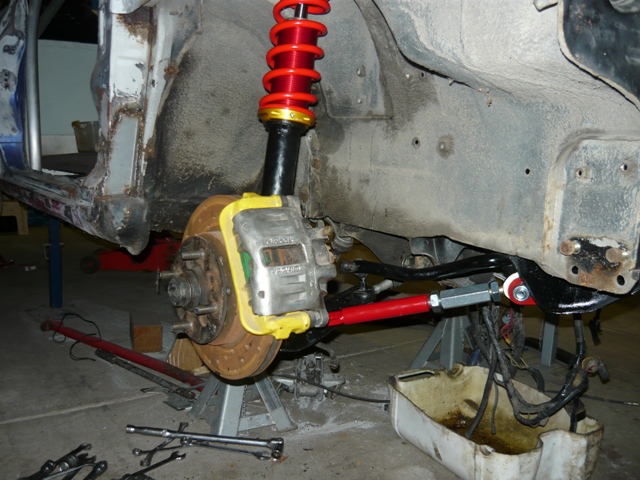

A little bit more work on the 20 over the last week or so. Starting to take shape.

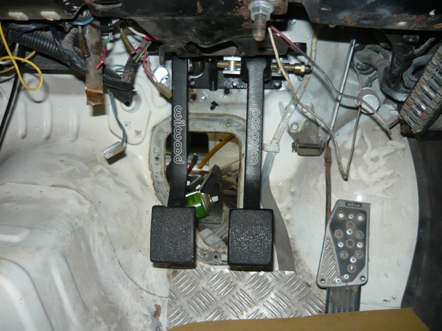

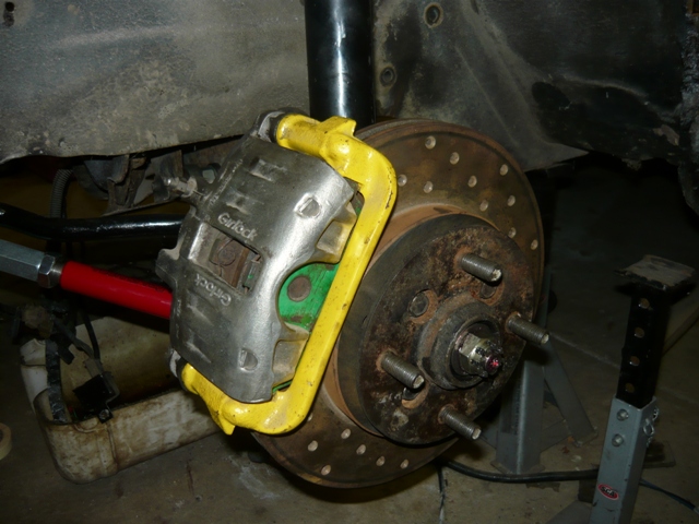

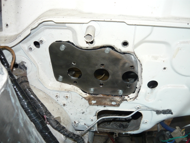

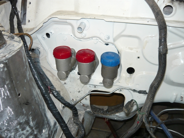

Started with the brakes. The old single master cylinder system got the flick and replaced with a Willwood  adjustable bias setup.

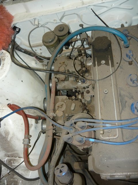

Original setup.
 P1010357.JPG.cfef7e2d6af94911067544e6c7fcb6ae.JPGP1010475.JPG.e576304921083956caebfc6c4c17757a.JPGP1010476.JPG.701b0f0268cd5fcbe418959f8198f7c3.JPGP1010480.JPG.a3c6e47ebd5c659f593eaed6428cb1d9.JPG

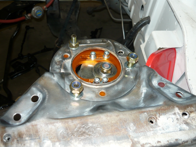

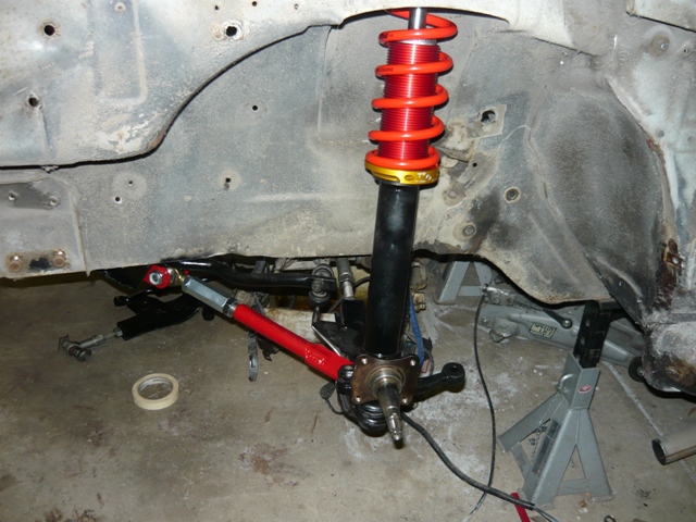

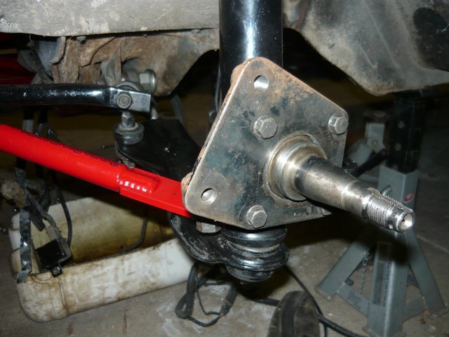

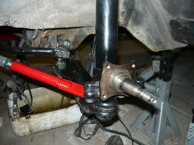

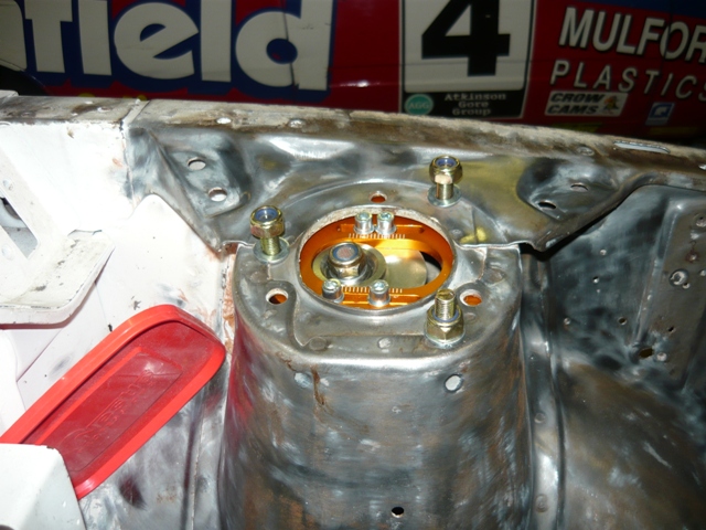

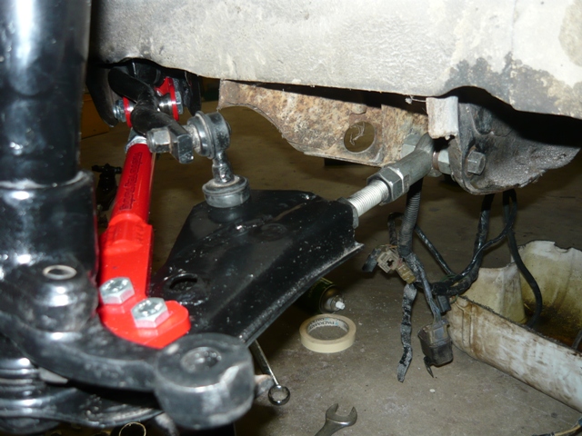

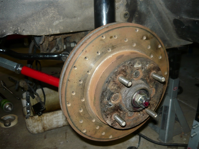

A bit of front end work.
P1010532.JPG.5bb575c16a84e9b2efef7a134929e23e.JPGP1010516.JPG.7fa703b723cb8d48a81c7dfcc7547b64.JPGP1010517.JPG.eb8ca3d0e324f28628cd9dca881e0f43.JPG
P1010550.JPG.13f283418d37dde0c2a4b829f0f5c466.JPGP1010546.JPG.dad14f8dcfde21e8d5d7a8ba7941adc7.JPG
That looks badass, nice work.
quick question, are you using a quick steer knuckle (shorter steering arm)?
or is that just a roll centre adjuster.
That fitment is spot on. Good job!
Also, whats your review on the coilover kit?
No KE1069, standard length steering arms.

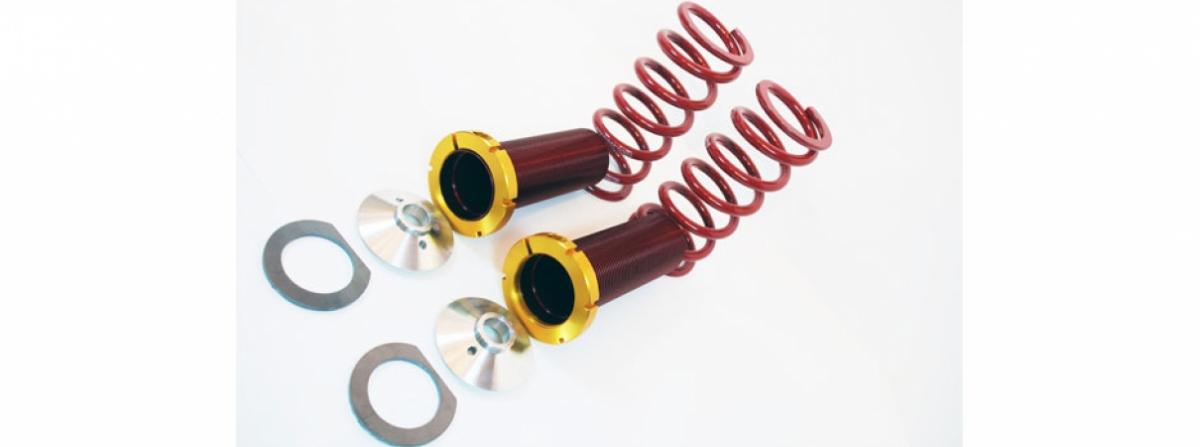

Very happy with the T3 kit. Very easy to do and if you ever need to replace the strut, you just need another Perch and you can use the wrest.
IMPORTANT!!!!!!!!!!!!!!!!!!!!!!!
You must stipulate the size of your strut casing when ordering because they come in different sizes.
