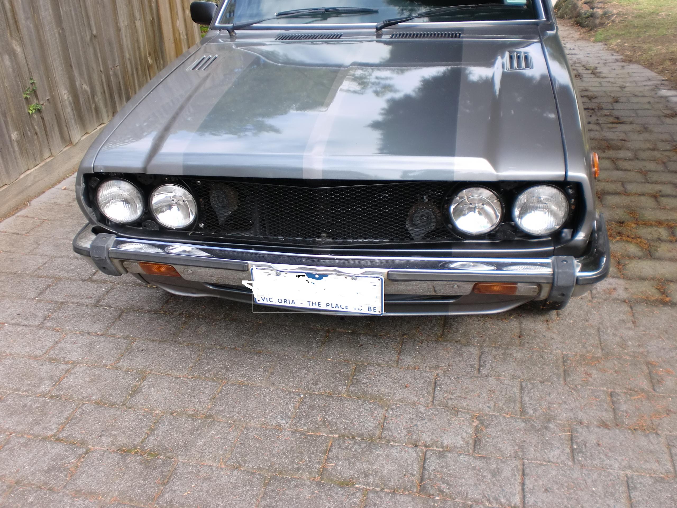

April 8, 201016 yr comment_428149 I know this was a discussion piece a few months ago. Damned if I can find the thread. I pride myself on checking before posting. Anyways, a new member came around on Wednesday and bought my exhaust. You know who you are! He had a KE55 hardtop. I took a pic of his grill/headlight combo. Lights ex celica. Report

April 8, 201016 yr comment_428196 I started that thread a while back and i think it looks good! I think some more work on the grille could have it looking even better though. Did he give any info about how he mounted it up / wired the headlights up etc? Report
April 8, 201016 yr Author comment_428199 All he said was it was easy. He followed your thread but didn't comment. I suspect the only reason he joined was to PM me for the exhaust. If your out there, REPLY! Report

April 8, 201016 yr comment_428211 I know this was a discussion piece a few months ago. Damned if I can find the thread. I pride myself on checking before posting. Anyways, a new member came around on Wednesday and bought my exhaust. You know who you are! He had a KE55 hardtop. I took a pic of his grill/headlight combo. Lights ex celica. Looks pretty good. Not really all that fussed on the shape of the grill, maybe if that point or angle or kink is taken out of it i think it'll look better. Wouldn't mind find out how he did it. Report
April 8, 201016 yr Author comment_428212 Looks pretty good. Not really all that fussed on the shape of the grill, maybe if that point or angle or kink is taken out of it i think it'll look better. Wouldn't mind find out how he did it. Hopefully he sees this and pipes up. Dude we're not gunna bite. Don't wanna speak for him Boo edit...sent the man a pm. Edited April 8, 201016 yr by Bamboo Report

April 10, 201016 yr comment_428596 Hi, Guys. My name is Neyland, i'm 24, studying mech eng and that's my car you've all been talk'n about. I'm in the process of doing a write up for it, but in the mean time i believe a few guys here were interested in fitting twin headlights to their front ends. It was quite simple i just got a pair of TA22 lights and painted them up. I'll just speak about the left light looking at the front of the car. 1. Dummy fit the headlight using the top left existing mount. 2. Measure the distances from the headlight mounting holes to the front end of the car. 3. Get yourself some strip steel and make some mounts i think 15mm, 40mm, 50mm deep from memory. I just bent some basic T shapes and drilled holes and welded a nut into the centre of each one. 4. Weld mounts 5. Bolt the light in 6. Wire it up The best part is i did not take any of the existing mounts off, so if need be i can just cut the new mounts and bolt the old lights and grill back in. As for the grill being plain, i'm totally aware of that and i have found a Punisher belt buckle and some studs i'm gonna bolt in the centre of it. It was suggested to me to run chrome bathroom bars across as a grill but i opted not too. As for looking like Elenor, i did gain inspiration from her however it was never my intention to make a look-a-like. It is simply a combination of my own tastes. And you are all right, it's still a rolla which i love don't get me wrong, however it is also a learning tool for me! Just a fun 1. Plus the best part is i've only spent approx $500 in total on here in the 2 years of had her, as the paint, spray booth and guidance were provided by some very generous mates!!! thanks Brendon and Shannon at C5 Systems! If anyone has any questions please just pm me, and i'll do my best to help. Report
