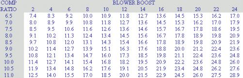

so 4k with 4k head 9:1
4k with 5k head 14.88:1
5k with 5k head about 9.08:1
5k with 4k head and 9cc dish pistons 8.38:1
5k D dish with 4k head 6.87:1
5k shallow dish with D dish head 12.2:1
ask if you want to know any more head block config's
3k heads on 5k blocks? both types of pistons?
if anyone can give me the cc of a 3k head i can do that i don't have a 3k here to measure
45thou thick and a bit bigger than bore size and are done on standard bore there are some factors that will make it different but it is within .25 of the amount of comp
