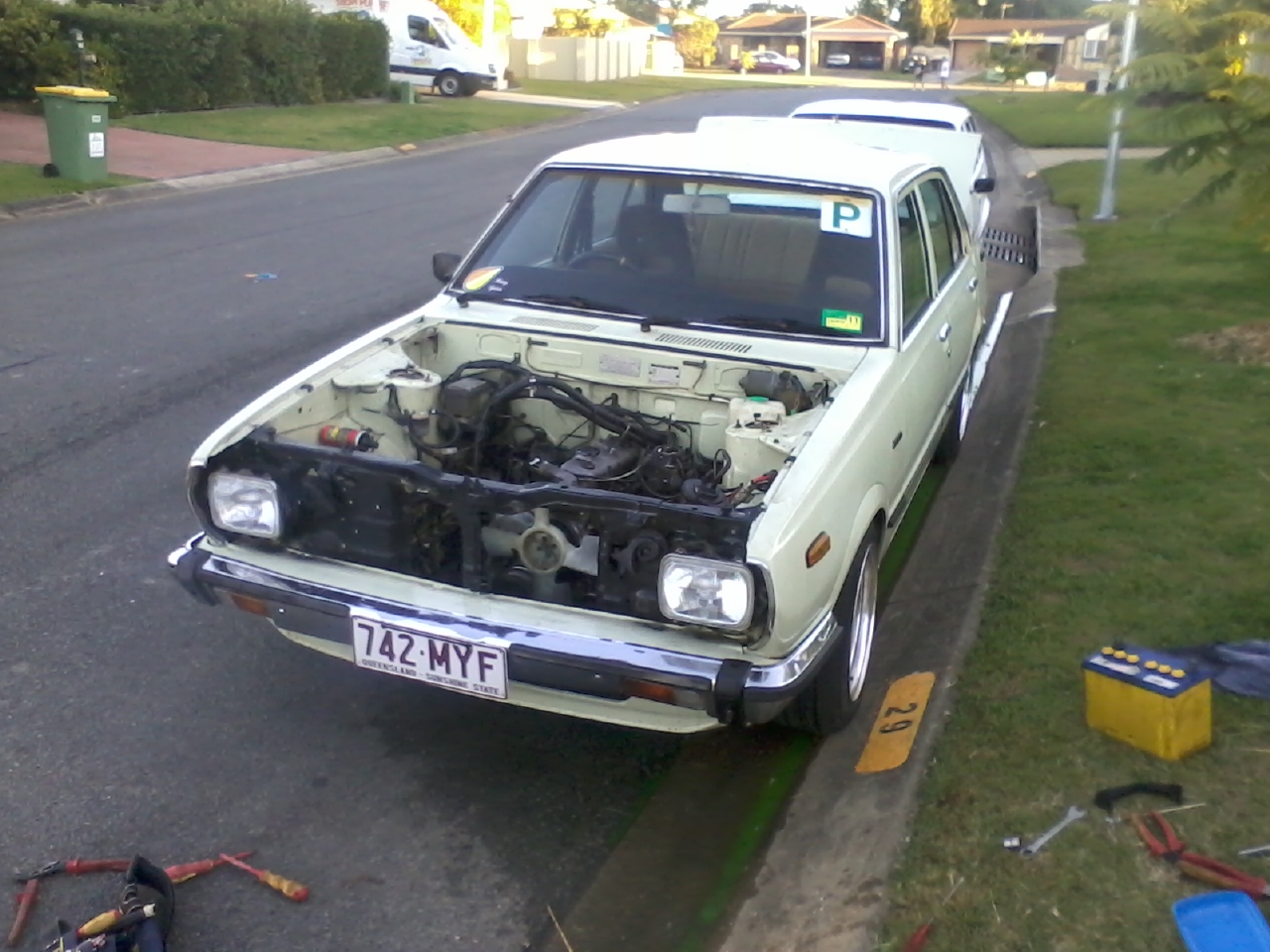

This arvo's work consisted of disconnecting the engine, ready to be lifted out tomorrow.

after many problems i have a 4k in and running.
The reason why the 5k blew up was because the fuel pump. The rear seal had gone and it was not pumping fuel through to the carby, instead it was pumped straight into the block from the rear of the pump. causing the engine to fill with fuel and end up exploding oil all through the bay. :bash:
