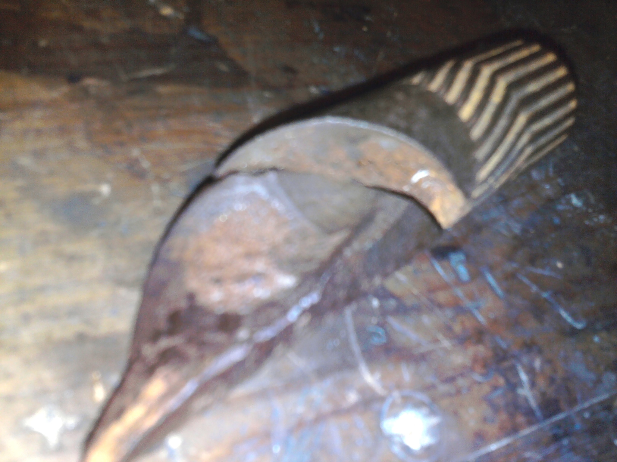

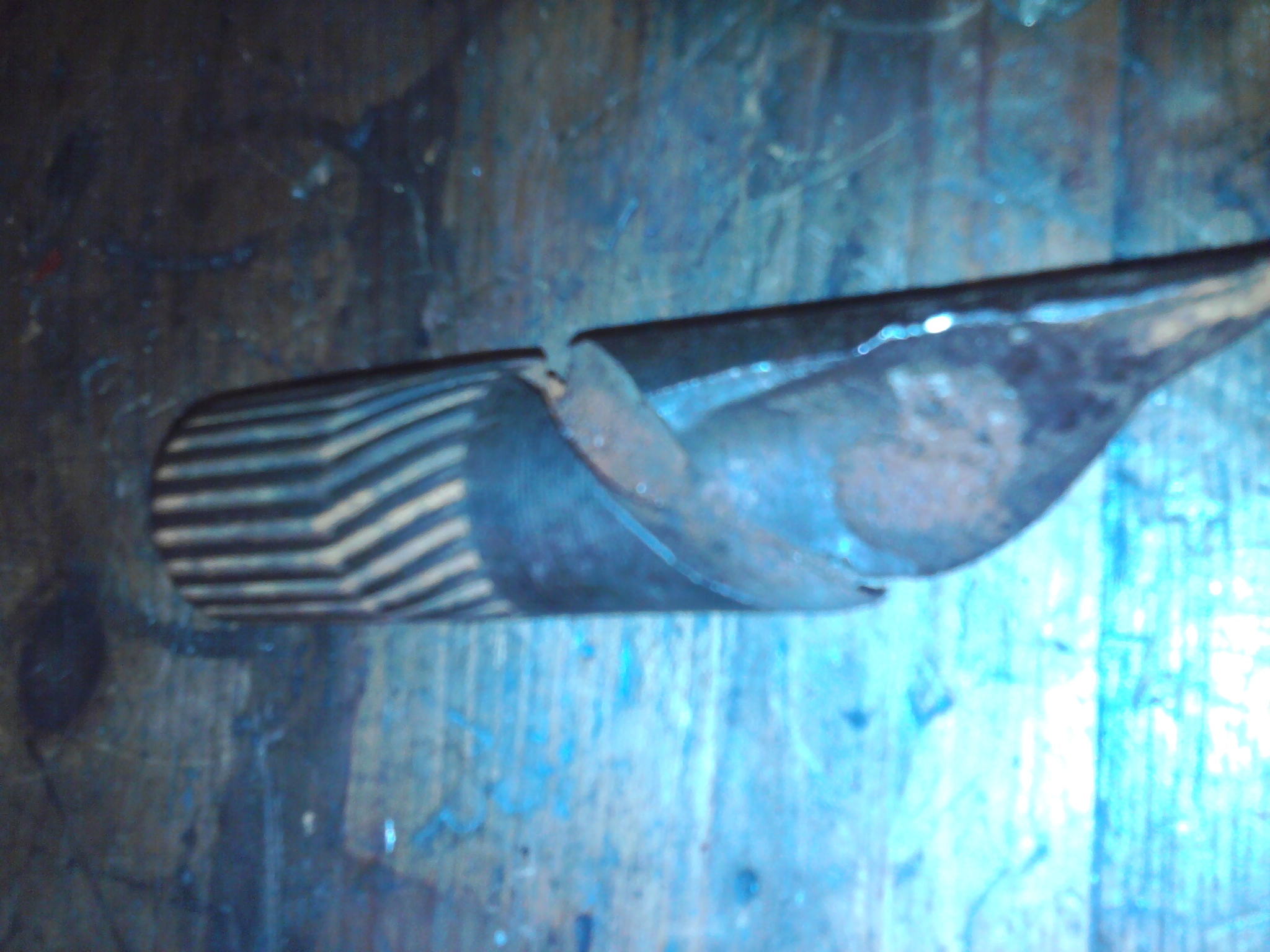

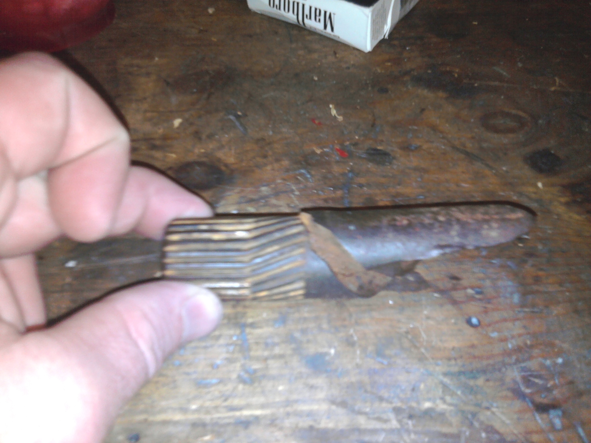

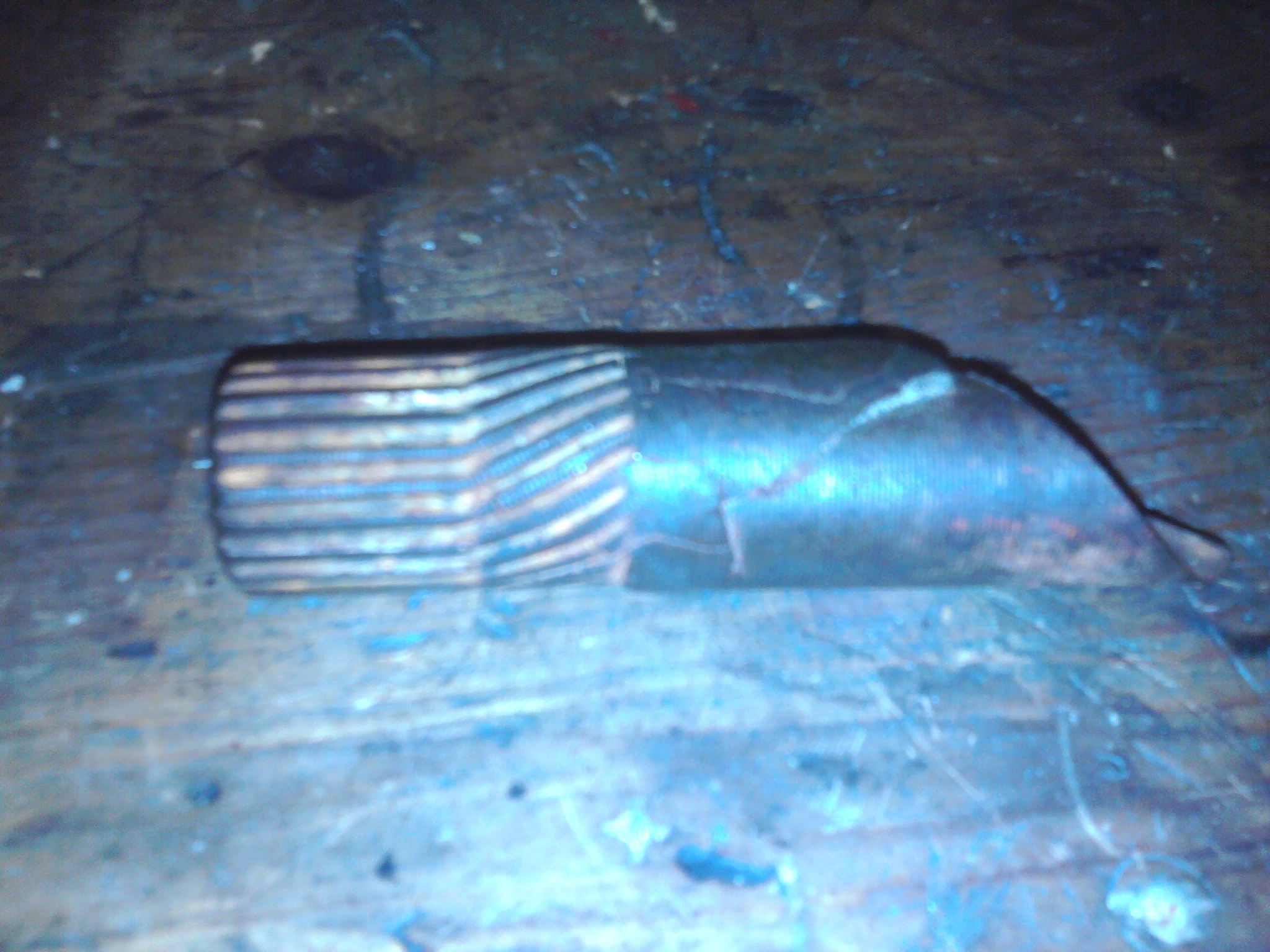

Yeah I'll get you a pic in the next couple of days Tom, in Hobart at the moment. The other 2x I've broken snapped were the spline has twisted on that one. This one twisted there, then continue to twist further down the axle in a spiral break, wait till you see it! :) I can you imagine the trouble I had trying to get the centre out of the housing with that much axle sticking back up the axle tube!! :)

Surely that's been cracked a long time from the rust down in the broken face.
It certainly makes an LSD look good in comparison to locking.
Mantlepiece time! You can show it to your grandkids for "what I was doing when I was your age.."
Yeah I would have busted that one..... :jamie: might have even been back in the CT12 days actually!!! so at least 3-4 years ago.
I've got a few bit and pieces like that for stories between my rollas and the mazda. Busted and bent axles, busted gearbox bit, busted wheels etc. I should get you a pick of my mazda diff "bommy-nocker" pinion. Death with a spline! :jamie:
