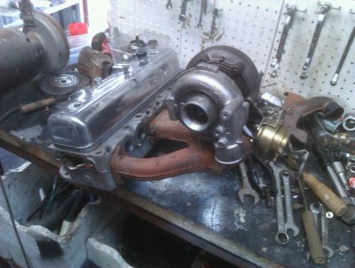

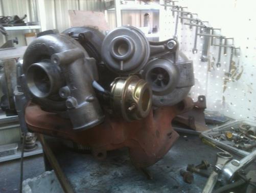

Excuse the long delay, I'm saving up for a holiday at the moment so the cars on the back burner again :P
Only a few things to add really..
I have removed the turbo so I can weld up the internal gate correctly (No bodgey brackets)
Cannot recall if I had said I extended the exhaust a tad (it was running a few weeks ago and was rather loud, didn't want to annoy the neighbours too much)
Not like it does much anywho :P
Ohh and I came up with a solution for a turbo hat :)
Used a LPG hat that actually were used on these webers, ill have to find a way to cut off and attach my pipe to that rectangular inlet but there will be a way :)
Iv also cut the manifold down and having it re-welded shortly (Who knows how long my step dad will take, busy at work)
as you can see in the above it sits about 70mm lower.
Anywho I had to make a new base plate as I had no way of fixing the one that came with it down. No biggy but just a hassle
Also riveted a bracket on to hold the hat down :)
Ohh and I got the adapter for the turbo outlet, but I'm not really happy how it looks :/
Granted the pipes were free and half painted, maybe itl look a bit nicer all black and the hose clamps are cut shorter
Ill also need to make a new tank vent as I have used the vent line as a secondary fuel return to ensure low line back pressure. That or get a vented cap.
