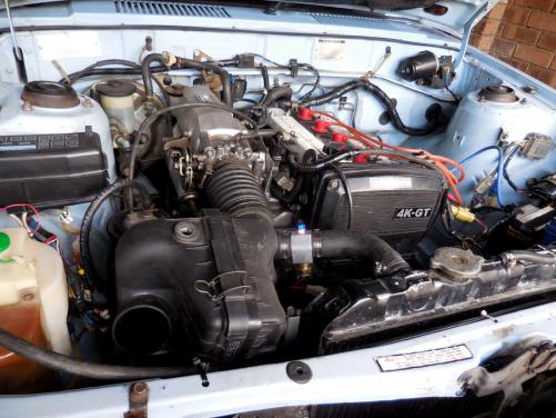

altezzaclub Posted March 15, 2016 Author Report Posted March 15, 2016 (edited) OK! It runs and its just driven the 550km home!! Not dead right, a few teething problems, but it is just the way the car SHOULD have been produced! Toyota would have sold millions of them. It doesn't feel particularly fast unless the revs are up over 4500, but it is effortless in climbing hills. The temperature sits at the halfway mark, between the "e" and the "m" and doesn't move. Maybe the thermostat is set that way. It heats up sitting at roadworks and I'll get the fan thermoswitch fitted when it arrives. Slightly heavier in the steering, it doesn't dance around like it used to. Still a great car to drive in hilly country and once you turn the steering at the beginning of the corner you can hold the wheel still and change direction with the accelerator. The clutch is heavier, as is the gearlever. The T50 is not as nice and slick as a K50. Its noisy from the exhaust, I think 2" is bigger than it needs to be. You wouldn't think so living in Sydney perhaps, but after 5 or 6hours you don't want it. The cat converter has Nissan on it, and a 3" pipe into it, so its off something like a Maxima and plenty big enough for a 4AGE. Not as economical as the 4K, it does 7.9L/100 instead of 6.9. The difference is the extra 10 kph in speed and better hill work. The idle is erratic, sometimes sticking at 1500rpm, sometimes dying right back and stalling. It suffers from over-run snatch too, just touching the throttle when cruising around town where you just have your foot off. That very slight delicate transition seems to be difficult, the same with the SU carbs. Probably both problems are air leak ones. So, it would be much easier the next time around, I'll write up a new topic on how I did it. This would be one of the cheapest conversions ever done- excluding the motor and gearbox, the rest came from the wrecker or random cars around the farm. Exhaust headers- Commodore VL or VK, can't remember. Exhaust pipe & cross-member, some keen AE71 owner who had a 1.25" stock pipe across the car into a 2" system. Air filter box- Daewoo EFi/COR relay box- Daihatsu Radiator fan- Mitsi Mirage (got the radiator and the other fan too, didn't use them) Catalytic converter- some Nissan Surge tank- Subaru fuel filter Wiring plugs and wiring- Celica and Camry Fuel pumps- Holden ones The wrecker probably cost me under $200, the fuel pumps were new from Melbourne for $130, & I just stole the rest from Steve's cars at the Woolshed! I think everyone who has a KE70 should do it! Edited March 16, 2016 by altezzaclub Quote

altezzaclub Posted April 5, 2016 Author Report Posted April 5, 2016 Pretty much the last job done- fitting the thermoswitch in the rad hose to earth out the relay and turn on the fan. Now to sort the idle out and get it engineered. 1 Quote
