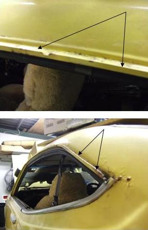

I'm talking about cutting the gutters off the roof as pointed out in the following photos.
Can it be done?
Has it been done?
Should it be done?
When I drive on the freeway will my roof peel open like a sardine tin?
I want to do it as I think it will give the car a smoother appearance and besides the chrome is impossible to find,
and before anyone suggests it, I have no intention of using adhesive chrome trim or anything similar.

Have seen it done on a cortina, looked fairly good but not sure how you will go with strength.
Would want some beefy modification, seeing as the gutter is the seam where the roof meets the sides of the car.

Was planning on welding the seam after cutting off the gutter.
Bit concerned about getting wet though!:blinks:
Might just give it a go and see what happens!

Did it on one of my Datsuns and it worked OK. You do get a bit of water dripping over the edge of the door when it rains, but not a biggie really...
Don't forget to strip the interior (mine was on a rally car) so you don't set fire to it with sparks from the welding.

Panel shop would charge a fair lump for this sort of work wouldn't they? It does look good when done right.
Yes indeedy, and cover up the seals and windows too when you do it.
I've set my car on fire many a time from welding, strangely satisfying though... :hmm: :laff:
Also, not sure if you will find the same thing, but when I did it (not on a corolla) I ended up with a fairly large gap between door top and lip where gutter was. And the roof is sort of 'in' compared to the door looking down. So you might want to add steel to make it look right, if I'm making sense :cool:
