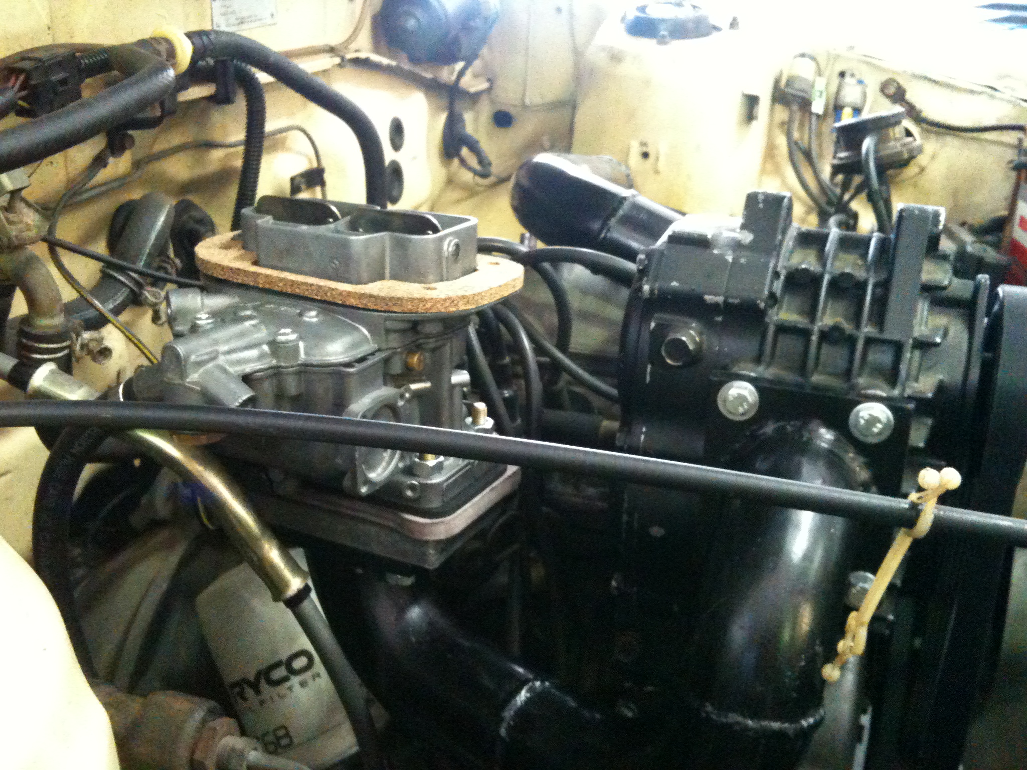

I'm a little worried about your intake path to the blower from the carb, any particular reason why it goes down so far before coming back up to to blower inlet? Low speed driving/lowair speed situations will probably cause fuel puddling down the bottom of the bend making for some interesting tuning issues!

  • Probably to give the car a reasonable amount of clearance with an air filter fitted and to keep a decent amount of radius in te bend.   Wack a sidedraught straight on the inlet :P

In all honesty this is more of a quick test/trial for when I do it to my 5k. So if it fails, I'll trial and error before moving onto supercharging the 5k and hopefully have all the problems worked out by the time it's ready :D

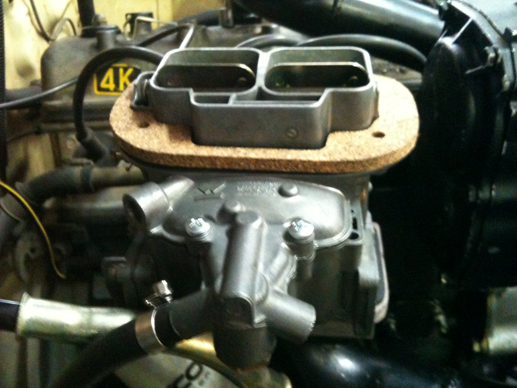

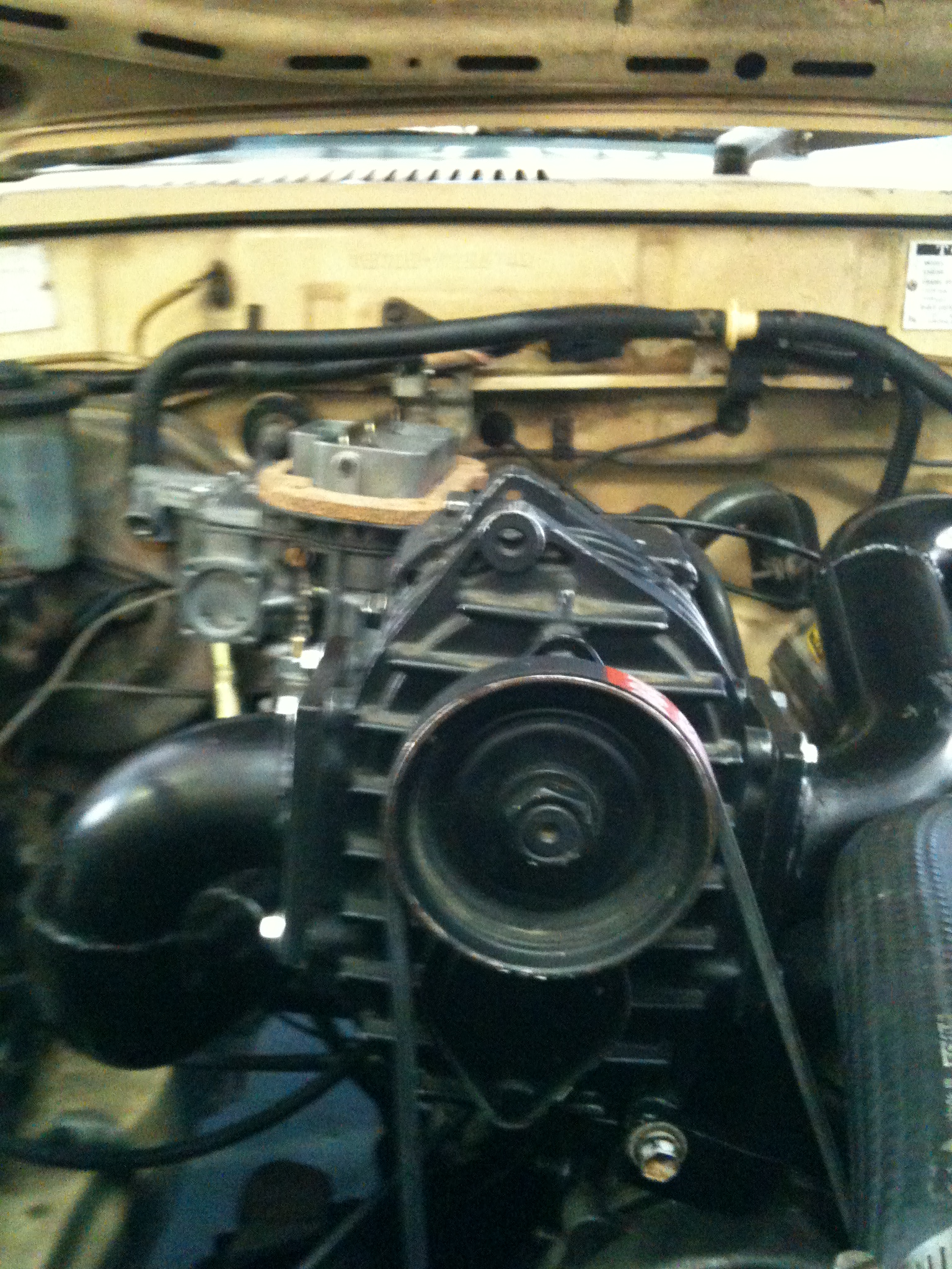

So I managed to get in nice an early to "finish" my work. I got there and straight away began dismantling the setup so that I could replace the blowers again. After much tedious lining up and what not I finally got it back to the way it should be. After all this fiddling and rage, I began working on fitting the Weber 32/36 carby. Most of the time was trial and error with how I would bolt it together, at first I wasn't keen on using the double ended bolts that you'd normally use on the intake manifold, but after some thinking I was okay with it. After much dicking around with bolts and gaskets the pipe was ready to fit the 32/36.

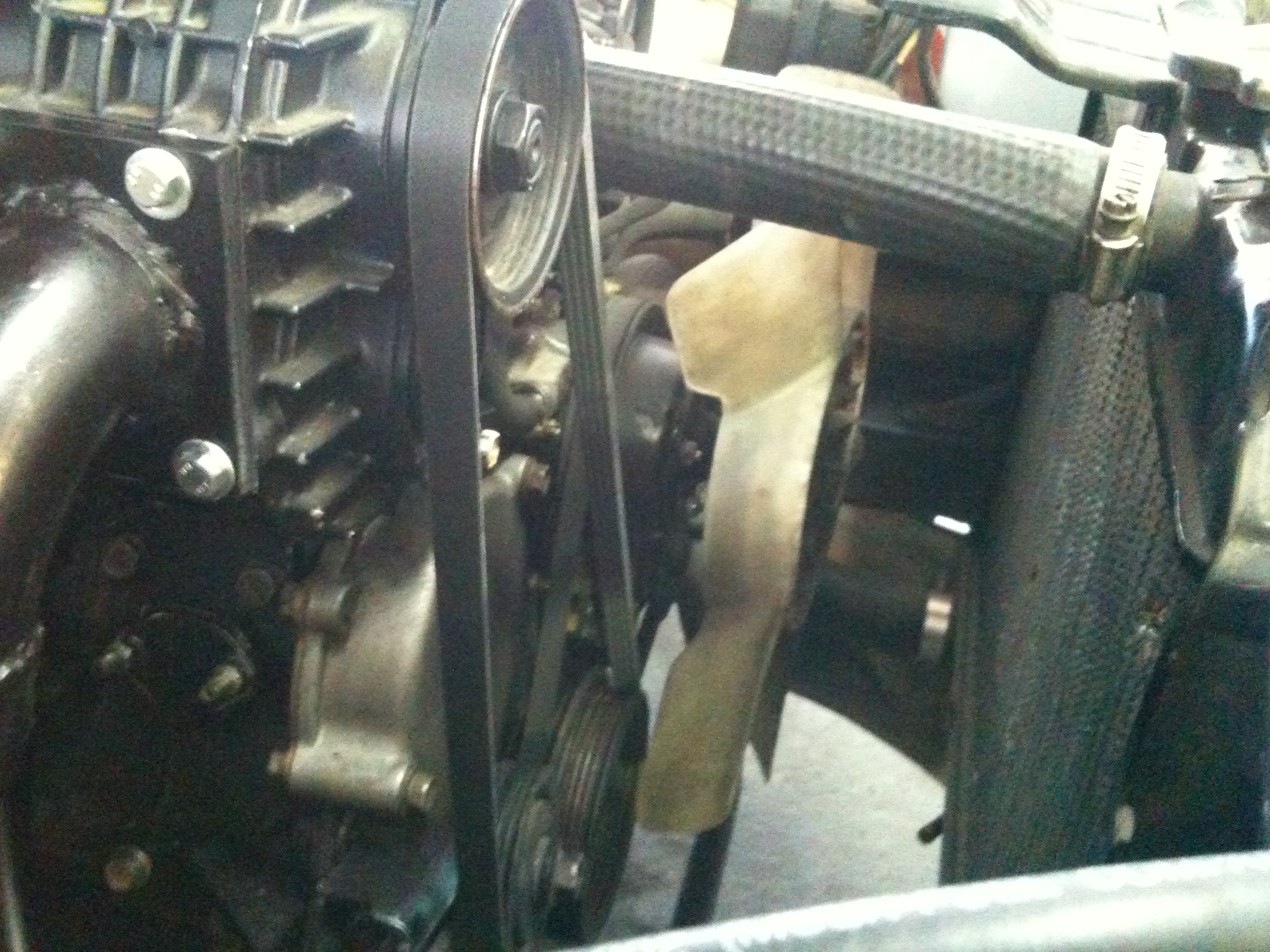

It worked out perfectly so far, so I then moved onto reattaching the choke. I did so, then the mechanic told me it was wrong, so I had to redo, but with more success the second time. At this point I was running short of time as I had to go to work for yet another NIGHT SHIFT!!!! So I made a quick trip to Repco to get the final odds and ends for the build, a new belt to suit the setup (The one I had was far too small), more fuel line seals and some electrical male/female terminal connections for the electric fuel pump. After picking that up I fitted the belt on with a good level of tension and attached the last remaining fuel line(pump<carby).
