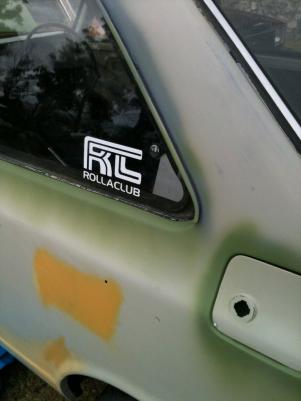

Jono.C Posted February 2, 2012 Author Report Posted February 2, 2012 Oh! Also pimped out my windows while they were out, The hardtuned one came with my hoodie so i just stuck it on. Â Waiting for my datsun one to come in the mail :lolcry: Â Quote
