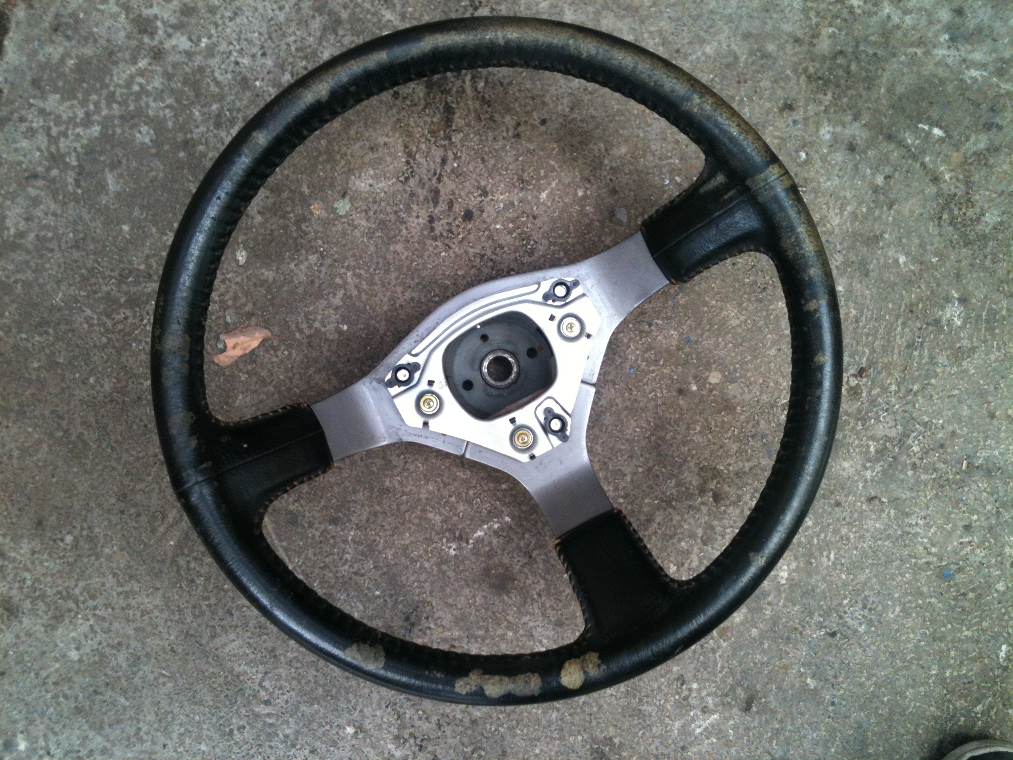

Very haggard and cracked/ worn leather.

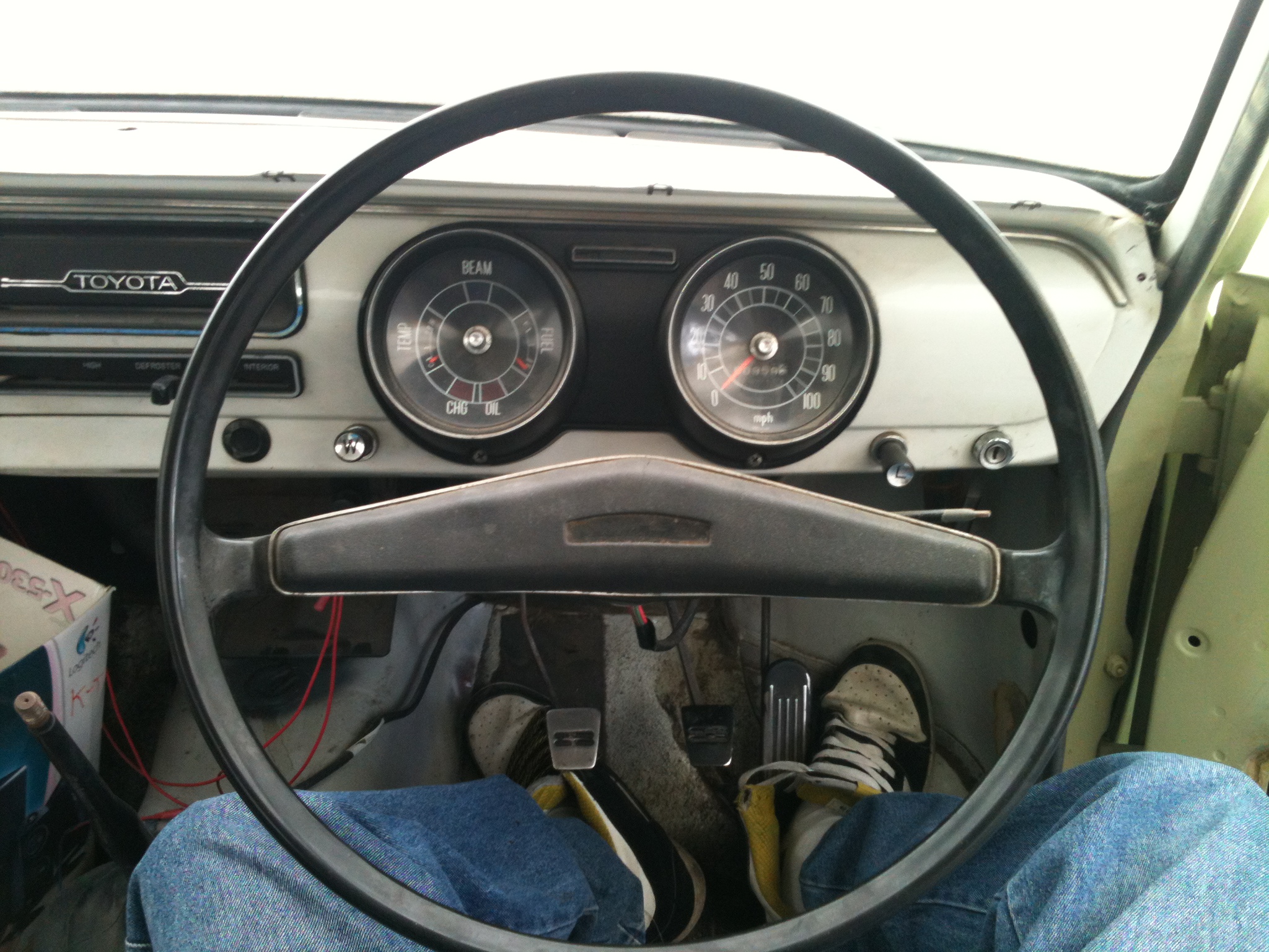

To replace this bus wheel

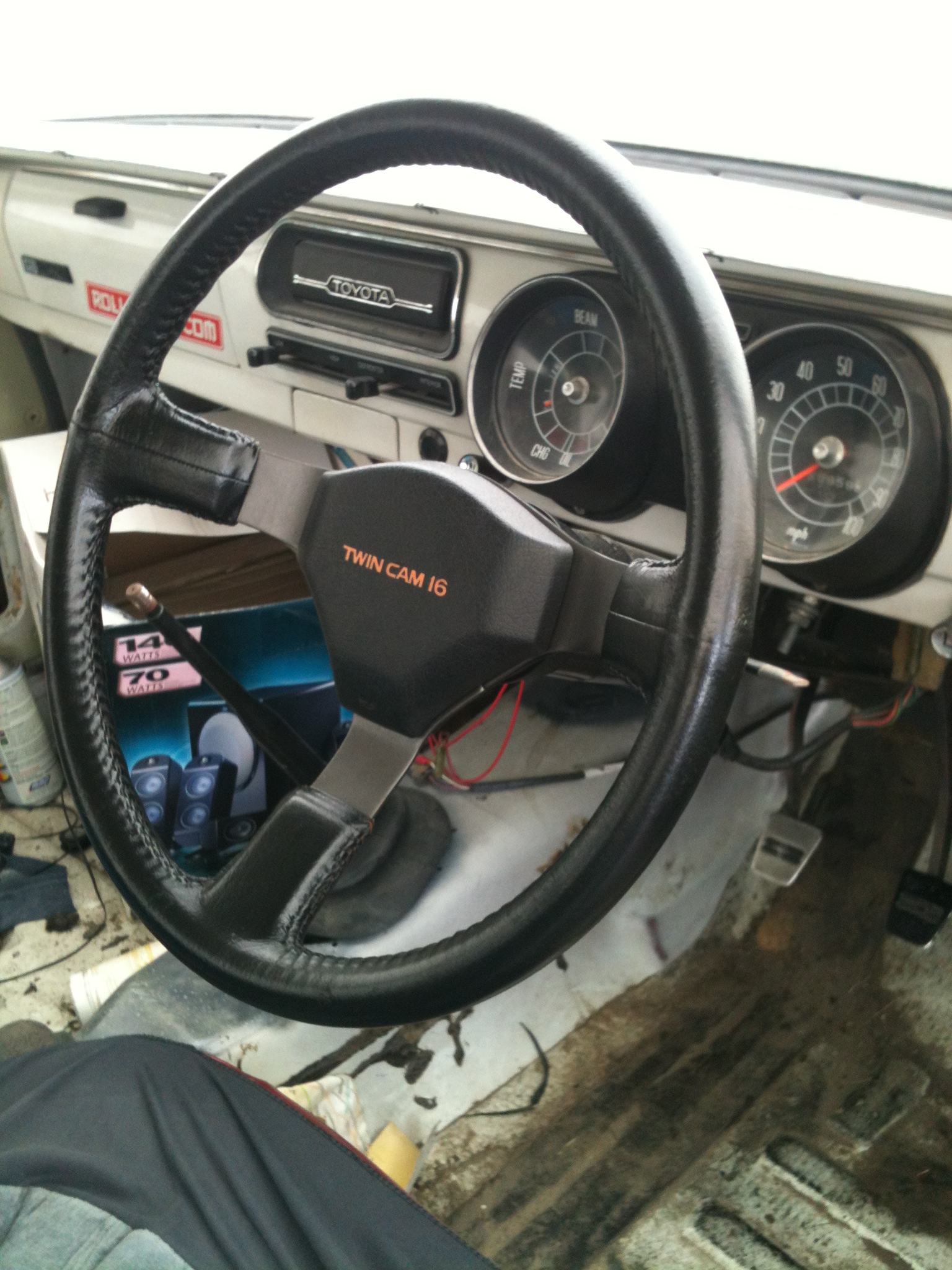

Spent some time sanding the old leather and used a leather repair-ness-ing kit
Feels good! Sits close. You lose the auto indicator off with it but meh. Will be replaced with a nardi after rego anyway :wink:
I know how i'm going to fix it. The twin cam wheel has an extra 2 holes in the back of the boss kit thing, you can see in the first photo.
The ke10 wheel has 2 dowels in the back of the wheel just flick the indicators off.
So i'm going to cut off some metal tube the right size and press it into the holes in the back of the twinky wheel, the spacing doesn't appear to matter
