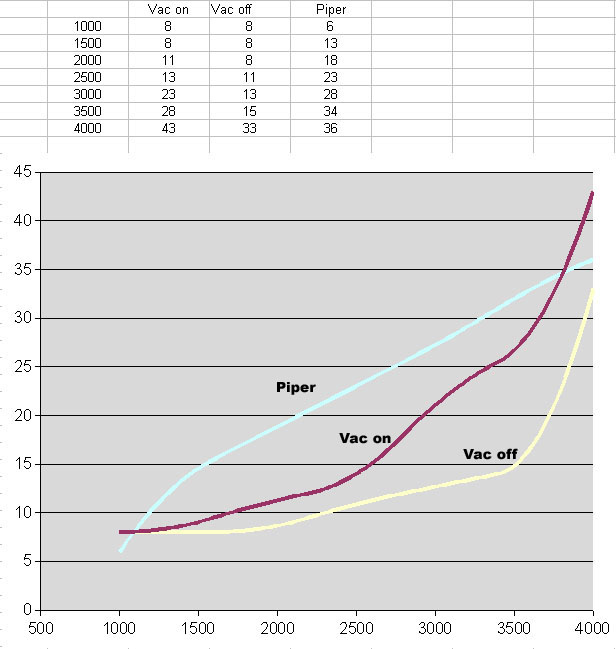

I have moved along and fitted an electronic dizzy, one that KE Motorsport sells. Certainly cleaner at low revs or when cold, and I just added advance until it felt OK. Today I plotted an ignition curve, and I found I was running 18deg static advance to make it get up and go! So I've reduced it back to 8deg and plotted this-
One set of figures with the vac unit on, one with the vac unit disconnected, and a Piper dizzy chart for comparison. That is what the Honda Accord uses, and is similar to the other dizzys mapped here-
http://www.jcna.com/library/tech/tech0015.html
I think the car feels much better with more advance early on, and I wondered who has had theirs re-mapped, what the curve looks like, and who really knows what changing the curve does in each sector...
Thge fgures I read were similar to Camerondownunder's specs, 9.5deg at 1700rpm and 13.5deg at 3100rpm, so maybe K dizzys just don't work...

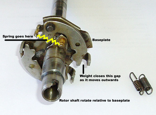

Here's step one- stock dizzy. If you've never seen under the plate, it looks like this. First photo has the rotor shaft off the dizzy's cam drive shaft.

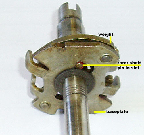

Second photo has it assembled. Those are the springs that control the rate of ignition advance, as those two centrifugal weights move outwards and turn the rotor shaft on the shaft inside it. That turns the rotor more, relative to the cam/crank and works the points earlier, so the spark arrives earlier.
You would think that the weights move out to take up the gap and stop advancing when they hit the vertical tabs... but no, max advance is done with the rotor shaft in the 2nd picture having pins into slots of the base below!

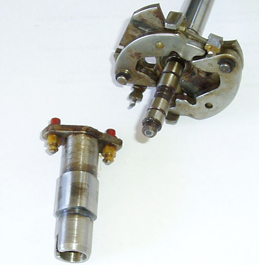

So, in the third picture you can see the rotating shaft's pins enclosed in red plastic sitting through the base plate slots. (well, one of them anyway) So to get more max advance you file the slot longer.
The pin moves 3.4mm in the slot, and they are 24mm apart. So they sit on a circle of pi*24=75mm, and 3.4mm is 4.5% of that, which is 16deg, so max advance is 32 crank degrees... just what I measured yesterday!
You can see that the weights and springs control the rate that advance is added, and the slots control the max spark advance you can get. On top of that, the vac advance pulls the points plate around, and ALSO adds and substracts advance.
