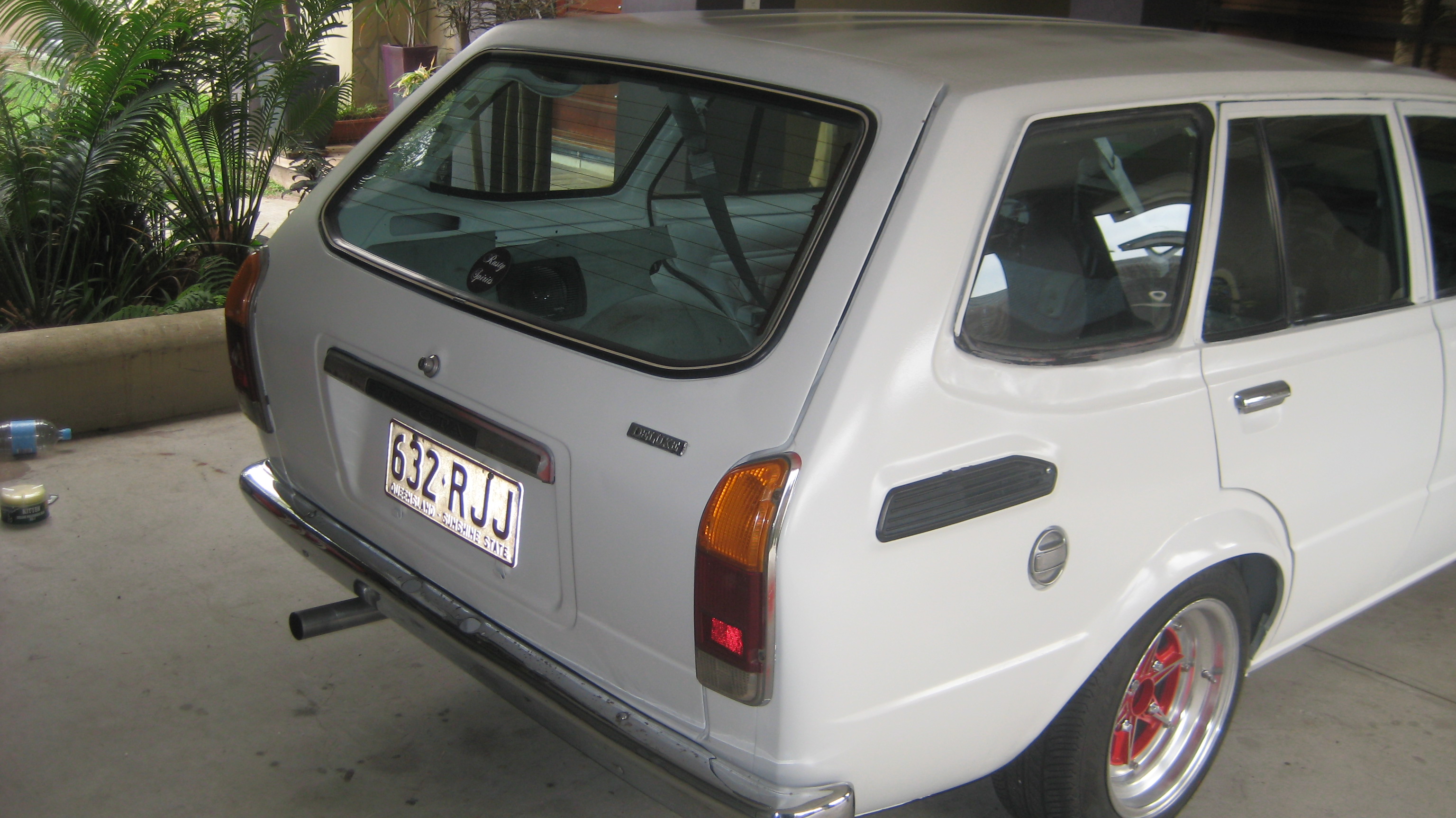

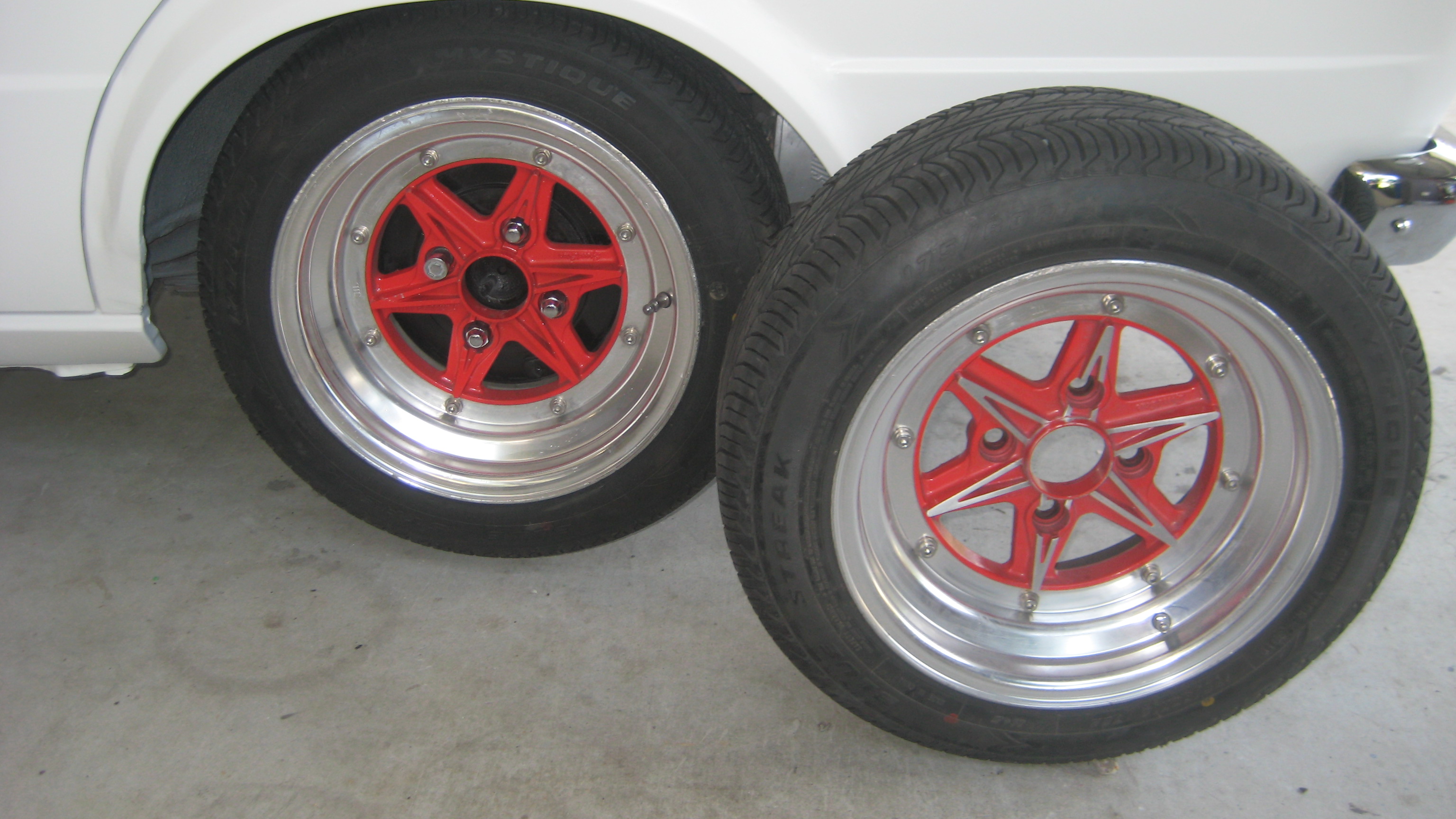

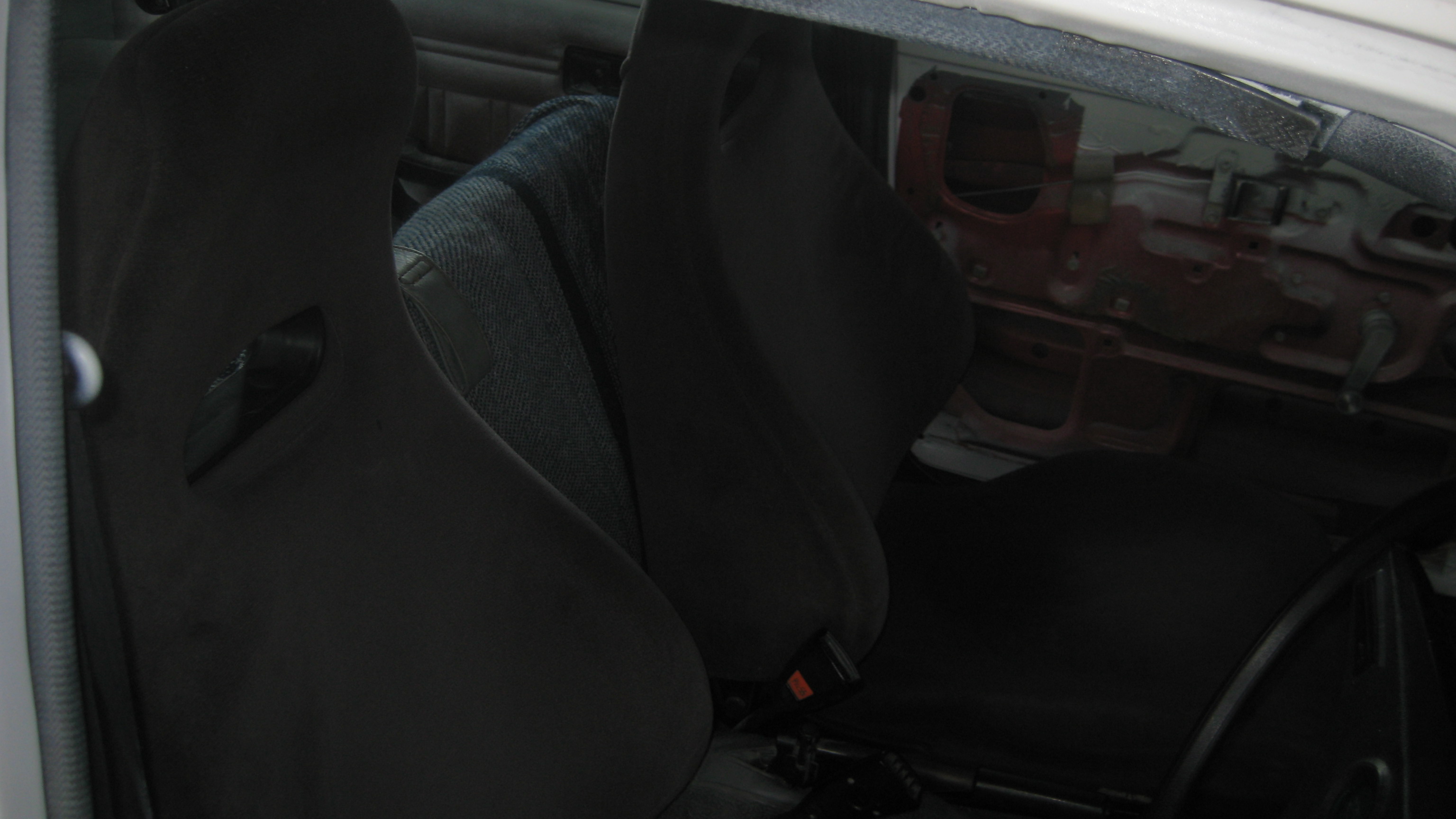

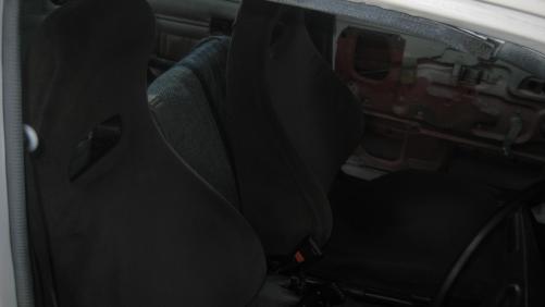

More updates! sanded back the machined edge on my rims that were painted over by previous owner, such a simple thing made the wheels (in my opinion) look 100 times better. Gave the old girl a buff too, not as glossy as I was hoping but it's all a learning curve, first spray job ever, so I am still very pleased with the outcome. Also scored some overrated black origional ke30 door cards off RA28GT (legend) a while back that are going in any day, wow and I nearly forgot to mention I installed s13 ca seats yesterday.

how'd you go fitting the ca seats mate?
much work to make em fit?
really like what your doing with the car mate :y: the red on the rear rims looks tuff have you thought about making the front the same colour? still looks good as is tho.

CA seats were easy, take off the stock ca rails, Measure dimensions of stock corolla rail bolting points 320mm x 390mm if I remember correct. mark out the bottom of the ca seats with a pencil, use a hole punch to mark holes, drill out the holes, get 4(per seat) bolts, matching nuts and a spacer/bunch of washers 12mm head at a maximum to let the rails slide over and about 50mm long.
Use your hand to hold the nuts between the metal frame and the padding of the seat and bolt the corolla rails to them with the spacer/washers(about 15-20mm) between the rail and the seat. The spacers are used to let the corolla rails clear the bottom of the ca seat bucket so that the adjustment of the rail can still be used.
Reapeat for all corners of the seats and you should be right to go, you might need to use a bar or similar tool to move the rails into place once bolting to the floor pan as the bottom of the ca seats have an angle and this skews the rails a little. Isn;t a hard job it just takes a little patience and persistence.
I'll be taking my ca's out soon to redo them as the spacers I've used are too small and the seat struggles to adjust. While I have it out I'll make a tutorial on it :y:
cheers 36panvan, plan to paint the front rims red very soon, I'll get onto those vents soon just been really busy with this thing as of late. More updates tonight ladies and gents.

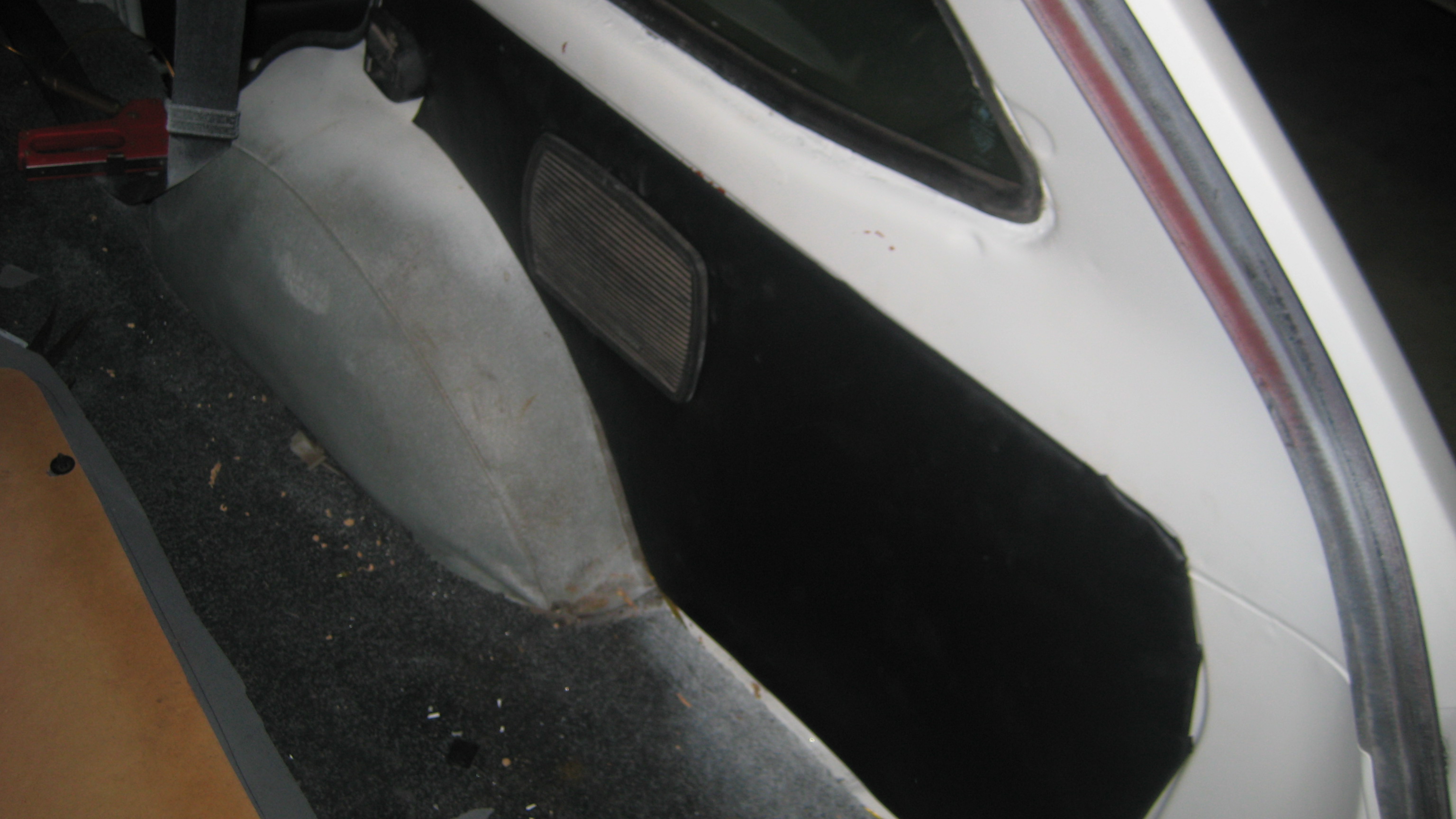

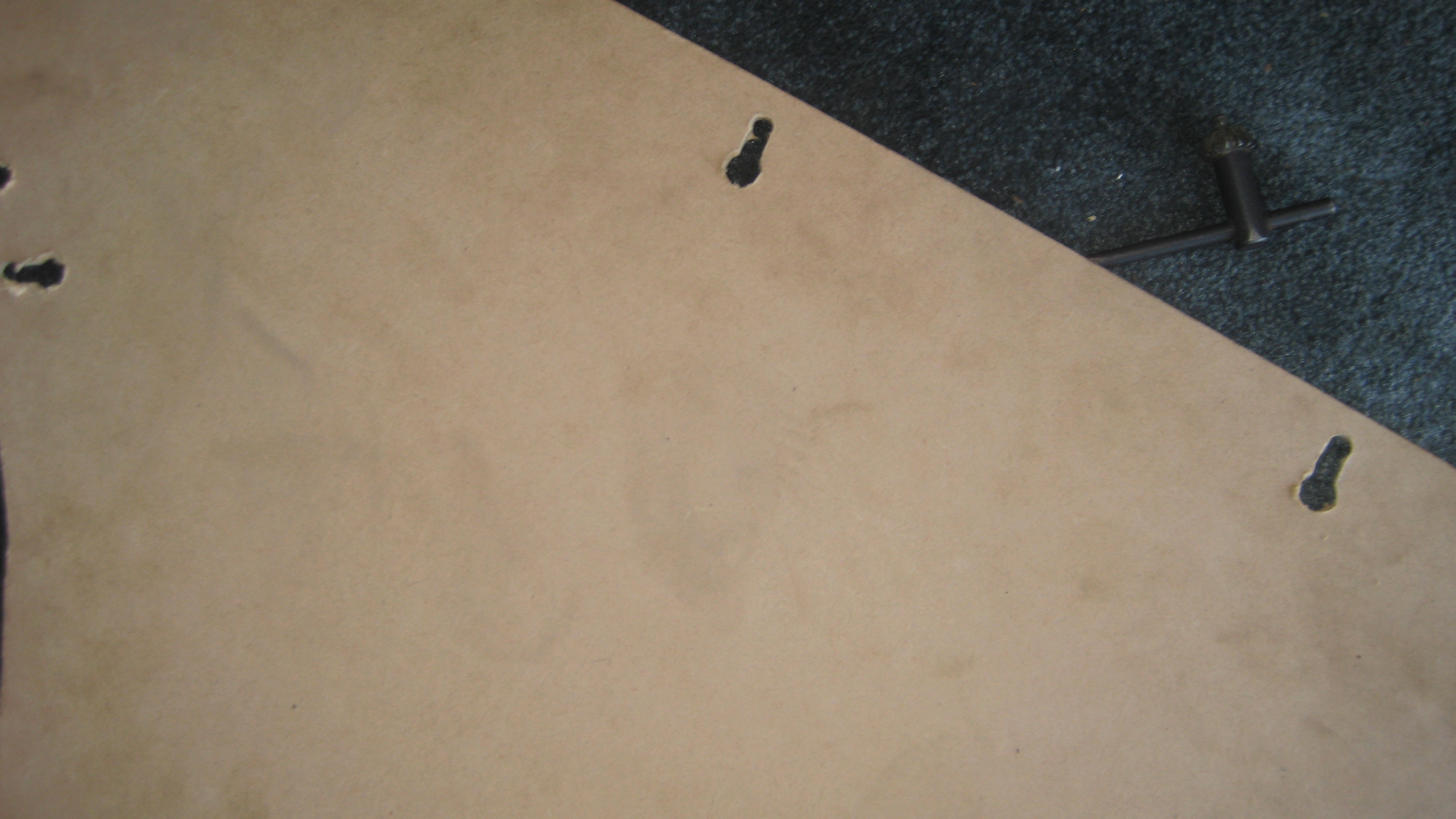

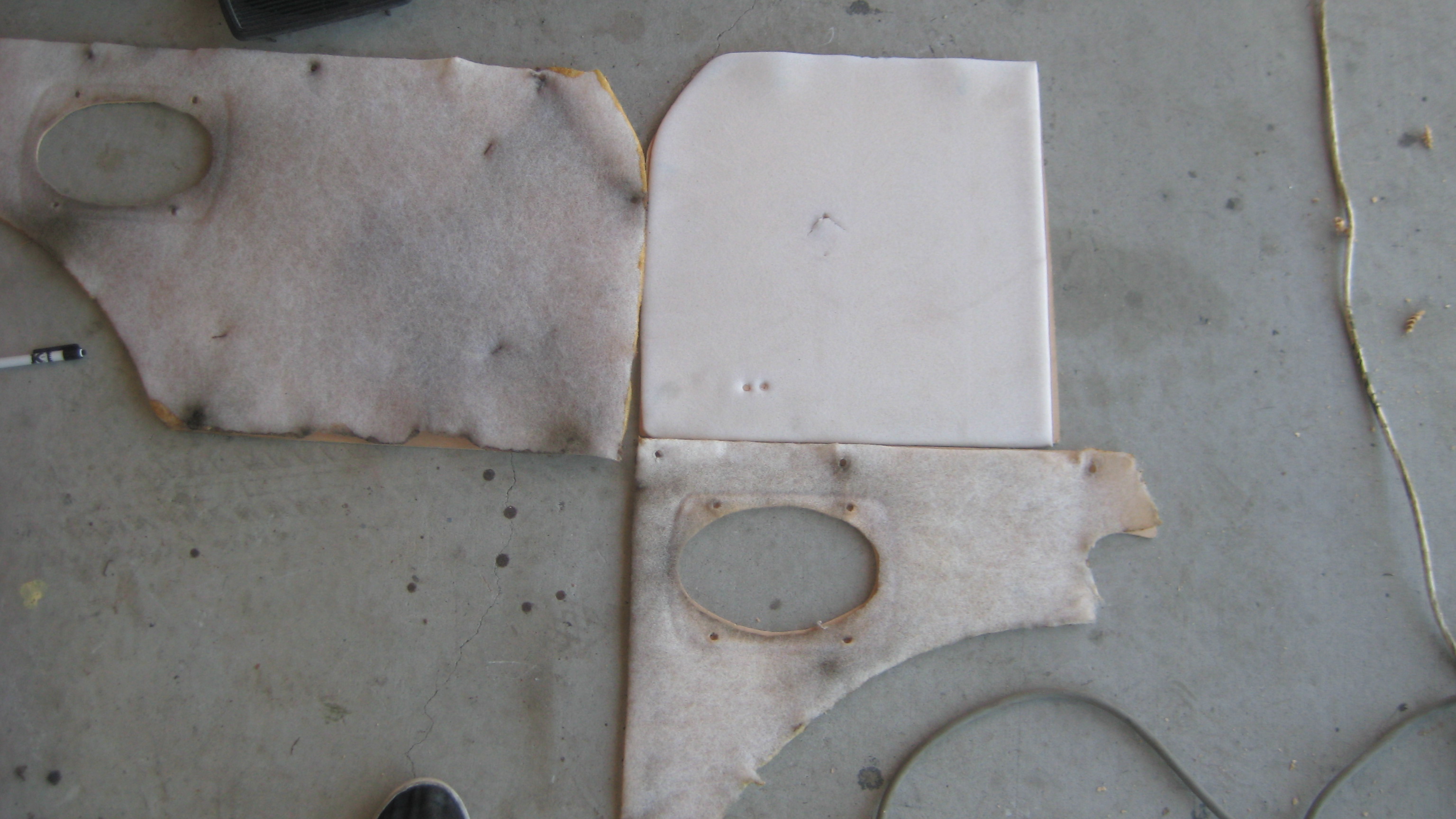

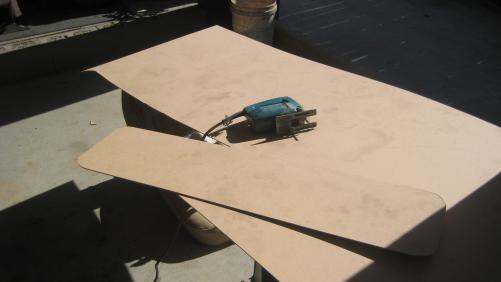

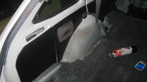

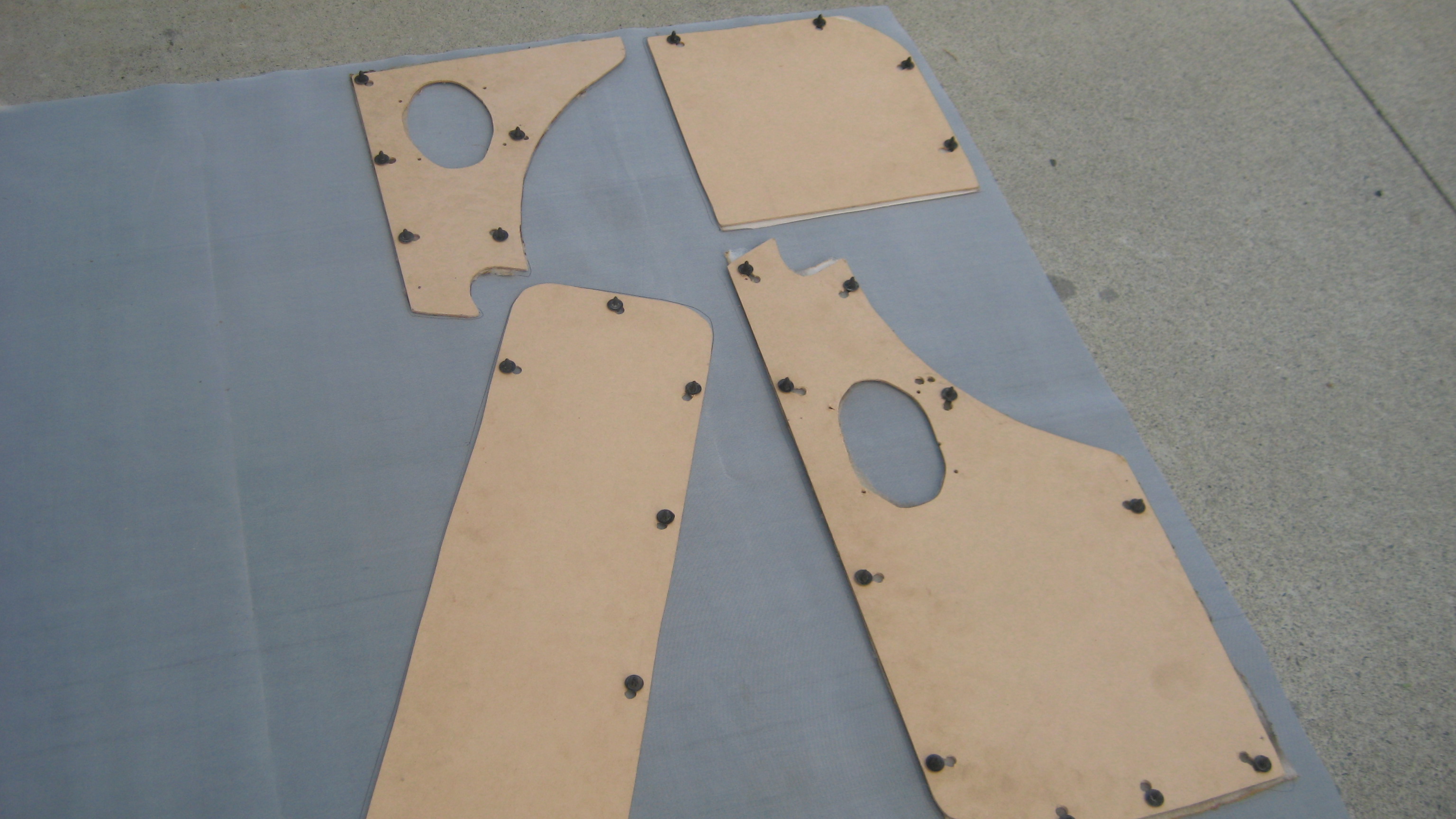

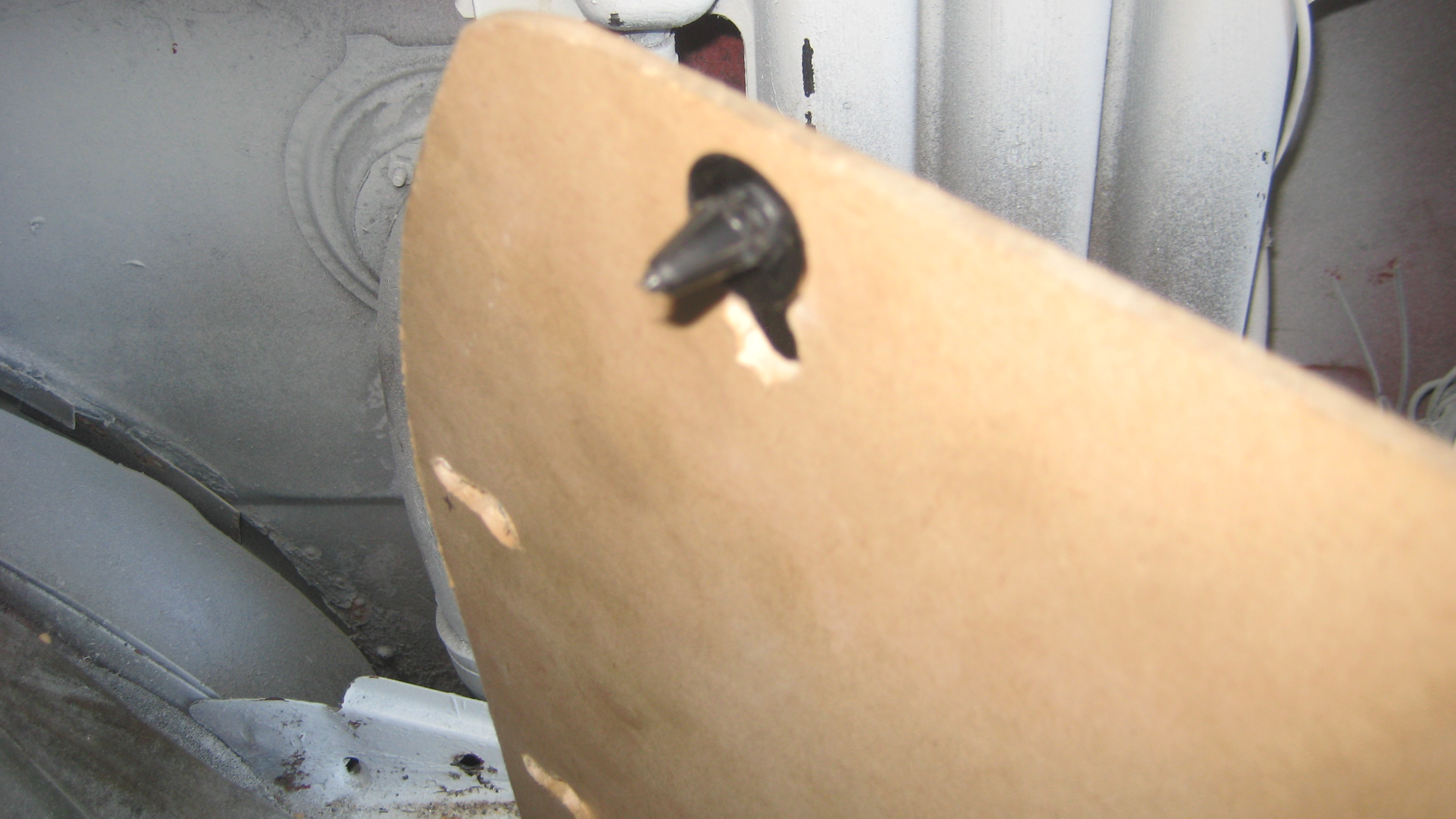

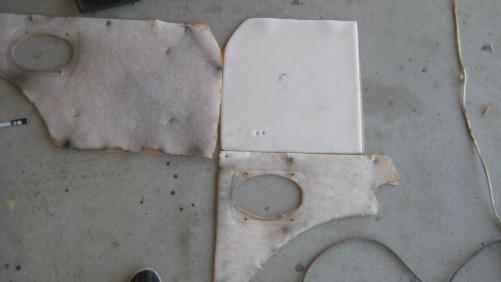

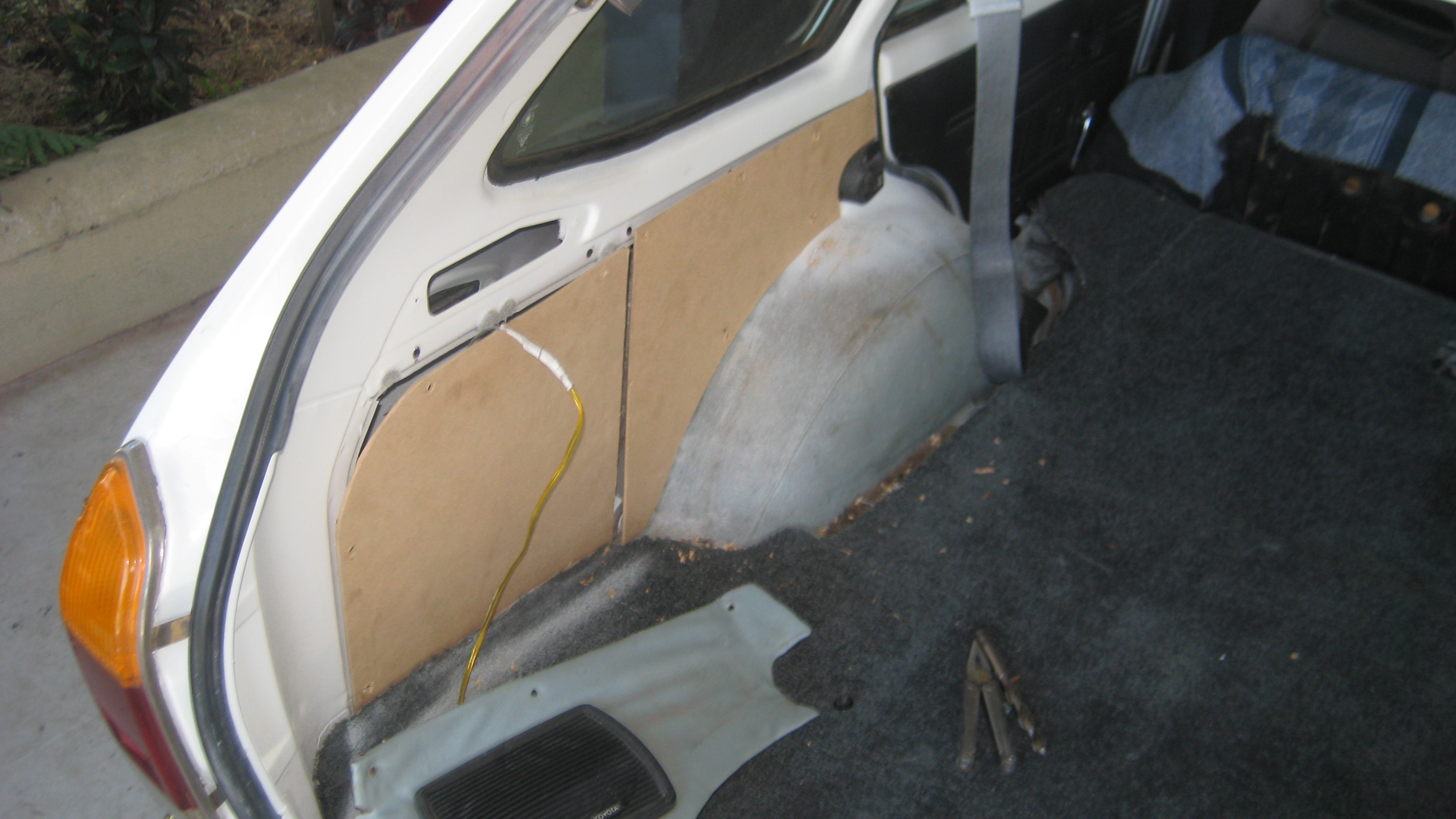

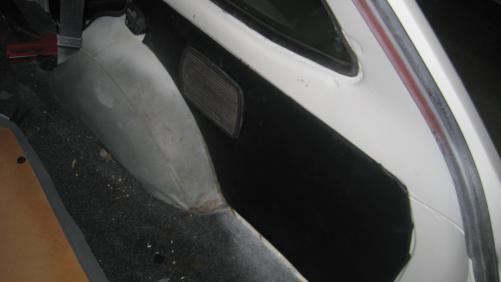

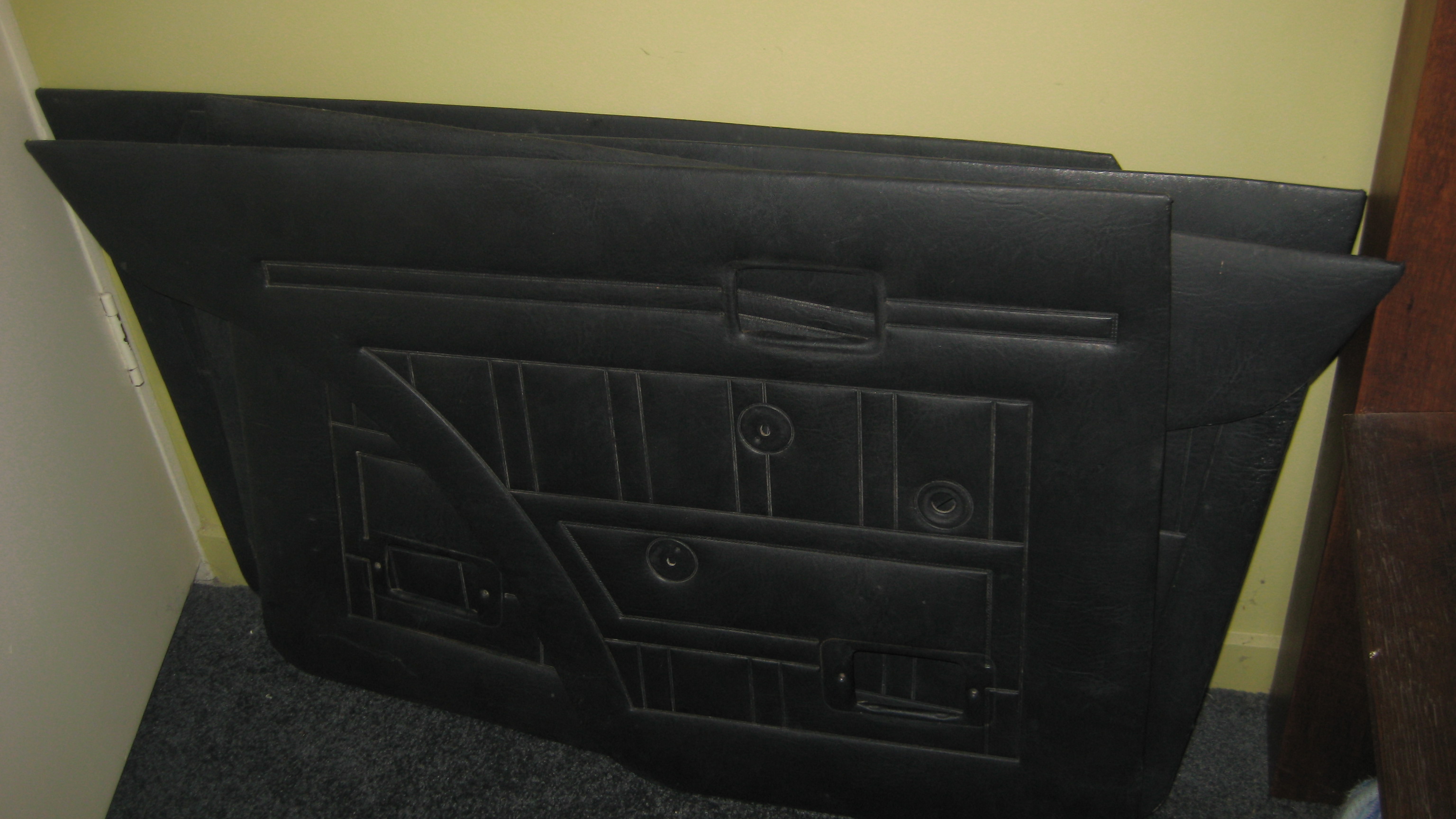

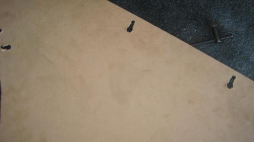

My rear sky blue boot cards were falling apart so I made some black ones today to match my door cards. overall it turned out pretty good, used the interior push clips from my previous door cards for these, even snuck my alpine 6" behind the stock speaker grill for the original look and stealthiness. Also tidied up some wiring and security issues but they are best not mentioned on a public forum. :wink:

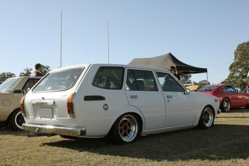

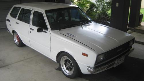

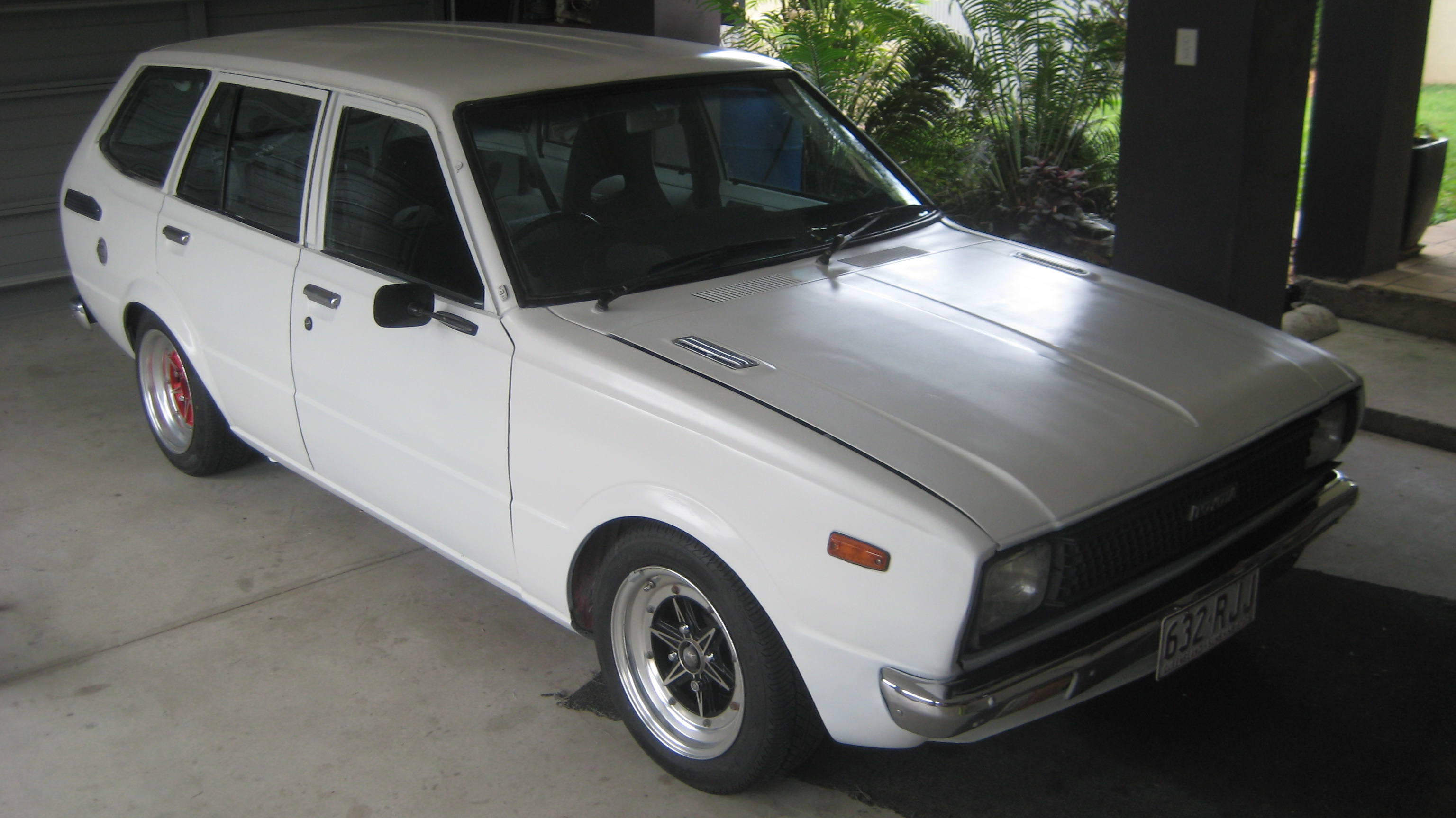

Well boys and girls had a great day on Sunday at the all Japanese day, great to see a healthy number of rollaclub members out and about. Very happy with the way things are going at the moment :yes:
Car looked awesome at the show after an extensive clean. Just thought I'd throw some pictures of me painting the car and also some decent photo's other people took of it at the show.

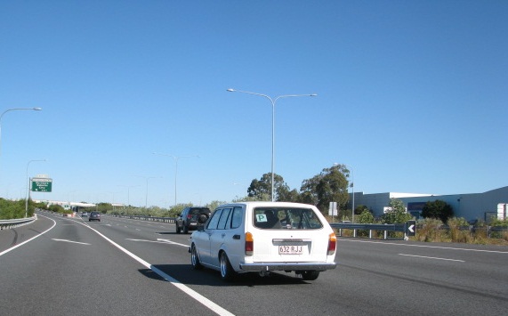

how did u get it this low bro
Flipped leaves and a couple added, 50mm lowering blocks and falcon springs with short strokes. "persuaded lowering blocks"
