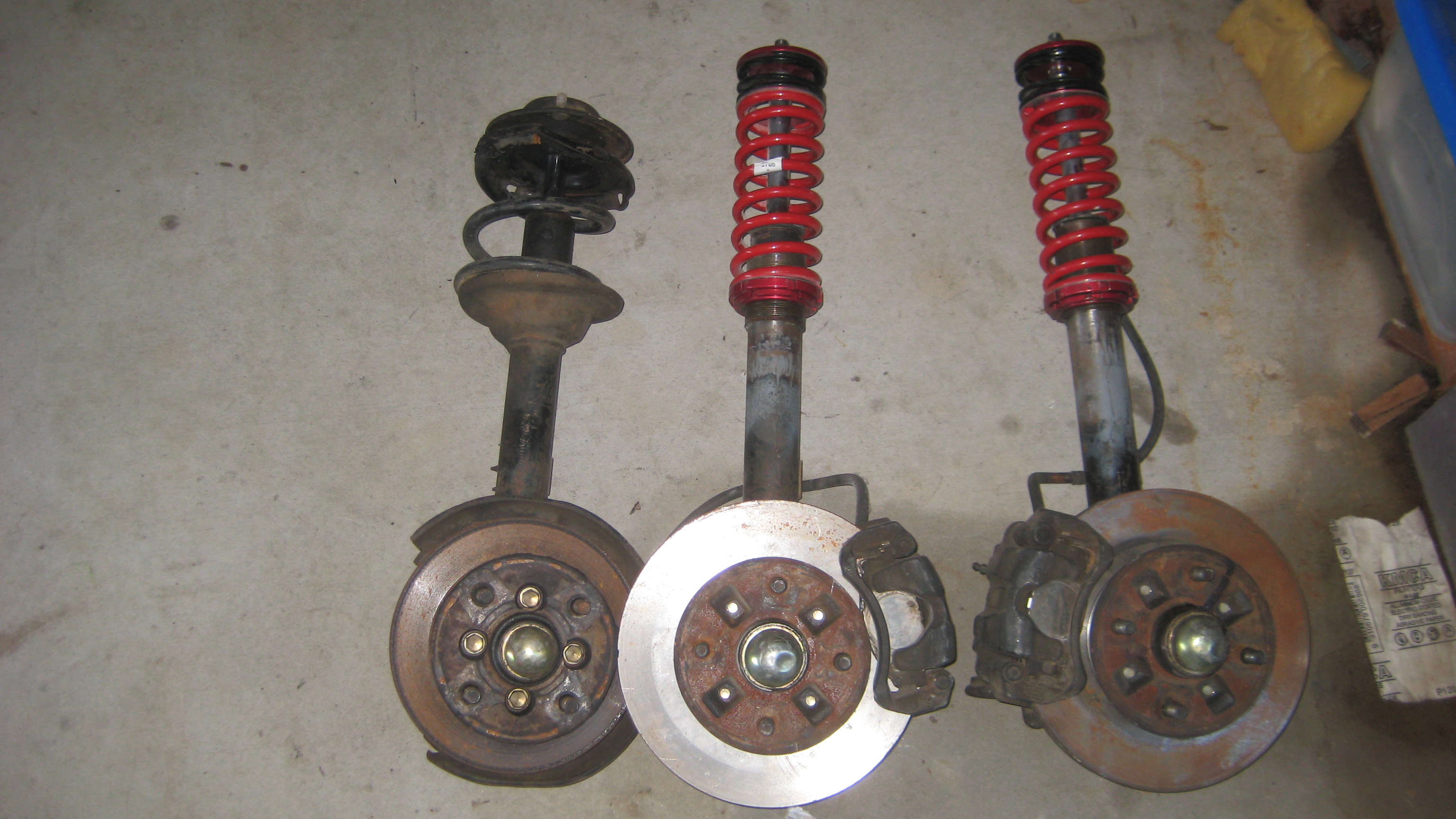

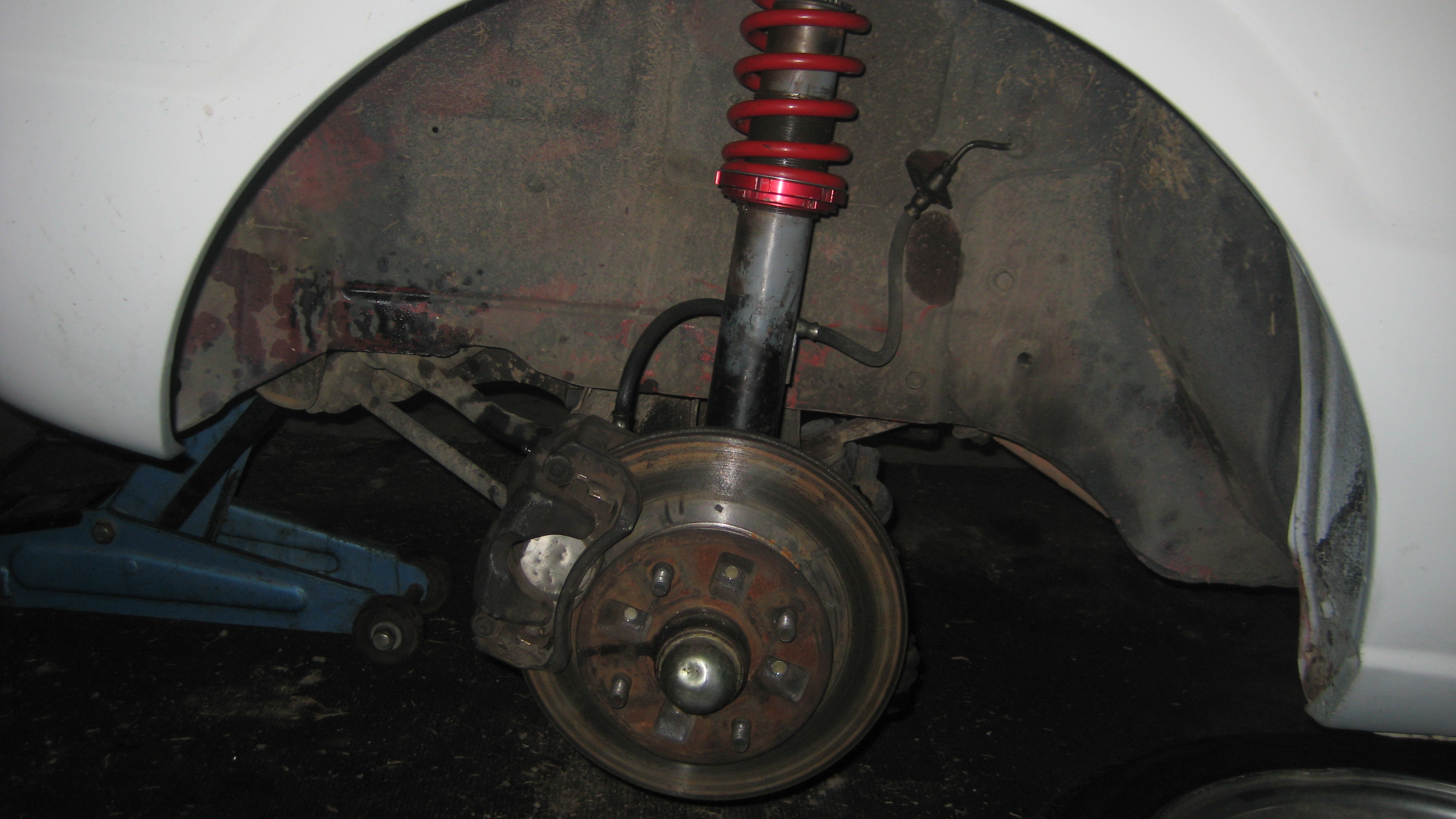

This was my current set up until today artofliphkd, it consisted low king springs and a Subaru brumby short stroke shock... not to sure if you get the brumbies over in Cali.
UPDATE TIME:
Coilovers are in! but car isn't road worthy yet. More details in next post... this mini laptop grinds my gears to type with.
Ok, while fitting the coilovers I ran into a little trouble; corolla(ke30,55,70 and ae86) steering knuckles DO NOT FIT the xt130 struts. luckily these coilovers came with knuckles. The outer tie rod ends looked like they have never been changed in the cars history and were impossible to get off the old knuckles, so i had to remover the knuckle then unwind the tie rod from the tube and replace them with the xt knuckle and new tie rod.

nice coil over setup was it hard to convert? and what brand are they?
Thanks man, Not too hard to convert just time consuming. They are a "pedders build it yourself coilover kit" welded onto a xt130 Corona strut that had the spring seat ground off. xt130 hubs, steering knuckles and bearings, ra60 celica rotors and mx62 Cressida calipers.

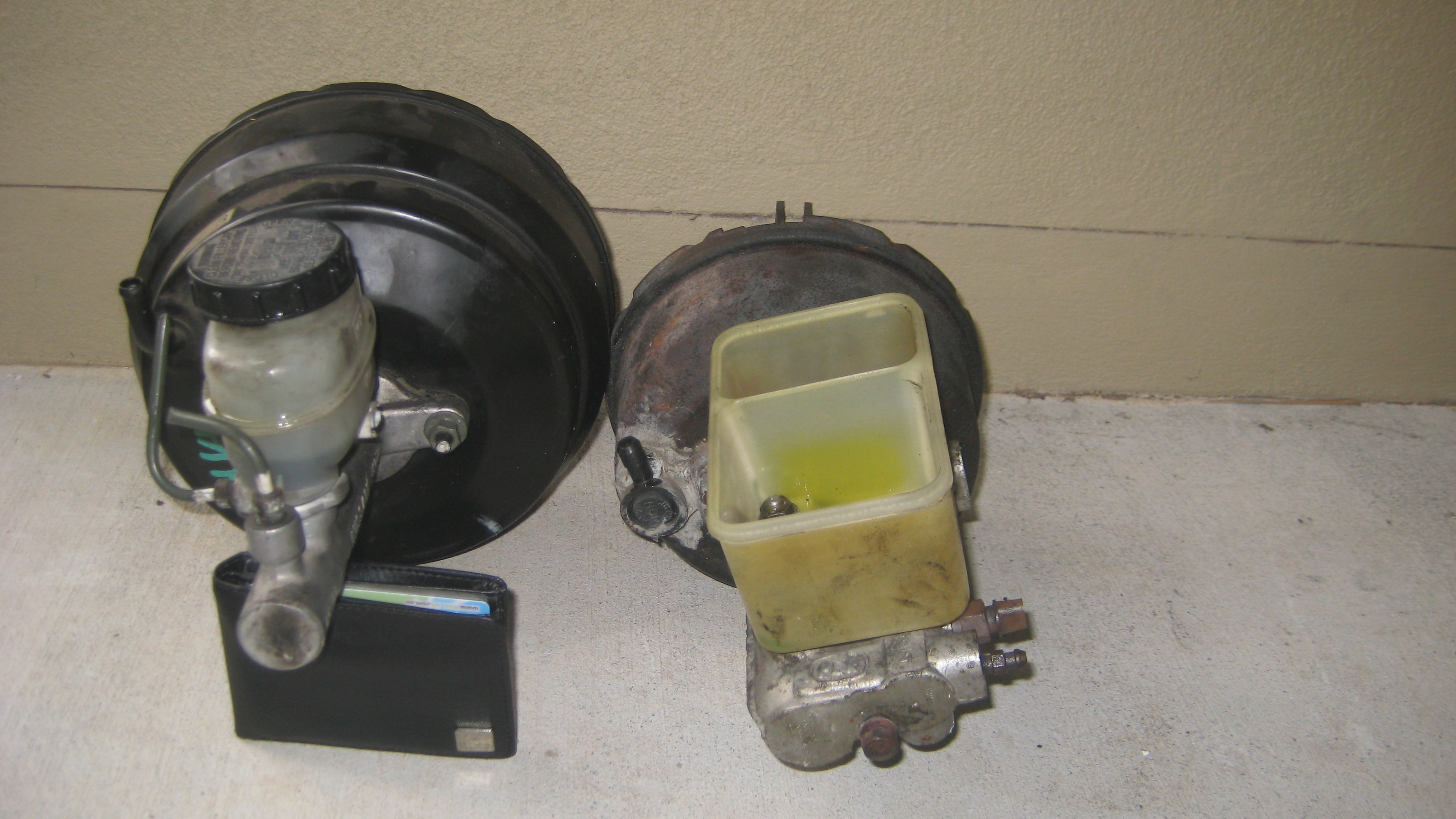

Got a n14 pulsar booster and master although I've found that i can't use the master on the corolla due to the lines hitting the strut tower, I'll go into detail when my photo's upload.

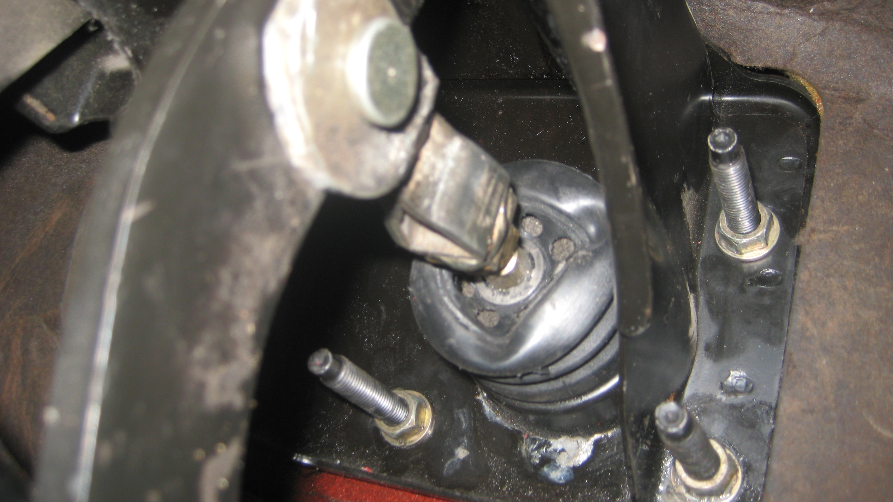

As I explained before my brake booster and master weren't up to the task of powering my new coilovers. So today I went about upgrading the booster and master to suit. Made a little tech write up to show what's involved as I think some people would benefit from it. N14 Nissam Pulsar brake booster and pajero master cylinder into ke30,35,36,38,55.

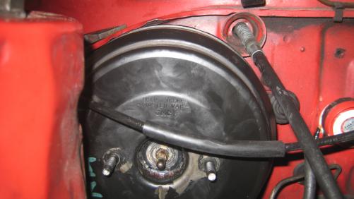

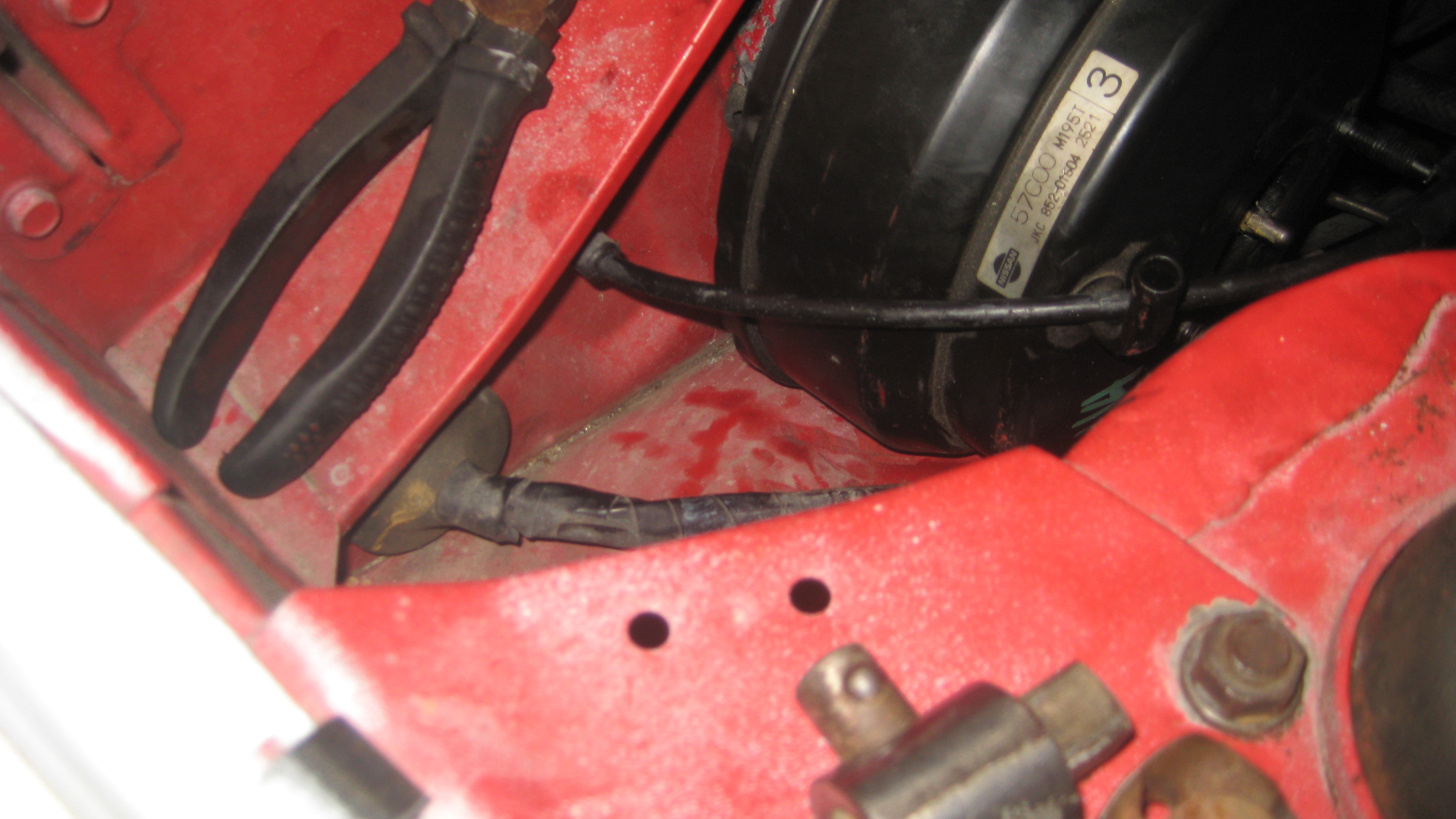

Firstly remove the stock booster and master from the firewall, it's quite awkward getting to the 4 bolts on the inside of the firewall. I can not explain how good the following tool was to get the nuts on the booster. Flexible T piece with a long 12mm socket helps so much getting at those impossible nuts without removing the complete dashpost-9001-0-15668100-1315562993_thumb.jpgpost-9001-0-55514100-1315617629_thumb.jpg

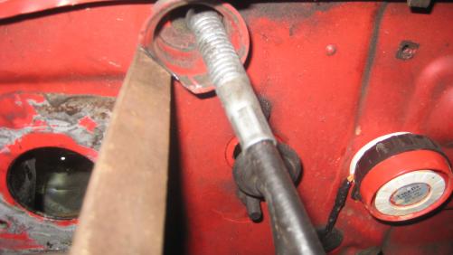

Then trial fit up the new booster to the firewall and mark out where the clutch cable input and rain lip need to be modified. post-9001-0-42683900-1315563602_thumb.jpg
The wheel arch also needs a slight tap to fit the booster, this is easily done with a hammer and piece of wood.post-9001-0-00486000-1315563746_thumb.jpg
grind a small section of the clutch cable input away and file smooth as shown also use some pliers or a hammer to lift the rain lip slightly.post-9001-0-48202500-1315564489_thumb.jpg

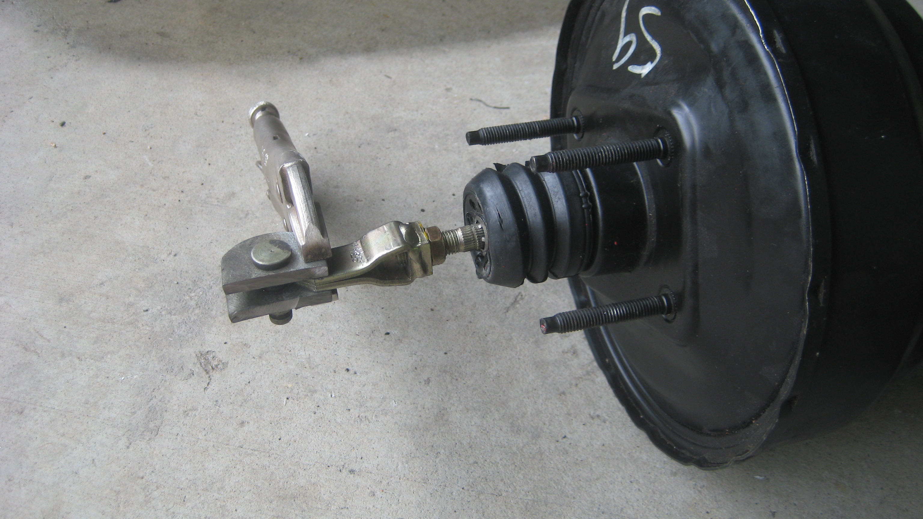

Next the shaft of the booster needs to be modified to reach the corolla pedal, trial fit the booster measure the distance from the center of the booster shaft and the hole in the brake pedal and make 2 steel plate to suit with a 8mm hole in each to suit the pedal pin.post-9001-0-72869000-1315565350_thumb.jpg
Fit the booster to the car and fit the booster pin through the pedal and make sure it has full movement.post-9001-0-20160900-1315617453_thumb.jpg

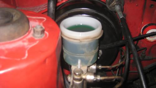

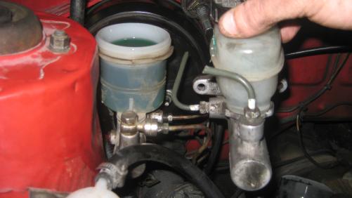

I had a problem with the n14 master cylinder, the brake line input is on the wrong side and when mounted to the booster the lines are unable to be fitted due to the strut tower. This is where the pajero master cylinder came in handy, it has the same bolt pattern as the n14 master. The brake lines mount on the right side of the booster so they don't interfere with the strut tower. post-9001-0-85098300-1315617948_thumb.jpg
Fit the pajero master and bleed the brakes and your done.post-9001-0-00617800-1315618152_thumb.jpg
Please note that this upgrade should only be done if you have upgraded your brakes as the combo is quite large and will be too touchy with your stock brakes.
